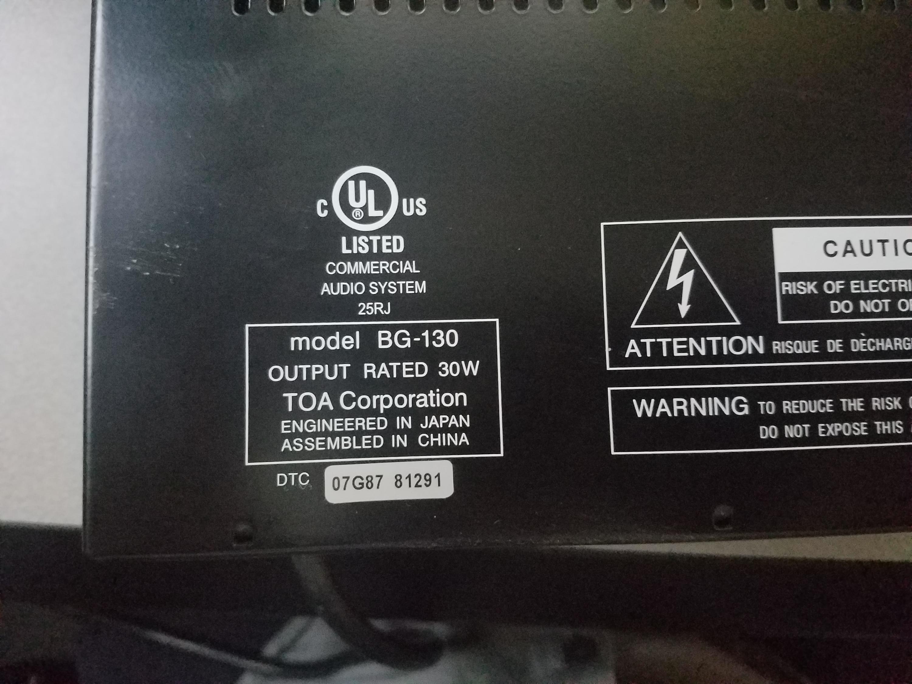

    TOA BG-130 Amplifier power supply fuse blown

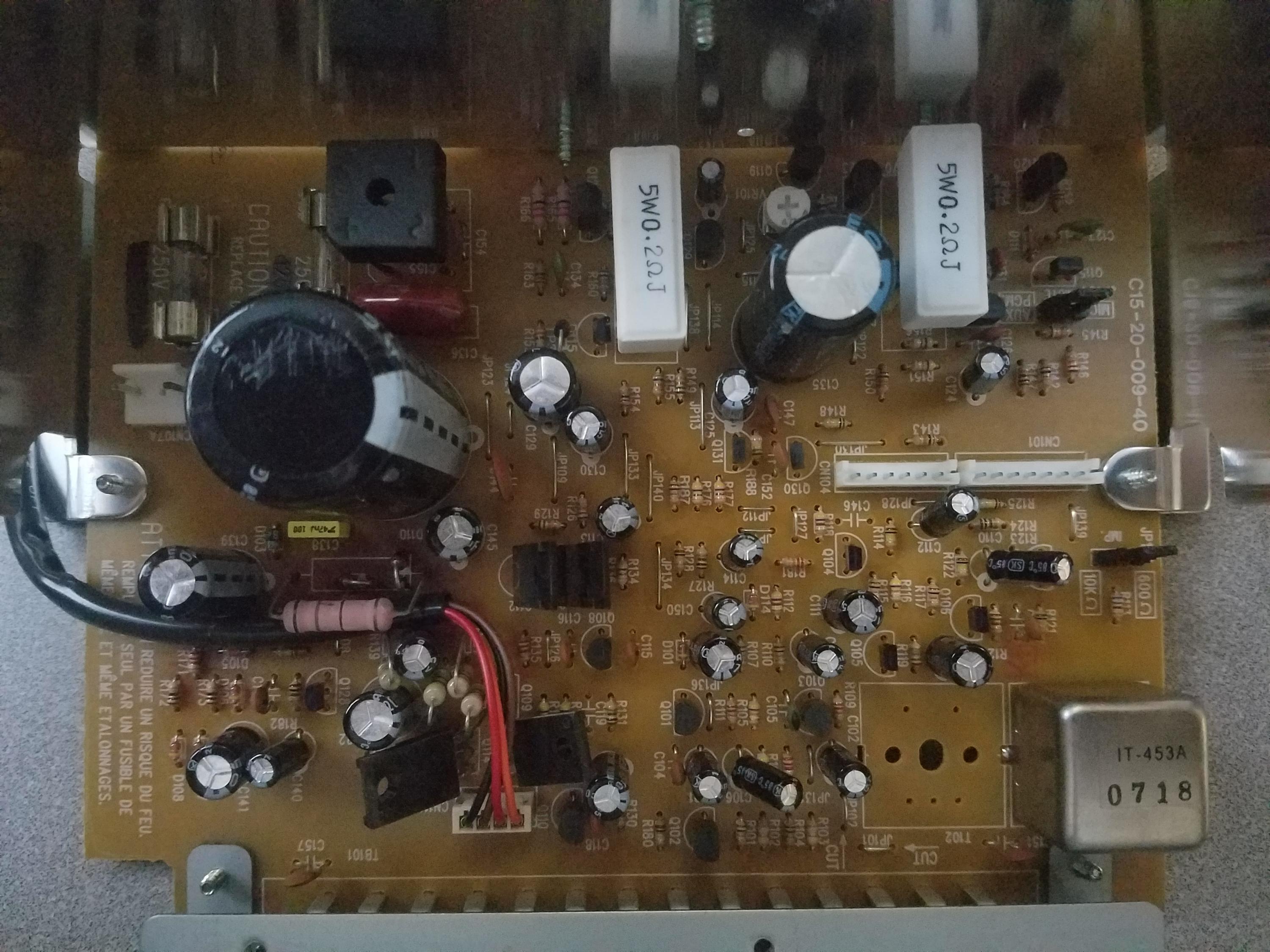

    This amp appears to have a basic unregulated power supply which is protected by a 1A fuse on the input side (F101), and a 3A fuse on the output side (F102).
    Power from mains through F101, into the transformer primary
    Unknown voltage out of transformer secondary through F102, and into a full wave bridge rectifier, and then through a 63V 4700uF cap. I'm assuming the secondary voltage is lower than 63V, lol

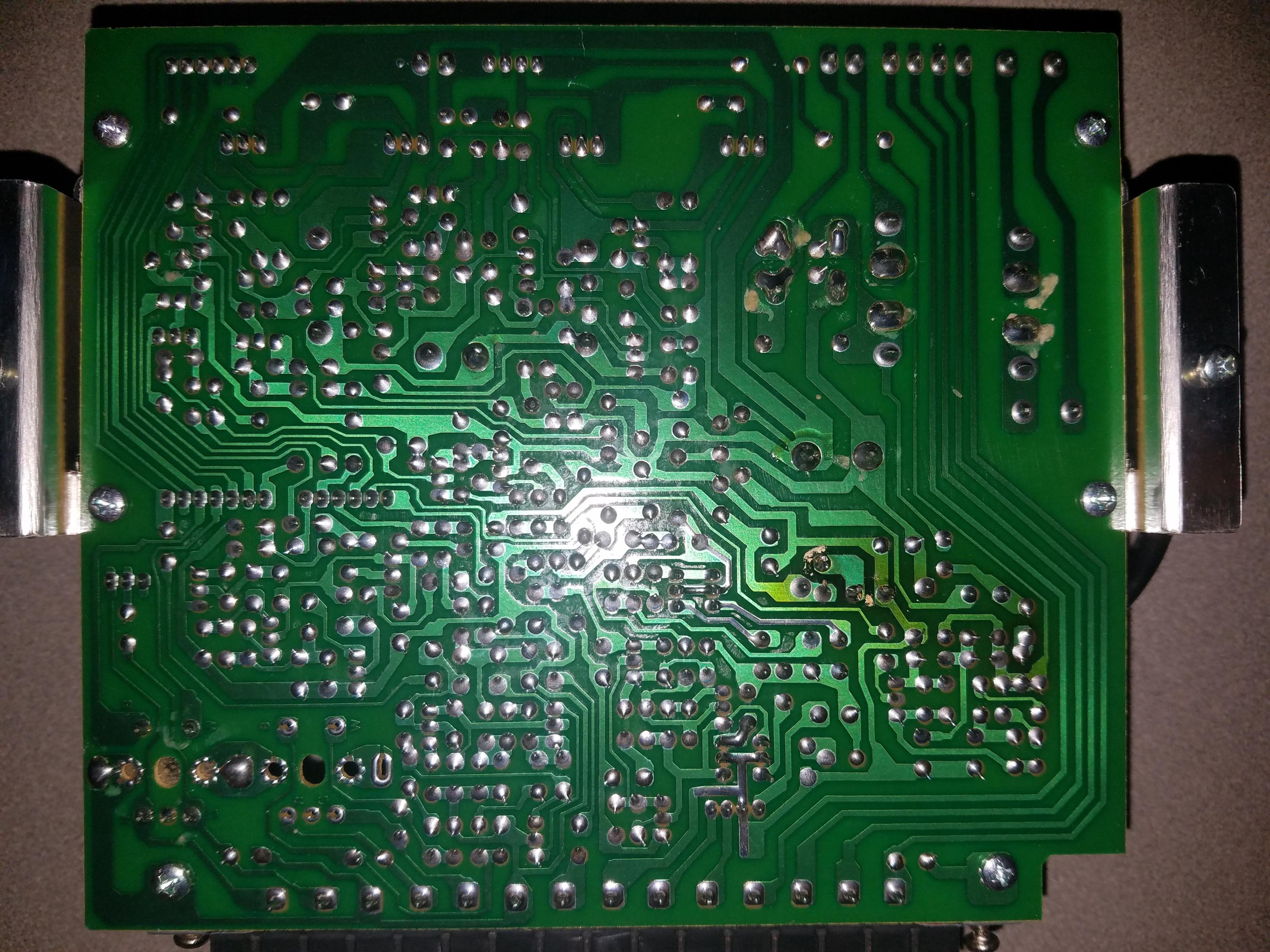

    F101 is blown, and If you guys have taught me anything it's not just to replace a fuse and plug it in..

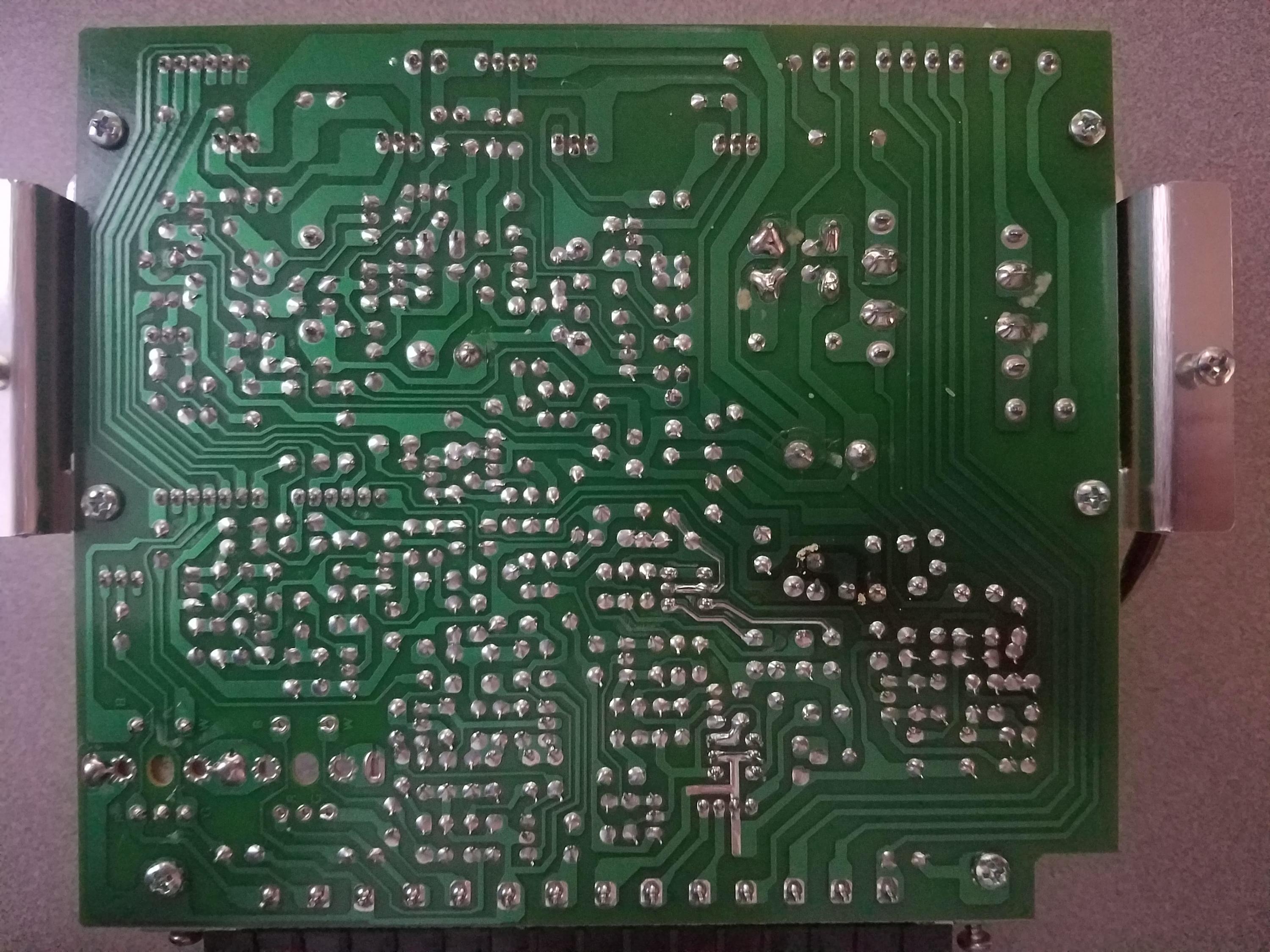

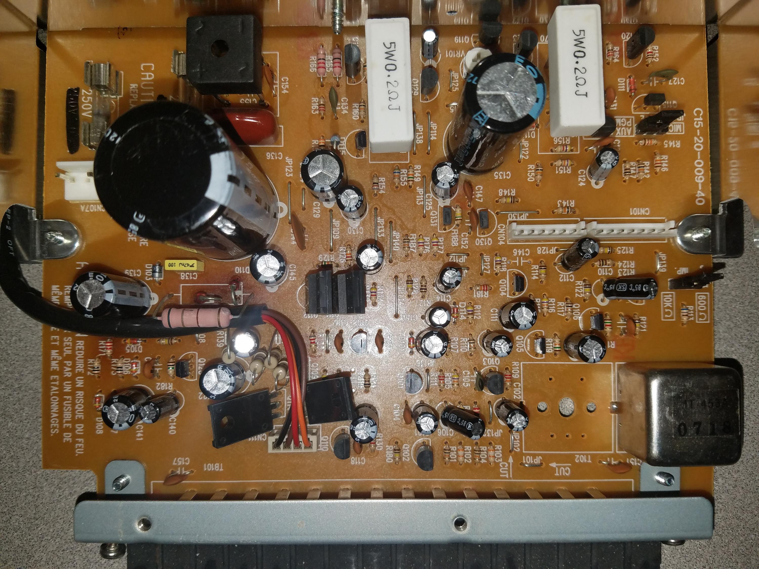

    On visual inspection of the board, the area around D109/D110/R179 has gotten hot and discolored the board, and I'm currently trying to trace how those might contribute to my problem.
    Do you guys have any ideas where I should troubleshoot?

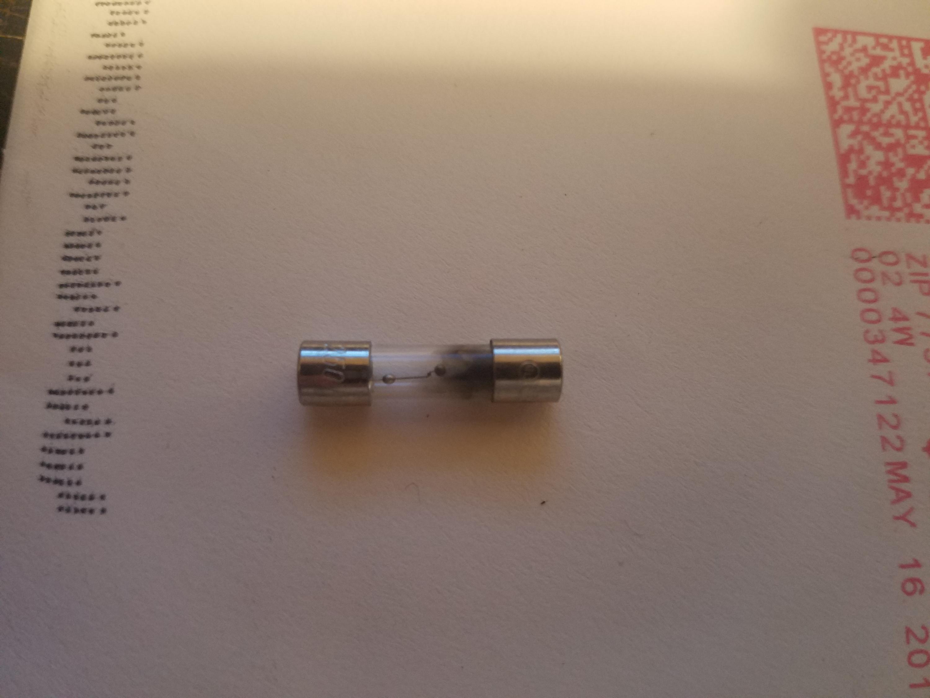

        Look at the blown fuse closely, if the fuse element looks like it is still there but broken open, it could just be fuse fatigue. Usually if there was a short the element will be totally missing and the glass will be black.

            the fuse itself actually appears blown, there's a bit of soot inside the glass.

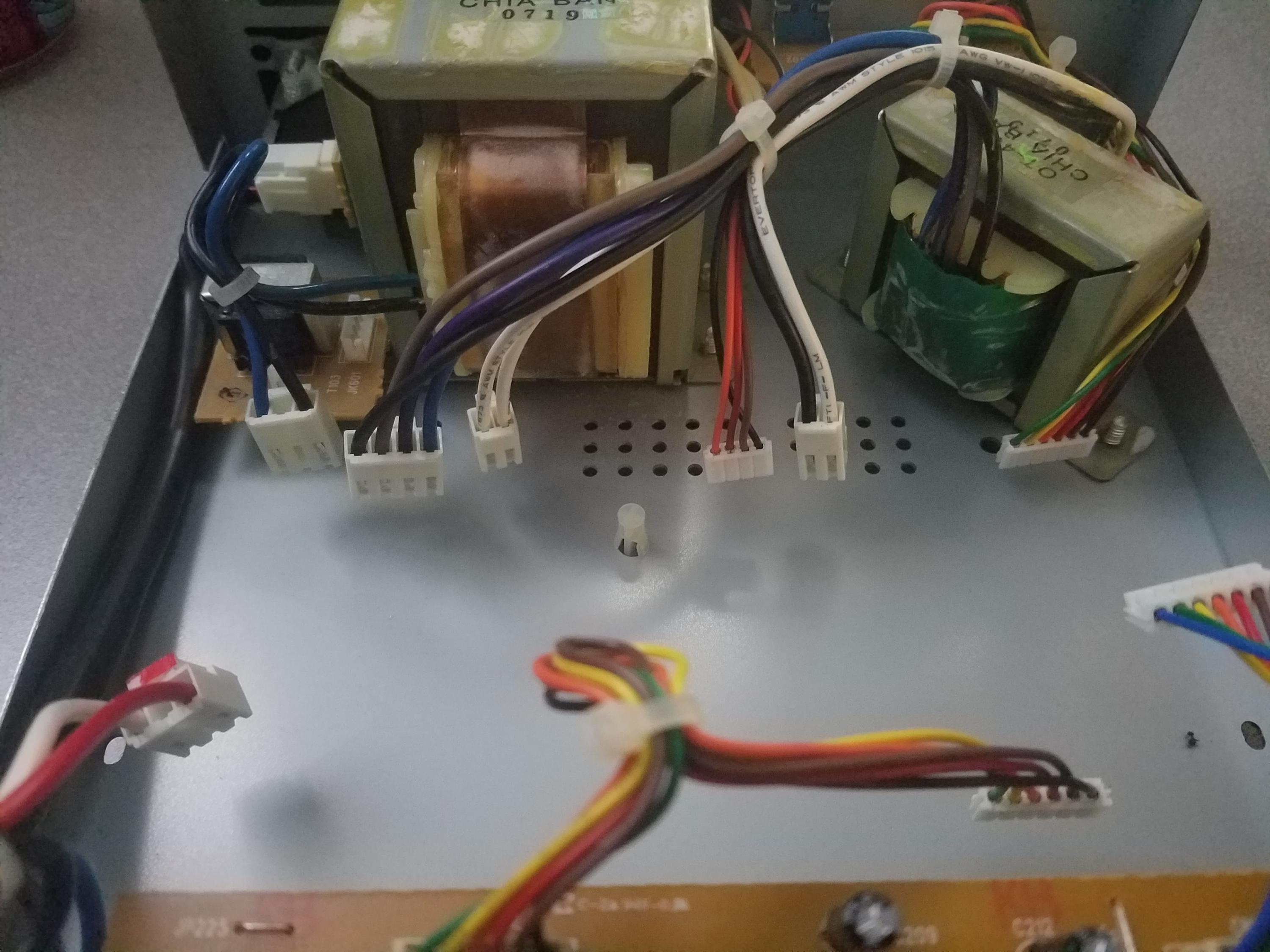

              Primaries on the main transformer read 8.8 ohm
              secondary on the main transformer read 1.7 ohm
              Replaced F101 , and it's blown as soon as power is applied.

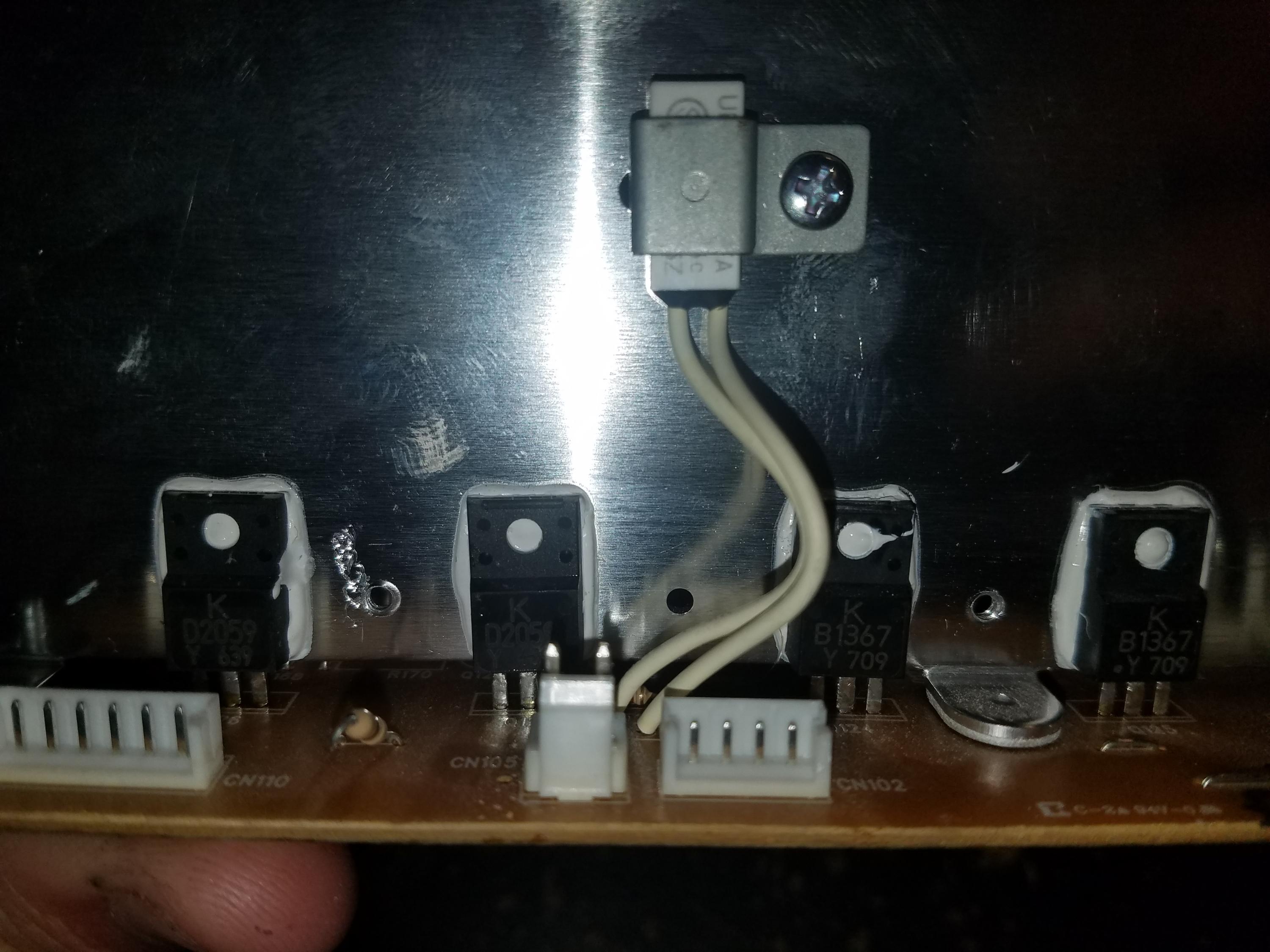

                        You could check the output transistors (looks like 4 of them) and see if they are ok

                              Look at the Output transistors...Yes the 4 on the big heatsink.....Each channel may have a complementary pair of NPN and PNP transistors.
                                Disclaimer: I've never been confident testing transistors with a multimeter
                                I've pulled all 4 transistors from the heatsink and board.
                                It looks like two complimentary pairs.
                                Facing the silkscreen on the front of the transistors, they are arranged like this
                                D2059 D2059 B1367 B1367
                                Not getting any shorts from any pins on each of the transistor, however, on "ohms" mode, I'm getting different values from the two B1367 transistors. I would have expected the two identical transistors to have identical results.

                                  If your multimeter is DMM then use the Diode scale to check the transistors. If you have analogue multimeter ( the one with the needle pointer) use the Rx1k scale. You would have to remove them from the circuit for testing, but you said you are not getting any shorts on the pins, so I'll say that is not the cause of blowing fuse. Getting similar readings from the identical transistors is correct to expect. Looking again at Post #1, I see there are two Transformers in this amplifier?

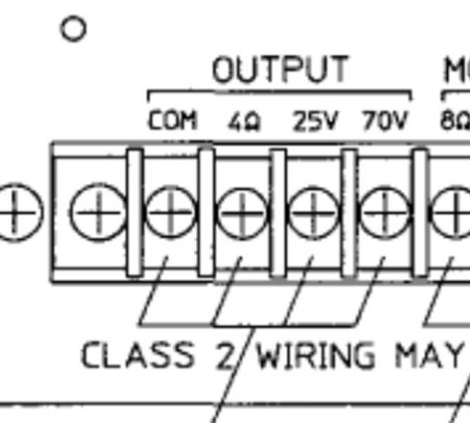

                                    There is two transformers, but the secondary transformer has multiple secondary windings and I'm honestly out of my element as to it's purpose.
                                    • fuxxy
                                      • Jan 2013
                                      • 318
                                      Re: TOA BG-130 Amplifier power supply fuse blown
                                      Looking at the board layout, it appears that all 4 output wires on the second transformer connect directly to the speaker output terminals of the amp, but at varying voltages.
                                      • R_J
                                        • Jun 2012
                                        • 9535
                                        That second output transformer is for driving multiple speakers that are a long way from the amp, like in a large store 25 volt or 75 volt line. the speakers would also have a small transformer on them with multiple taps.
                                        or if you want to connect just a speaker direct you would use the com and 4ohm
                                        I would think the outputs are fine.
                                        I wonder if d109 & d110 are maybe zeners and are bad, It looks like the voltage from the main cap. goes through r179 and is droped by the 2 diodes which seem to be connected in series.
