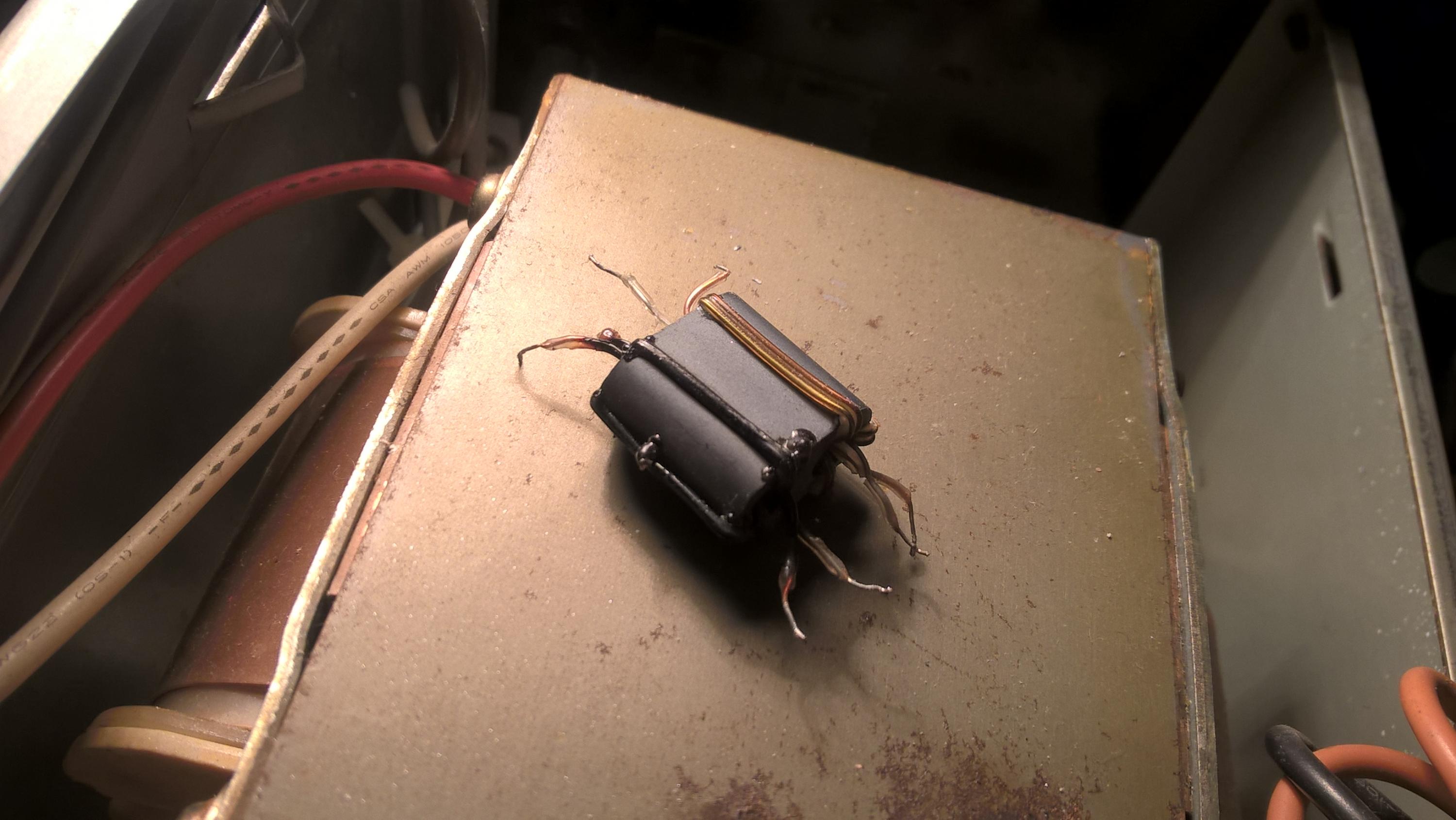

    Hi. I have perfect voltage everywhere, amp work, but if i turn volume from 0 to 1, relay turn off.
    If i disconnect input cable, and connect only speakers, and turn volume max, all is normal(relay doesn't turn off)
    If i disconnect all cables /output and input/ turn volume max all is normal (relay doesn't turn off)
    When i connect input cables and press 'PLAY'' button on cd player or tablet, relay turn off.
    I change input cable but without result. I have this problem in every input /tape1, tape2, aux, cd.../
    I check voltages on M5218 / M5238 - all normal. I check also idle adj. is 20mv, normal.
    Open relay and clean, all normal.
    Do you have any idea? ://

    There may be a error in the OUTPUT stages. Look for cold solder joints, open load resistor or weak capacitors. Of course test the pre-amp and output transistors, they might have become leaky due to aging.

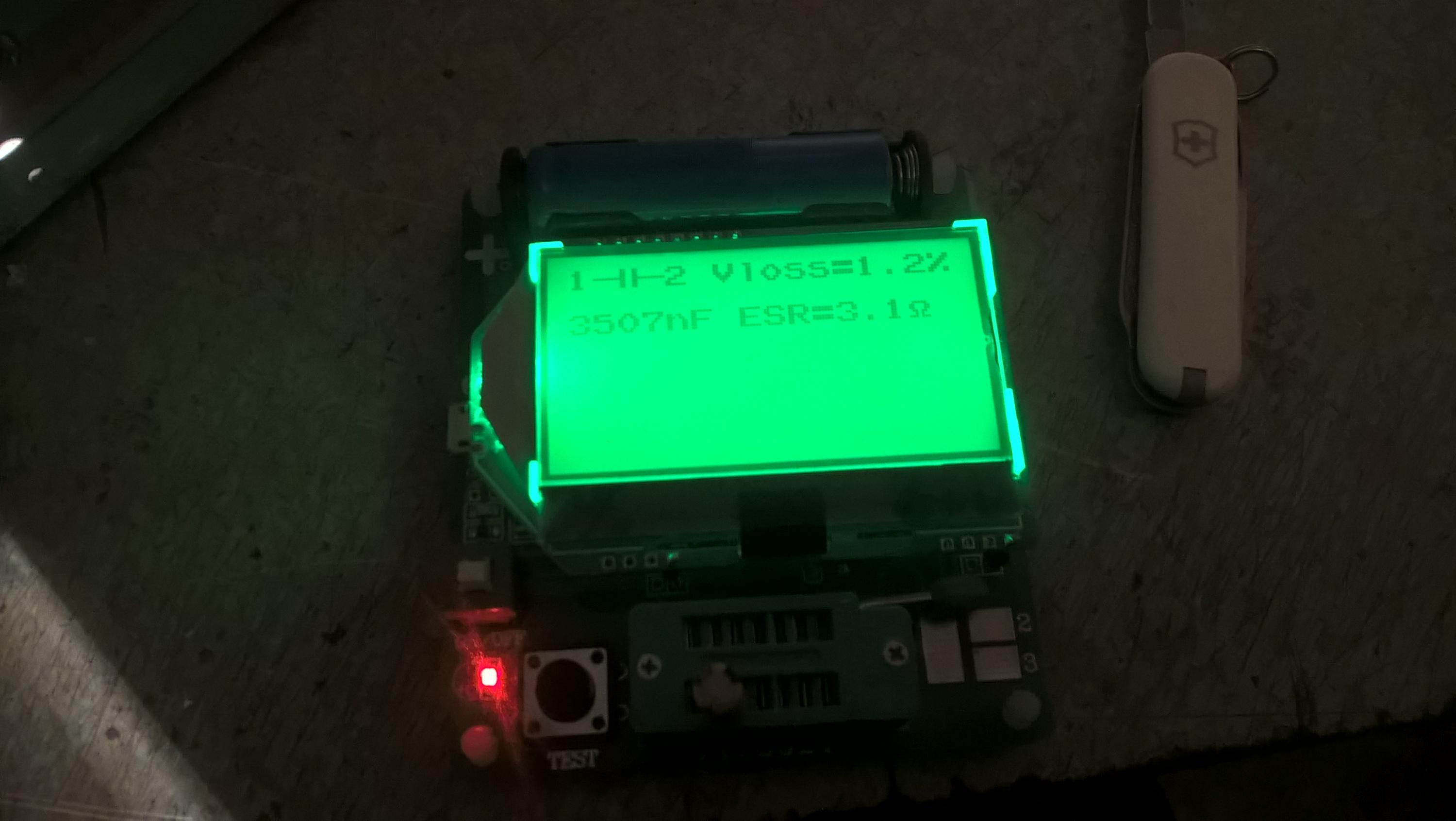

      I resolded all joints, I fuseable resistor checked /perfect/. I test some capacitors on input board with esr meter, but they are good.
        Re: Vintage Akai-52 /turn off when turn volume control/
        The speaker relays turn off?
        Try turning OFF the SOURCE DIRECT switch #2 as shown on page 4 and see what happen.

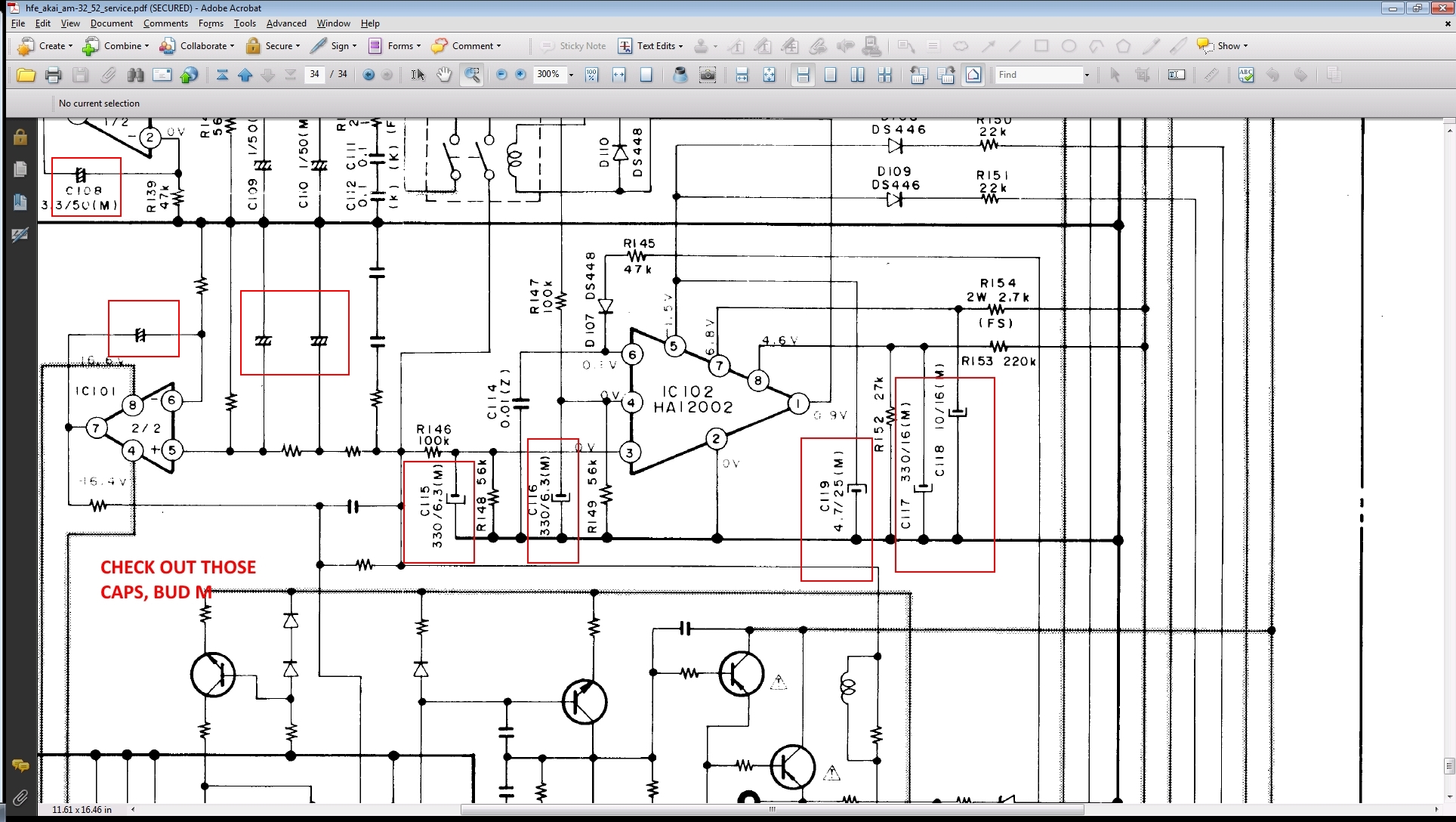

          C2 at IC1 should block DC from getting to the volume control.
          The protect-relay cap maybe open C115/C116 at IC102. This would make it trip with any "thump".
          Otherwise, since this is a DC-coupled power amp with a servo IC101, I would check C109/C108.

            I remove Source Direct, but no result. Check C115/C116/C108/C109, they are good. You can see what happen on my video.
              How about C119, C117, and as others as marked?

                In the video, IC102 trips when the volume is up.
                With BAL control I would see if it is L or R channel doing this or both.
                That looked like over-current trip as if shorted loudspeaker or open C113 (by TR112).

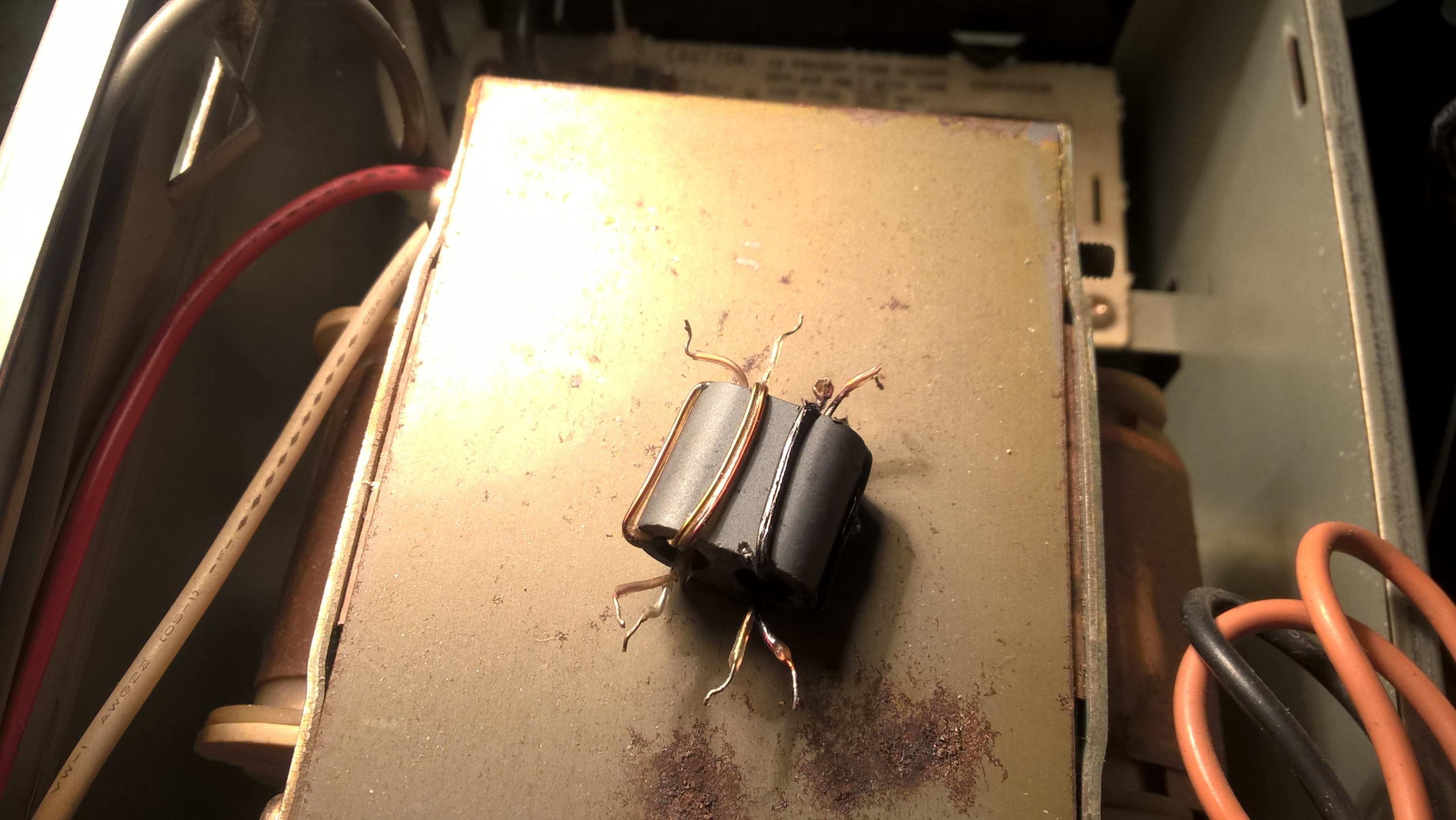

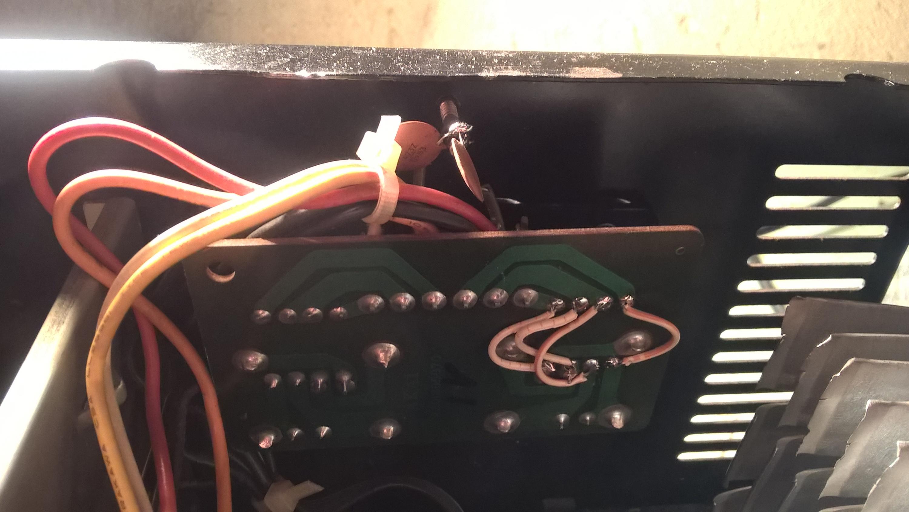

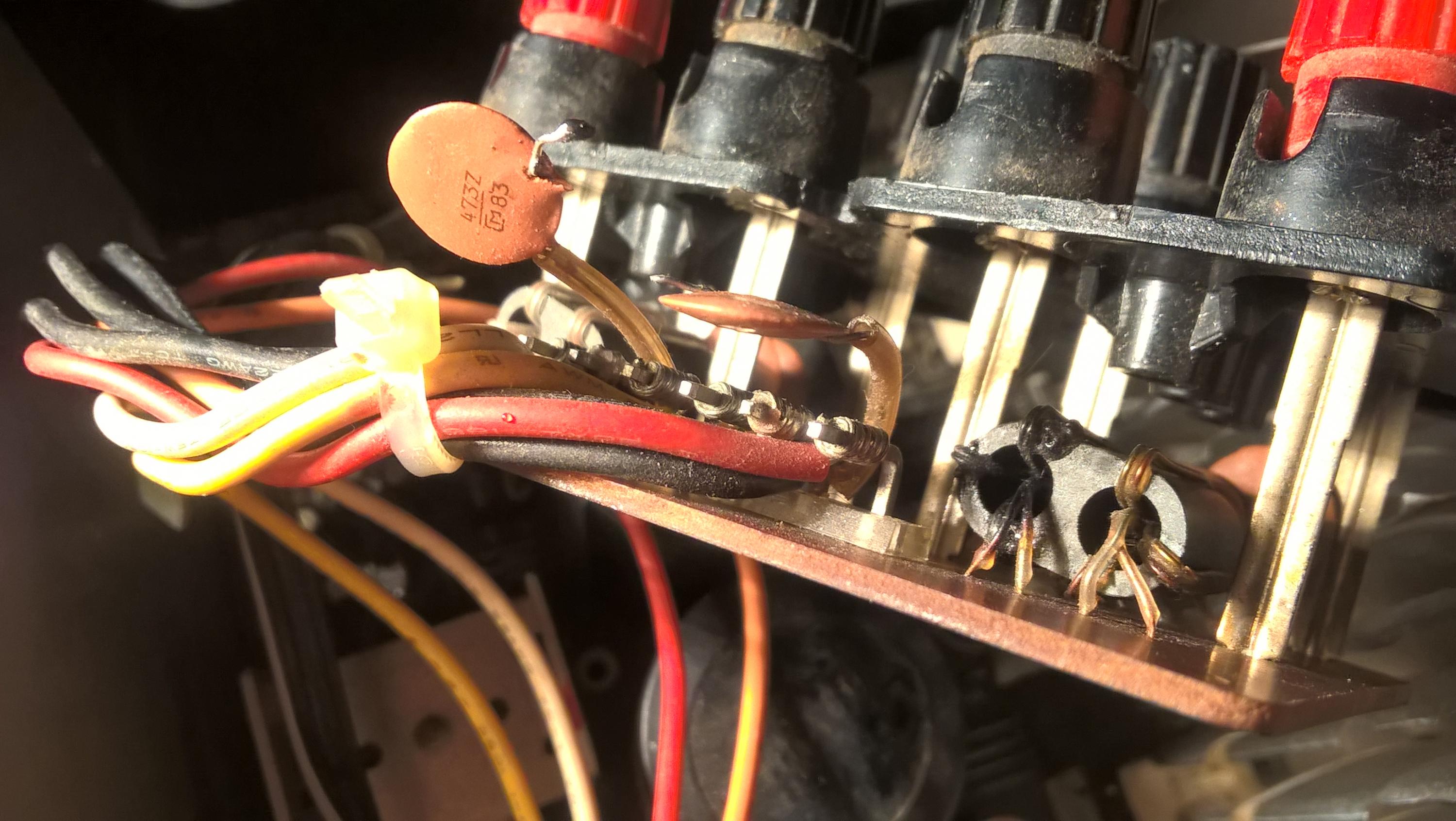

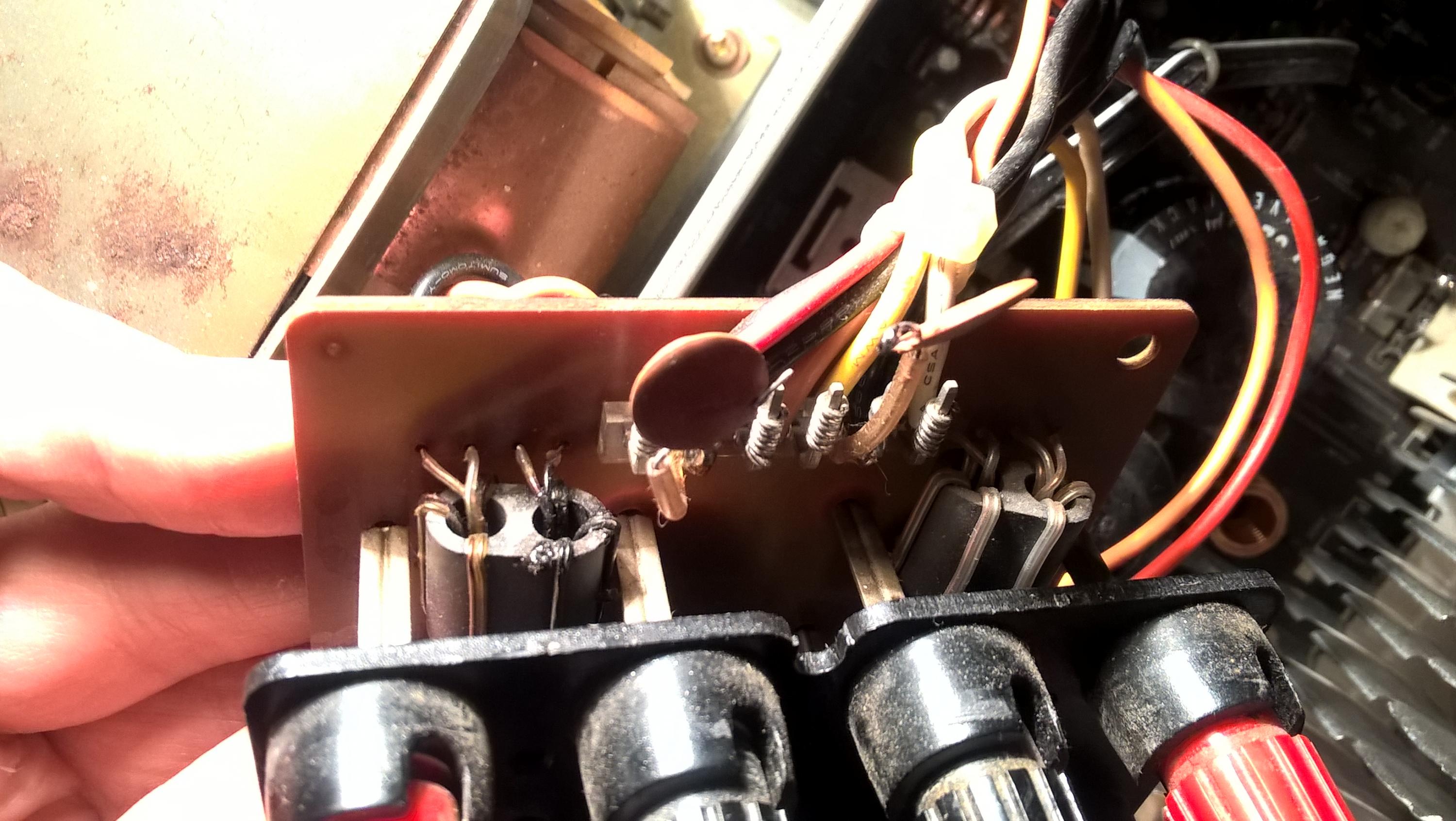

                  Hi. Thanks for reply. Amplifier work now!!! The problem was ... output wires short on the right chanel in amplifier. Do you have any idea how is possible to short this wires??? Every parts in this amp is perfect (c113 was perfect, tr112 also). Thanks all who reply in my topic.
                    Good find, but I did not expect you to get sound on both speakers unless it is not a dead short between speaker terminals. It looks like common mode choke to stop RF from coming in to the amp through the speaker outputs.
