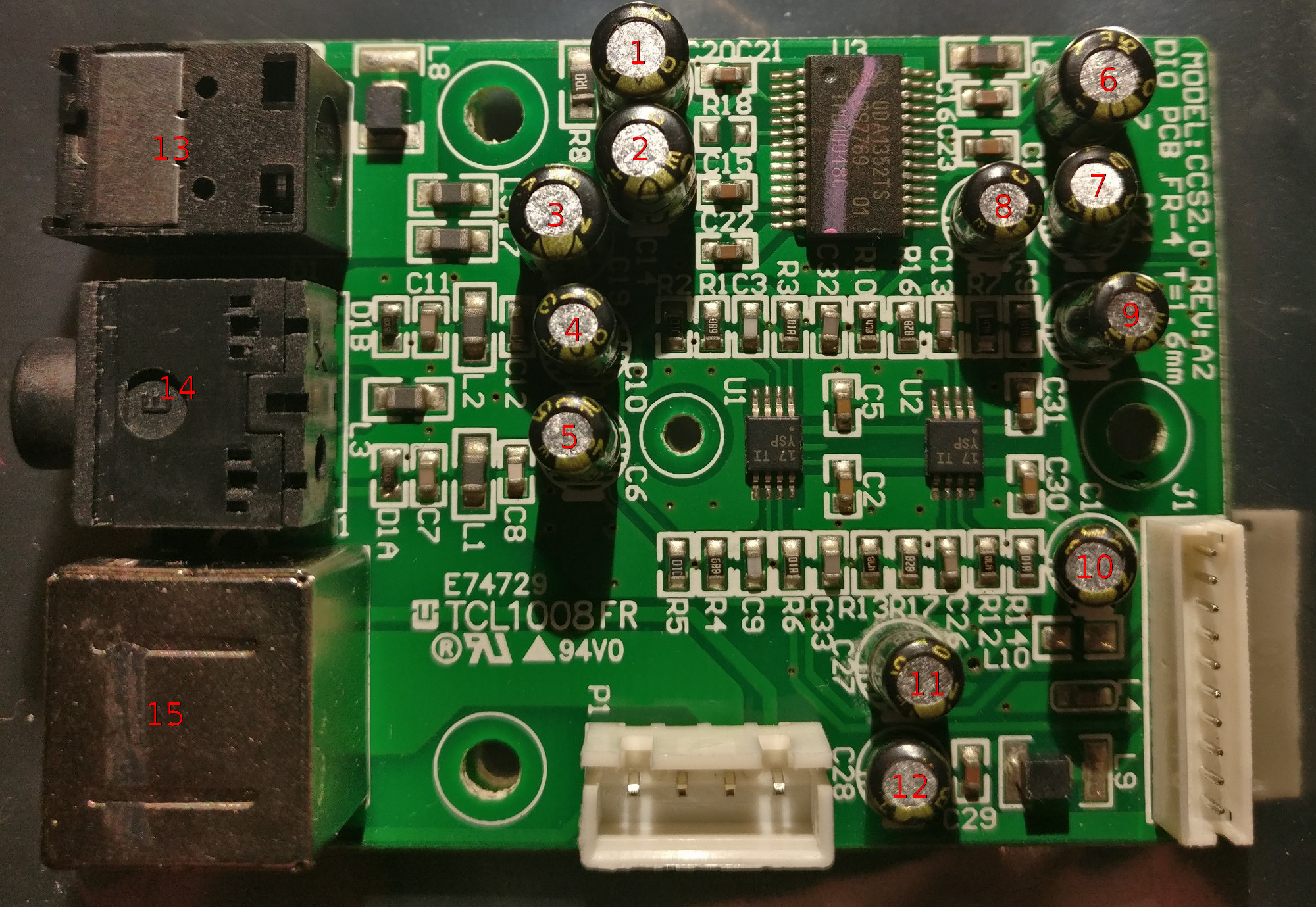

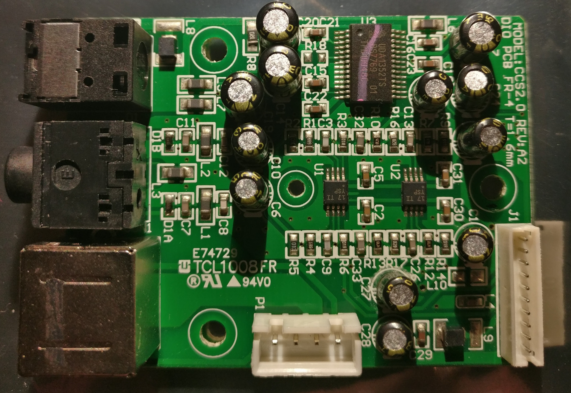

    I am looking for some expert opinion regarding the board in the pictures. The board comes from the right speaker of a stereo PC speaker set (Audyssey Lower East Side Media Speakers). There are two external audio inputs on the board: a 3.5 mm jack socket, and a S/PDIF optical. The two white connectors at the bottom and the right connect the board to the speaker box, which I am not able to disassemble any further. Both speakers have a tweeter and woofer. If input is connected using the 3.5 mm jack, then everything works fine. However if input is connected using the S/PDIF connector, only the woofers produce sound. Visually the only suspicious component I could find is capacitor 11 (using my labelling; marked as C27 on the board), which has some white residue around it. Any pointers how to get started fixing this?
    1. Decon 10 V; 100 uF; (M)105 °C
    2. Decon 10 V; 100 uF; (M)105 °C
    3. Decon 10 V; 100 uF; (M)105 °C
    4. Decon 35 V; 10 uF; (M)105 °C
    5. Decon 35 V; 10 uF; (M)105 °C
    6. Decon 10 V; 100 uF; (M)105 °C
    7. Decon 35 V; 10 uF; (M)105 °C
    8. Decon 35 V; 10 uF; (M)105 °C
    9. Decon 35 V; 10 uF; (M)105 °C
    10. Decon 35 V; 10 uF; (M)105 °C
    11. Decon 35 V; 10 uF; (M)105 °C
    12. Decon 35 V; 10 uF; (M)105 °C
    13. Audio in (S/PDIF optical)
    14. Audio in (3.5 mm jack)
    15. Power input

    Looks like the capacitors are all Decon SHA series. How does one pick replacements?
      Re: Audyssey Lower East Side Media Speakers
      DAC: UDA1352TS
      What is the Source for the SPDIF?
      Did you already try that SPDIF Source with other devices to see if it is OK?
      What kind of tools do you have?
        Thanks for the reply!
        A PC (with an integrated sound card).
        Yes, I tested it with two different PCs (and cables).
        Only a multimeter. However I might be able to get access to an oscilloscope at my uni. What do I need?
