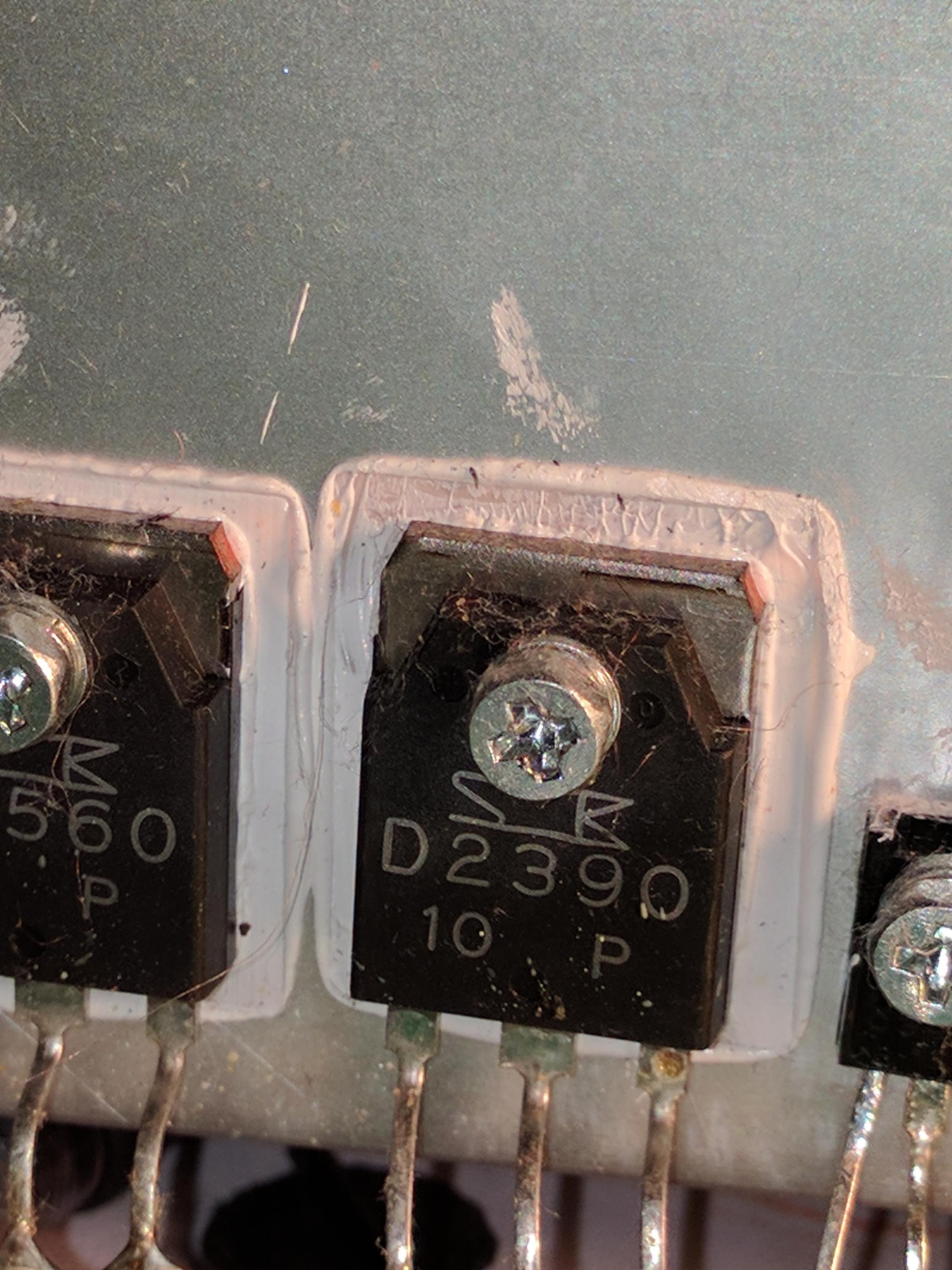

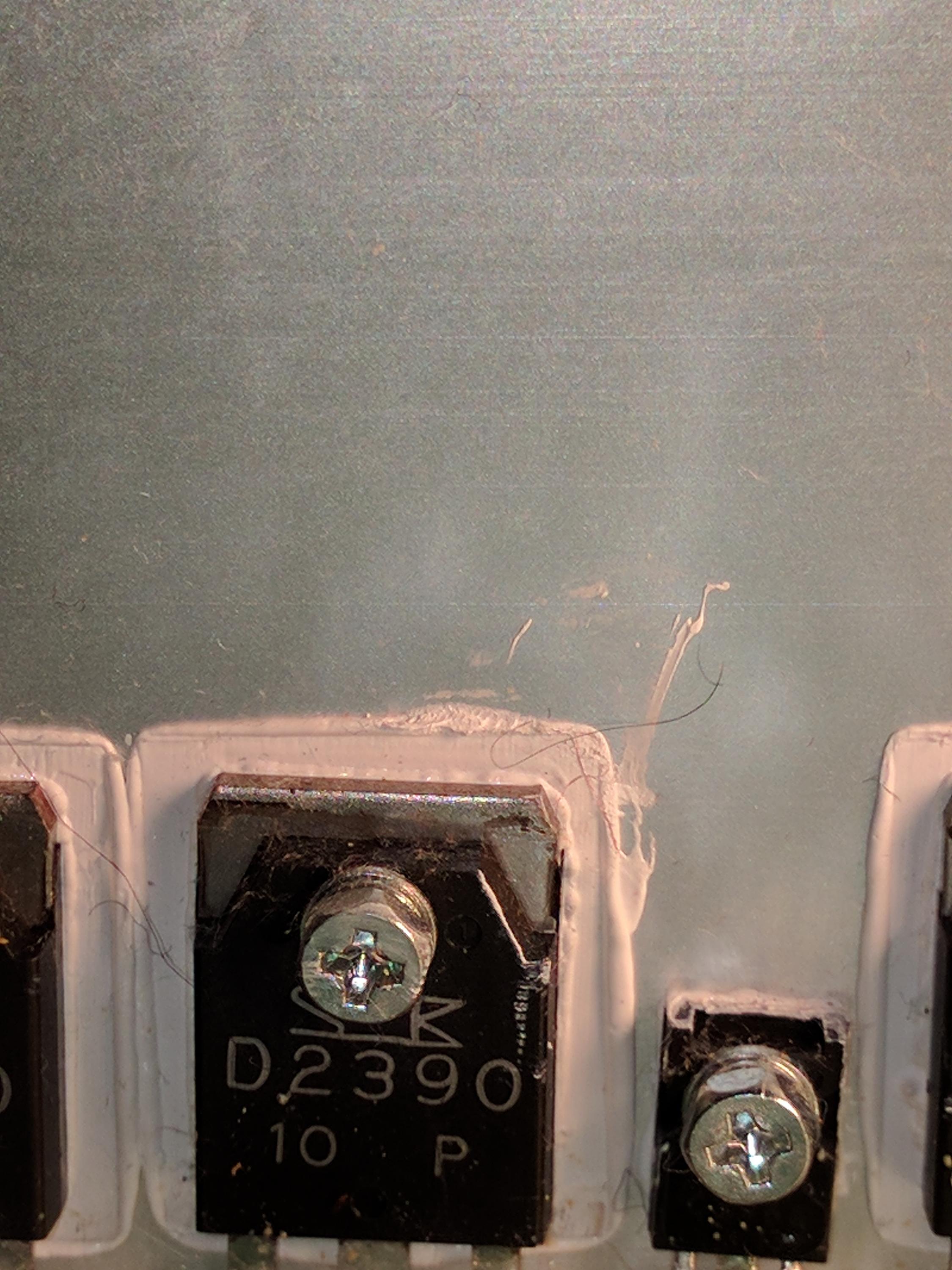

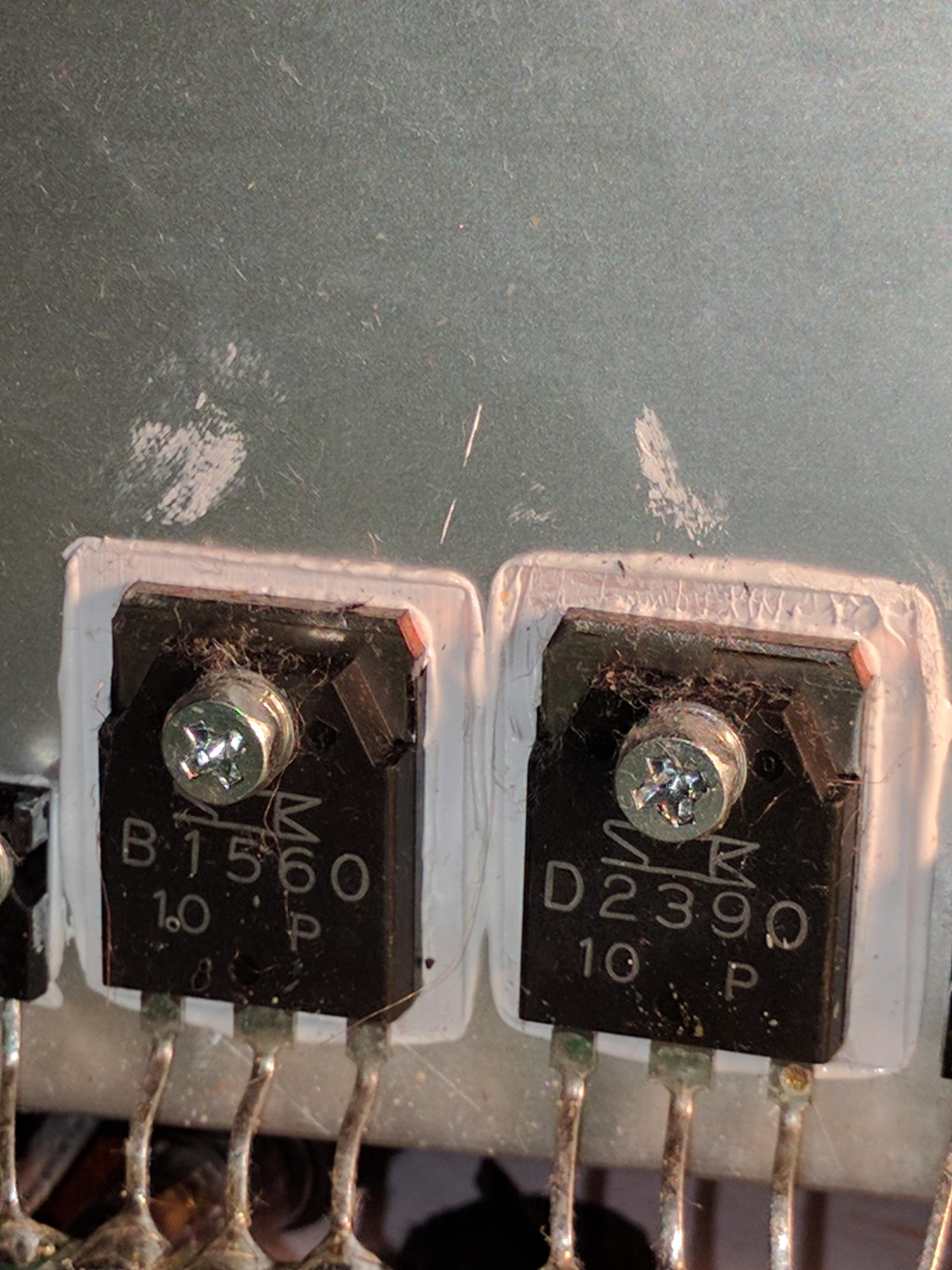

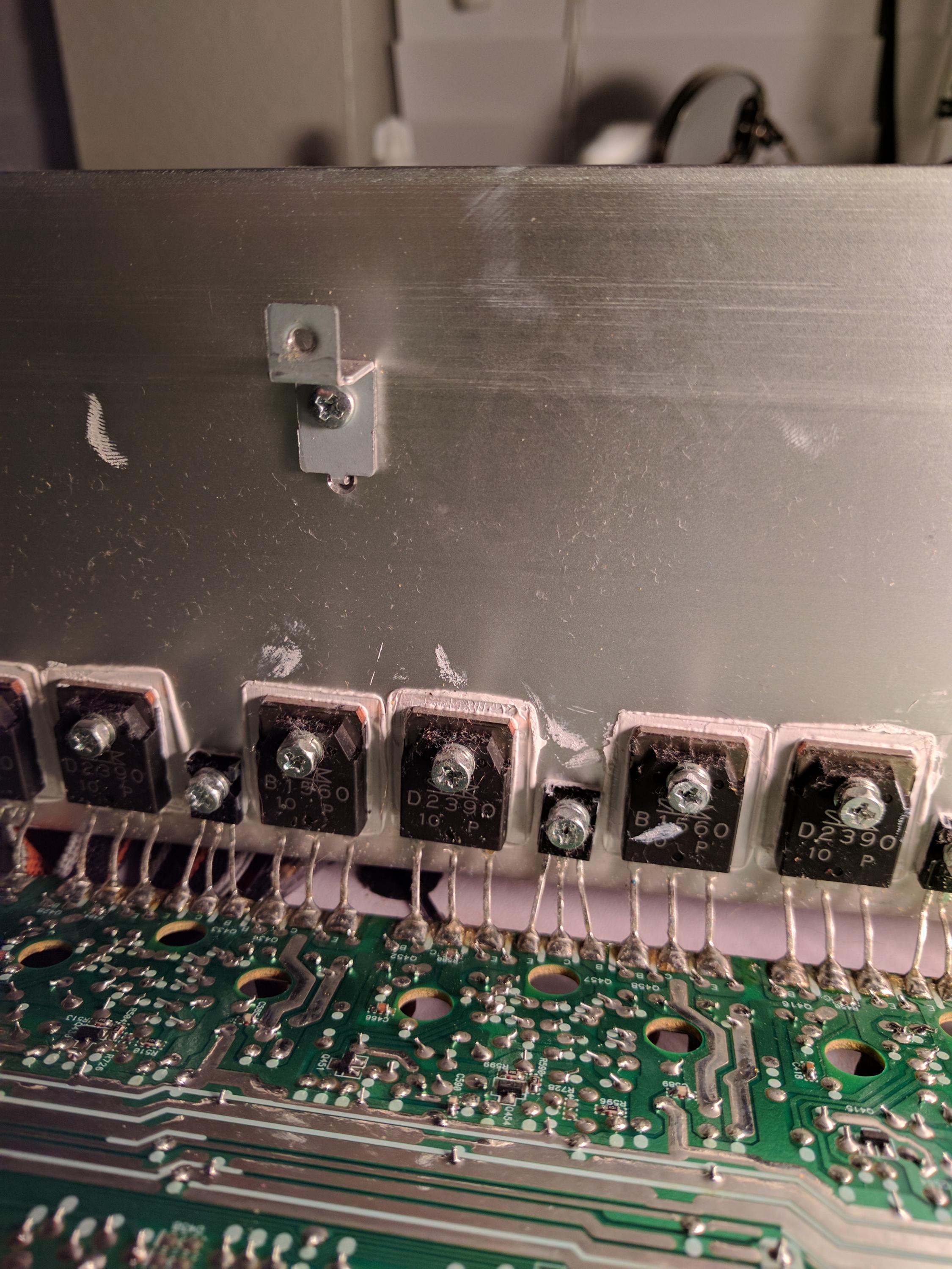

                  Thermistors checked fine. Looks like someone has been in this board before. Finger prints of thermal paste and gnarled heads on transistors. The dig gets deeper.

                    Re: Pioneer VSX-1021-k volume decreases 3db every few minutes
                    Pics of potential previous work. Gnarled Philips head slot and thermal paste finger prints...
                      Ok. Unscrewed the ones that looked to have been tampered with. Applied the correct amount of thermal paste and snugged it all back up. No change. Still dropping the volume 3db every 2 minutes. So I have a thermal issue. I rigged up a fan and then had it blow all over the board.... Same issue. volume still drops. My hand says no excessive heat coming from anywhere.
