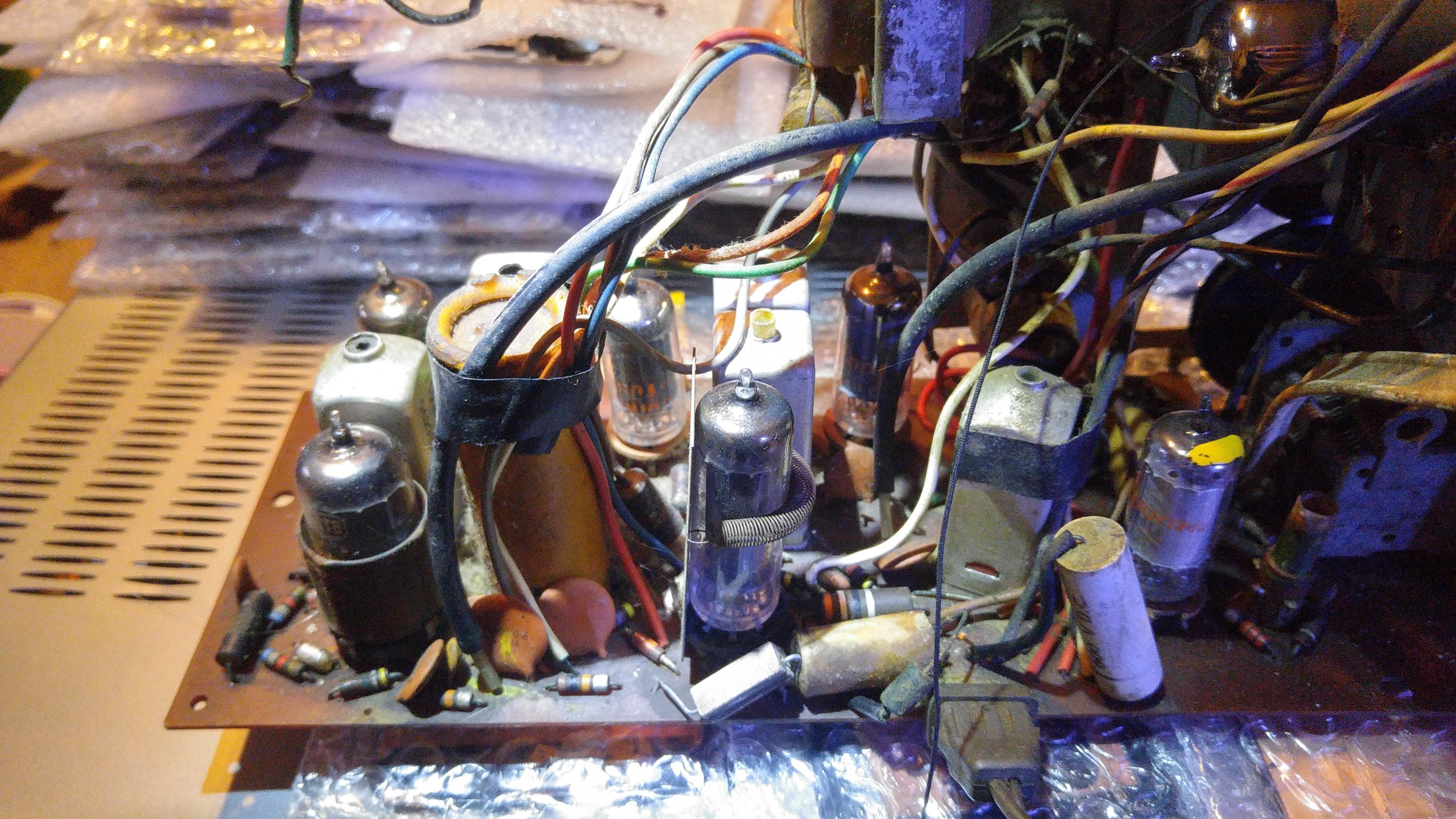

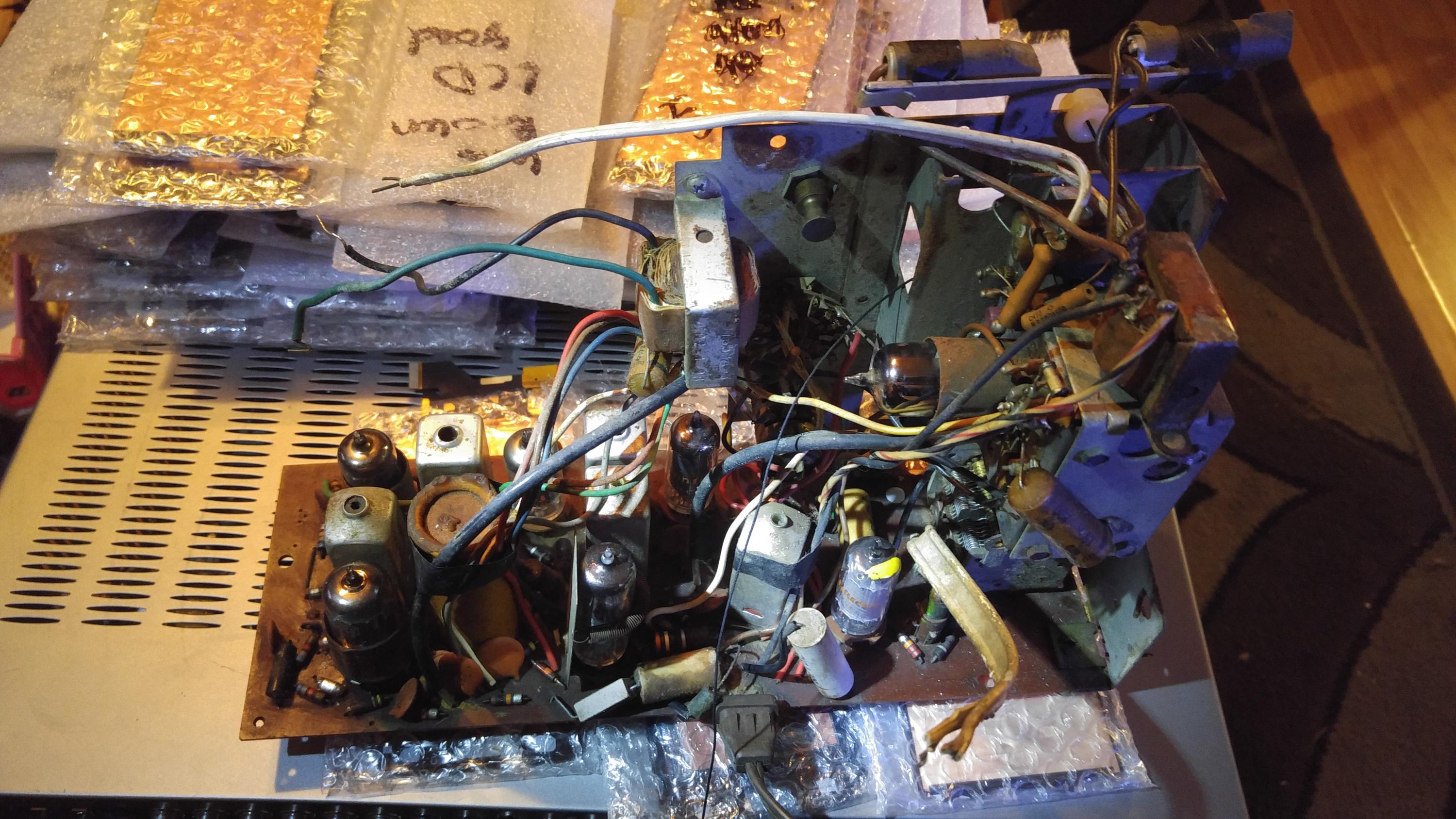

                40 Years old HUH?! I got an Old tube Radio I am trying to Restore. It works powers on all. But it sat outside in a pole barn for decades. So I have to clean everything up. Some things are going to have to be replaced would it be ok for me to pm you or something if I need any help?
                I love old tube radios! I want to make one that shows all the tubes and display them all over my house! I do not know why I am so obsessed with them I just fell in love one day!
