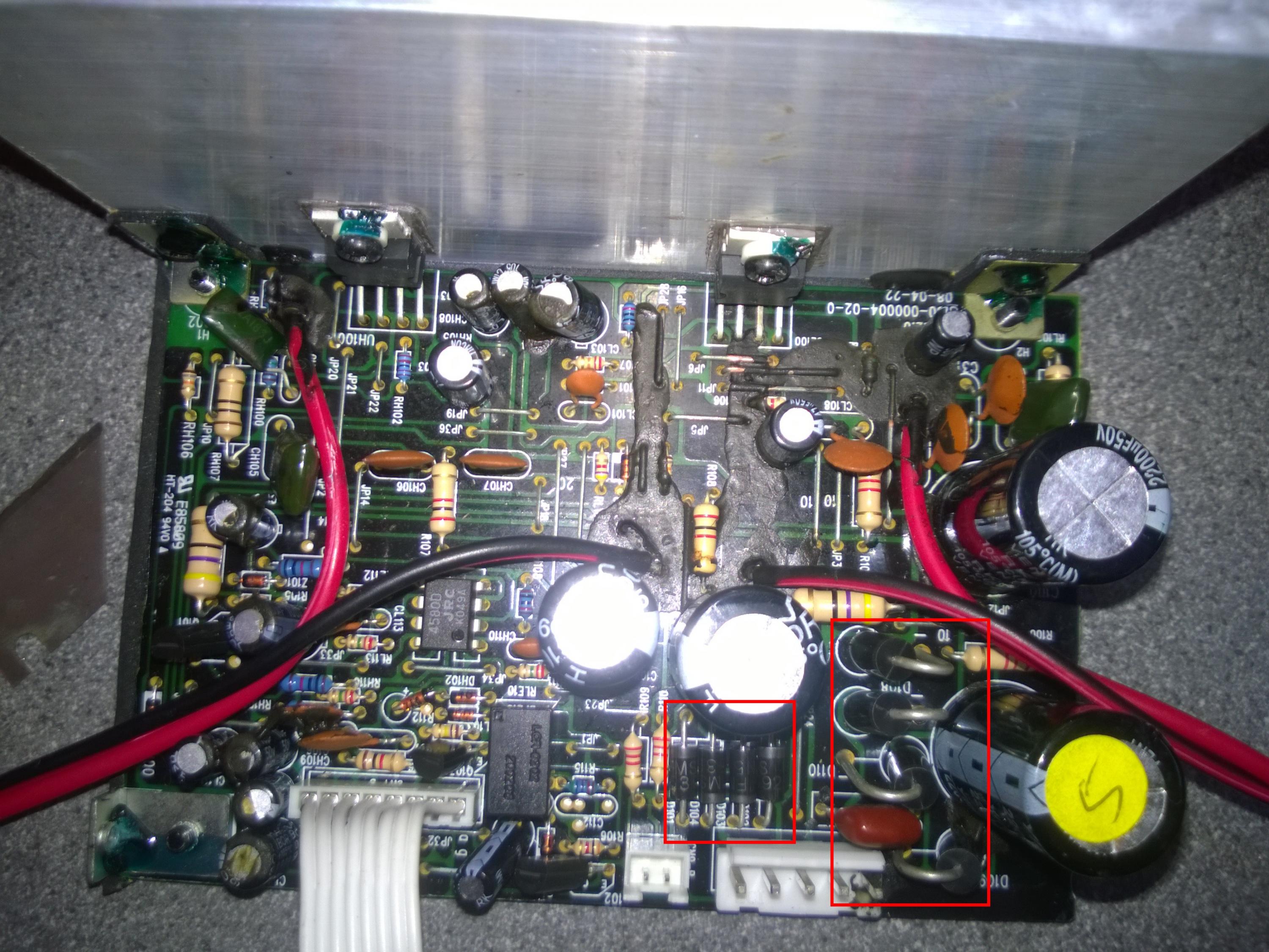

    Hello Guys and Gals,
    The powered speaker blows fuse as soon as its turned on, it makes a loud low frequency noise and then blows. Inside of speaker smells distinctly smoky.
    Looking inside the TDA2052 on the HF side looks like its had a lot of heat, thermal compound between IC and the heatsink has dried up.
    Anyone have experience with this particular model, any schematics around?
    There is quite a lot of black insulation compound used throughout the Mainboard and power PCB's, this looks like a black version of the regular white silicon stuff you get on PCB's to prevent arcing and movement of components.
    All the black gunk appears wet, small beads have formed all over it and when wiped they come off on a cotton bud and stain it brown.
    Doesn't smell good either, I read about a type of rubber that breaks down after time and produces butyric acid, butyric acid is supposed to smell like vomit and this stuff definitely has the same aroma.
    Anyone have experience with this stuff looking/going bad, I cant see any signs of water damage in the speaker and the droplets are on the black gunk only.
    thanks in advance

    Post some high resolution, straight shot pictures. First off you'd have to remove all that wet black gunk, whatever that is.

          Images as requested, let me know if you need any more
          Red lead on right side of board goes to the woofer and left side to the tweeter, the IC on the right which I assume to be dealing with HF because of its proximity to the HF feed is the one that looked burned.
          Some of the leads of the HF and LF IC's looked dry so I retouched them and reapplied thermal paste between IC's and heatsink. Tested with a new fuse and it still blows immediately.

                  Dont see any other boards that look like they provide power, nonetheless pics below of remaining parts of amp -
                  The only other power supply parts I can see are the transformer and the filter caps, I don't see any other power IC's anywhere that could be shorted.

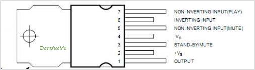

                      Check the resistance between pin 1 and pin 2, pin 1 and pin 4.

                        LF IC shows almost no resistance between Pin 1-2 and pin 1-4
                        HF IC shows about 700ohm resistance 1-2 and open on pin 1-4

                          Do the four diodes by the large capacitor with the yellow top on test ok?
                            Re: Rokit 5 Powered Speakers - Blowing Fuses
                            You have two sets of bridge rectifiers setup.
                            BTW, does the fuse still blow if the secondary side of the transformer (RED/YELLOW/BLACK wires) not connected to the board?
                            The TDA with 700 Ohms reading is not right, remove it and test it off the board.
                              High Frequency TDA -
                              Pin 1-2 - 660 OHM
                              Pin 1-4 588 OHM
                              Low frequency TDA -
                              Pin 1-2 - 21 OHM
                              Pin 1-4 - 3 OHM
                              I will remove from board and retest.
                              What should I be seeing between the pins if the IC is good?
                                It should show high resistance:
                                This one is bad for sure.
                                Low frequency TDA -
                                Pin 1-2 - 21 OHM
                                Pin 1-4 - 3 OHM
                                The measurement are for the Upper and Lower power transistors' Emitter-Collector junction inside the IC.
                                BTW, it was confusing when you have indicated "LF IC shows almost no resistance between Pin 1-2 and pin 1-4".
