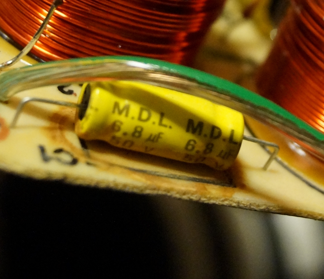

    HI, Ive got a speaker hear that sounds different than the other identicle speakers. It sounds muddy in comparison. Had a look all all tweeters and drivers seem to be functioning fine, so thinking maybe the crossover.
    There is residue all over the board which I assumed was electrolytic from one of the caps. Have removed and tested them all and all are testing ok but cant think of anything else and wouldn't be the first time a cap tested ok but wasn't so might aswell just change them as there are only 5 of them.

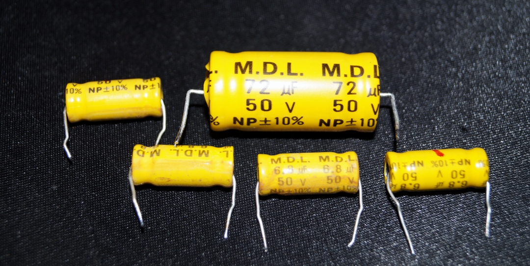

    Speaker is a Jamo L7 Sur
    Caps are all NP caps
    3 x M.D.L. 6.8uf 50v NP
    1 x M.D.L. 10uf 50v NP
    1 x M.D.L. 72uf 50v NP
    Not really sure what to replace with?

        I had the same thing with my Sansui's. Old capacitors sounded muddy and smeared. I replaced them with Solen from here http://www.parts-express.com/cat/met...capacitors/294 .

          Originally posted by stj
          good crossovers generally use plastic caps, not electrolytics
          Any idea what the ones in mine are? Anyway I can check

                • 31218
                Re: Ideal caps for crossover?
                NP = non-polarised electrolytic
                junk, but MUCH cheaper than film caps

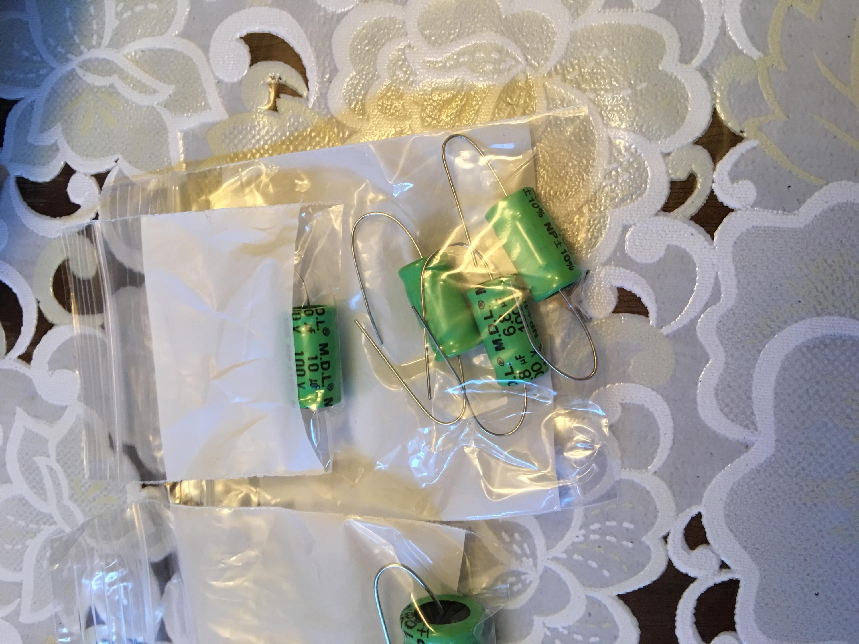

                • mikay786
                  • Aug 2014
                  • 765
                  Yea the films caps are a bit too pricy for value of speaker. Ive gone for some jentzen non polarized electrolytic caps. See how it goes.

                        • mikay786
                          • Aug 2014
                          • 765
                          http://www.hificollective.co.uk/comp...apacitors.html
                          Images of the caps looked to be the same ones as the ones that need replacing, so maybe a better match. Are jentzen the same company as mdl?

                                  • mikay786
                                    • Aug 2014
                                    • 765
                                    New caps here and the are m.d.l. Branded so thanks for the jentzen tip rhomanski.
                                    So jentzen make these caps
