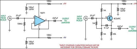

          Re: Help making pre-amp kit work with turntable
          It will have to be a preamp for ceramic phono cartridges. They don't appear to be as common as those for magnetic cartridges but you can NOT use one for a mag with a ceramic, the ceramic high output will overdrive the input all to hell.
          There are circuit diagrams on the web if you want to build one. They aren't complicated.

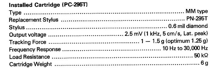

                            Thanks fzabkar for all that. I was under the impression it was a ceramic cartridge thus confused why if such a cartridge works at line level that the audio out was faint.
                            Found out it does in fact use a magnetic type

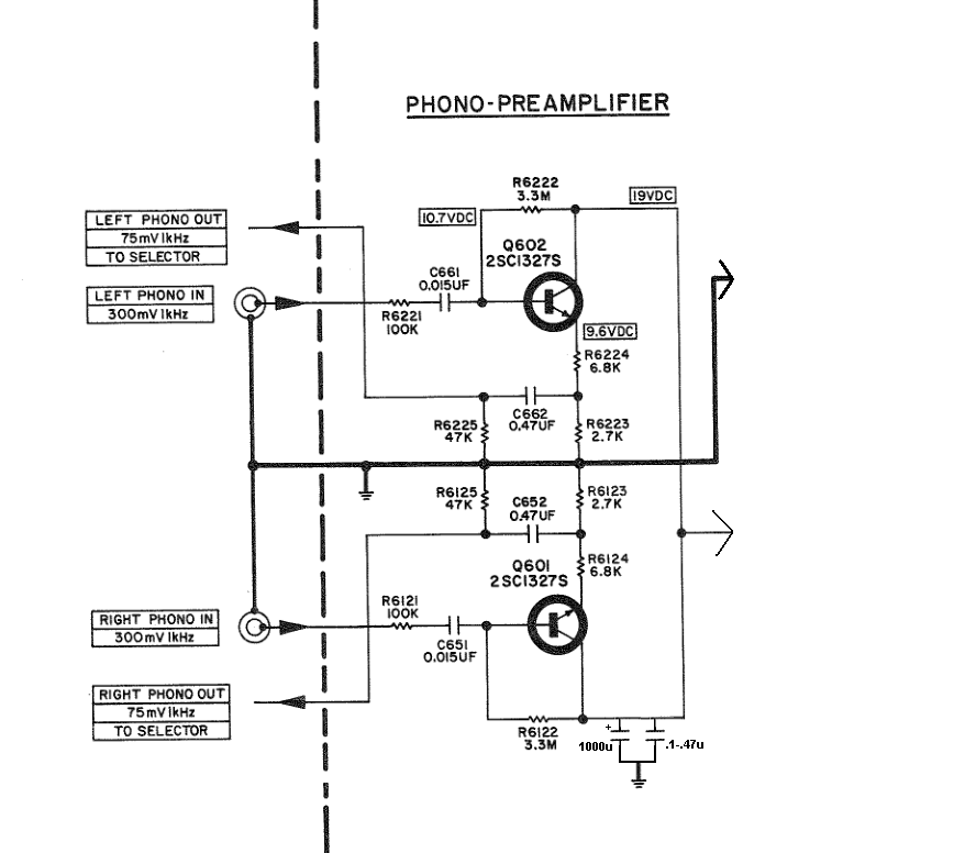

                                Originally posted by fzabkar
                                AIUI, a ceramic cartridge can directly drive a regular line input
                                They can not.
                                A ceramic cart appears to the signal as a high series XC. If loaded with anything within the ballpark impedance of typical line inputs (10K-47k), that series reactance/capacitance forms a C-R hipass filter. Bass response is severly reduced.
                                Ceramic carts need to be loaded a high impedance, on the order of 470K or more. What's required is an impedance matching preamp- a Hi-Z to Lo-Z buffer.
                                Even the typical circuit from the 70's will do. I've attached part of the schematic from a Sanyo/Fisher 4080. Notice I've added two caps and lines to an external power supply for "stand-alone" use." Use modern devices for the transistors- KSC/2SC1815, KSC945, or even 2SC2240. The 3.3M bias resistors may need to be changed to suit substitute transistors- you want approx 1/2 B+ from the emitters to GND. If the output level is too low, connect the 0.47u coupling caps directly to the emitters instead of the junction of the 6.8K and 2.7K resistors. This will increase the output level to 275mV.
