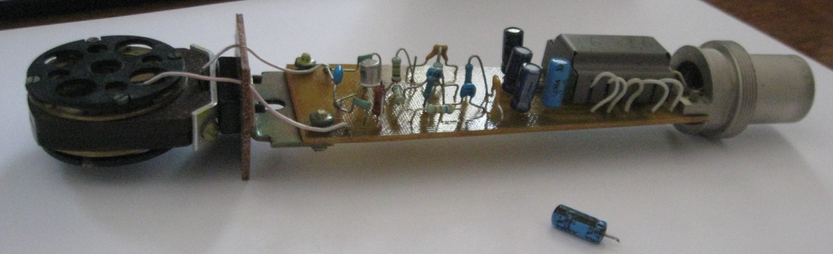

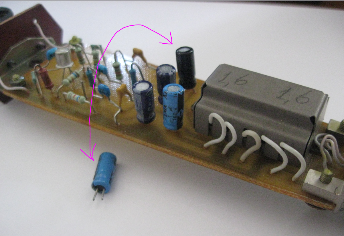

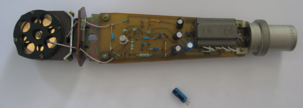

    Yesterday I turned on my condenser mic Oktava 219A, but there was no sound. This mic served me from ~2001. It was a surprise for me.
    I disassembled it. One of 1uF caps looked a little bit like extra fat, so I replaced it, but it didn't help.
    Please could you advice my next steps.
    May be buy and replace all the caps?

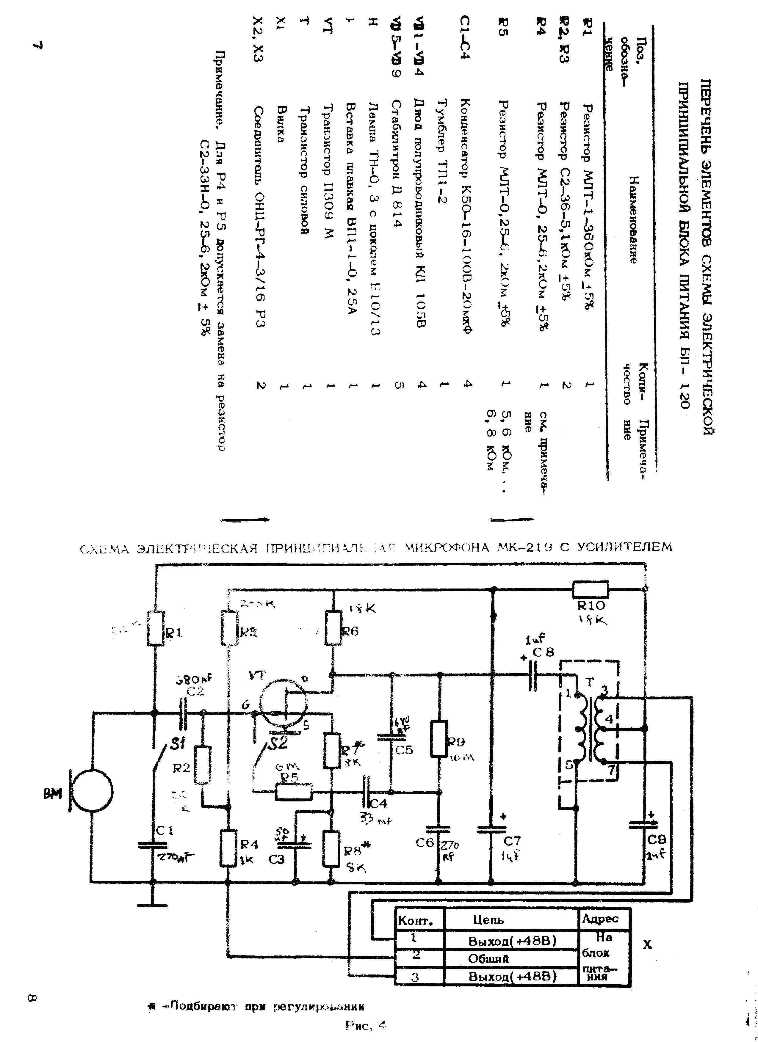

    For what it's worth, i've managed to track down the schematic, as well as some circuit descriptions / upgrades:
    http://www.recordingmag.com/download...schematic2.jpg
    http://www.recordingmag.com/resource...etail/316.html
    The schematic has some voltage readings at several points - you might want to start by checking if voltages in your microphone are anywhere near those values.

          Khron666, thank you for direction. However this schematic is different because number of resistors and condensers differ.
          I measured voltages:
          1.7v instead of 6.8v on C3 (47uF).
          3.4v and 0v on FET instead of 2.1v and 22v.
          Because schematics differ I could not find point of 0.8v to measure.
          So, that's all what we have now.

                      PS: I think i might've found the original(?) schematic, as well: http://www.sdiy.org/oid/mics/Oktava-MK219.gif
                      That JFET symbol looks like it has its case grounded, i believe?

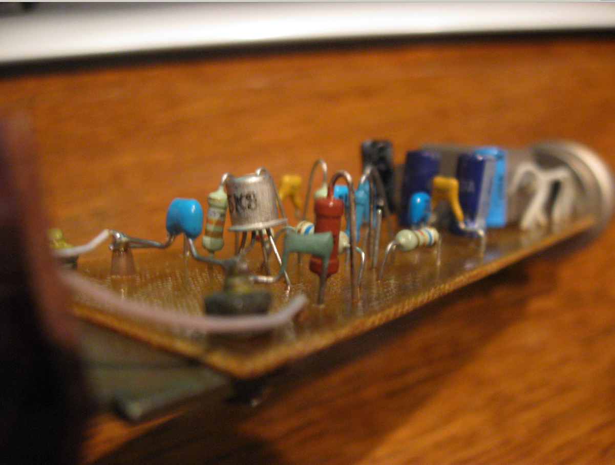

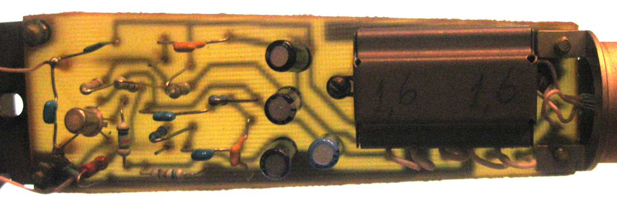

                            It's right in the description: "Revision 2: This layout uses plastic standoffs to which the capsule wire, C2, and the FET are soldered. This results in lower noise and less trouble with flux contamination."
                            Hint: read the last sentence there
                            It's a pretty safe bet that the leg that goes between the blue capacitor and that thin "tall" resistor is the gate of the JFET (like in the schematics).
                            https://www.badcaps.net/forum/attach...2&d=1442664256
                            The lowest leg of the JFET, in this picture, seems to go to a trace that goes straight to the ground "plane". The drain would most likely be the top leg, and the source is the one that's left. Simple and logical

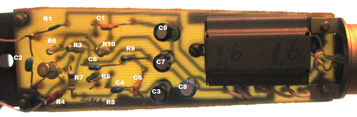

                            How certain are you that the C9 you replaced was good? You CAN use a larger value capacitor as well, as long as it physically fits. It's there to filter the voltage coming from the phantom power supply, so really, "bigger is better" 47u/63v capacitors are usually in 6.3mm diameter / 11mm tall cans, same height as the originals (which look like 5mm / 11mm).
                            EDIT: I'm attaching a photo with my suspected part names, according to the old (russian) schematic, and from what i could try to see, regarding the traces, through the board. Feel free to correct those, and i hope it helps

                              I thought that those 2 little things you marked as R1 and R2 are condensers . I've measured it's impedance - it's more then 2000k Ohms, article proves they has to be that big (1000M (1G) resistor).
                              Saying this - I must admit that you were right point me to this schematics:
                              Here are 2 more photos - one of them with back light in order to see traces (and all 4 legs of FET are seen clearly).
                              What about FET legs - that 4th leg was ground! . Is it necessary? Can I use 3-leg FET and not solder ground?

                                A-haaaa! So i was indeed right - the old russian schematic showed the JFET's case as grounded, as i "decoded" it
                                I've gotta get ready for rehearsals, but i'll get back to this later tonight, and "re-annotate" this better-lit circuit.

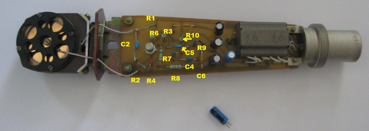

                                    Well, i think i've managed to figure out which component's name is which I hope this, and the article i linked above, will help.
                                    C9 and C7 can easily have greater values, that's only going to help. C9 should be rated for (at least) 63v, although 50v might be enough. C7, for safety, should be 50v. Value-wise, as big as you have available, anything up to 47uF should be good
                                    If you have one, and it fits, you could swap C8 for a film capacitor (worst case, you could tack it on, on the solder side of the board, maybe with a bit of double-sided tape).
                                    But first of all, change C9, because it sounds like that might (still) be the cause of the problem. Then see how your voltage readings look.

                                        The quest if over! The mic is working now.
                                        Thank you once again, Khron and all the guys who shared their thoughts to help me.
                                        All 4 electrolytic caps were bought yesterday on local market. And today I started to replace them. First of all I replaced C9 (once again:-D) and C7. And it helped! Then I replaced other 2 caps just for the case.
                                        BTW, when I turned my mic ON without the case (which acts as a shield) there was a VERY loud hum (50Hz I suppose), much louder then my voice. Though I didn't touch ground while holding it. When I touched pre-amp case - the hum level became lower and I could hear myself a little. When I assembled the case around my mic - that terrible hum disappeared completely.
                                        I'd like to replace JFET also (if it will improve the sound), but the Toshiba 2SK170BL has 3 legs and I'm not sure if it will work without ground leg.
                                        What about capsule - it's rather dusty. I'd happily clean it, if there is a correct way to do it.
