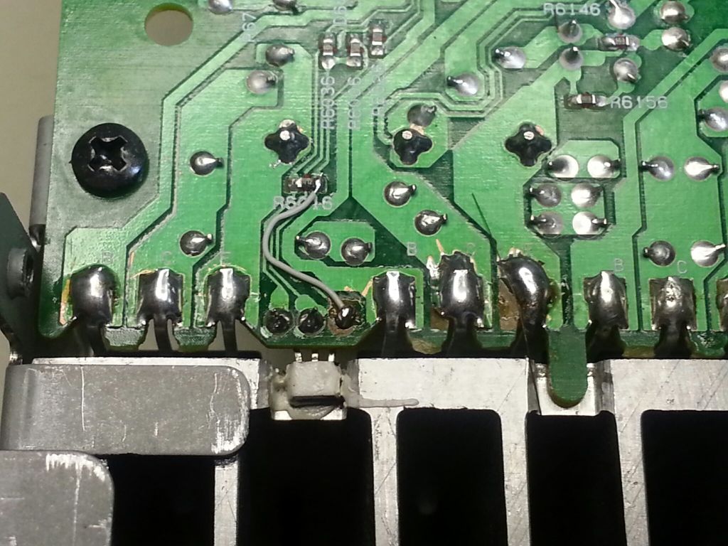

    Ok looking for a little help with this one I picked up another TX-NR609 off of eBay knowing it had a bad HDMI board.
    So I get the unit plug it in to test it out a bam it blows the SBR channel and I mean with a POP.
    So I take the unit apart and replace the blown output Transistor and the few resistors that have blown. Put the unit back together and get ready to adjust the idling current.
    I start to adjust the idling current and BAM blows the new out Transistors and now the 2SC5171 transistor also blows.
    So once again I replace the parts that have blown and recheck everything again to see if I have missed anything. Everything looks goods.
    Put the unit back together plug it in and I have the meter on the SBR channel as soon and I turn the unit on I see the meter start to climb so I let it run for a few seconds and then shut it down I notice that the SBR Transistor are starting to get HOT. What do you think I am missing?

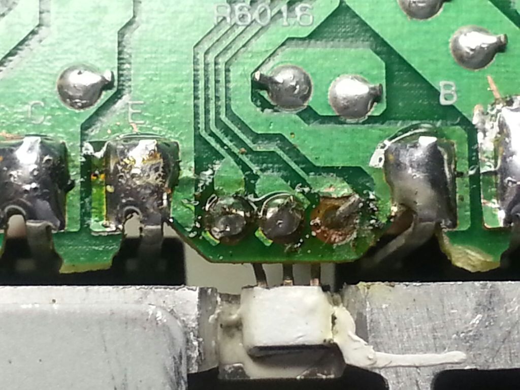

                  Re: Onkyo TX-NR609 Blown output {FIXED}
                  Ok after several hours of trying to fix this I have it fixed and here is what the problem was.
                  The pad that connected to the base of Q6006 had broken from the trace.
                  After checking and rechecking everything for the 5th time I decide I was going to replace the Q6006 transistor.
                  Once I applied the iron with some solder wick to the base pin to remove the solder BAMN there was the problem all along the pad and trace had cracked apart. You would have never seen it without removing the solder.
                  So three sets of Output transistors and several hours of trouble shooting and I have it fixed ready to go back to Onkyo for the HDMI board replacement. WOOHOO
                  So in the end I had about $10 in parts for the repair and about $1000 in labor hours HAHAHA but it was worth it not to be beat! I knew I was missing something simple well simple now in hindsight of finding it.
                  Here are some pics of the pad and the repair.
