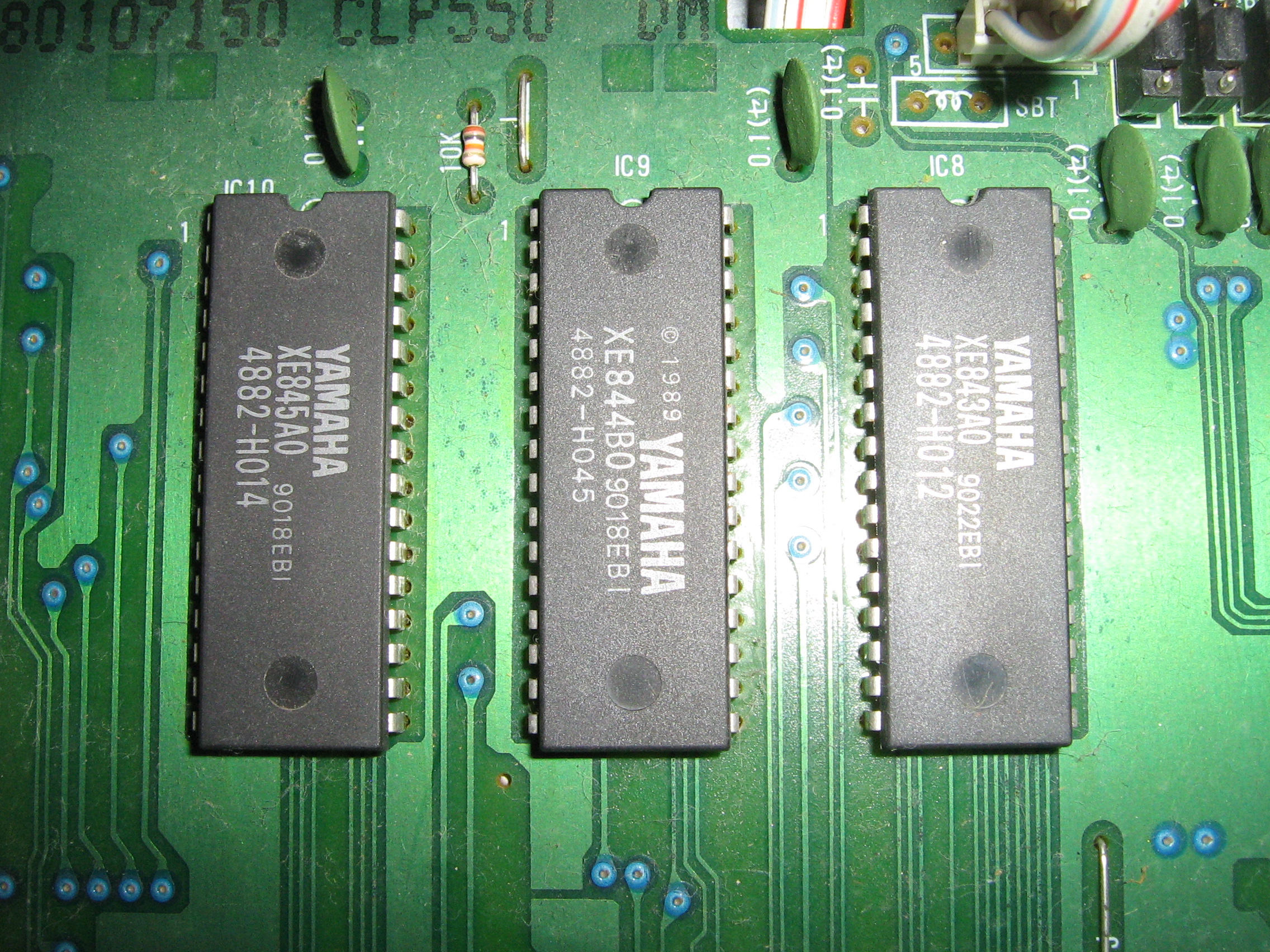

    o.k. yammy are full of shit.
    the roms are toshiba tc534000
    these are pin compatable with 27c040 eproms and 29f040 flash chips.
    both worth about 2-3 euro/pound/dollar each.
    now we just need to find some romdumps on the net to program a set.

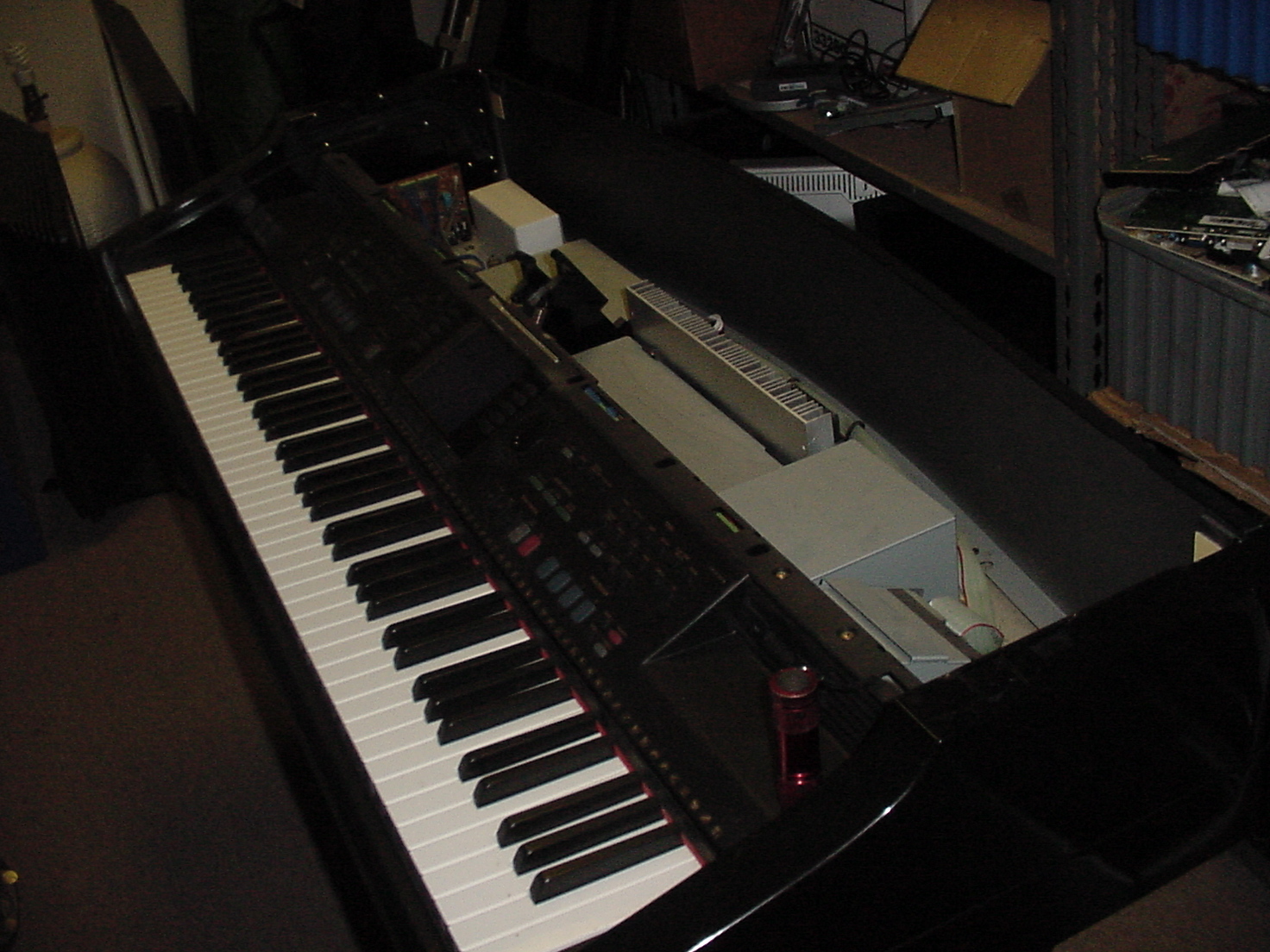

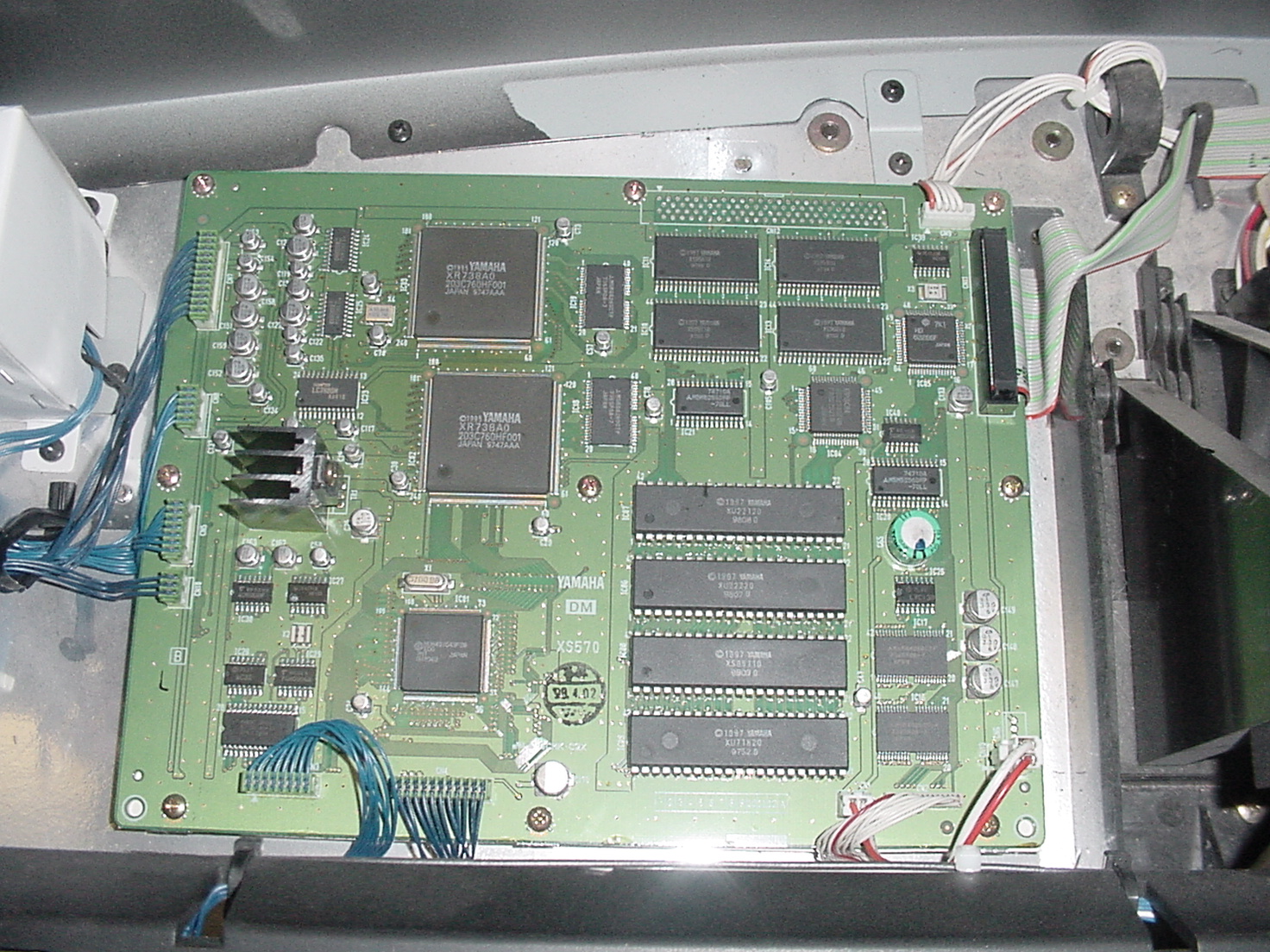

                          The two pianos we received at the recycle place may be gone by now. This is one of the them, they came in March.
                            • 31048
                            #33
                            Re: Yamaha Electric Piano CLP550 no keyboard output
                            that's different.
                            board says 570.
                            and it's got 4 roms - not 3.
                            infact it looks like it may have 4 smd ones too.
                            and a supercap.
                            DK - can you post a foto of your main board plz.

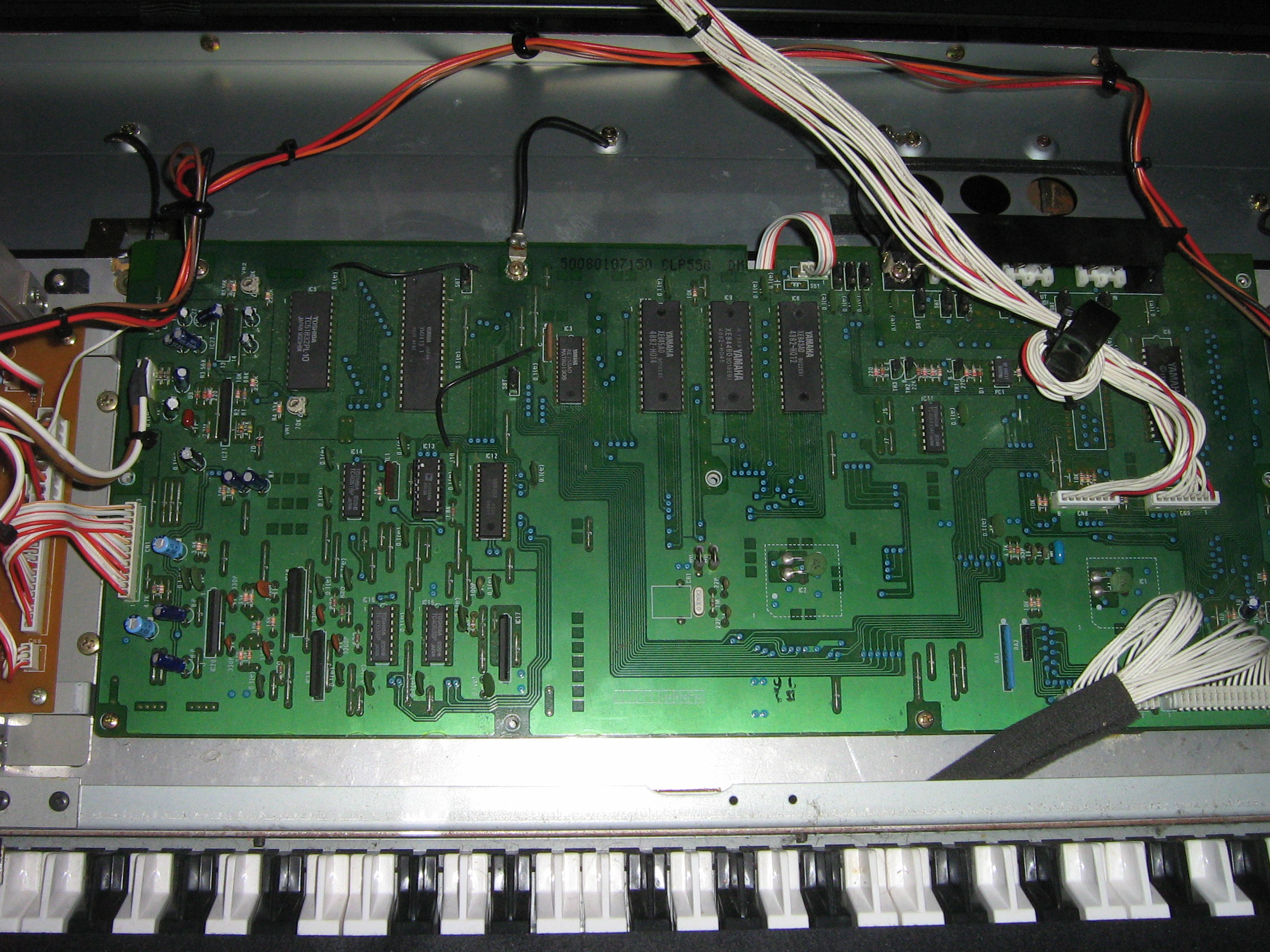

                              Sadly it looks very different. Will post pictures of the CLP-550 tomorrow. (Busy tonight with guests.)
                              • dkneyle
                                • Dec 2013
                                • 441
                                #35
                                My CLP-550 mainboard and the three waveform generator ROMS.
                                  • 31048
                                  #36
                                  that's more like it.
                                  3 x 32pin rom.
                                  and no top pads too - easy for someone without high-end tools to desolder.
                                  so now we need either luck, or dumps from anothe user.
                                  would yamaha give us a set of dumps?
                                  probably not, but the worst they can do is tell us to go fvck ourselves.
                                  if they did - i'd consider it a declaration of war & start a rom repository to dump every damned product they make!
