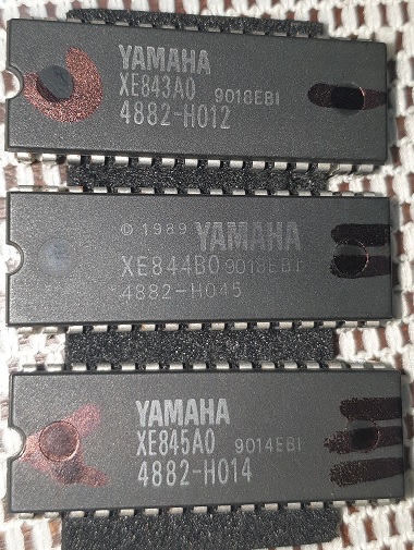

      Hello friends, Thanks for the lot of effort made on the clavinova 550 so far. me too now having a unit to repair with NO sound or some strange distortions on certain key puches. so i follow the whole thread and learn alot.
      i had gone through my case before read this thread and refering the circuit diagram and i was end up with decision to change the DAC chip first. but it seems i have more things to consider.
      i noted the circuit of my case had not done any repair so far and problem occurred after idle for year or so. so im quite convince the fault will not cure after replacement of DAC and few other digital chips support mux n chip enables(Hex inverters). anyway im trying my luck in coming few days if i was able to procure the DAC locally or i have to wait 3~4 weeks to arrive it from Ebay. in the same time im planning to remove ROMs carefully to read them and make a dump. fortunately i have all the stuff to do so with me already. if the luck is in our side n if we able to read ROM-A, we have have whole lot with collection of your previous efforts.
      i had checked the availability of 27C040 ROMS( or even AT27C040 from ATMEL from more recent era) and those are available to order and my EPROM reader\programmer well supporting those. so hope for the best!
      Thanks guys for your endless effort from 2014, long way back!, will update you the progress!
      by the way: let me introduce my-self, im PMD from Sri Lanka, Engineer and experienced Repairman(as part of the job and as a hobby) for many years. experience in Electronics, component level repairs in analog and digital systems, embedded system design and programming, Electrical Engineering...

          I was working on my CLP550 and got replacement EPROM AM27C040 and had read my existing chips. two were readable quite well and files attached here. basically the missing image from previous attempt also recovered. but only one rom we both recovered by seems some slight differences in some areas. pls refer attached images if any one interest to some forensics. i manged to read rom A & C. third ROM was just reading first 2 or three bytes but from that point nothing readout. i dont have control over reading pulse time of data settling time after address latch. so might get better results with slower clocks. my reader took around 7500ms to read the whole memory, 14us per byte, might be ok.
          will update after while the developments.

                  hi, i were managed to check the CLP 550 with 27C040 ROMs burn with given images. and piano is working!!. i checked the DA converter as well but it working fine. i think previous conclusion of wave ROMs are rotten is correct. even i read the two ROMs just after remove from the board but does not respond to reader few days afterward(i just wanted to read again and compare few reads to see how much consistent the contents of ROMs). but no chance now.
                  Quote eccerr0r:
                  "What do you mean by "nothing readout" and "first 2 or three bytes"? What are you reading out on the "bad" one, as they are asynchronous they shouldn't give much information about read failures, just returns bad information. "
                  I try to read the 3rd chip but after first 2 or 3 address, all remaining adress readsout "FF" or yeilds no output so my output window just shows 1F, 03, A2 then FF, FF, FF till the end. seems chip have error in address decoder area.
                  with ROM B and C unit is working almost. only the default tone(Grand piano-1) chord area working and reaming keys giving no output but all other 7 tones working. with given ROM A, remaining areas also working, but in my case some noices are added witch i cant eliminate(to all the tones with or without ROM A). i suspect two reasons. one is some data bytes of the roms are incorrectly reads and that causes the issue. also i notices IC15 & IC16 getting some decoding pulses from IC12 and it does the stereo decoding and having some voltage issue in SH3 pin(only 0V - no change over any tone or any function). im further checking on changing these digital chips and let you know in due course. i found all the voltages in remaining areas correct. any suggestions and guide lines are mostly welcome. my CLP550 tones getting slight distortion and at the end of the tone the distortion can here quite well and once toning period end, all noises vanished.

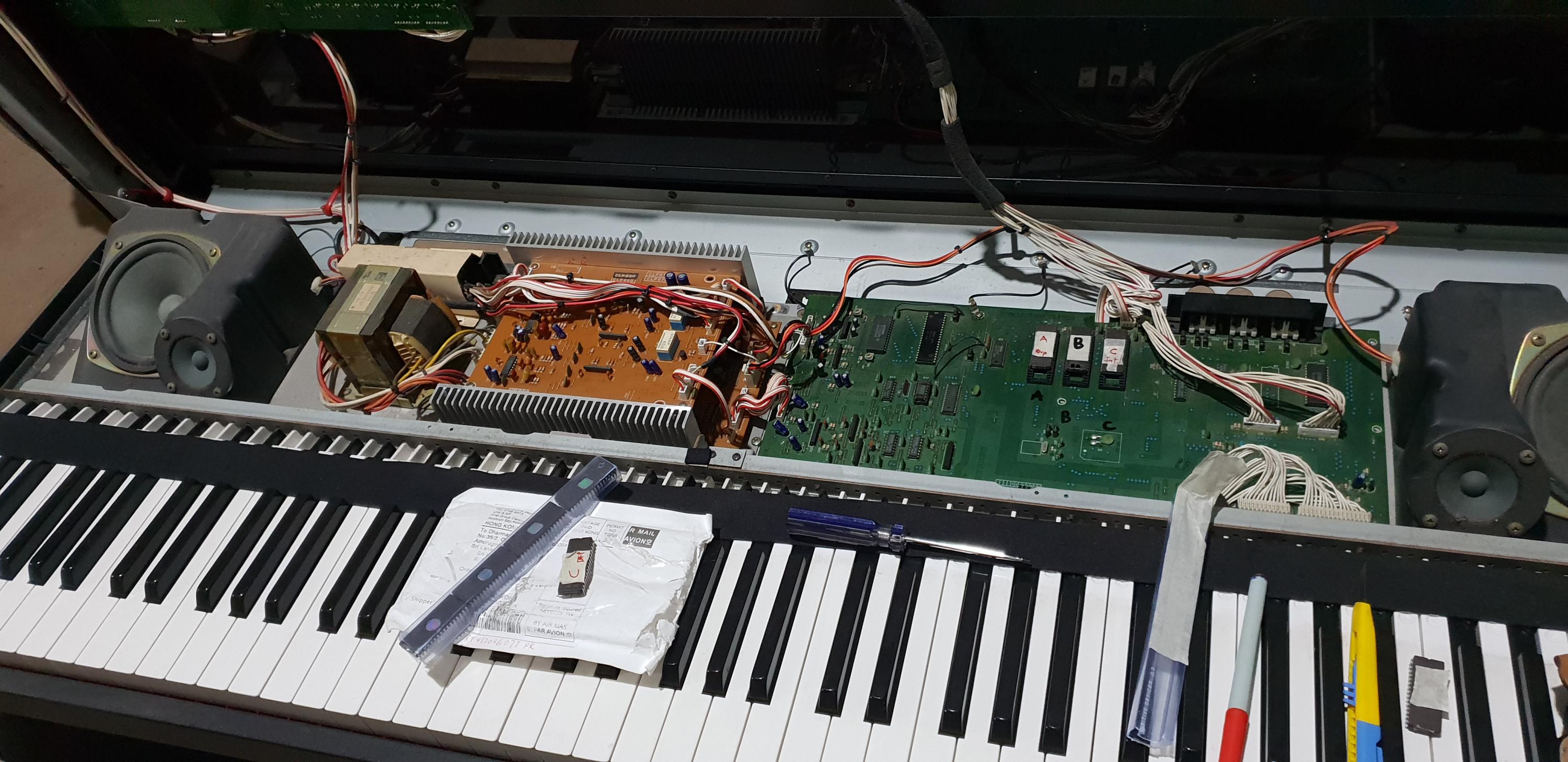

                        Hi Everyone
                        Thank you for the forum, I was able to resuscitate my CLP550. It is working without a glitch.
                        I used the the ROM from Band C with my original A chip. I believe the ROM from the A chip provided is incomplete or corrupt. I initially used it on a 27C040 however the function Piano 1 worked partially with similar symptom as without A chip.
                        When I used the original Yamaha chip A - everything worked without sound distortion
                        So far I have been unable to dump the Rom from my A chip, the universal programmer I used http://www.xgecu.com/en/TL866_main.html TL866II Plus does not support TC534000.
                        I requested from the manufacturer a firmware update but ... who knows when it will be available.
                        So if you have any suggestion on how I could dump the ROM please let me know
                        I am afraid that the original A chip might fail

                                dont the original roms have a crc32 checksum printed on them??
                                • PMD
                                  • Nov 2018
                                  • 18
                                  • Sri Lanka
                                  #96
                                  Re: Yamaha Electric Piano CLP550 no keyboard output
                                  NO checksum printed on the chip! chip images attached

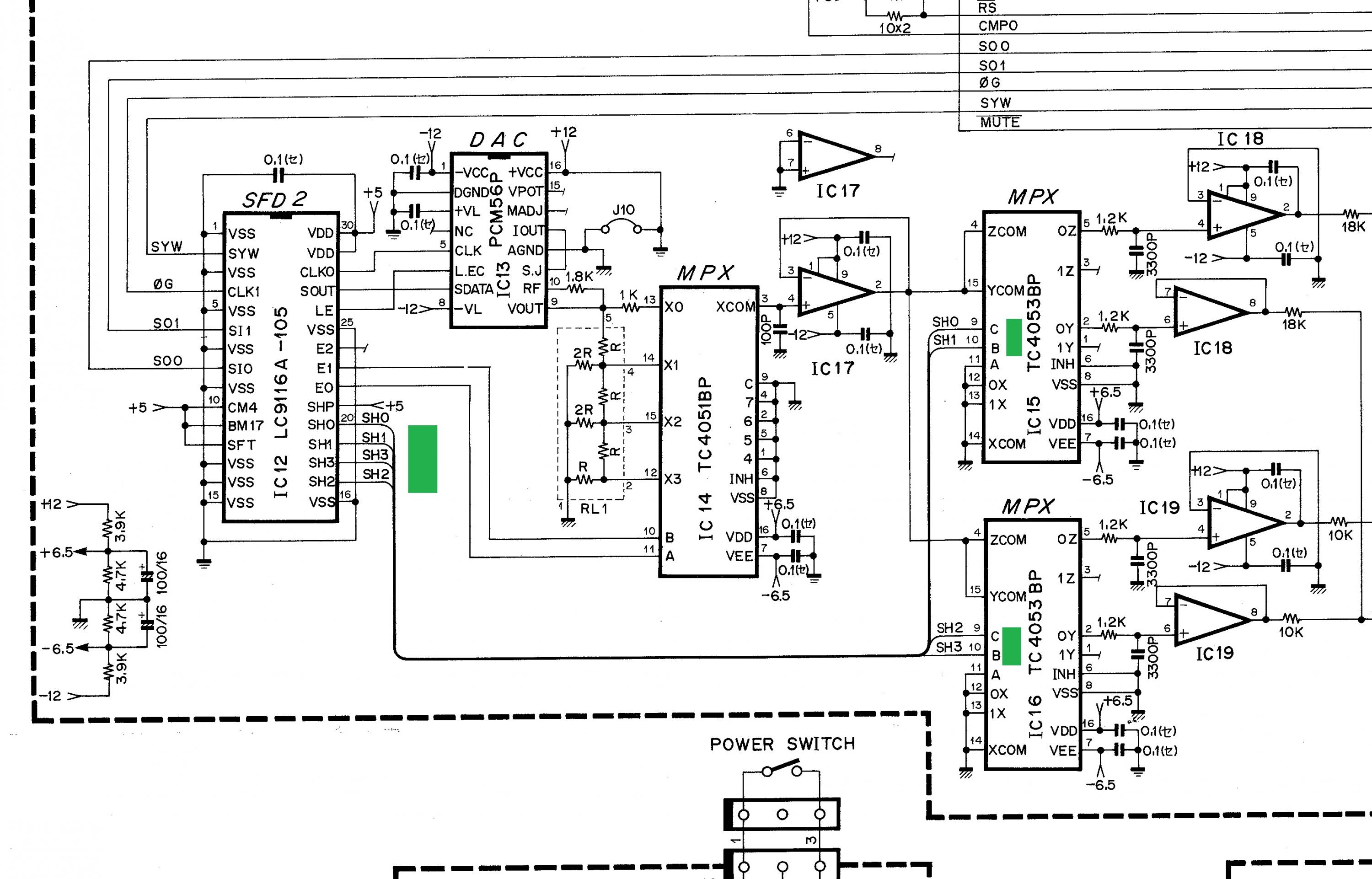

                                        Before I rush onto removing the ROMs, I want to be absolutely sure that it's one (or more) of them who is a culprit.
                                        The symptoms in my case are not a clear cut, to this point - see below.
                                        I do have a CRO, and can probe the signals at multiple points. Of course, I have a schematics.
                                        Here's the brief summary - maybe someone experienced in repairing those beasts can give me their option:

                                          Hi DS, I noted, you were very observant and focus to very detailed description of the problems and behaviors of the Piano. Im certain you had the same issue of ROMs. me too getting likely issues before change ROMs. i assume ROMs had wave details of the tones also some sound effects related information's and information how to decode the bit steam to the stereo sound with some switching\multiplexing mechanism. also i guess mostly, all 3 ROMS of your Piano had issues. mainly read as zero outputs.( possibly due to disconnected pins or connections internally at silicon level), that might be some reason for endless CE as no response. in worst case it might be due to some (partial or very little)corruption in CPU ROM as well. if that was the case, i will try to send you image of system ROM dumped from my unit( i hope its still doing good).
                                          anyway my conclusion was you are good to go with wave ROM replacement. try to remove chips very carefully, one by one without let them getting heated. remove one pin give time, remove next. once remove, read the ROM without delay(immediately) with programmer. sure you cant find correct exact chip, but select as AM27C040 and read. save each read before analyze. im telling all because my ROMs read just after removal and got some readings, but after day or two i couldn't read any of them and read as blank mostly(except some random bytes). i cooled one chip as i read only 10% of it and rest are zeros. i cooled in normal refrigerator in sealed box to about 4deg centigrade to see any improvements(that works for me in some other cases), but after that i couldnt read anything, totally no response from ROM. im glad if you can get some dumps to compare results with previous ones.
                                          Also find attached image of the part of circuit diagram. i marked some pins with green colour boxes. pls do check those pin status while key pressed, released, ect and see its conditions and update me if possible as in my case, SH0 or SH2(one of it i couldn't exactly remember now) is at Logic Zero Always and no change what ever the condition of tones and key pressed. it should change. that will be the my problem i think as my Piano working but tones get bit distorted possible due to not decoded in correct sequence and switching not happen properly due to this pin output not changing. i feel IC12 Faulty. lets see if you can give some inputs in this case.
                                          DAC chip not getting any issue. its bit heating but it is normal.
                                          Good Luck!
