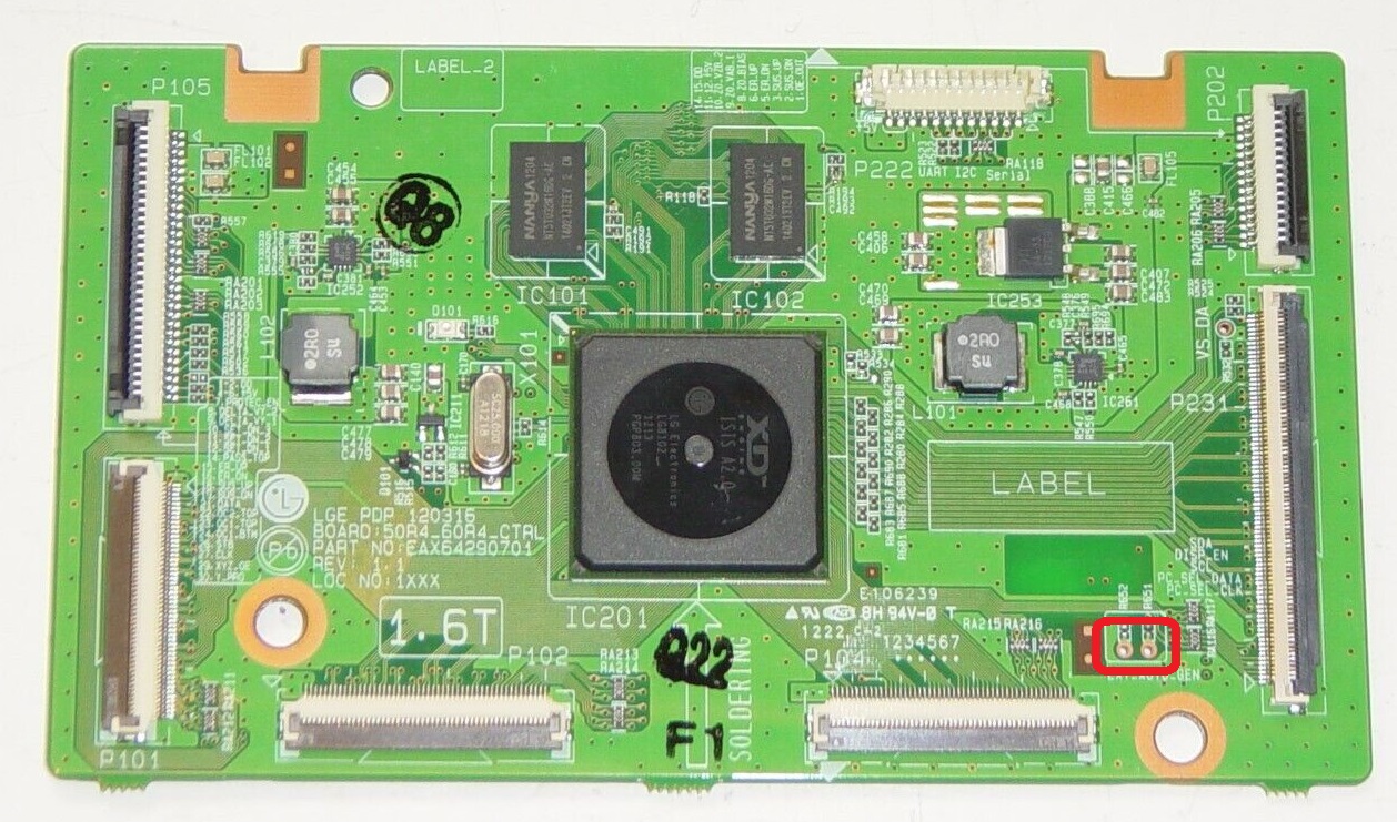

            • Biruslapio
              • Nov 2013
              • 552
              • Brasil
              Re: LG 50PA6500 Plasma TV damaged after a power spike
              For the self test all you need is the VA, VS and M5V, led not blinking is very suspect so test again when the new board arrives.
              It is done by shorting those two pins circled on the image.
              • tofik
                • Dec 2022
                • 26
                Update,
                I received a new LOGIC PCB, now I see that the status LED on it is blinking (so the logic board definitely was damaged) but it's blinking only when the main board and YSUS board (EAX64282201) is disconnected.

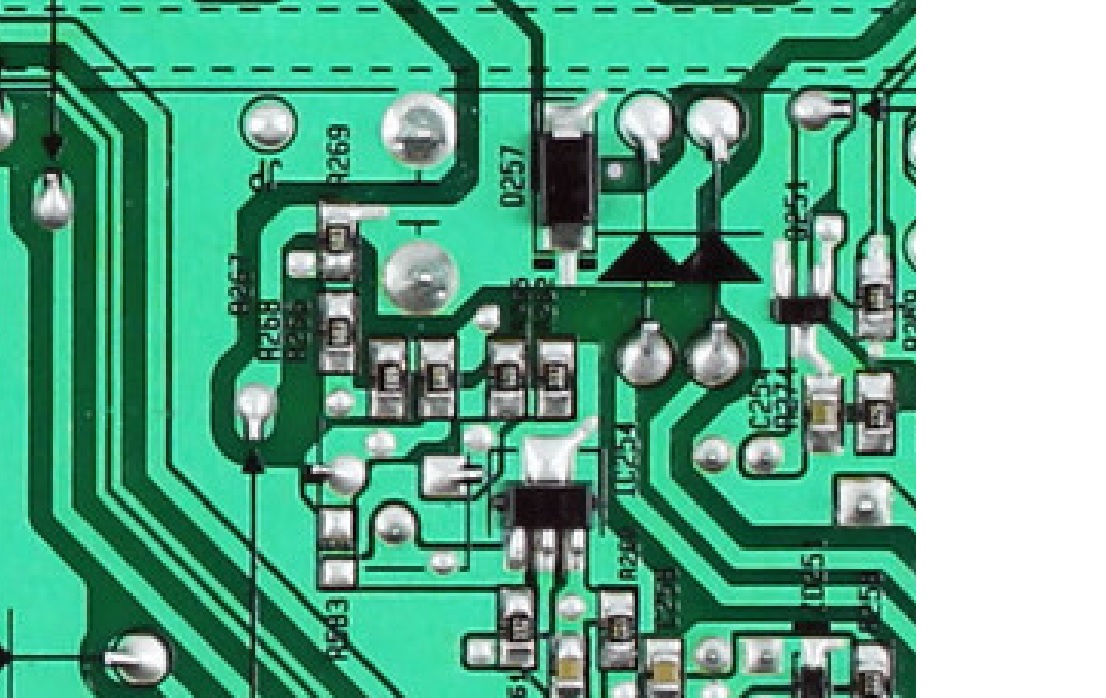

                Today afternoon I will have a new main board but the problem is also YSUS board.
                You can see that two tracks were burned, I restored them but it still doesn't work.
                I quickly tested few components and diode D562 (as marked on red) is very likely damaged, resistance on both end is 0,4 ohm.
                Probably it will be difficult to fix this YSUS pcb and replacement is not that cheap like a logic and mainboard
                The problem also is I am not sure it will work even when YSUS is replaced.
                Any suggestions?

                        • tofik
                          • Dec 2022
                          • 26
                          Thanks for the links! I will check it later, I mean the components on the YSUS pcb.
                          Is it possible to check if the PDP panel is working fine without a YSUS board? I think ZSUS is in good condition, same like PSU, mainboard and logic.
                          Aslo I just realized that not the track is burned out but the resistor R267, does anyone know what's the value it could be?
                          • R_J
                            • Jun 2012
                            • 9535
                            It is just the trace that is burnt, R267 is not burnt, it is in series with R269. It looks like the source for the voltage is D255, so I would check all the components connected to D562 anode
