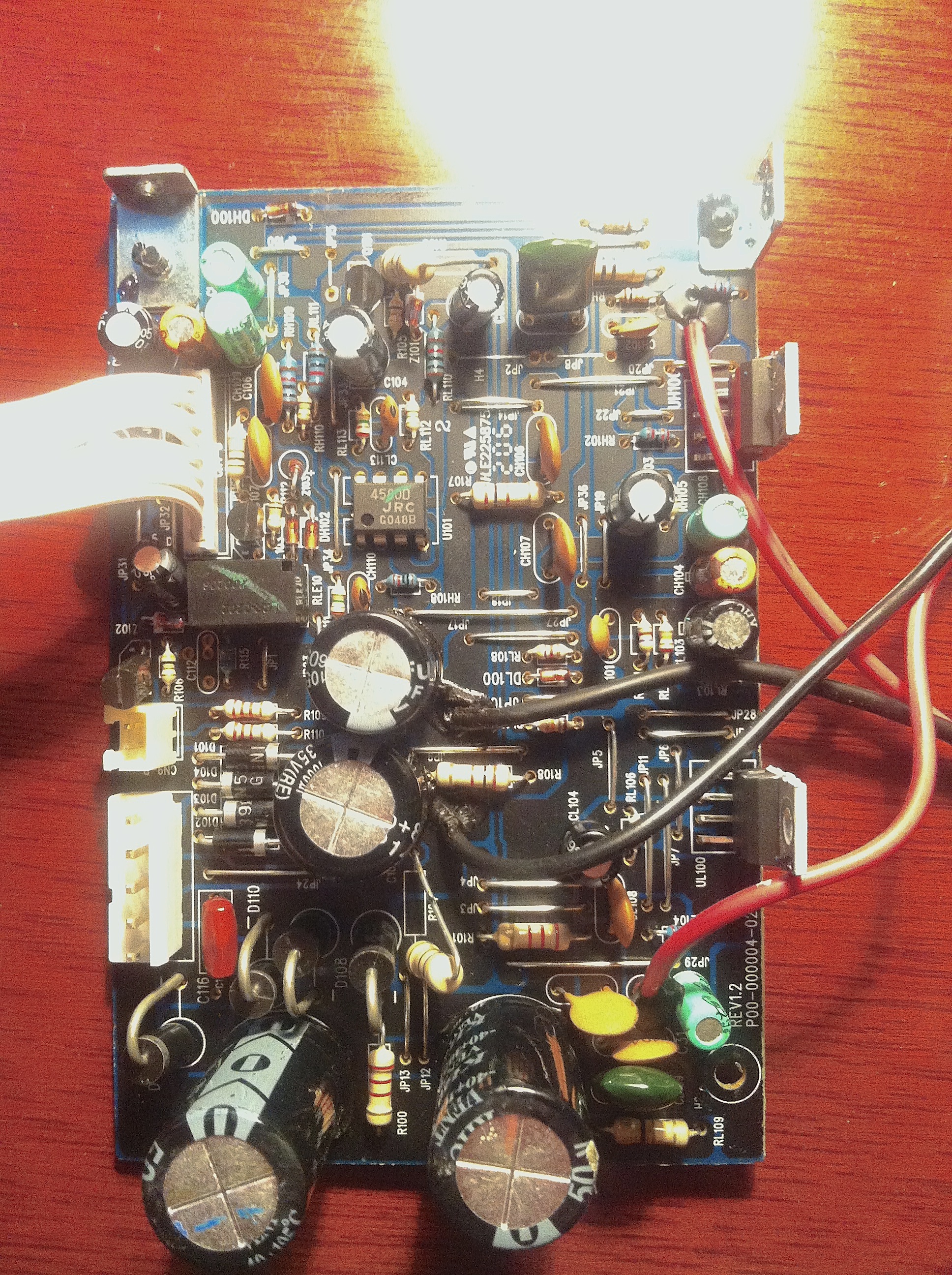

        Re: KRK Rokit 5 Gen 1 pops fuses as soon as it's powered on
        Sorry about that. Here's the inverter board from overhead.

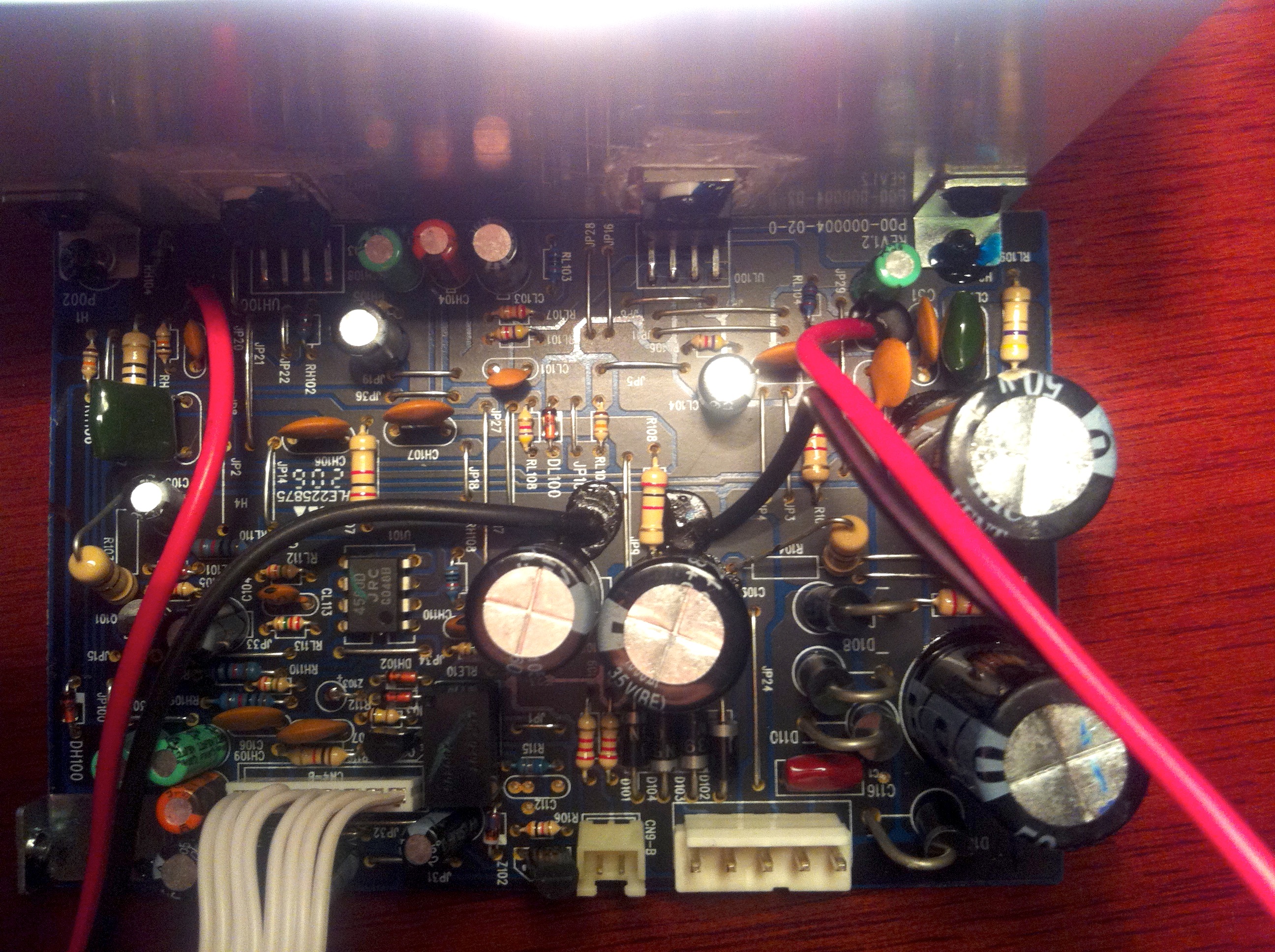

          One more with the heatsink off
            Gotta love how the copper bottom layer is silkscreened on the top - easier to trace stuff
            Hint: this is the "power board"; inverters are mostly found in UPS's (turning the battery DC into the AC that mains-powered things are fed with) or they supply fluorescent lamp (turning whatever DC they're fed with into the high-voltage AC the lamps need)
            As budm said, the first place to check would be the rectifiers - these are the four fat-ish "upright" diodes (D108, D110 and the other two like them, around the two big main filter caps). Just to be on the safe side, you could consider checking the small rectifier diodes too (D101-104, right next to the two white connectors).
            Seems these Rokits use some chip-amps to power the speakers -these are the two seven-legged devices that are screwed to the heatsink. What do the markings on those say?
            My guess is they're some TDA chips; LM1875's only have 5 legs. A quick search on Digikey turned up stuff like TDA2052, TDA7240 and TDA7298. I kinda doubt KRK went with anything more "exotic" than that

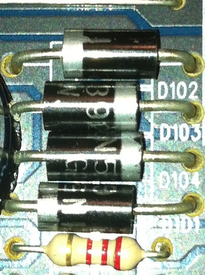

                Checking diodes is best done with them removed from the circuit (so that other components and connections won't interefere and cause false readings).
                You've got a (digital) multimeter, right? Switch that to the diode range (the -|>|- symbol), place the black probe on the "band" (cathode) terminal of the diode, and the red probe on the other end (anode). A good diode should show something in the range of 0.5-0.7 volts - this is the "forward voltage drop" that you'll find in datasheets.
                If it's higher than that (unlikely) or the meter goes "over the top", the diode failed open. If it's lower than that (in the 0.00x range), it's shorted
                  So just tested the diodes and the top one of these 4 (D102?) metered 000. So as soon as find my soldering iron, I'll pop it out and get a replacement. Thanks!
                    Mmm... Not just yet. Or better yet, pop all four diodes out, and using the Ohm (resistance) range on your meter, probe between the positive (+) rail and ground, and then the negative rail (-) and ground.
                    If neither of those shows a low resistance (give it a few seconds before drawing a conclusion, until those big caps charge up to the low voltage the meter provides), then it's safe to assume the two amplifiers are fine (PS: they're not just plain ol' transistors )
                      So I got the diode off. Markings are IN5392 GW. Not seeing this in DigiKey nor does a google search lead me anywhere useful. Suggestions?
                          If this is a common failure, you shouldn't use an exact replacement. Find one with a higher current rating. I don't think the voltage rating will need to be increased since it looks like the filter caps are rated for 35V. None of the other specs really matter since it doesn't use a switching power supply.
                              You could use a diode with a lower Vf, therefore it isn't as likely to overheat.
                              Also, maybe a 1N5401 will be useful, it is rated at 3A instead of the 1.5A that the original is rated at.
                                Big ups Budm!
                                The new rectifier has my monitor up and running like a champ! Guess it's time to get back to work…
