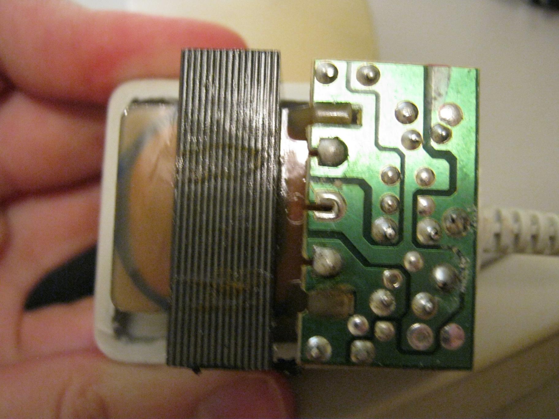

        I have finally taken pictures of the power supply.
        The transformer produces 11.2VAC on the secondary with no load. The diodes are 1N4001s.
        I might remove the 1uF input coupling caps since the IC doesn't need coupling caps on its input. I have discovered that polarized caps don't last very long when there a pure AC signal (no DC voltage) across them.
        I could also leave it alone since these speakers are so crappy. I have noticed that very high frequencies are too loud, but it might be a flaw in the amplifier IC (just like the APA3541).

            There is a fault with the amp. The problem is more annoying when using headphones. It isn't that bad when I use the speakers.

                    Re: $10 computer speakers
                    I finally removed the coupling caps. It seems to sound better, but I am also using a 12V power supply. At that voltage, the amp has enough power to blow headphones, so I normally use a 5.2V power supply that used to be a USB charger (the wires broke where they entered the USB plug). There is no power supply noise when using that adapter.
