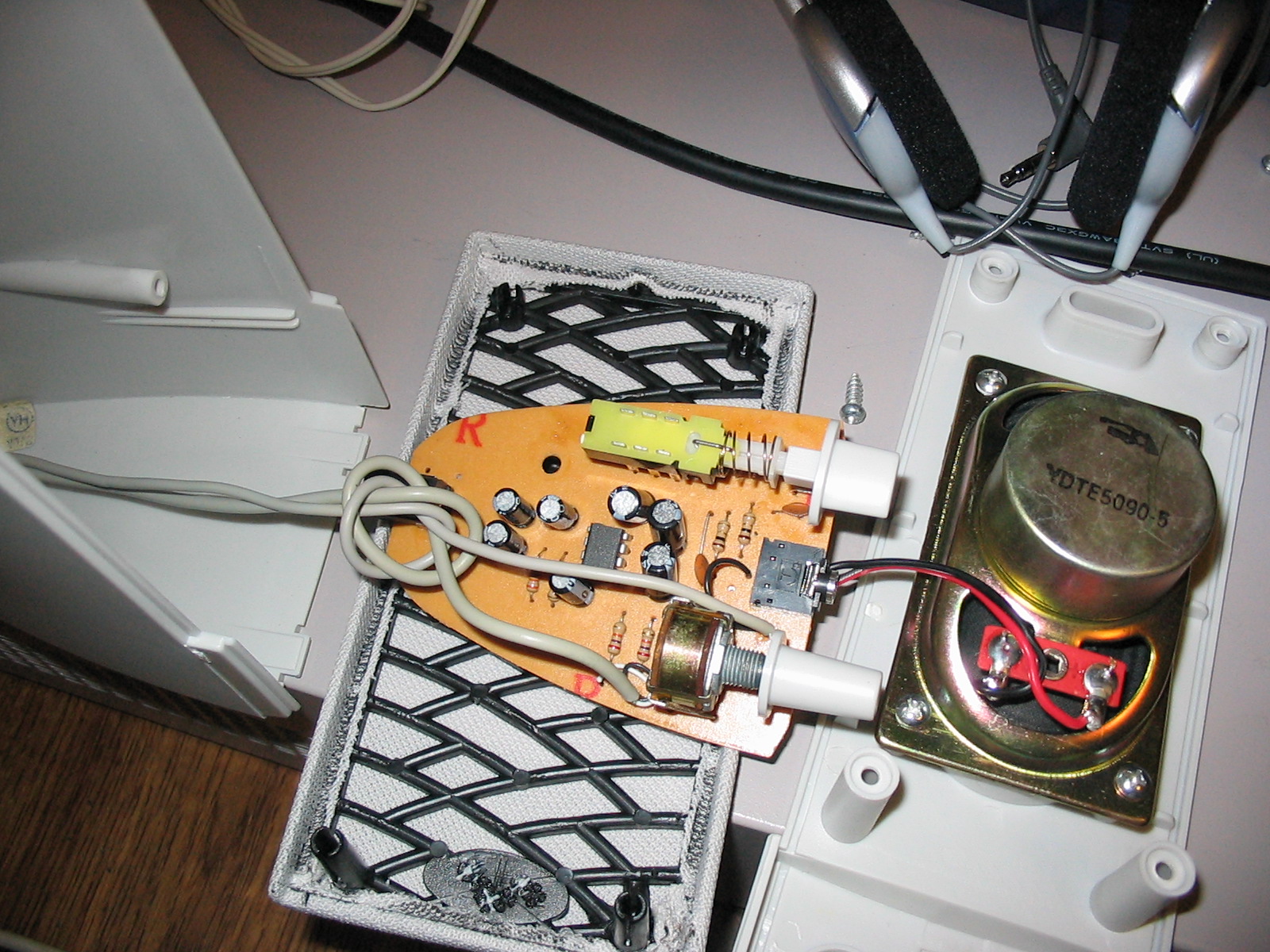

    Here is more cheap crap that I am trying to fix. These are a set of Cyber Acoustics CA-2012 computer speakers. The CA-2014 speakers are identical to these, and the CA-2011 and CA-2016 are USB powered versions of the same speakers. Most of the sound from these speakers comes from the plastic case resonating.
    These speakers have an insanely bright blue power LED, produce a loud humming noise, and nearby devices cause interference.

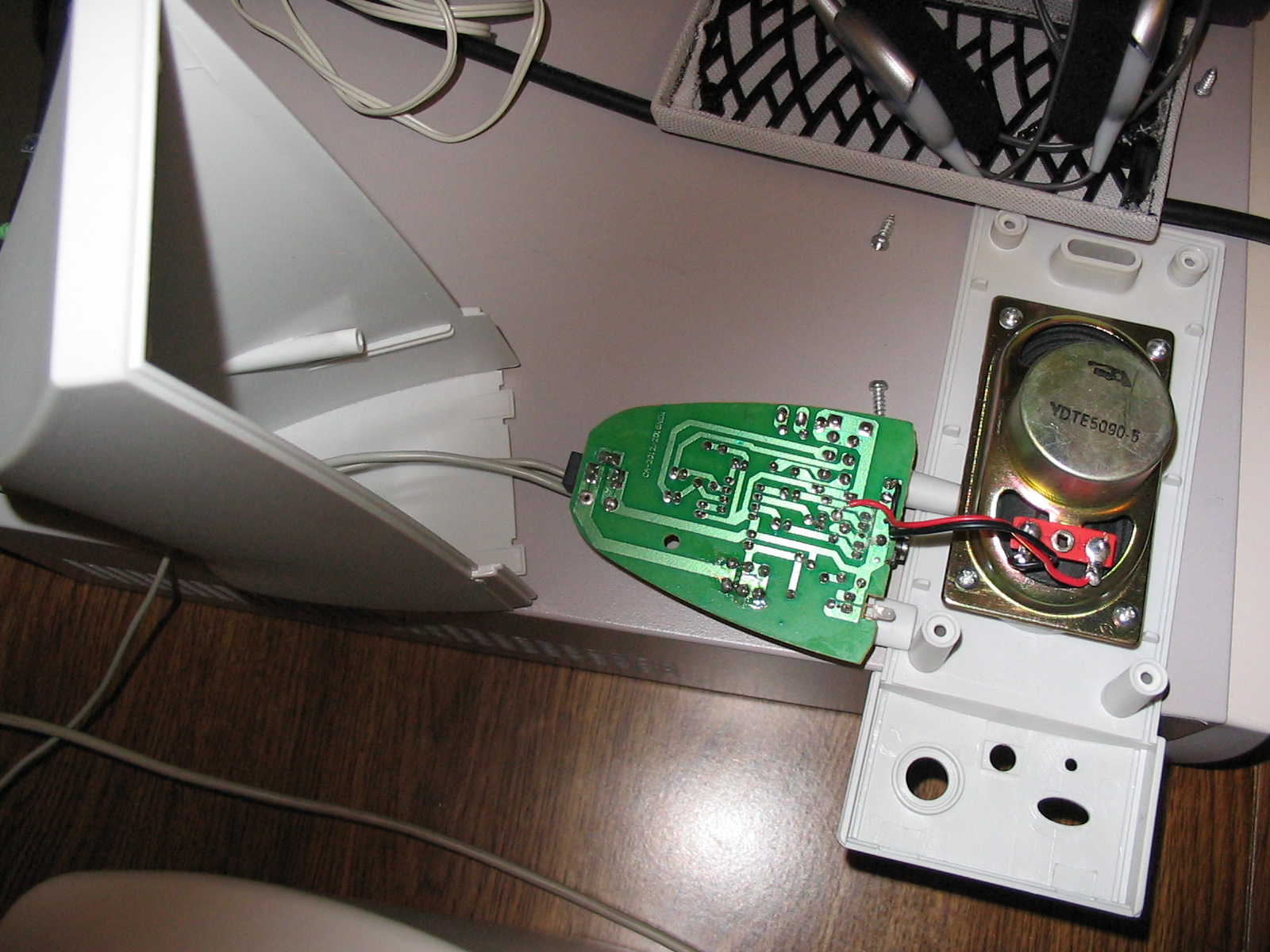

    Inside, there is a small circuit board that contains a TDA2822N IC. I can't find a datasheet for that part, but the TDA2822M has the same pinout.
    I first started to investigate the humming problem. The AC adapter is a simple unregulated linear power supply. I checked the voltage on the "7.5V" AC adapter and... look at picture 3. With the amplifier powered on, the voltage across the filter cap is 14.85V, which is extremely close to the TDA2822M's absolute maximum voltage of 15V.
    After replacing the AC adapter with a 5.2V linear regulated adapter, there is no humming. There is still a hissing noise in the background, but it appears even if I power the amplifier with batteries. The interference problem still exists as well.

    The humming noise is due to a very small filter cap used after that transformer. If the cap were larger peak voltage would also be lower. Try playing some music and you'll see that supply voltage quickly dips with increasing volume, therefore the IC is "protected". And it sounds like a fart box. Bump the voltage up to 12v regulated and it'll sound half decent.
    The hissing noise is inherent to the 2822, it has too high gain. Same goes for the interference issue. You haven't tried a bridged 2822 - wait till you see the background hiss on that.

      The AC adapter has a 470uF filter cap and the amp has a 220uF filter cap. I also added a 2200uF filter cap and the speakers still hummed. Yes, the transformer is not able to supply enough current to keep the voltage relatively constant. I used the 9V unregulated adapter from my other computer speakers and there was almost no humming and the sound was slightly better. There isn't much you can do to improve the sound of a small driver in a thin plastic enclosure.
      I'm surprised that the hissing is a fault with the TDA2822M, considering that it is designed to be used as either a speaker or headphone amp. I am currently using a 5.5V power supply so I can use the headphone jack. At 12V, the chip produces more power than most headphones can handle.
