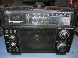

    Rhapsody RY-610 Multiband radio - need schematic\photos

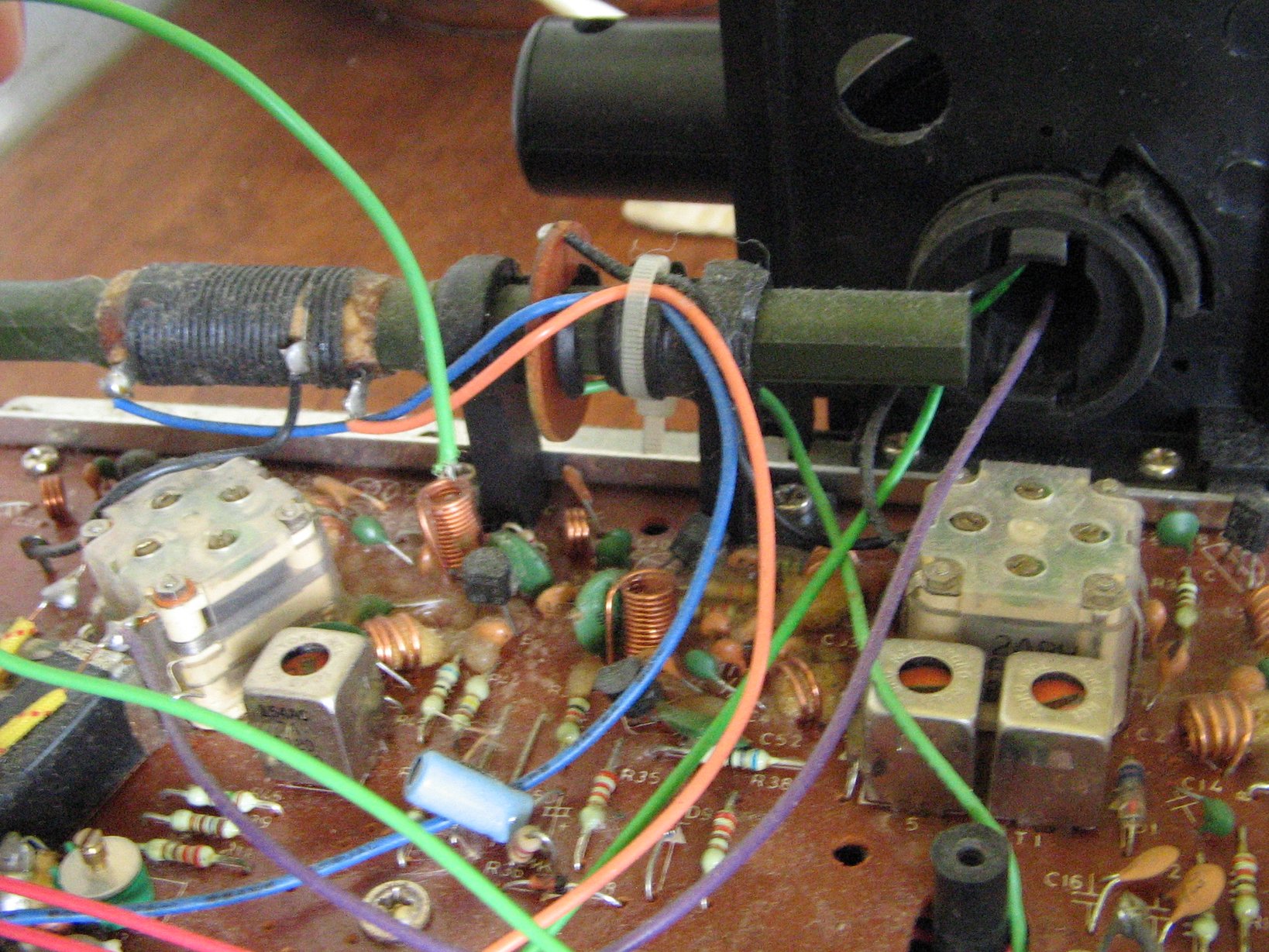

    Someone gave me one of these radios several years ago with a faulty amplifier
    I opened it hoping to find out what was wrong but never did (didn't know much back when I was 12 or whatever)
    I put it away, forgot about it for a while. Took it out a year ago, realised I had forgotton where half the wires connected.
    Now I'm hoping I can find a schematic or at least someone with one who can take some photos or otherwise describe where the connections are supposed to go.
    I figure that now I know a bit more with what I'm doing, I should be able to actually get the amplifier working again and use the radio
    I've attached a photo and added this link in case someone has one but with a different brand, as seems happens a lot with these kinds of things.

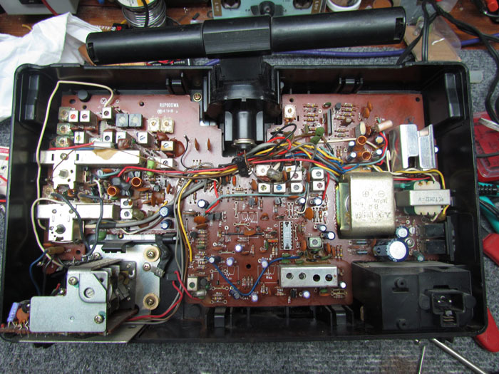

    Re: Rhapsody RY-610 Multiband radio - need schematic\photos
    looks a bit like an older panasonic.
    post pics of the board.it may become obvious where things go.and if it is really a rebadged panasonic it may be easy to crossreference to the real model.

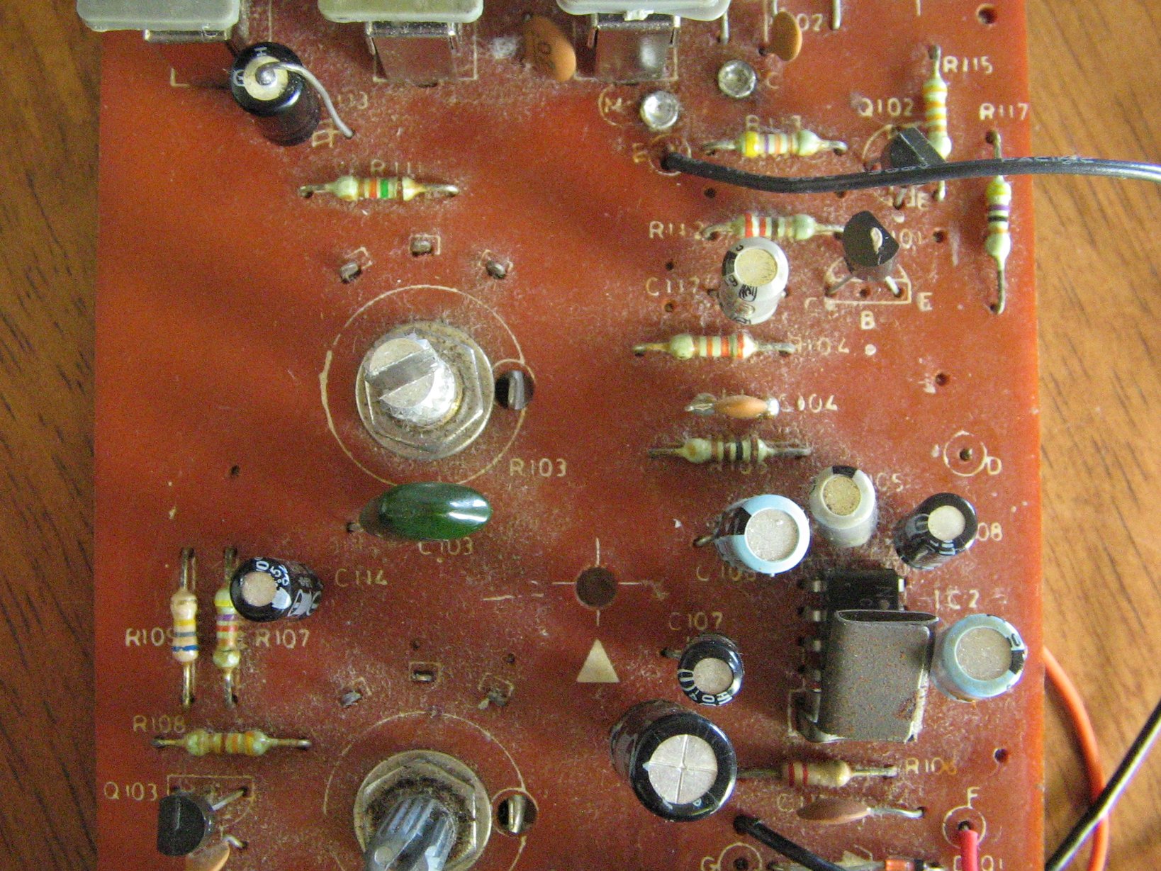

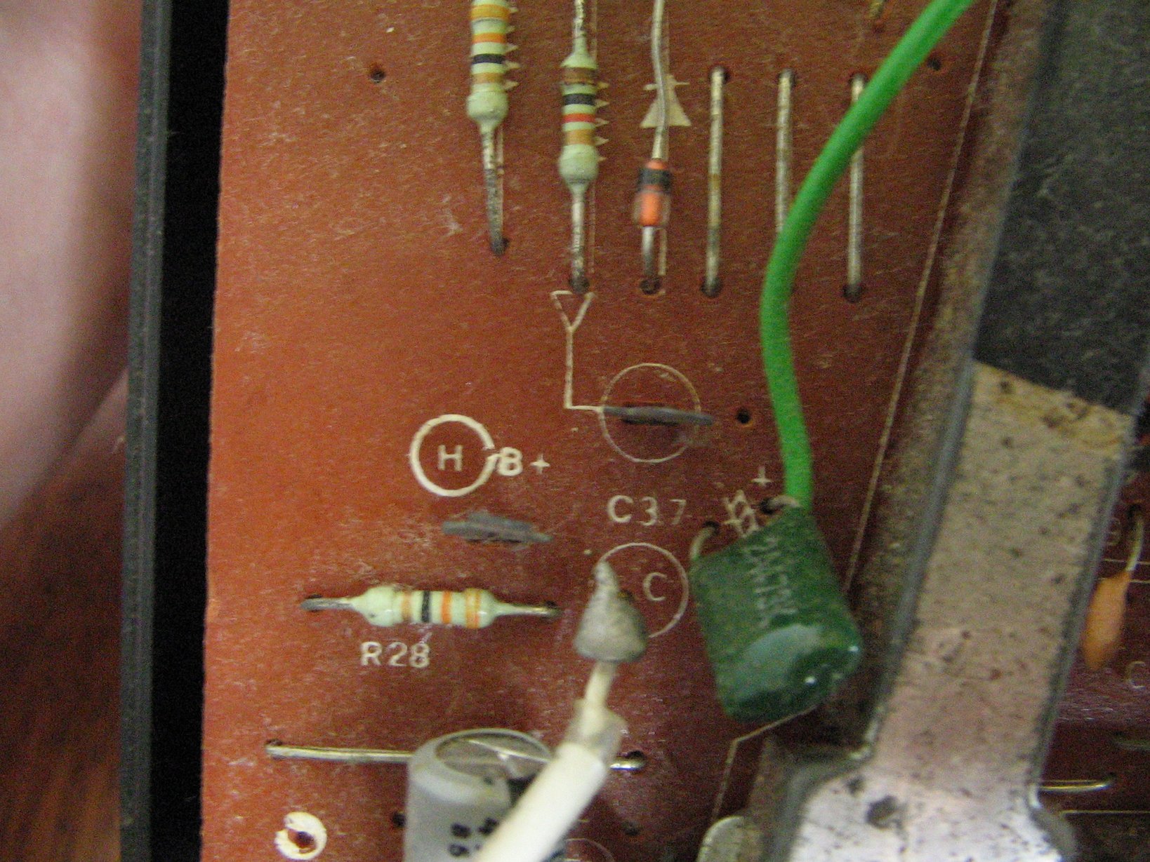

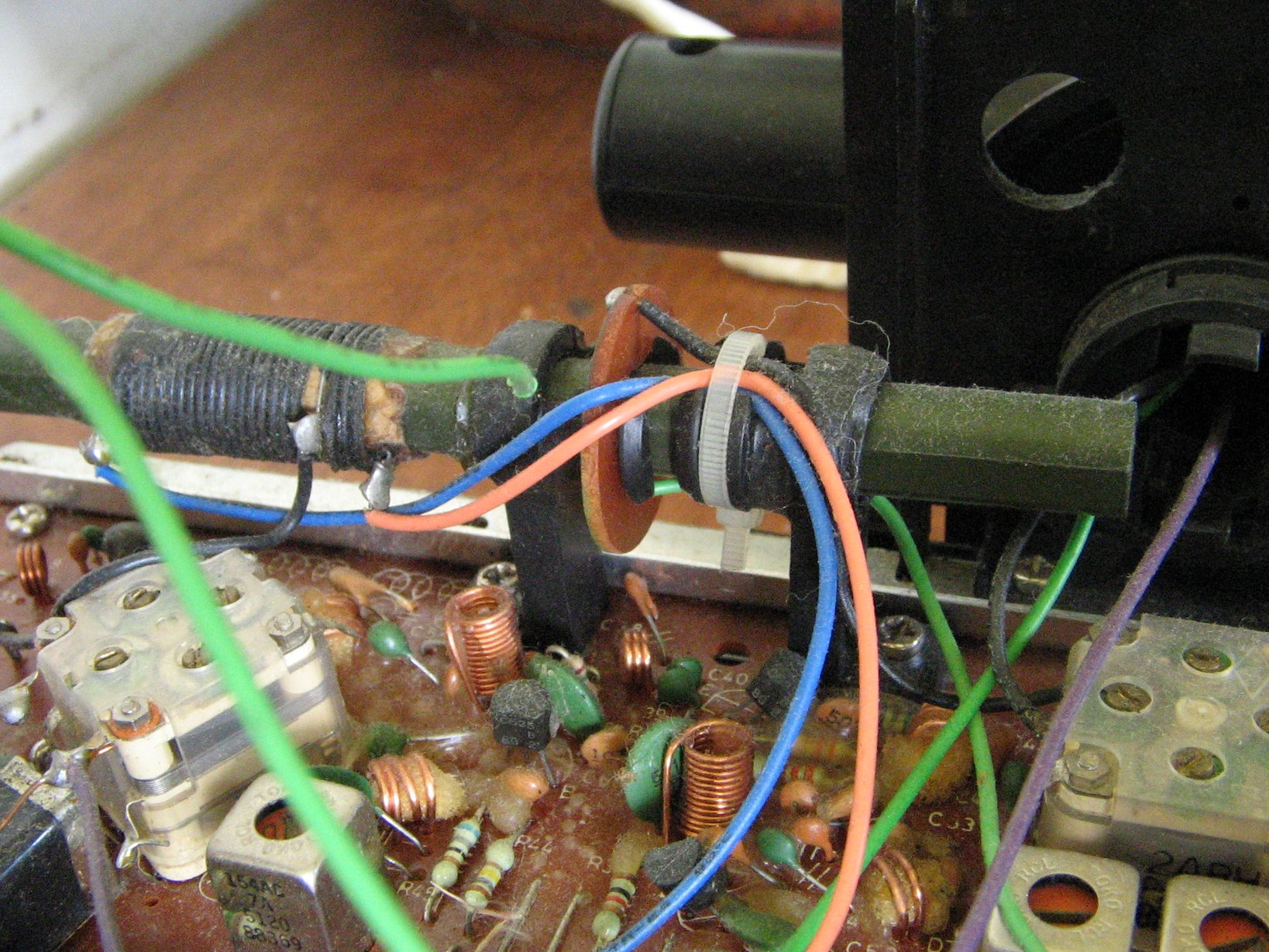

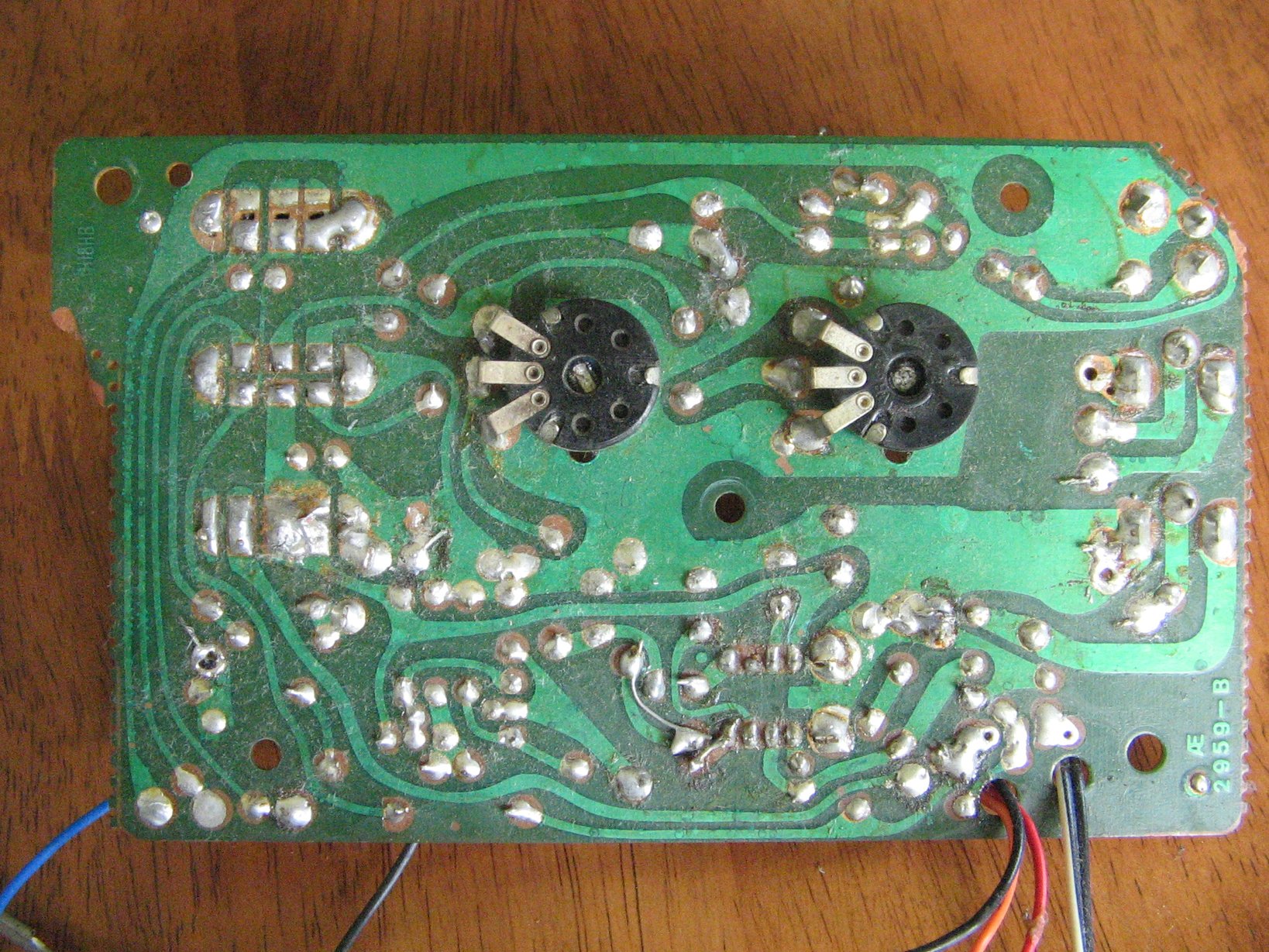

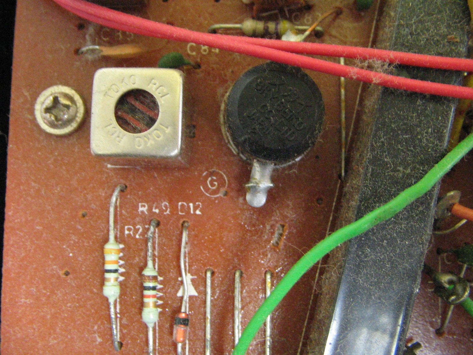

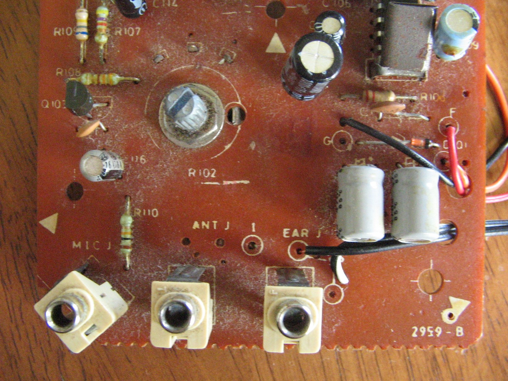

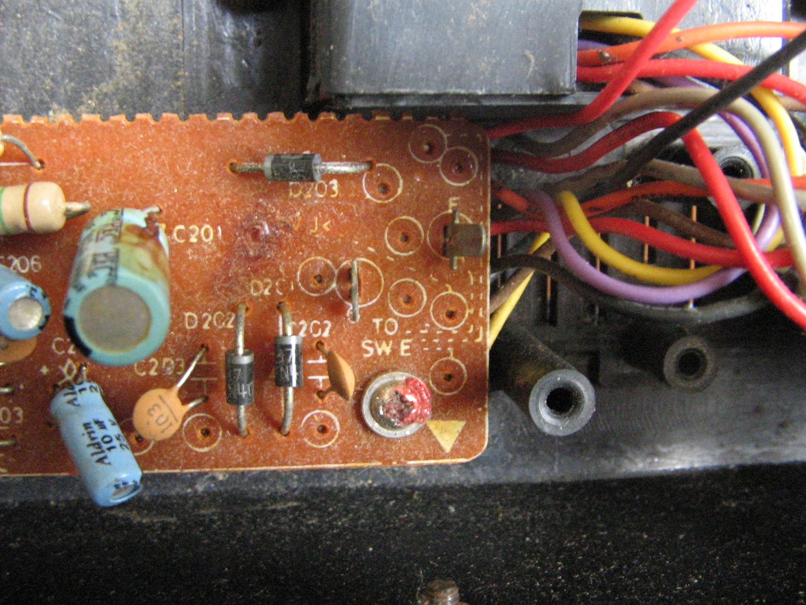

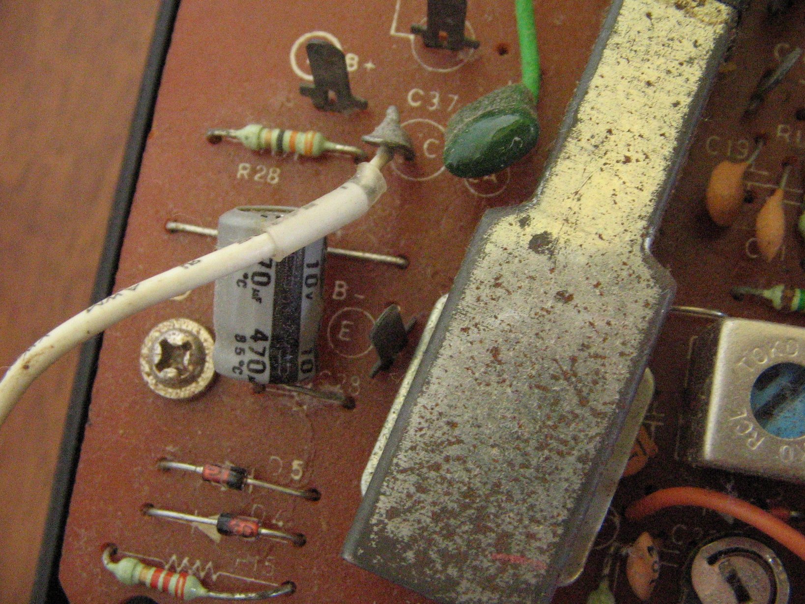

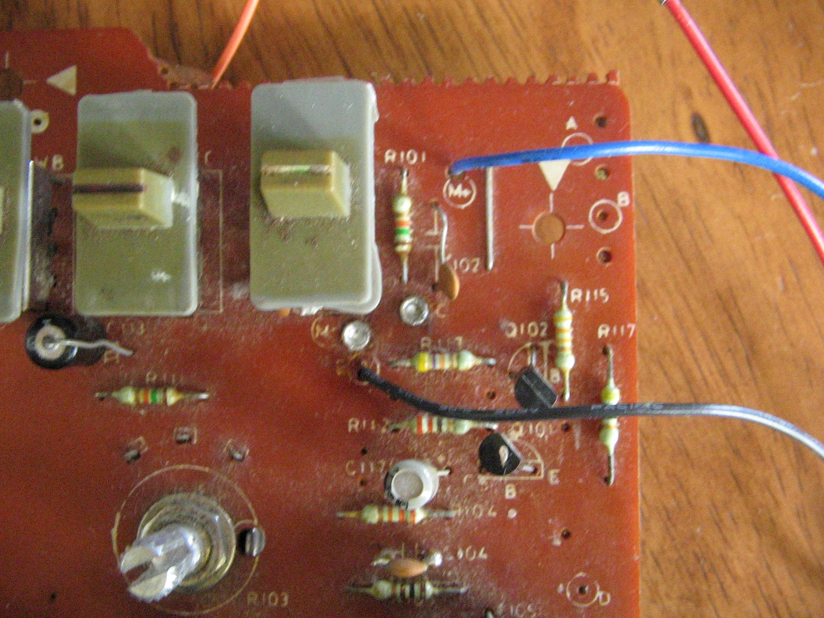

      Here's some photos, hopefully someone will recognize something there.
      First board is the power supply, 9 volts, F = Positive and G = Negative. I know that much
      From the board (BFO) I am not too sure what goes where. I think the red wire (which broke off) went on the B- point, but there is nothing called B- on any other board.
      As for the amp board, M+ and M- I believe are for the VU meter, and C is audio signal input from the tuner board

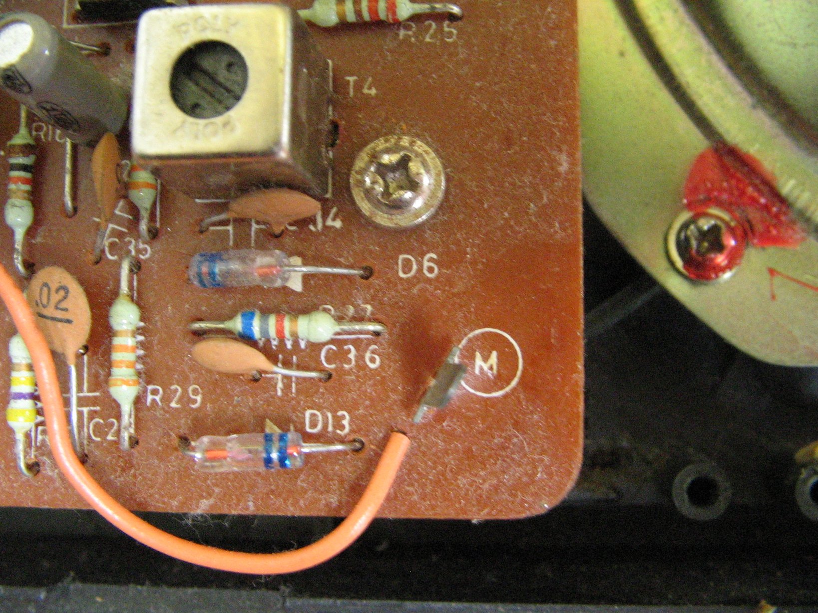

      Not sure what M is on the tuner board.
      Several points are not used, as this is the model without the tape deck built in.

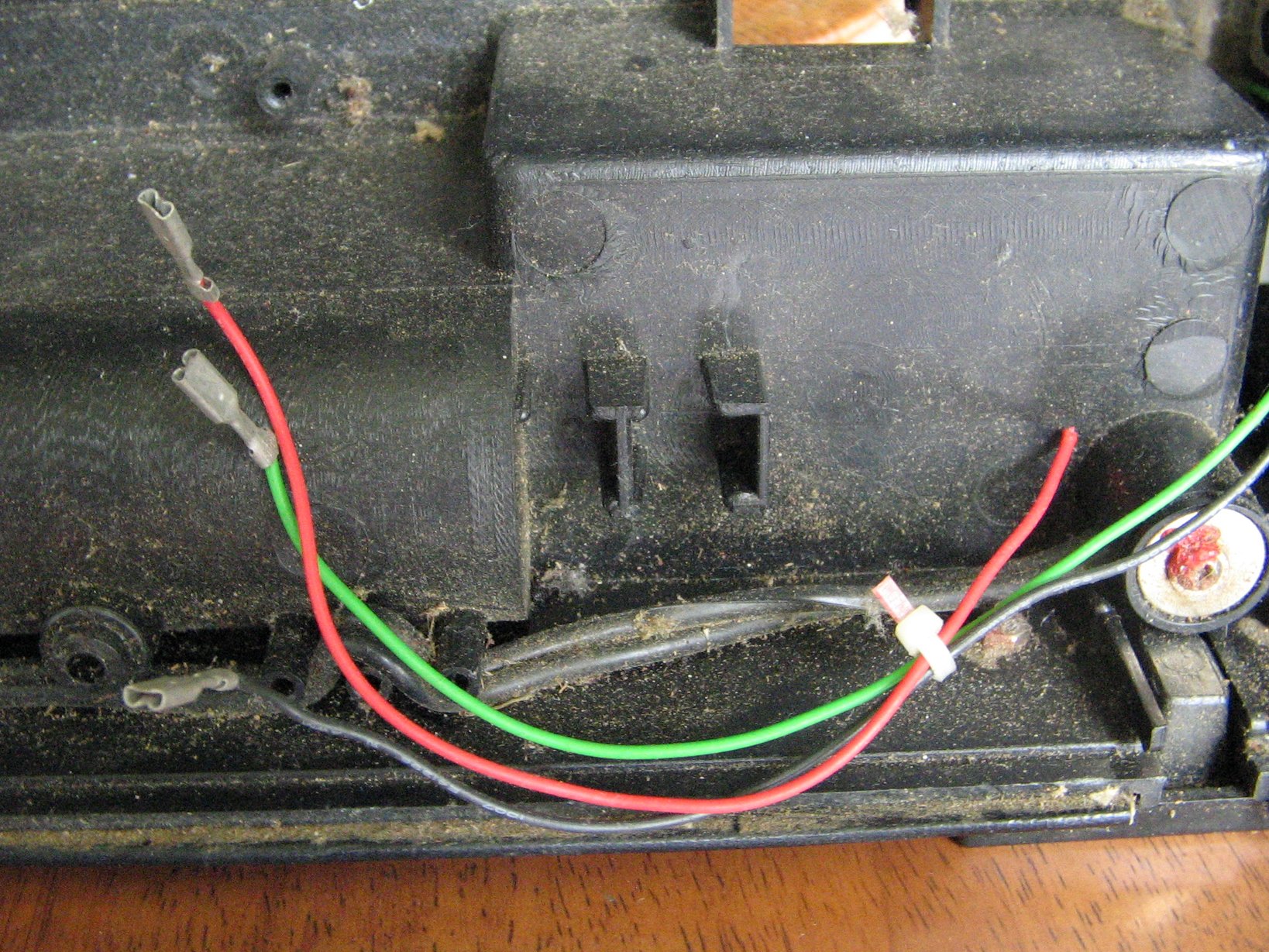

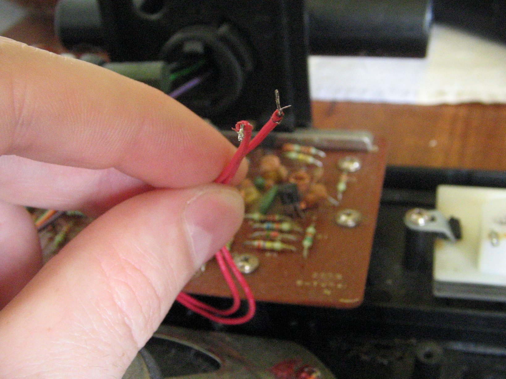

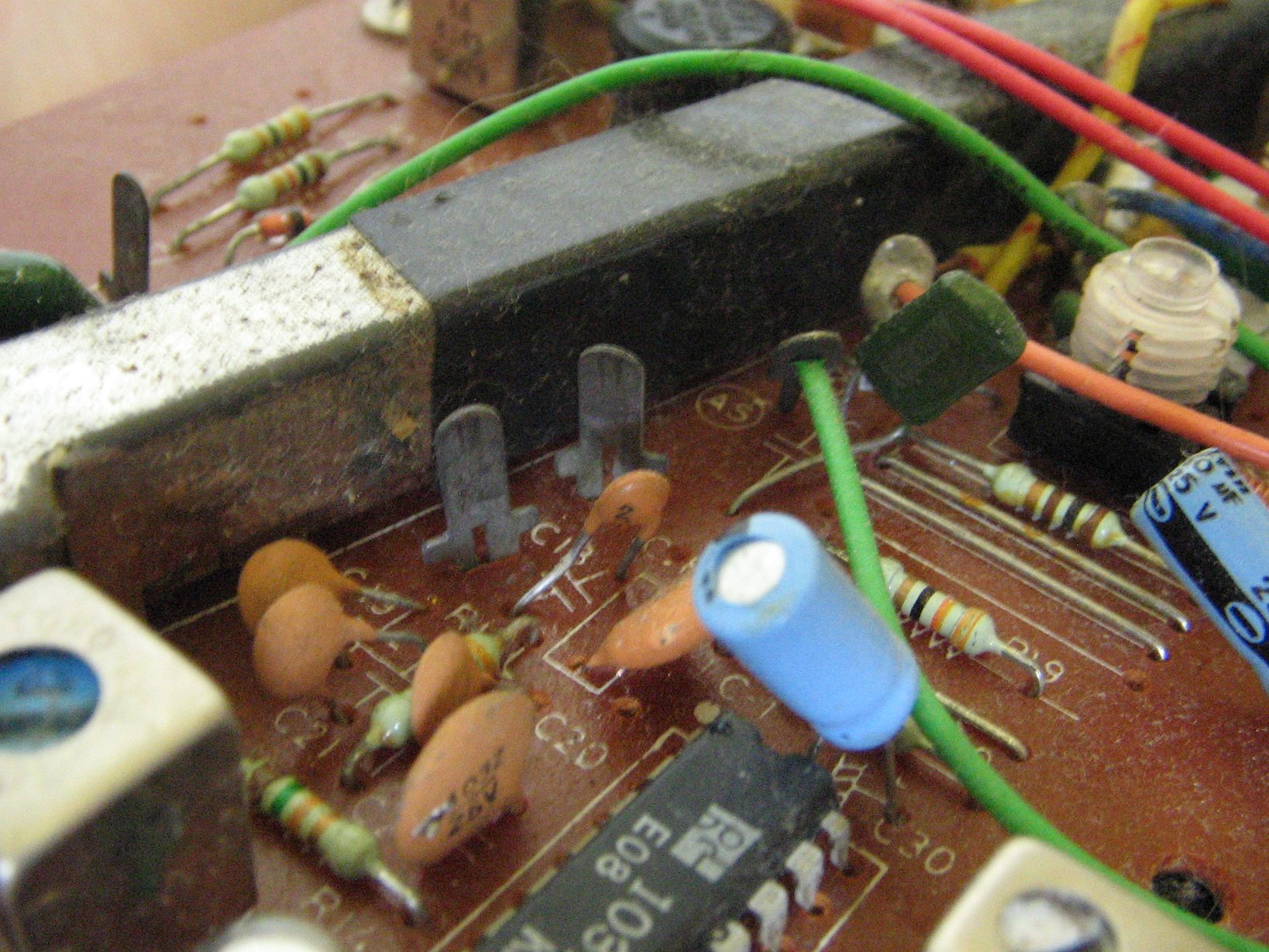

      The green wire I am holding comes from a small disc-shaped board on the ferrite antenna, but not sure where it connects to.
      The 2 red wires following that are for the dial light, and connect somehow to the left most switch on the amp board (point A and B, or, A or B & something else)
      I really think a schematic will be needed to prevent major headaches...
                    I'm gonna rain on this parade- that's no Panasonic. Overall, cheep construction... The real 2200s have both LW & MW antennas in the Gyro-Antenna. This thing has a ferrite rod, immovable, mounted on a board.
                    No Jap caps- they've all got weird names...
                    I see no "M" or "triad" logo on those boards. That looks a lot like various chinese "copy" radios I took apart years ago.
                    Don't get "tunnel vision" looking for an "equivalent model" where one may not even exist!
