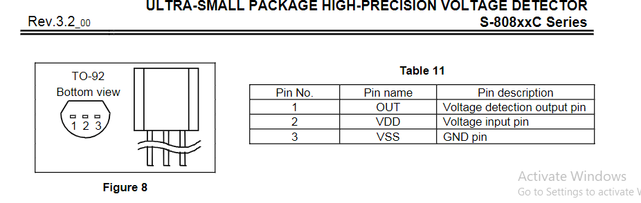

    The reset IC96 has the below voltages;
    Pin1 --OUT--4.95v
    Pin2 --INPUT--7.9v
    Pin3 --GND--0v

          The reset IC does gives a -ve pulse for a very short interval. Just like a blip and is maintained at near 5v.
          And the reset pin of the micro is held high: near 5v as soon as the power button is switched on. As per the pin diagram it must be held LOW, right..if you could please confirm this.
          I am not sure, how to measure the clock though i have an oscilloscope. I don't know the settings to see if the crystal is okay or not.
          Any suggestions on the above.

            • 31024
            Re: Marantz SR3001 Full dead
            the reset pin should be low for a blip, then high.
            (usually - sometimes inverted)
            if your multimeter has frequency then you can check crystals if they arent too fast.
            most meters can do 4MHz atleast.
