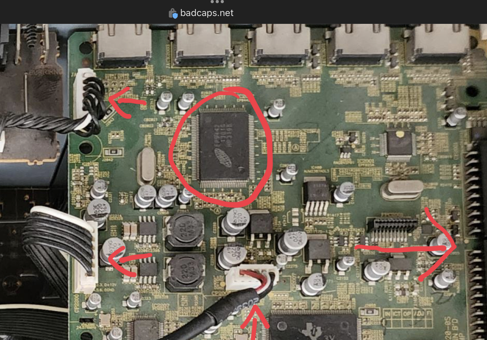

            • CapLeaker
              Leaking Member
              • Dec 2014
              • 8352
              Re: Pioneer VSX-324 suddenly the HDMI stops working
              Focus on the board attached below.
              First I would take the board out clean all connections and put it back in. Also verify if the HDMI problem is just one or all ports. Get yourself a can of air or dust spray. If you turn the can upside down you can freeze IC's or other components with it. Same with a hair dryer or similar, you can heat a part of the board and hopefully can find the problem that way.
