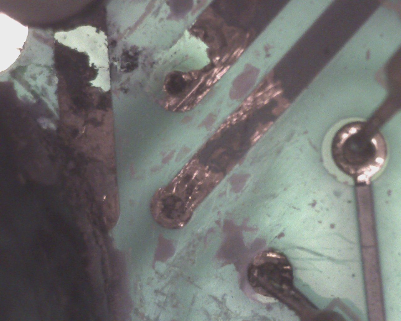

Looks like that whole area around D5 has overheated. C8 has some brown stuff caked on to the bottom as you can see in the photo. D5 was covered with the same or similar brown substance what I thought at the time was burned adhesive but doesn't make sense why D5 would be covered in adhesive in the first place. Measured D5 with a multimeter and got 0.62v so I assume it doesn't need replacing even after being covered with that crap?
Wondering if I should remove the burned adhesive on the board just to the right of R18? I read somewhere that it's conductive once browned but don't know how much truth there is to that. Got some conductive paste to repair the broken trace under R18. Do you think maybe the problem is just that broken trace?
Also, after taking out D5 I noticed that the holes for D5 and R5 are pretty close and looks like they'd join when I replace D5. I didn't notice this before removing D5 so I'm wondering if it's my rubbish soldering skills but then looking at the diagram in the photo it looks like they should connect perhaps? Sorry, so many questions and a complete electronics noob... but I'm enjoying it, so far
Re: Repairing Alesis M1 Active mk2 Monitor Speakers
As a rule of thumb, if an electrolytic says "VENT" on it, i don't trust it as far as i can throw it. Only (some of) the crap brands have that written on them; the good ones don't - coincidence?
I'd replace that, if only to save myself potential headaches down the road. And i'd recommend you use the method i did - relocate C8 to replace C14 next to the chip (and away from the heatsink), and add C14 back, on the bottom of the circuit board. It's in parallel with C8, so no worries there.
If the colour code matches the measured resistance, AND they're both the same, i'd call them good. Highly unlikely they'd both deteriorate to the same exact value, wouldn't you say? And their values aren't exactly critical anyway, they're there more for current-limiting purposes.
Why would D5 be covered in that crap? One reason - zero f**ks given during applying of said goop. But if it measures ok, and the legs aren't too corroded (from the goop), i guess D5 should still be ok.
Yes, remove as much of that adhesive as you can, burnt or not. Yes, it does indeed turn dark, brittle and conductive, as well as corrosive, which is, as i'm sure you can imagine, quite unhealthy for copper traces and component legs.

Hi guys. I was lurking around for year here. I love the forum and I finally had some spare time to check what's wrong with my Alesis M1 Mk2. In the past there was no time to fix them and they were usually blowing up just after warranty and it was actually cheaper (and faster) to buy new ones than to send them for repair. So I ended with 6 of them
Reading this thread I spent a few hours yesterday just to see what's wrong with them and most of that time - cleaning them. And I cannot emphasize enough of one of the advices in this thread:
REMOVE ALL THE GUNK YOU CAN. In my case 3 out of 4 speakers had good C8, but the gunk was dry and conductive. It measures between 80k and 200k Ohm when dry. Out of those 3 - one is the newer version with C8 moved away from the hot spot, but all of them developed fault in the very same place. I don't know If I will have time to diagnose and repair those and basically toroidal transformer + two bridges and some caps looks like a much faster solution. I'll remove the rest of the gunk (which is pain in the rear) and then start to read this thread again to look for pointers
If anyone is not yet convinced why you should remove the gunk - I am attaching a few pictures what happens under the gunk if you let it dry.Last edited by niripas; 12-30-2018, 06:49 AM.Comment

Hi niripas, welcome to the forums!
Yes, that's very typical of this conductive glue. Although the resistance is not enough to cause major current flow to melt traces, it is more than enough to bias transistors and thus wreck the circuit. It is also corrosive and will eat traces away over time.
So I concur with what you said - always remove that glue from electronics, regardless if it has gone conductive or not.
