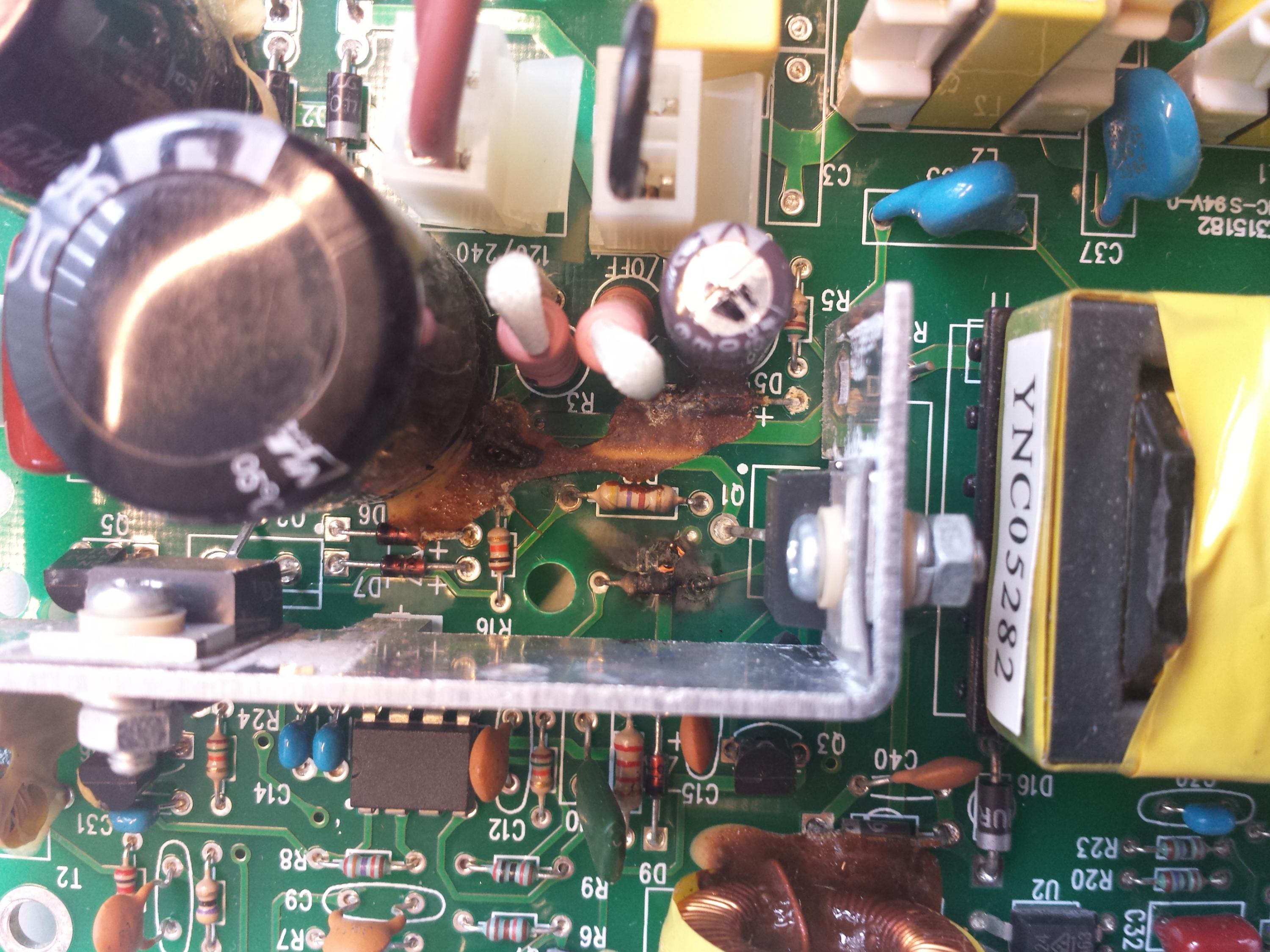

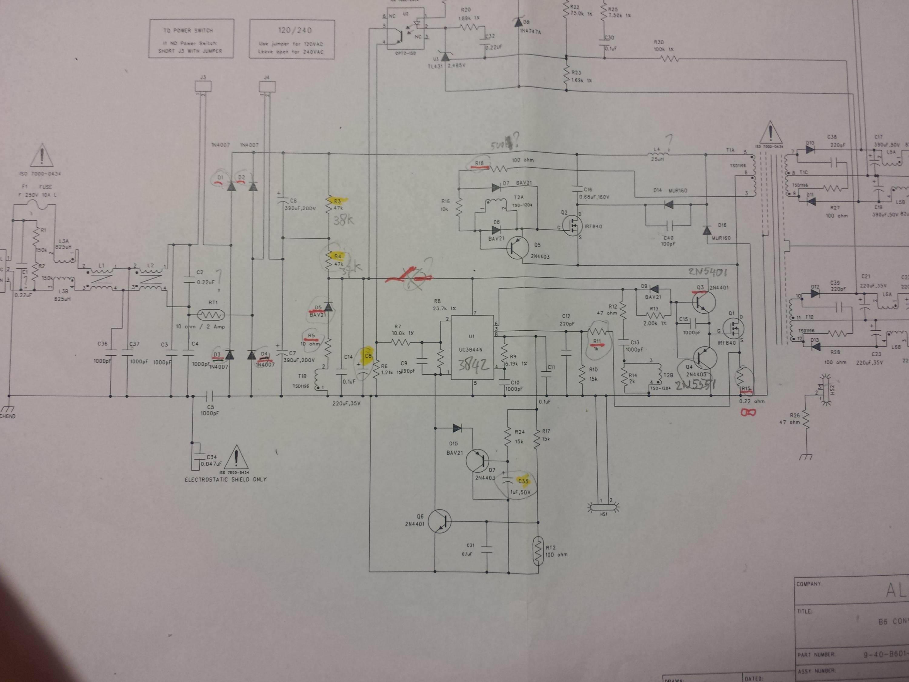

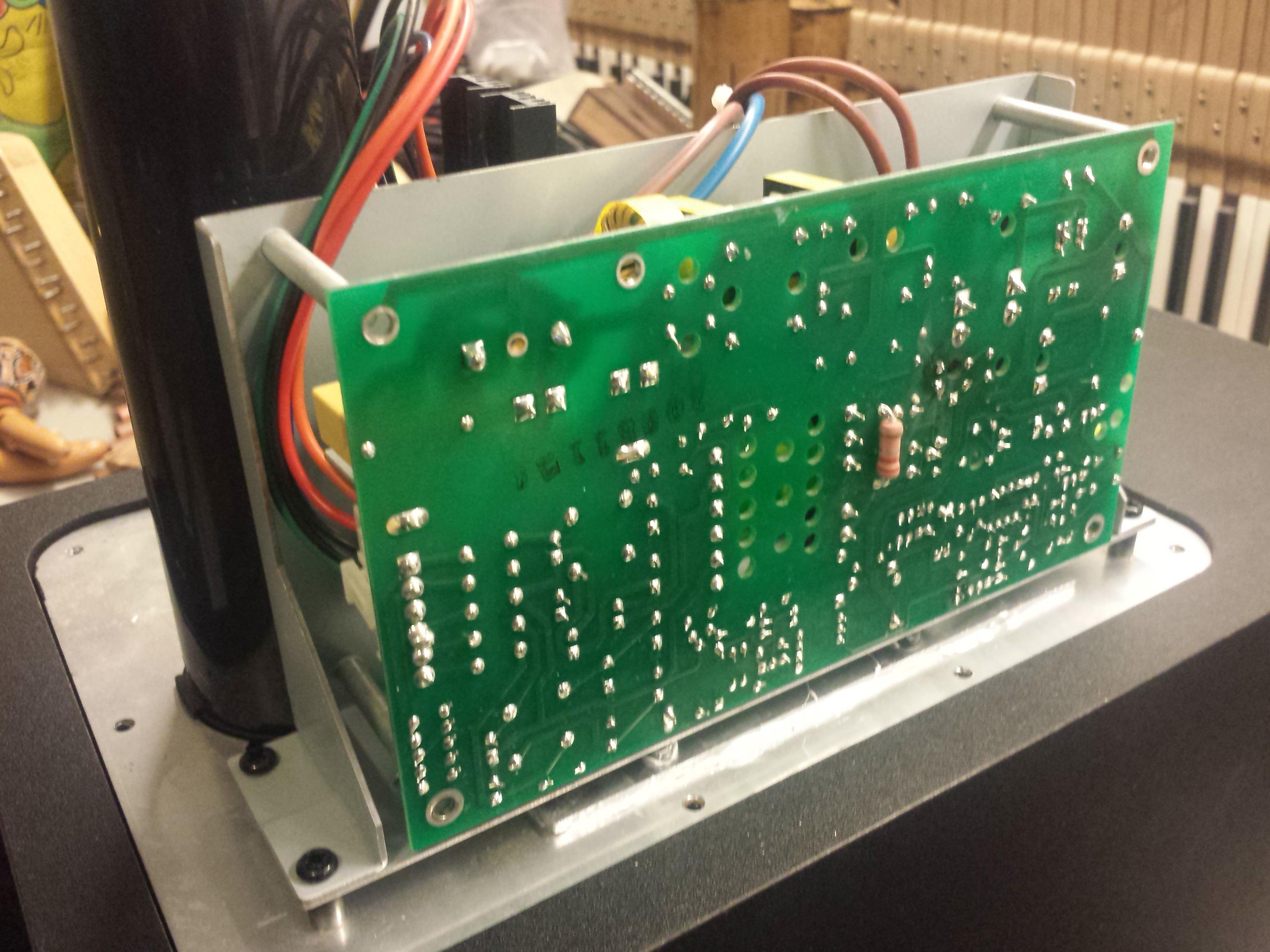

                                        Okay, here another alesis (try to) repear story
                                        I'm a newby here, read this hole post(which helps me already a lot!), some other sites and videos around repearing, I'm able to solder, know how to use a ohm and volt meter, but don,t have much knowledge of electronica. But I hope some masters can help/tip me to solve my issues.
                                        I bought 2 defect M1 620's which burn out fuse directly when powering on. The pcb/print of these have number 9-40-B601-E, which is also in the service manual of MKII(N8), so I guess this should be the same?
                                        One speaker has no visible damage, only replaced once the known C8 (still close to the hot R3/4) and C35, but don't know if this ever worked. I would like to start with replacing D1-4 and maybe C1-2, and order at least also uc3842, with foot..
                                        The other has burned places, like R11, D5, R5 and one burnedout line on the PCB(between +C8 and port7 of UC3844 and Q3, I think caused by blown R11 ), see in red in picture of scheme, Also from Q3 a part was broken off. In the picture of the scheme you see in red all parts which have visual damage, or easy to measure when on the pcb. In some cases I wrote what I found on pcb(other type/value)
                                        I was thinking about replacing at least al red marked parts and the yellow marked parts.
                                        But I still don't have a clue which could have cause this issues, do I have to replace more? Is the a chance all replaced parts will burn out again? Can/need I measure some more part? In- our outside the pcb? Should UC3844(conform scheme, in my case uc3842) be replaced? Could damage Q3 kill Q4/Q1?
                                        Some people have to exchange C1&2 together with D1-4, is the smart to do/order anyway?
                                        I can easy solder R3+4 on the back of the pcb for heatproblem, like R15, see picture. (I guess pcb in the 620 are mounted the other way as mkII? )
                                        They will maybe touch the glass wool, maybe I have to cut away? I guess it won't burn? And solve the heating problem?
                                        I'm not in a hurry, just a nice little project. I still have to order all parts.
                                        Well, I hope someone can help me a little :-)

                                          Step one - remove the visibly damaged components
                                          Step two - remove all of that crap brown (or black) glue; it dries out, it's corrosive and it turns conductive
                                          R11's the really-blown-up one in the middle of the third photo, right? In that case, there's a good chance the 3842's blown as well.
                                          Do you have a diode-test mode on your multimeter? That would / will come in really handy for double-checking some of the silicon components there.
