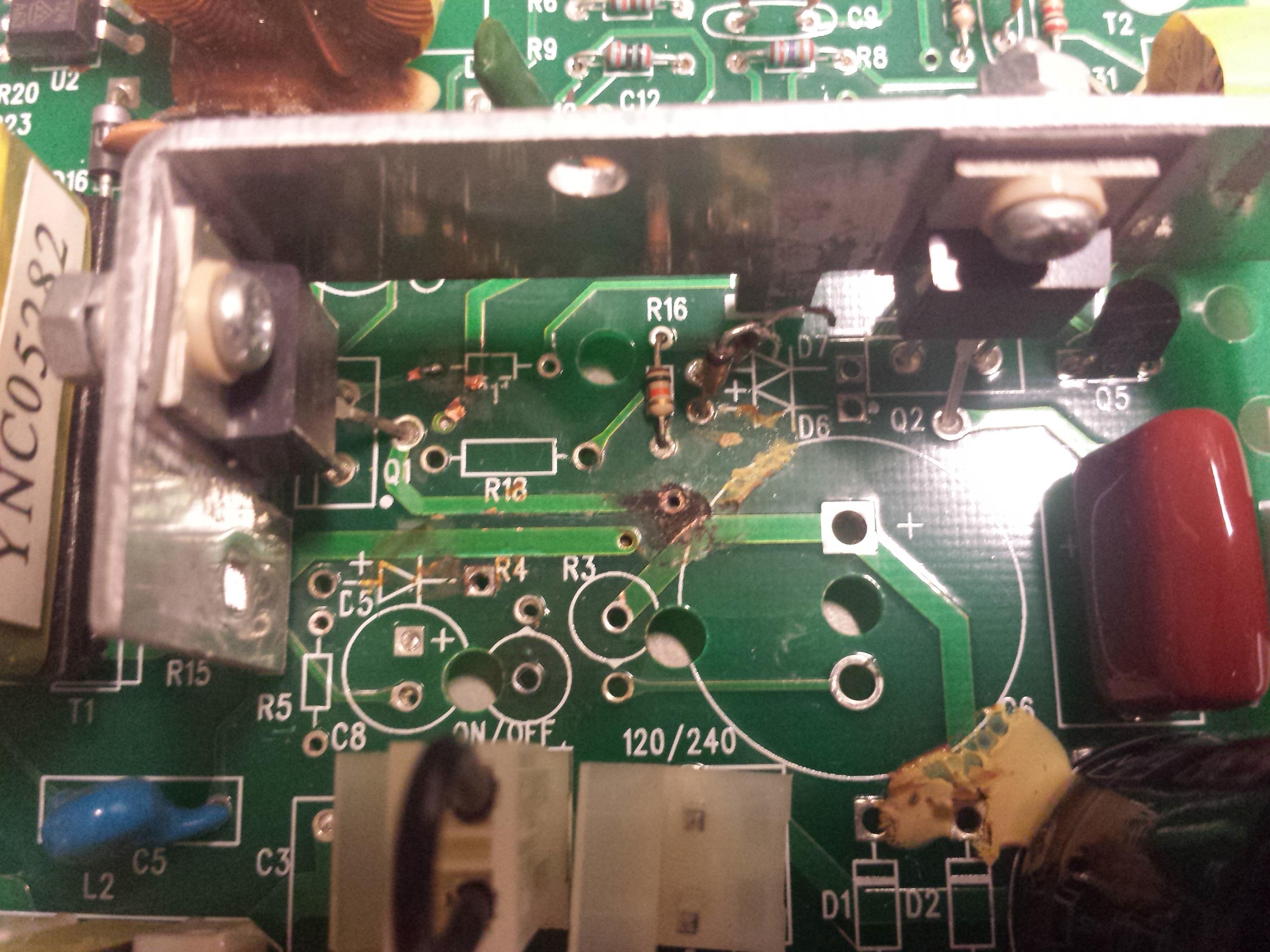

Step one and two done, see new picture. On the brown spot on the left of the + of C6 a little of the board burned/'eaten away', there's no shortcut and I don't think I have to isolate that extra or do soemthing with that? And yeah, R11 looks blown-up/burned.
My multimter got a diode-test. Which silicon(?) components I have to check? In/out board?
Thanks already for the very quick help!!! I don't have much time for this so won't reactie every time that quick...
