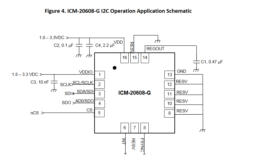

          Well, without the caps and the I2608D on the board, the only thing that heats is the main IC, a large 100pin ARM GD32F103 VBT6
          Also with the battery the led on the power button light powered on, but without the gyroscope, it's worth putting it all together?
          Also say that not sure if its a proper short, between the pins of the capacitors place there are 5 Ohms, continuity test on the tester makes it sound like a short, now I don't know if the gyro chip is bad or the ARM is bad.
          Will try to make some readings on the gyro chip to see if the Vin and GNT are shorted there and put back the caps on board to see if the power button gets alive with them on it.
          What a pain to work with this without any scheme...

            Well found at I2608D between Pin 16 VDD 3,3v and pin 13 GND are 1,8 ohms (tester threats that like a short), on board same pins 5,3 Ohms, should I consider damaged the I2608D?
            • lotas
              • Jan 2016
              • 4803
              • Russia
              Re: SDJ01RM vacuum robot not powers on, all dead
              Yes, the I2608D burned out, since there is a short circuit in the power supply and the processor is powered (3.3V) along the same line, it means that the processor got it if there is low resistance at 3.3v.

                  You have low resistance left on the line (5 Om) and the processor (ARM GD32F103 VBT6) is heating up - that means it is also short and it is also not working, you can check to unsolder it and if the resistance on the 3.3v line increases, you will have to change it too, but it has an internal firmware that you are unlikely to find.
