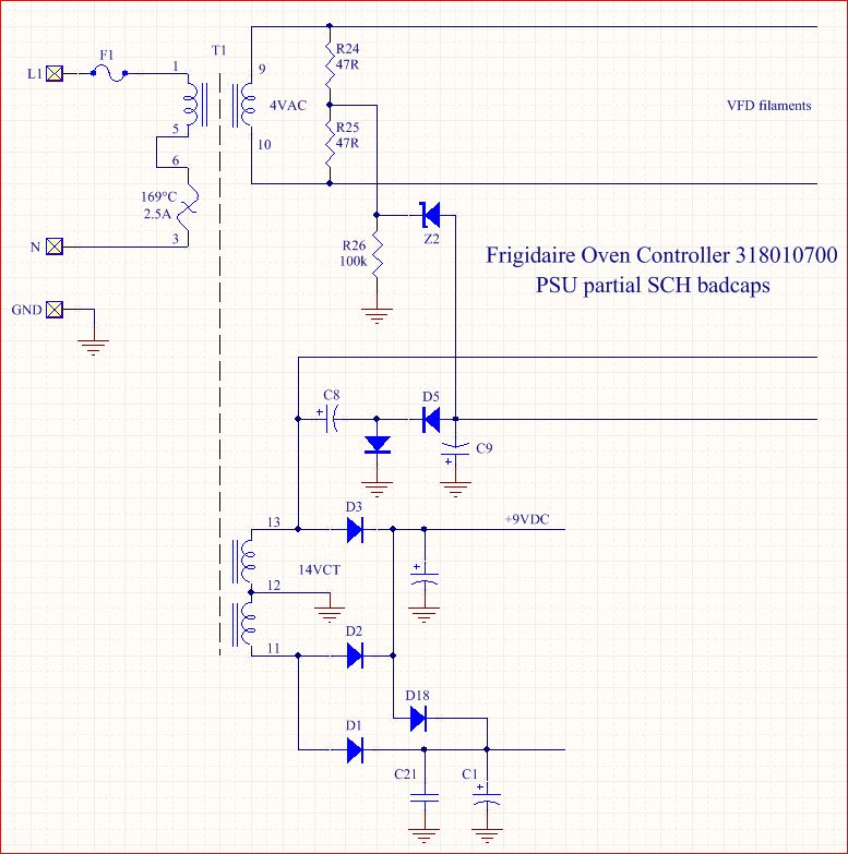

        So neither of the manufacturers have responded. Applianceboardrepair.com responded, but were of no help, only sending me links to irrelevant search results on mouser. Their last response was that they did not have a transformer, but if I sent the board in they would "patch it" for me. Not sure what they would "patch" it with considering the useless search results they sent me. Oh well.
        Anyway, I couldn't find an exact match for the fuse and didn't want to wait on AliExpress, so I ended up buying some 2.5A 126C fuses from Amazon for $10. I figured the amp rating was more important than the temp limit. Fingers crossed.

              Re: Dead Oven Control Board, Possibly Transformer?
              I drew a partial schematic and it all makes much more sense.
              This Frigidaire Oven Controller 318010700 oven control board transformer is a custom part, because the vacuum fluorescent display needs that additional winding - the filament winding.
              I would say estimate it is around 14VAC center-tapped as the board uses less common 9VDC relays. OP measures 18VAC but at no (relay) load, and 4VAC with the VFD connected?
              In a pinch I would use an off the shelf 14VCT transformer and a second (extra) transformer 6.3V and add two resistors to get the filament voltage down to what it should be.
              It's great the transformer survived. I read another forum that this is a common failure mode - any power line surge causes these oven boards to collapse and then cook the transformer. I'm still puzzled about what causes the transformer to overheat. There is an additional primary fuse F1 so I would expect that have protected the transformer but the design fails here F1 should only be around 1/2A max. it must be way over that.
              I would say if you can't get a replacement thermal fuse, it is acceptable to add a (proper) normal fuse on the transformer's primary for F1. I use around 1/4A to 1/2A slow blow.

                    Nice, thanks for the analysis. If I continue to have issues with the thermal fuse, I will consider replacing F1 with a 0.25-0.5A slow-blow fuse and see if that spares the thermal fuse. Hopefully I won't have to rig up a two transformer system.
