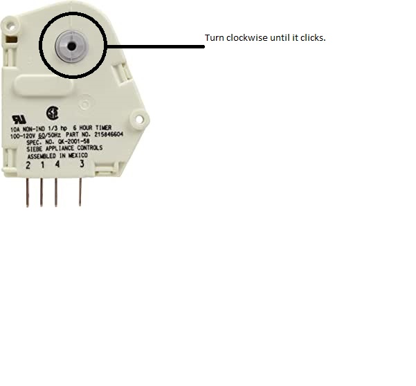

Hitachi Refrigerator R-Z270AUN7KV not cold.
  • SuperAman
    replied
    Re: Hitachi Refrigerator R-Z270AUN7KV not cold.
    Originally posted by R_J
    The defrost timer is likely located on the lower part of the rear of the fridge, It will not be inside a compartment. Here is the location of mine, take a picture of the rear of your fridge if you can't locate it. When I checked the model of your fridge, the defrost timer for it is the one I posted in the picture, The original is likely black not white.
    I don't see anything like that on my fridge. Here is a picture with the pan removed.
    Last edited by SuperAman; 11-15-2020, 10:08 AM.
    Leave a comment:
  • R_J
    replied
    Re: Hitachi Refrigerator R-Z270AUN7KV not cold.
    The defrost timer is likely located on the lower part of the rear of the fridge, It will not be inside a compartment. Here is the location of mine, take a picture of the rear of your fridge if you can't locate it. When I checked the model of your fridge, the defrost timer for it is the one I posted in the picture, The original is likely black not white.
    Last edited by R_J; 11-11-2020, 09:37 AM.
    Leave a comment:
  • SuperAman
    replied
    Re: Hitachi Refrigerator R-Z270AUN7KV not cold.
    Originally posted by R_J
    It will do it again, you just proved the defrost timer is likely not working. It needs to cycle the defrost element every few days to keep the ice from forming.
    You can operate the defrost cycle manually to melt the ice.
    Thank you. Is the defrost timer located in the freezer or fridge compartment? I don't recall seeing anything that resembled that in the freezer compartment.
    Leave a comment:
  • R_J
    replied
    Re: Hitachi Refrigerator R-Z270AUN7KV not cold.
    It will do it again, you just proved the defrost timer is likely not working. It needs to cycle the defrost element every few days to keep the ice from forming.
    You can operate the defrost cycle manually to melt the ice.
    Last edited by R_J; 11-08-2020, 09:41 AM.
    Leave a comment:
  • SuperAman
    replied
    Re: Hitachi Refrigerator R-Z270AUN7KV not cold.
    Originally posted by R_J
    One thing to check is if the defrost timer is working, What can happen if it does not cycle, ice can build up around the freezer and block the air flow to cool the fridge. I have a fridge with a similar defrost timer and if the motor in it stops running, the fridge will not get cold. The timer should be located on the rear lower right, you can cycle it manually using a large flat blade screwdriver. If the fridge is indeed frozen up, you may need to turn the defrost timer until it clicks and the heat element comes on and do this a couple times, You should then see or here water running into the pan under the fridge.
    If this is the timer, you can turn the grey knob with a flat blade screwdriver clockwise. until it clicks, If the compressor is running at the time it will turn off.
    There was a buildup of ice on the coils. Cooled it down, melted it with boiling water. Now with the fridge and freezer set to the lowest settings, it has been working fine.
    Leave a comment:
  • R_J
    replied
    Re: Hitachi Refrigerator R-Z270AUN7KV not cold.
    One thing to check is if the defrost timer is working, What can happen if it does not cycle, ice can build up around the freezer and block the air flow to cool the fridge. I have a fridge with a similar defrost timer and if the motor in it stops running, the fridge will not get cold. The timer should be located on the rear lower right, you can cycle it manually using a large flat blade screwdriver. If the fridge is indeed frozen up, you may need to turn the defrost timer until it clicks and the heat element comes on and do this a couple times, You should then see or here water running into the pan under the fridge.
    If this is the timer, you can turn the grey knob with a flat blade screwdriver clockwise. until it clicks, If the compressor is running at the time it will turn off.
    Last edited by R_J; 10-29-2020, 05:22 PM.
    Leave a comment:
  • petehall347
    replied
    Re: Hitachi Refrigerator R-Z270AUN7KV not cold.
    manual says ..Is the cold air vent blocked with food?
    Leave a comment:
    replied
    Re: Hitachi Refrigerator R-Z270AUN7KV not cold.
    The lower section get the cold air form the freezer section, so look for opening in the bottom section of the fridge to see if there is any obstruction, also look for a fan that circulate the cold air from freezer to the lower fridge section.
    Show us the pictures of the internal chambers of the fridge.
    https://www.gfyappliancerepair.com/b...-freezer-cold/
    Last edited by budm; 10-29-2020, 02:57 PM.
    Leave a comment:
  • SuperAman
    started a topic Hitachi Refrigerator R-Z270AUN7KV not cold.
    Hitachi Refrigerator R-Z270AUN7KV not cold.
    Hi, I have a Hitachi Refrigerator R-Z270AUN7KV. The fridge is on the bottom and the freezer is on the top. My problem is no matter what setting (1-9) the freezer is, the fridge is not getting cold but the freezer is always cold. I have tried all combination of settings for the fridge (Min, Mid, Max) but nothing. Fridge is always hot now. Before it would sometimes do this but now always fridge is hot. I believe the service center peeled some of the foil from the thermostat and that seemed to help a few years back. I replaced the thermostat recently and it worked off and on for a few weeks but now fridge is always hot and freezer cold for the past week.
    Last edited by SuperAman; 10-29-2020, 02:03 AM.
  • Th3_uN1Qu3
    Cooling upgrade on refrigerator. If it works, it ain't stupid!
    by Th3_uN1Qu3
    I had this refrigerator at my old folks which I noticed I would put my beer or soda in and take it out warmer than I'd brought it from the store.
    Now, I don't know much about refrigerators or HVAC but to me it seemed like we have a problem. I threw a thermometer in... 20 deg C in the fridge. WHAT THE... Freezer worked fine with temperatures way below zero, as it should, and it has only one compressor for both sides so it got me scratching my head for a while.
    Only other things that seemed a bit odd was that the heatsink on the back was barely warm and the...
    09-03-2023, 06:29 AM
  • connorcc2005
    Kenmore refrigerator adaptive defrost timer fix. Part: AP4909015
    by connorcc2005
    I have a 20 year old Kenmore side by side refrigerator that was acting up with the following issues:
    • Evaporator coil in the freezer was frozen up.
    • Unit was still holding temperature
    • Evaporator fan would run 2 to 3 seconds on then shut off only to repeat.
    Defrosted the evaporator coil and began testing. Defrost heater ohmed out good. Defrost thermal switch on the evaporator line in the freezer tested good. Once the evaporator coil was defrosted, the freezer and fridge worked but the fan continued to cycle on and off continuously. I suspect the evaporator coil was destined to freeze up again...
    03-20-2024, 01:14 PM
  • CG2
    Liebherr Fridge Freezer KGT 3456 not working
    by CG2
    To be a bit more specific, I've got a 20-ish year old Liebherr that has just stopped working. This was quite a sophisticated beast for its time. It's a twin compressor model, and you set the desired temperatures of the fridge and freezer parts from a couple of little control panels above the door. It displays the actual temps on some eight segment displays there, flashing if it's working to get to where you want it. There's a control board with a microprocessor on it that read the temperature from a couple of sensors, switches the compressors on as necessary, and runs the display. There's also...
    01-25-2023, 02:12 PM
  • mikey5791
    Help repair Panasonic fridge not cooling
    by mikey5791
    Hi all forum members,
    Few days ago, i might have forgotten to close my home fridge freezer door completely. The next day, the ice cubes and frozen meat almost melted halfway and the freezer doesn't feel cool. I shut it off, wipe dry and let it air dry for one whole day. The next day i switched on the fridge, the compressor run for a second and it shuts off(no vibration and no sound at all) only the internal freezer compartment fan is running but is not cooling even i switched on a full day.
    After shut off, i dismantle the rear water pan holder and reached to the compressor wiring....
    07-16-2025, 02:01 AM
  • beetle1303
    Panasonic Inverter Refrigerator model NR-BY602XS - suddenly not cold overnight
    by beetle1303
    I have a 7-year old Panasonic inverter refrigerator model NR-BY602XS that went from working normally to completely not cold air overnight (both freezer and refrigerator compartments...
    The service manual instruction on Self Diagnostic Test seems to indicated Compressor faulty or locked. But the compressor seems to be working with humming sound and vibrating at variable speed and noise level..
    Everything else seems to be working normally - power cycled a few times has no effect. All the interior lights, and fan are working. I dismantled the interior panel to expose...
    04-18-2020, 08:12 AM
