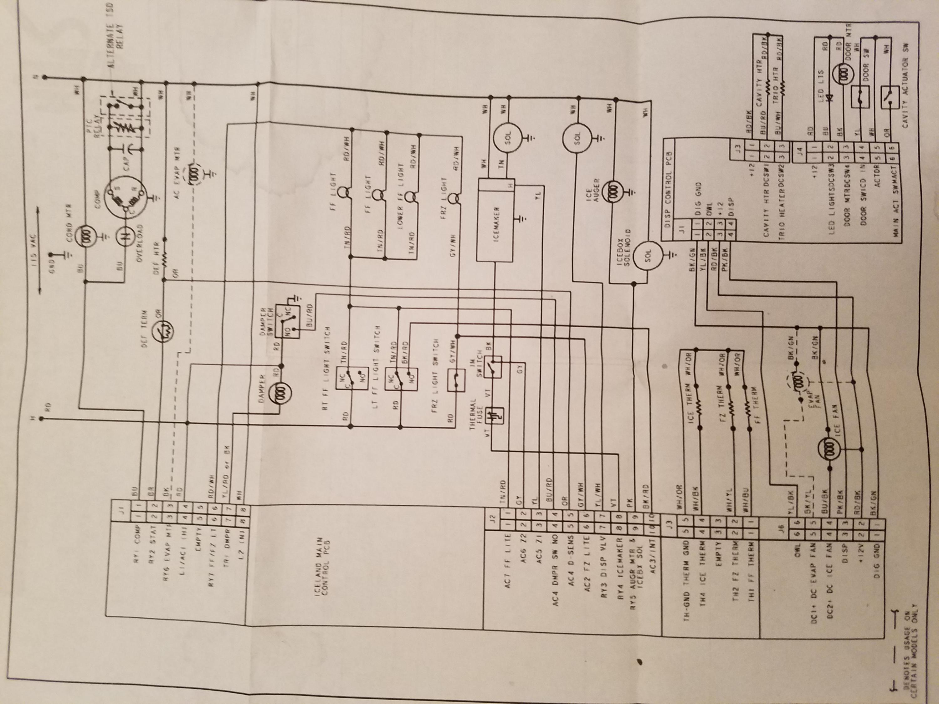

      Refrigerator: Whirlpool Gold Series
      Model Number: gi5svaxvl01
      Looks like the board has been worked on before.
      Pin number 4 on in the area of visible trouble looks to be soldered to an exposed bit of copper on the circuit board. (See picture) Was this a viable repair choice, or is it a potential cause of the fridge not working. And I guess the deeper mystery . . . What happened with this pin / area of exposed copper to begin with?
      Next to the pin, I noticed someone has wrapped a small piece of copper wire from one end of the resistor to the other. Clue to what's going on?
      I used isopropyl alcohol to clean up the burn residue and I used a soldering iron to bring the solder from pin 4 to the exposed copper. The previous effort to connect to the exposed copper with solder (before I had the board) had become detached. I had no idea what I was doing. I think I made a solid connection and I don't think I messed anything up . . .
      Tried plugging it back up and the fridge lights came on. That's all. No control panel to set temps, etc.
      I found the fridge schematic and wiring diagram. I really have no idea what I'm looking at, beyond recognizing it's pen #4 on the 8 pin part that is possibly the trouble spot. (See pictures)
      Any feedback or thoughts are appreciated. Again . . . all of this is WAY out of my league. I'm trying to learn.

            Re: Refrigerator Control Board WPW10310240
            I would remove that wire across R62, the resistor is 470k and the wire is not a good idea. Then I would check the red fuse
              I was on page one and noticed the resistor, then saw page two and your better photo of it, just wow!
              Anyway, now that it is removed have a look at the two circled areas.
              Looks like the fuse has arced over (small red circle) so check it, maybe it is open as R_J suggests.
              Then the soldering in the big circle looks like whoever had the bright idea with the resistor also did some soldering.
              But soldering with what I have no idea, certainly not a soldering iron!
                It looks like the relay M1 connects Pin1 Compressor to pin 4 A/C Line. Check if the fuse is ok, if it is, check for voltage across C5 (160VDC) Or you can check if you have any voltage across C12,C13 or C14
                It looks like someone has removed D5 at one time, I would check it and the other diodes in that area.
                  Big capacitor C5 is way crooked! too crooked... and there is felt pen markings on the board so someone has replaced it, likely with a part too tall. D5 is pushed over as well. Like somebody tried to stuff the board in afterwards to make it fit.
                  I see that PCB trace melted on the connector run to the compressor relay, so there must have been an overcurrent. I would see if the compressor is not bagged?
