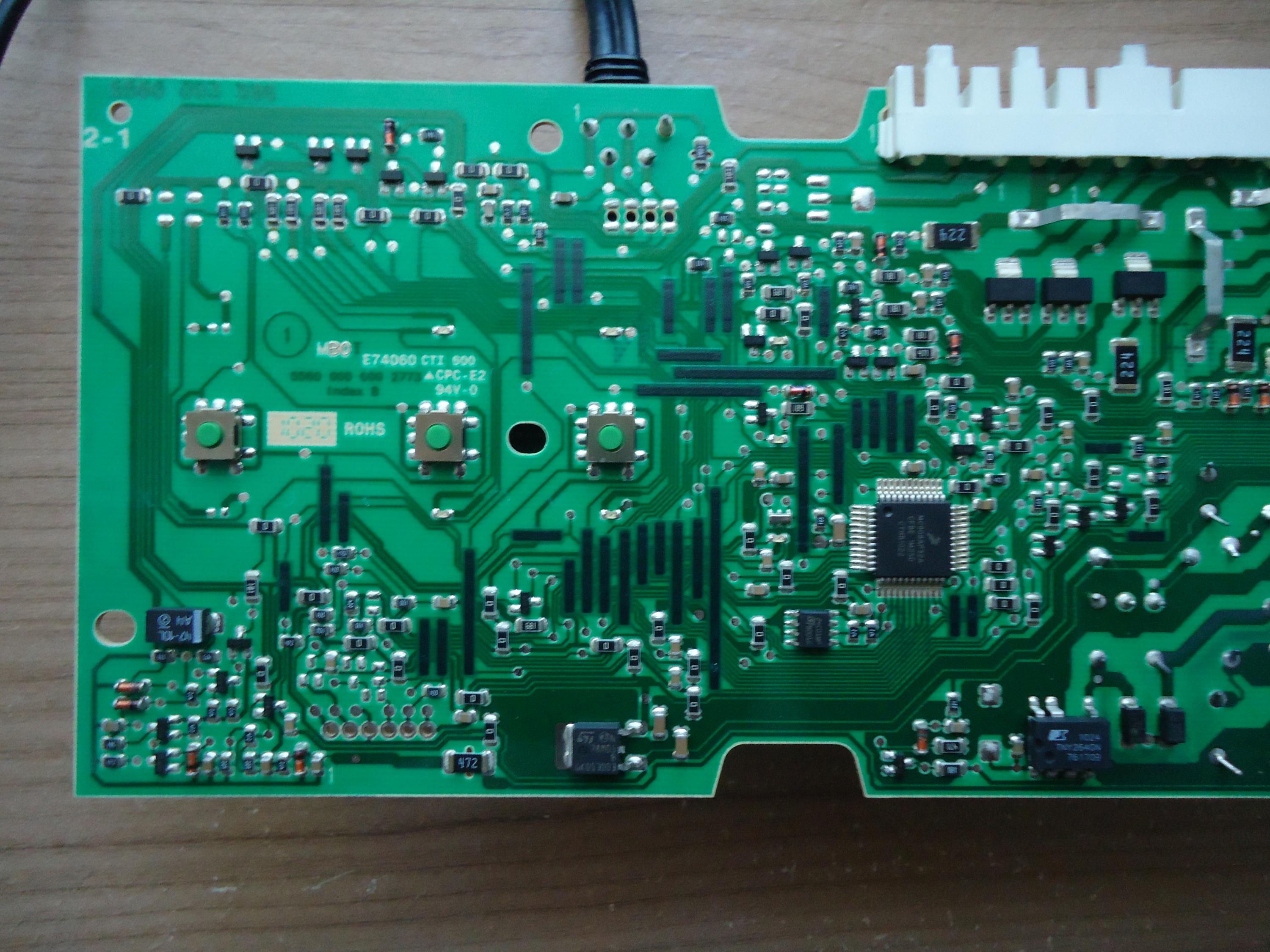

Bosch washing machine dies after 15 seconds
  • Audison
    • Sep 2016
    • 46
    • Slovenia

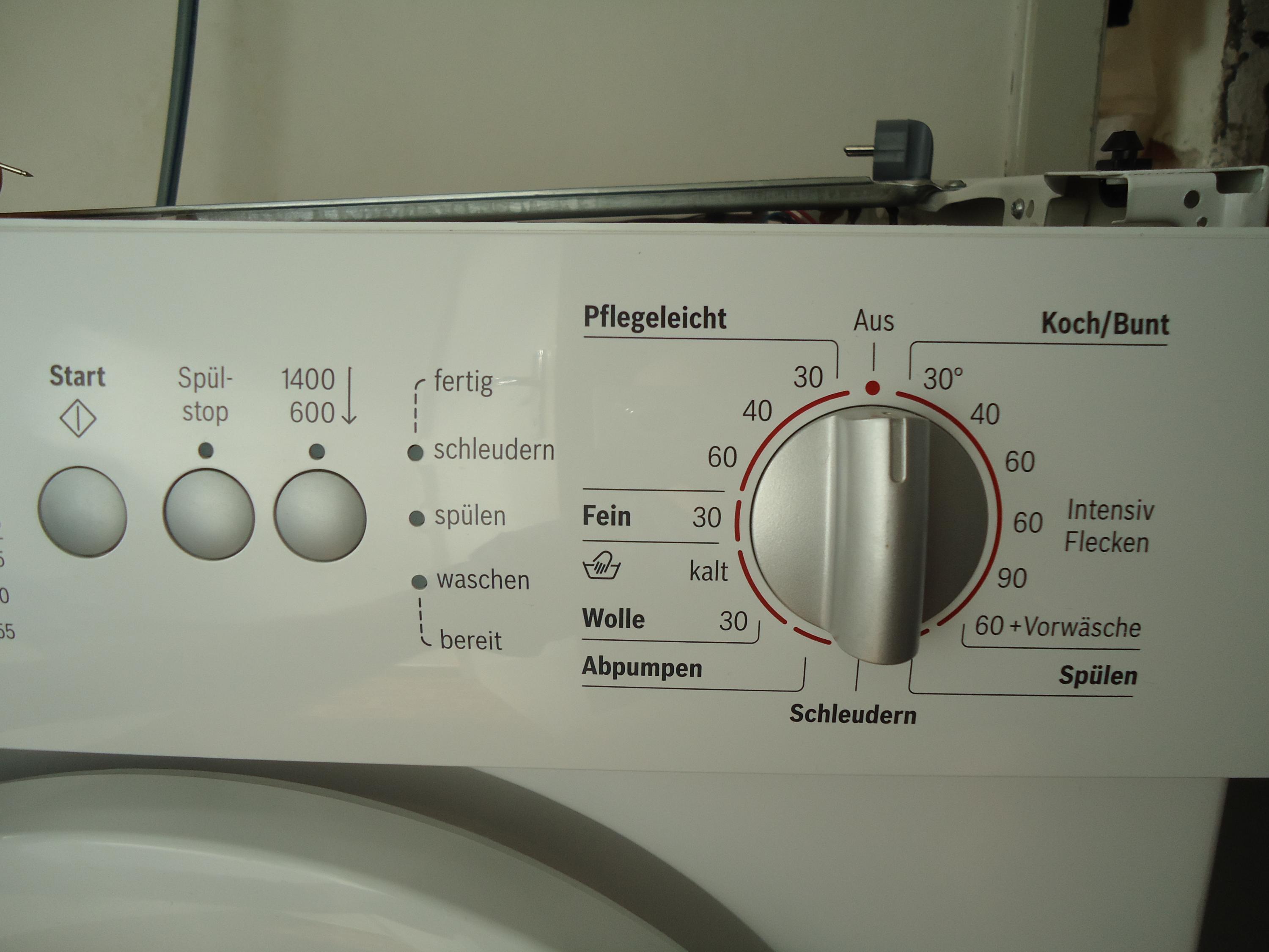

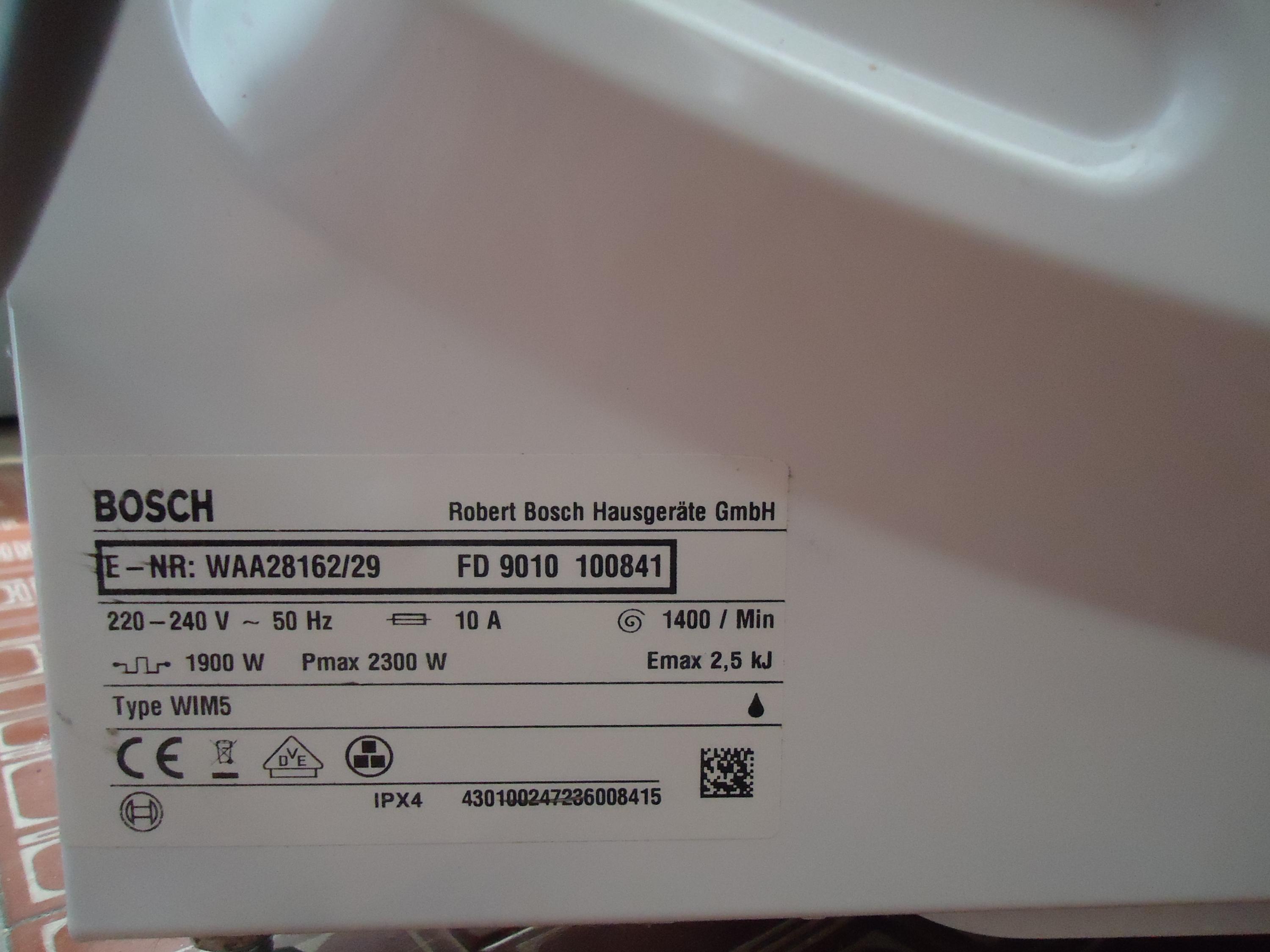

    When I select program waschen light pulses like it does normally and than just dies. If I try to start the program immediately than the program starts and dies after a few seconds. How do you even figure out what is wrong, there is nothing to check? Or am I missing something? Images in the attachments...

    if not, get the circuit board out of the casing and look closely at it.

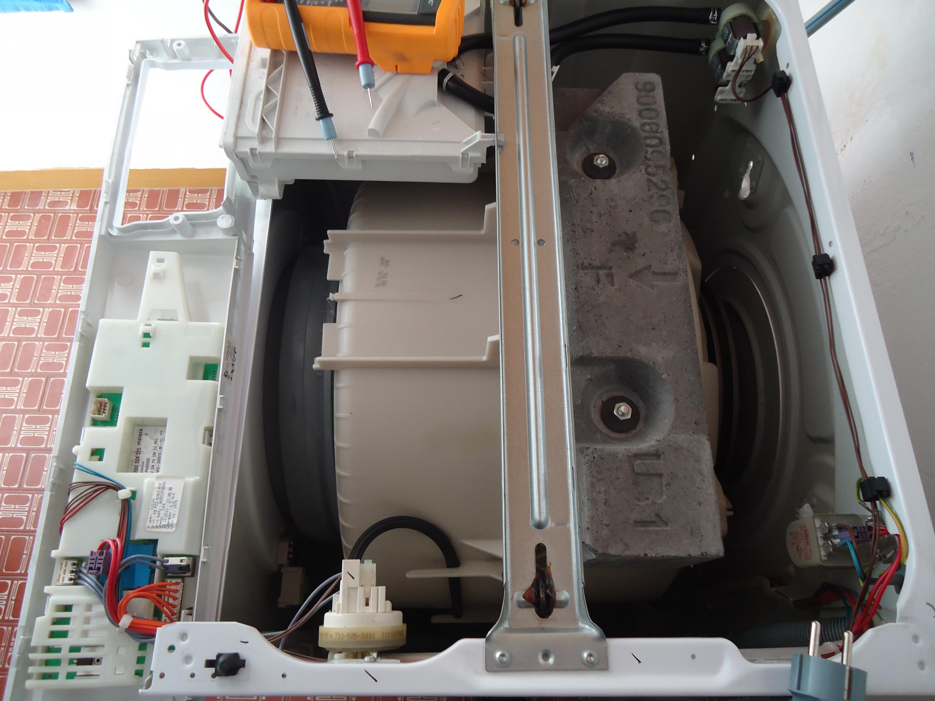

        Re: Bosch washing machine dies after 15 seconds

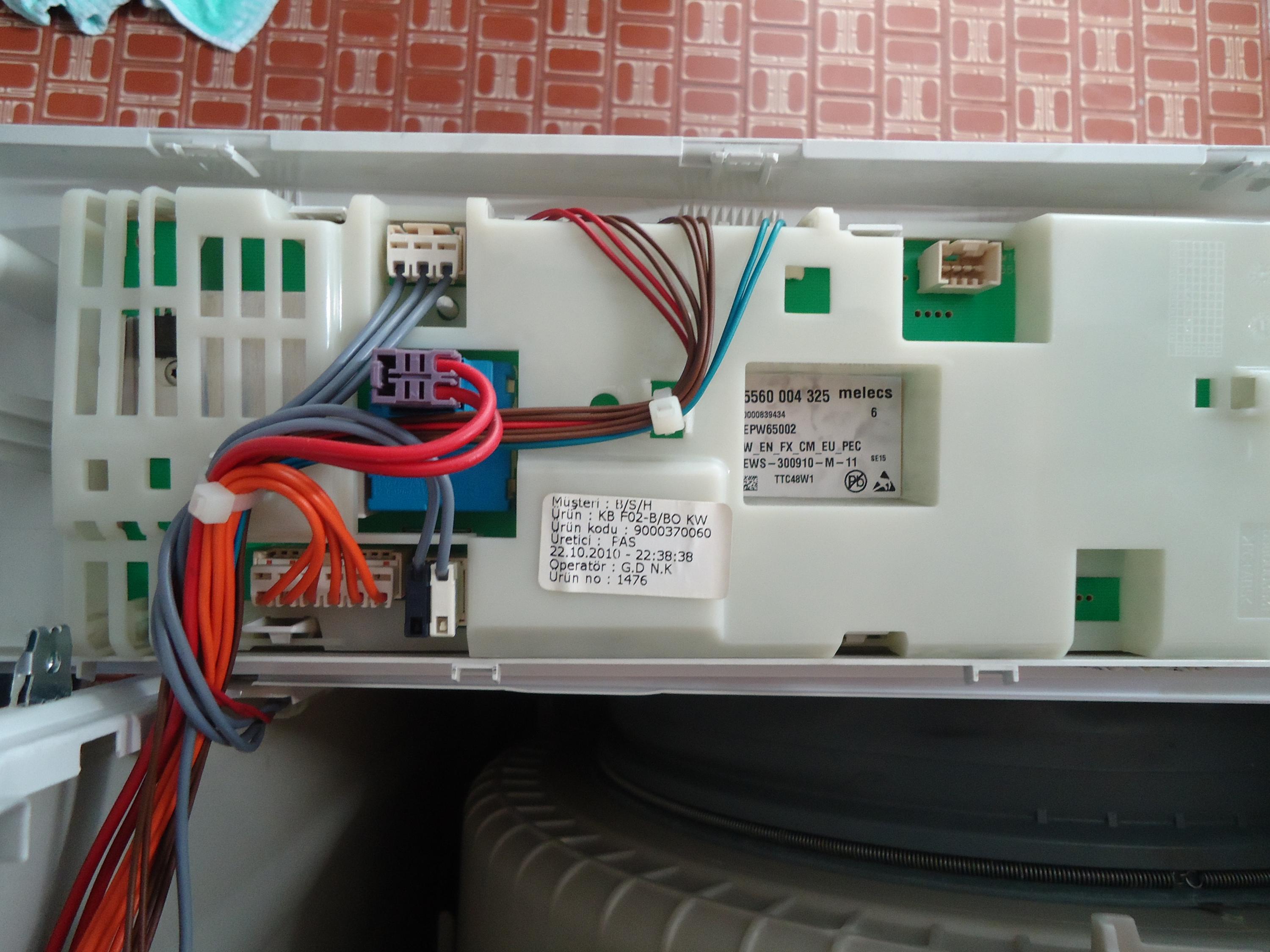

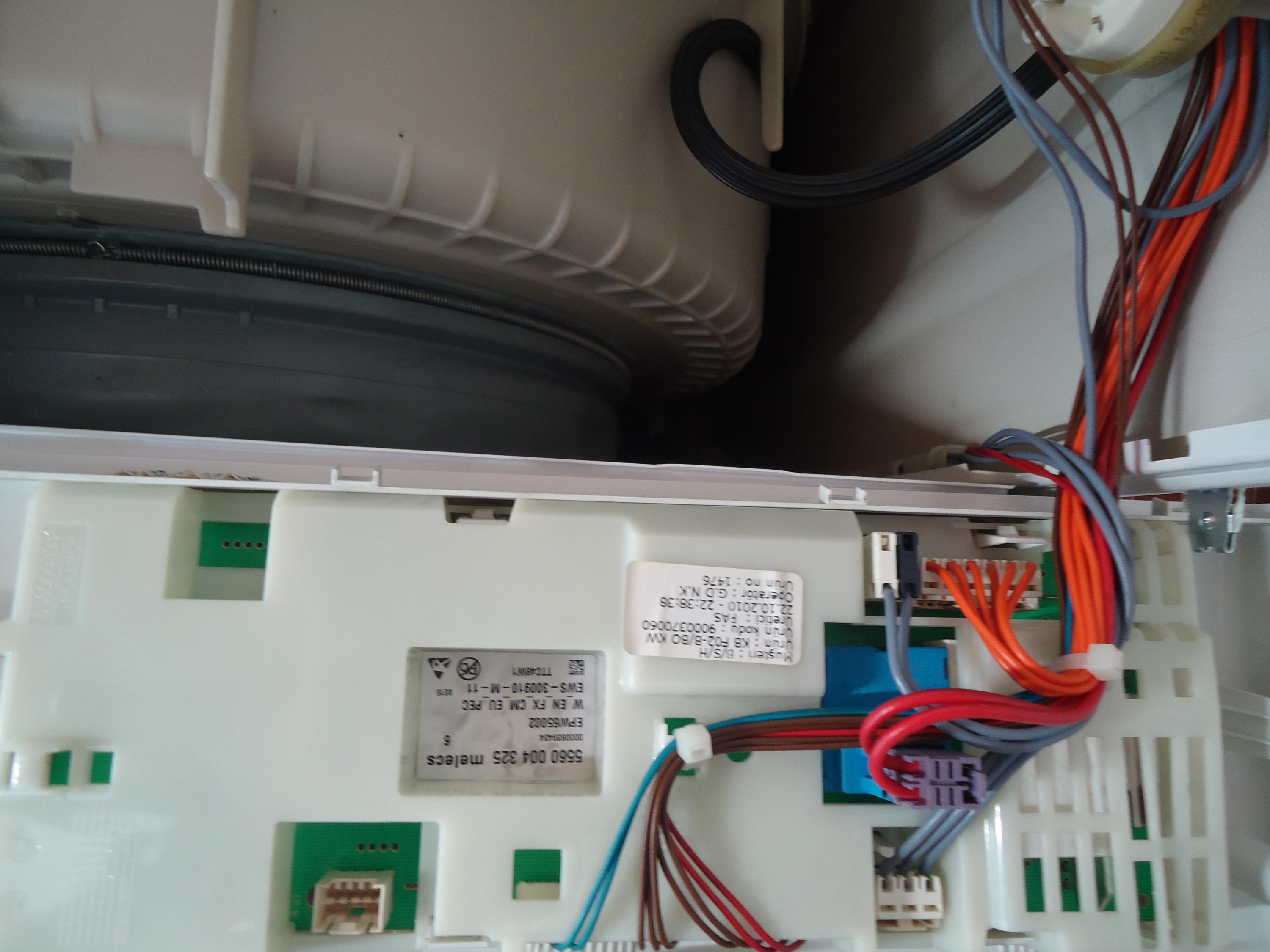

        There's nothing to check because the board you are looking for is inside the machine. That's just the front control panel.
        Dies ? Stops spinning or lights go off ? Could just be the brushes.
          Only 2 year warranty that expired already. For this model you needed to buy extended warranty for 50 € for additional 3 year warranty...

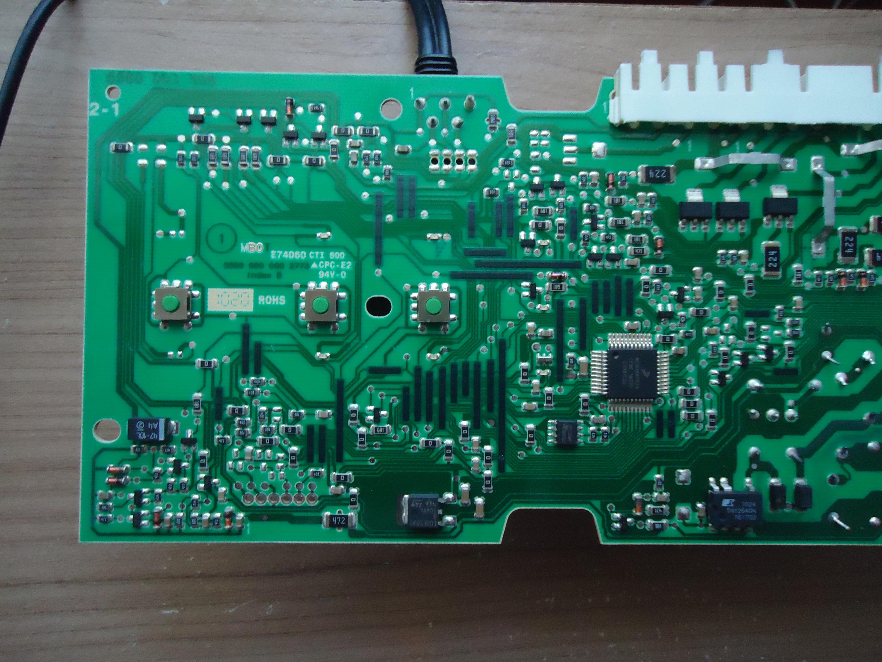

          Took out circuit board and it looks good visually
          Also I am not from Germany but looks like the supplier of the shop where we bought this washing machine imported it from Germany...
          Everything turns off. Than I have to disconnect it for a minute and connect it and it works again for 15 seconds...

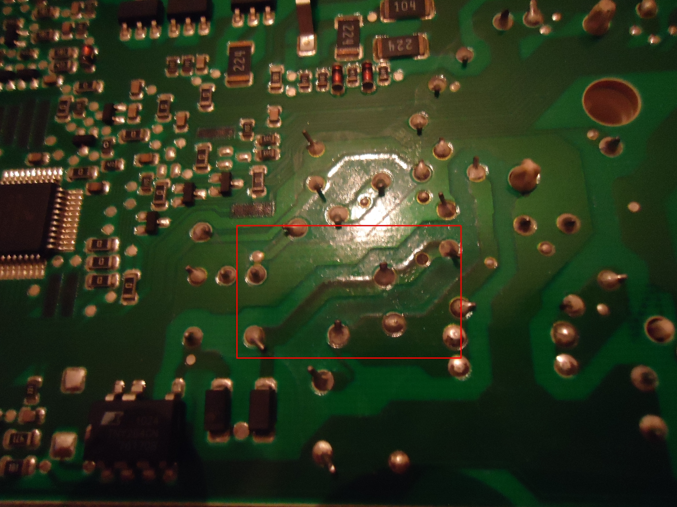

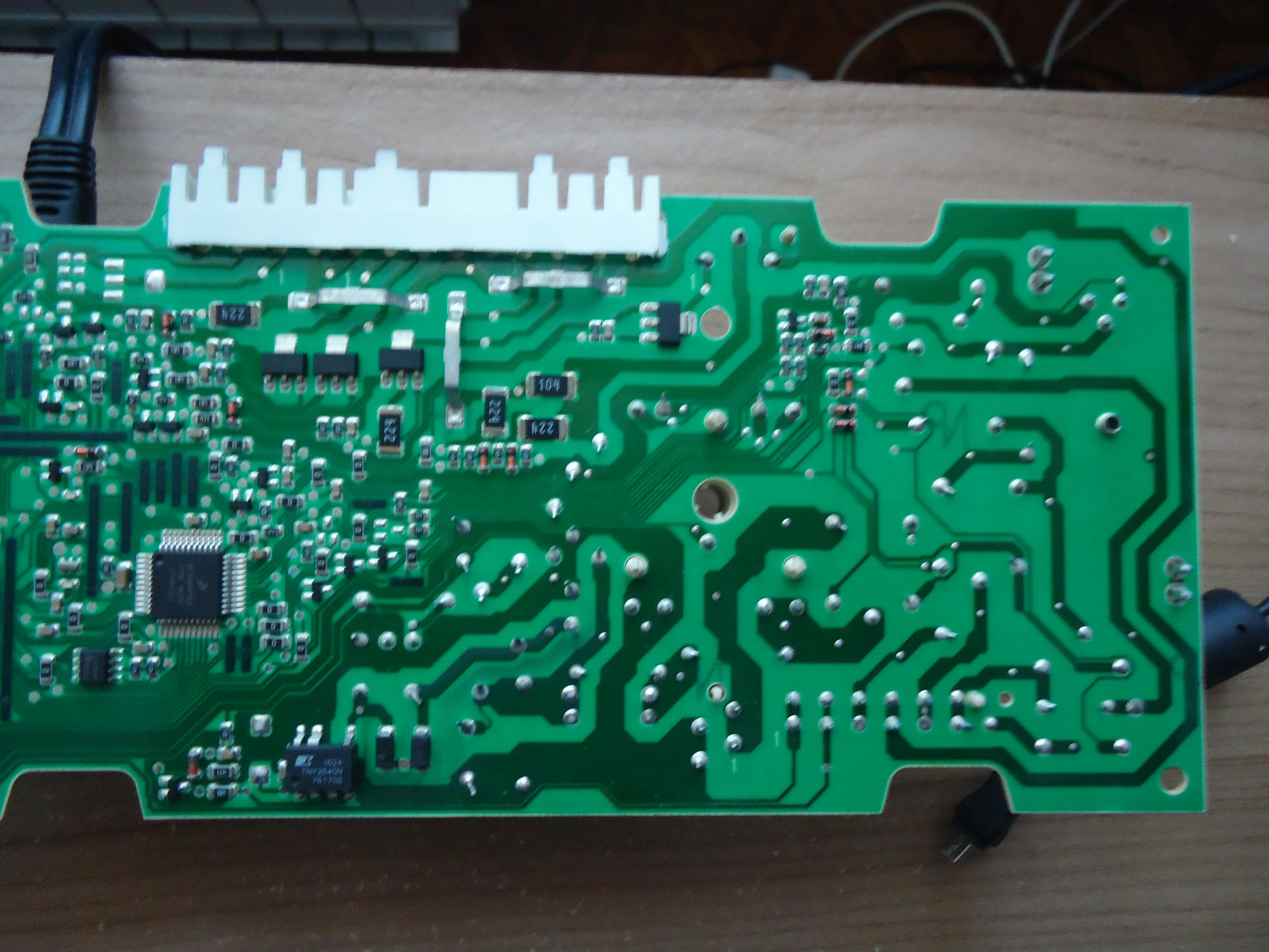

              • 31080

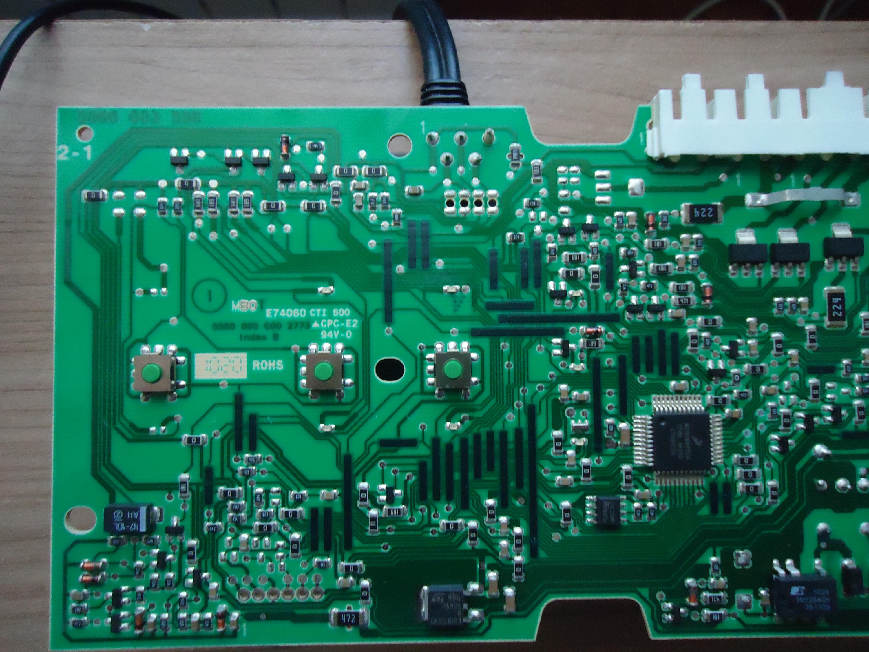

              look very closely at that board, it has some cracked soldering.
              • Audison
                • Sep 2016
                • 46
                • Slovenia

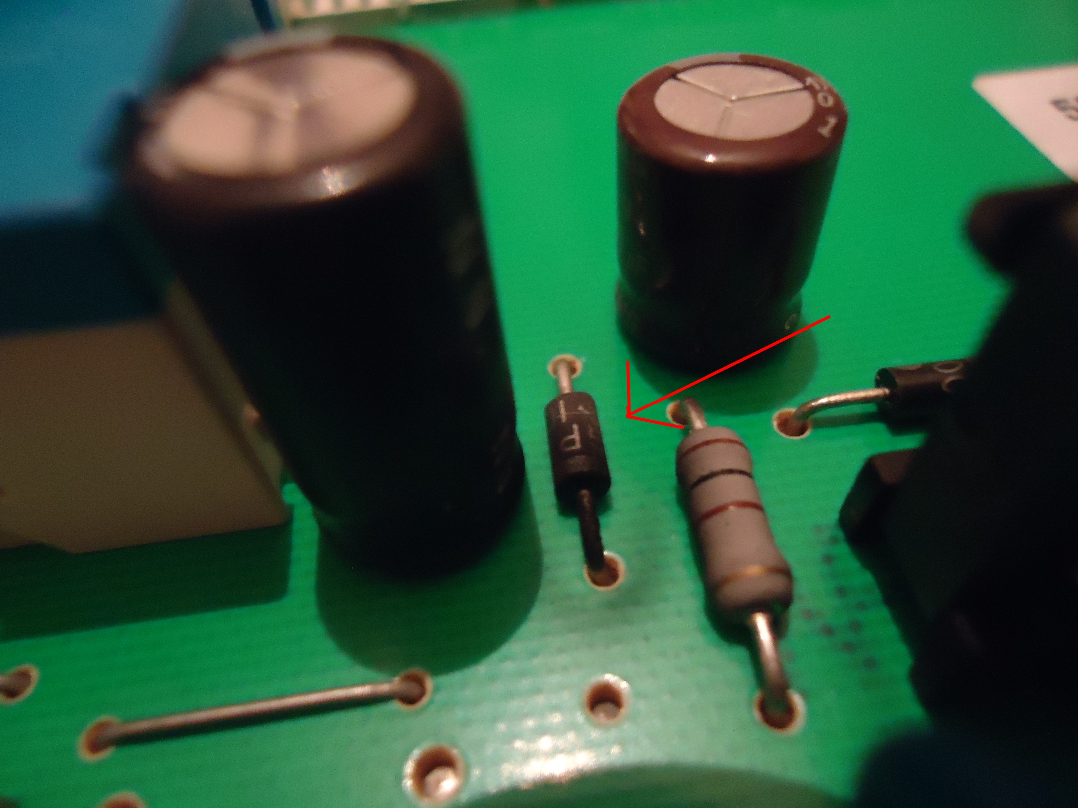

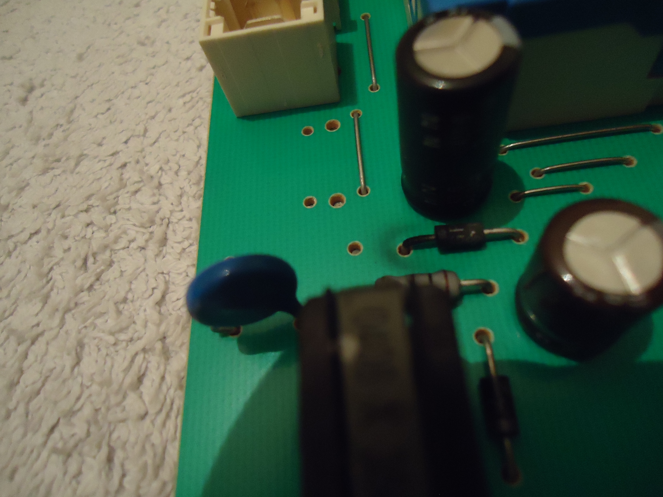

                After a closer look I see now that there are some elements burned :O
                Is this fixable? What kind of elements are they? I will try to remove them from the board tomorrow...
                Also what cause them to burn? it's something else broken on the washing machine or just fired because poor elements quality??
                • redwire
                  • Dec 2010
                  • 3910
                  The high-voltage on that attracts dust and dirt, humidity, the diode looks black from oxidization, I do not think it looks burnt. It should be OK but you can test it.
                  Check the board for bad solder joints on all the big through-hole parts like relays, connectors. Number one problem with appliance boards.

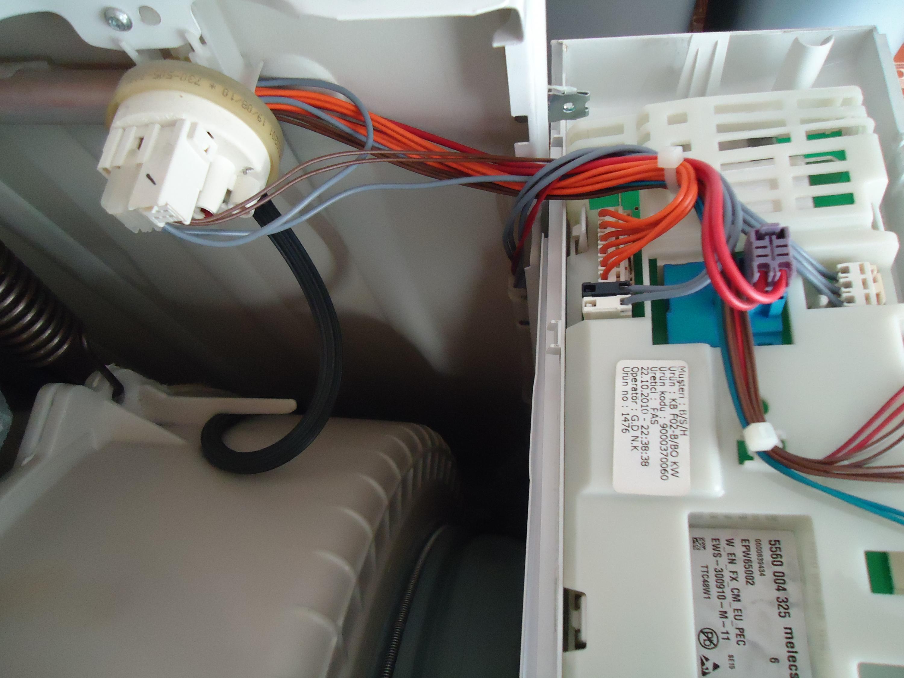

                    look up your model number there will be a test mode . it will tell you where the fault is .
                    check motor brushes . and check for broken wires . see if door lock is working . check pump is not blocked and can be spun easily .
                      The model number is WAA28162 (Bosch Classixx 5) but I can't find the test mode...

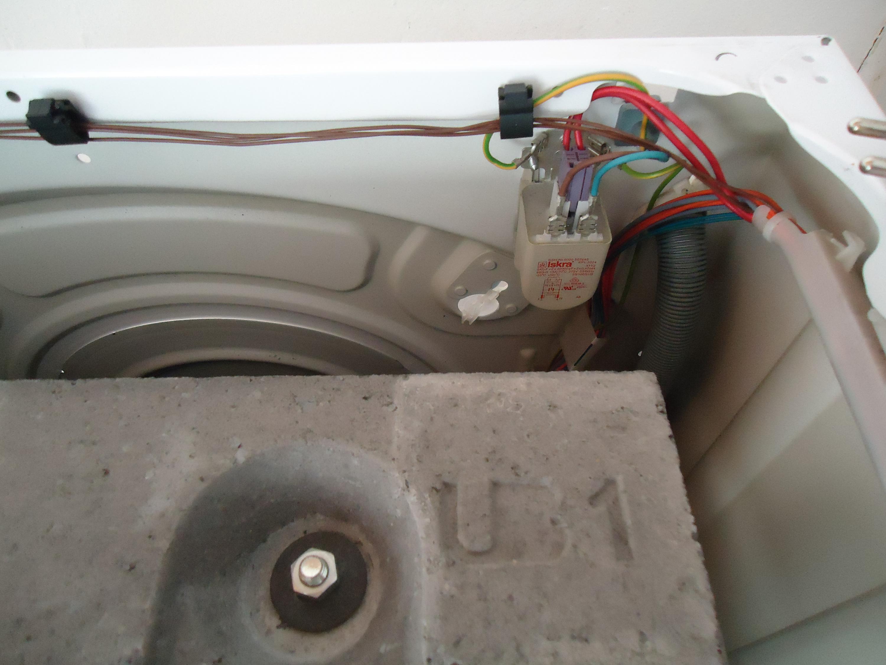

                      I checked everything motor, broken wires, door lock and pump and all works fine.
                      Also tried running the cold water program and tried to disconnect one connector at the time to see if I can find what the problem is but every time is the same. The program continues running but after one spin it shuts down. If I disconnect the power and reconnect it after the door unlocks in will work again for one spin and shut down again...
                        • 31080

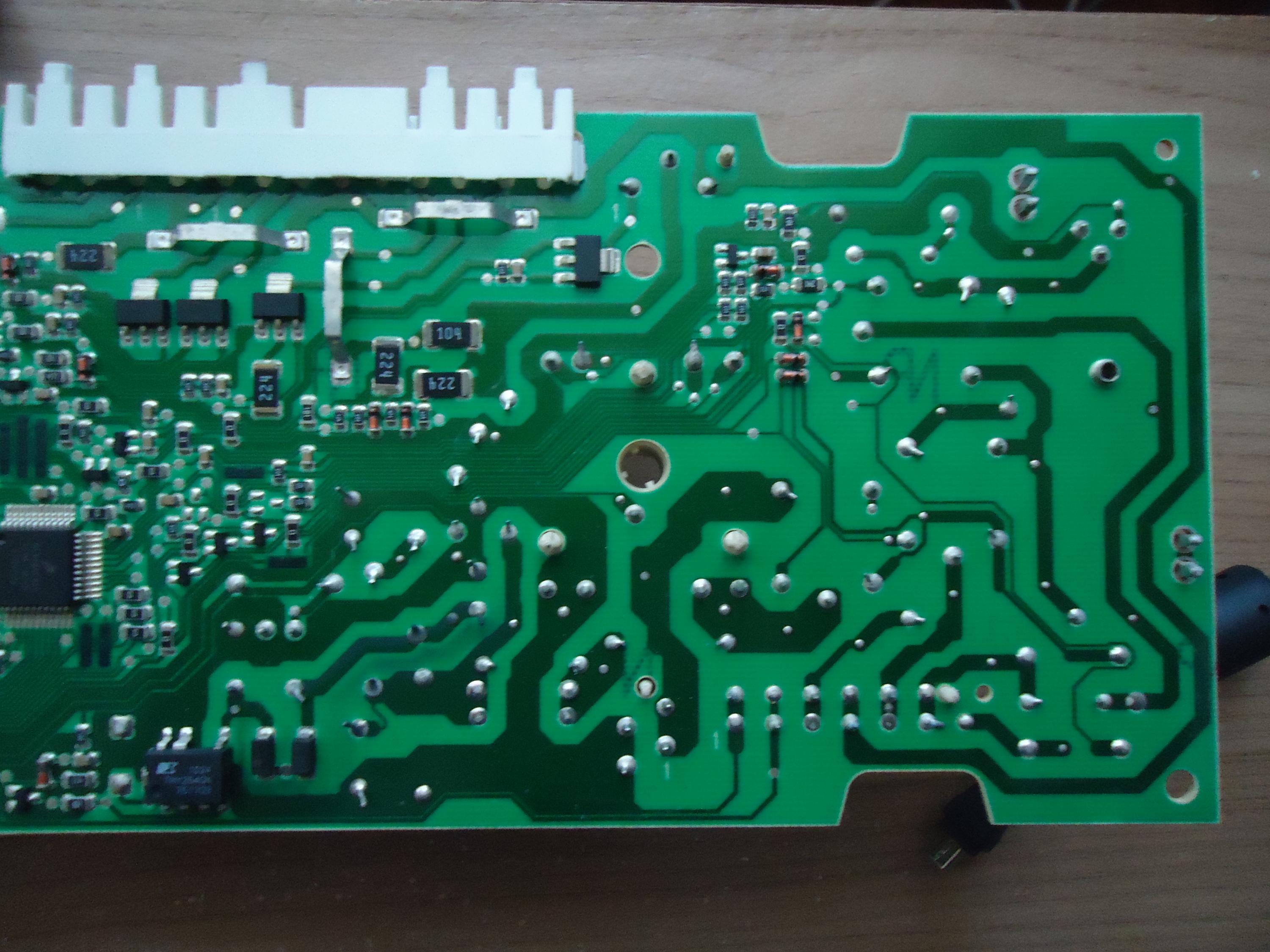

                        i'll say it again, you have a lot of bad soldering on the pcb.
                          • Jul 2011
                          • 6040
                          This board needs have most of the soldering joint resoldered you can not find the problem until you rework this board

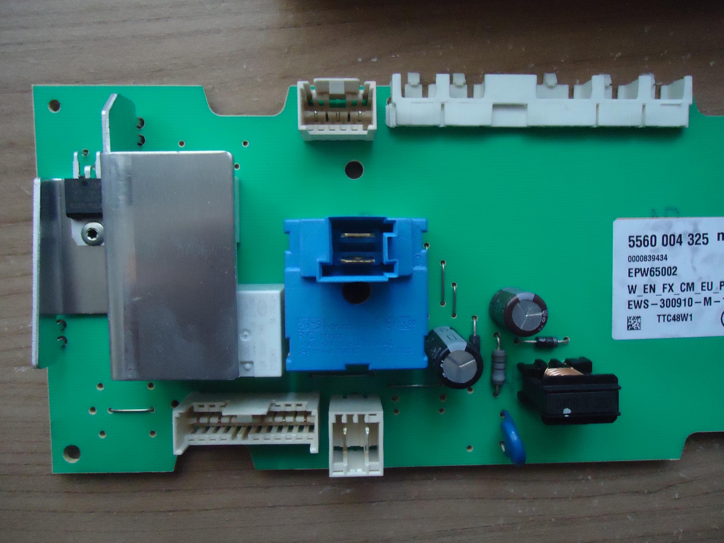

                          • Audison
                            • Sep 2016
                            • 46
                            • Slovenia

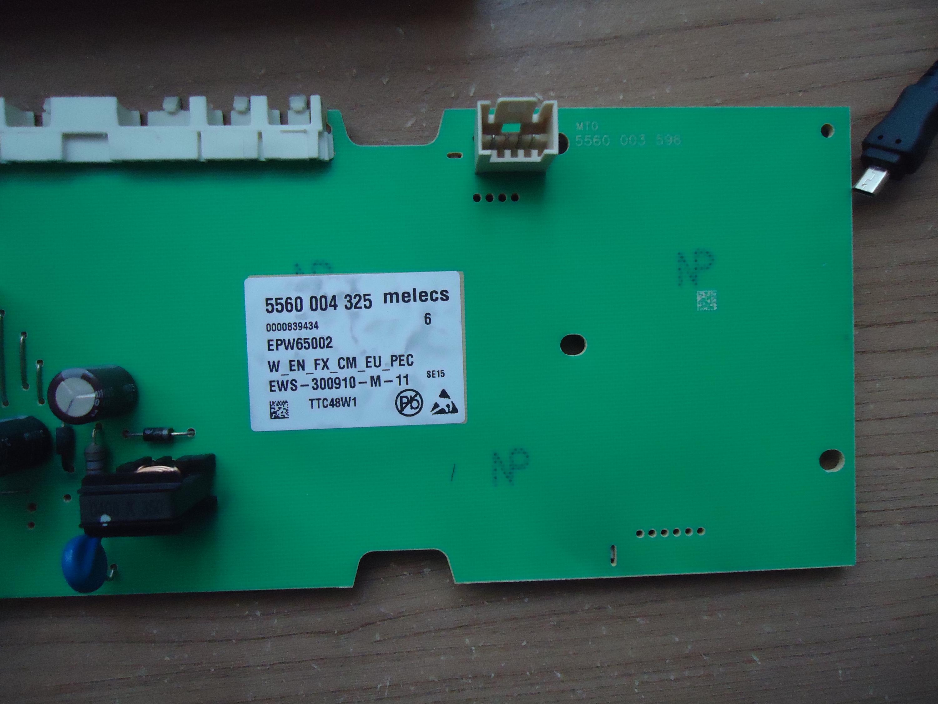

                            Update: I got a second hand board same model 5560 004 325 but from Siemens and the washing machine works again. Thanks again for all your advice. I am happy that I posted it here and manage to fix it for 15€. You can really see how much better quality Siemens board is compared to Melecs board. On my washing machine they really cut corners to keep the cost down. Lesson learned just buy 5 year warranty model to avoid this kind of problems. I will attempt to fix the broken board if the replacement dies until then keep helping newcomers on badcaps

                            • Moreno83
                              • Jun 2014
                              • 2008
                              • The Netherlands
                              You could have saved the 15$ and reflowed the solder haha.
