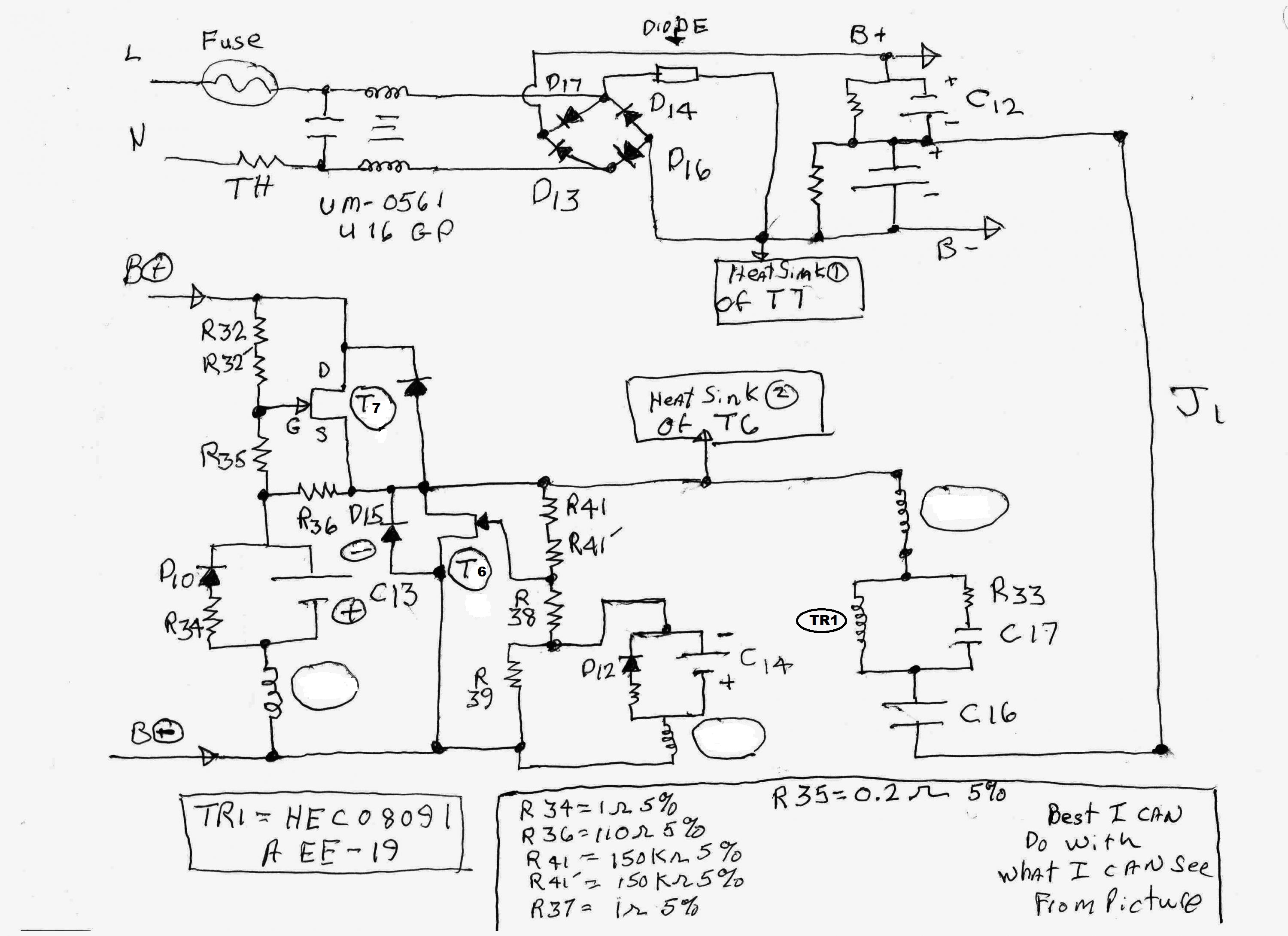

              #106
              Re: Wine Fridge Power Board
              I made it a diode because it had Dxx on it. You also,missed R36. You had circled the end points of it, but you didn't put symbol in. This is a schematic Primary side with the correct component numbers as the board. I put the two components in that were in question to what I believe you referred to. I can values of resistors from what I can see. If you think something is wrong let me know. I will try and look up the transformers later on to get the correct pin number and voltage value. I found they usually go by the part number so if there is a ll-19 it usually means 19 volts.

                      #110
                      Originally posted by budm
                      Sure like to know what that part is inside that tubing ...
                      It appears to be a wire link that programs the fridge for 120VAC operation. Removing the link would configure it for 240VAC.

                        #111
                        So the best spec. I can come up with is in post 106 schematic I drew up. I do not have the board, I am going from a picture. I tried to have the numbers verified by the person who has the board, but he has not responded back yet.

                          #112
                          Originally posted by dunkel
                          Hello, I am having problems with this board, some components are totally burnt and i would like to know the specs of them, can you guys help me? the components are:
                          L1
                          R34
                          R35
                          R36
                          D10
                          I think that there may be errors in the hand drawn circuit diagram, but ISTM that there is enough symmetry in the circuit to enable the values of some of the damaged components to be inferred from other components.
                          R35 = R38
                          R34 = R37
                          D10 = D12

                            #113
                            Yes dunkel the values possible could be in error as the color coding could be different from looking at a picture as apposed to seeing in real life. I Believe the schematic drawing to be very accurate. This can be confirmed by ohming out the various points on the board. As fzabkar said there is a symmetry of the circuit so some of the components are the same because you have two circuit performing similar functions. I would still lift these components up on one side and measure them as I have run across color codes that were wrong for the value of the part and yet the part was of the correct value. I think in China if they catch that the color code is wrong they go ahead and use the part because the part is good.
                            • fzabkar

                              #114
                              My eyesight isn't young anymore, and I don't mean to nitpick an excellent body of work, but ISTM that, on the basis of symmetry alone, the network consisting of D10, R34, C13 and the associated transformer winding should terminate at the source of T7 rather than B-. Also the "DIODE" in parallel with D14 is clearly in error.
                              Edit: maybe R36 = R39

                                #115
                                Fzabkar I do not mind the knit picking that is how something is proving. If you look at previous posts this board was from a unit not working correctly. It was the same as the board that was set up. My belief was that the D10 and C13 of this bad board are in backwards as are D14 and C14 and that is why it did not work. The person that has this board never got back to me. Perhaps the dunkel can confirm the direction of these components. The layout was from a virtual program from BudM all I did was develop a schematic from it. Do you have a schematic of this board or have you repaired these board? Also D14 is there, but it was listed as a resistor by BudM. I just put D14 because it had a marking of Dxx. Which I did not know what that meant perhaps you understand that marking?

                                  #116
                                  I don't know the reason for the Dxx circuit reference, but, as budm explains in post #104, it "is connected between incoming AC L and another end goes to the junction of those two filter cap not to the primary DC negative as I have drawn". This means that "it appears to be a wire link that programs the fridge for 120VAC operation", as I explained in post #110.
                                  As for the polarities of D10/C13 and D14/C14, I'm still trying to get my head around it. ISTM that the diodes may be reversed, but I'm not certain.

                                    #117
                                    fzabkar I have corrected it here. When BudM told me that I did not understand as he drew it to DC primary ground and indeed from the picture of the board it actually seems to go to the DC primary ground.
                                    Also remember you are looking at 1/2 of the circuit. So there is feed back to control duty cycle and to turn off the devices it is controlling. These diodes and caps I believe are used for oscillation for the pulsated DC supply.
                                      #118
                                      I wish I have the board in front of me, at first thought I was thinking it is set up as the Voltage Doubler circuit for 120AC line but looking at the connections it does not look right.
                                      So the diode (the one connected to the two main filter cap +/- connection) as shown in the drawing is actually a jumper wire? It has to be for it to be Voltage Doubler circuit.
                                      https://en.wikipedia.org/wiki/Rectif..._rectifier.svg

                                        #119
                                        So here is the update primary side per your recommendations
                                          #120
                                          I think the main power supply is OK, it is the switching circuit that is not working.
