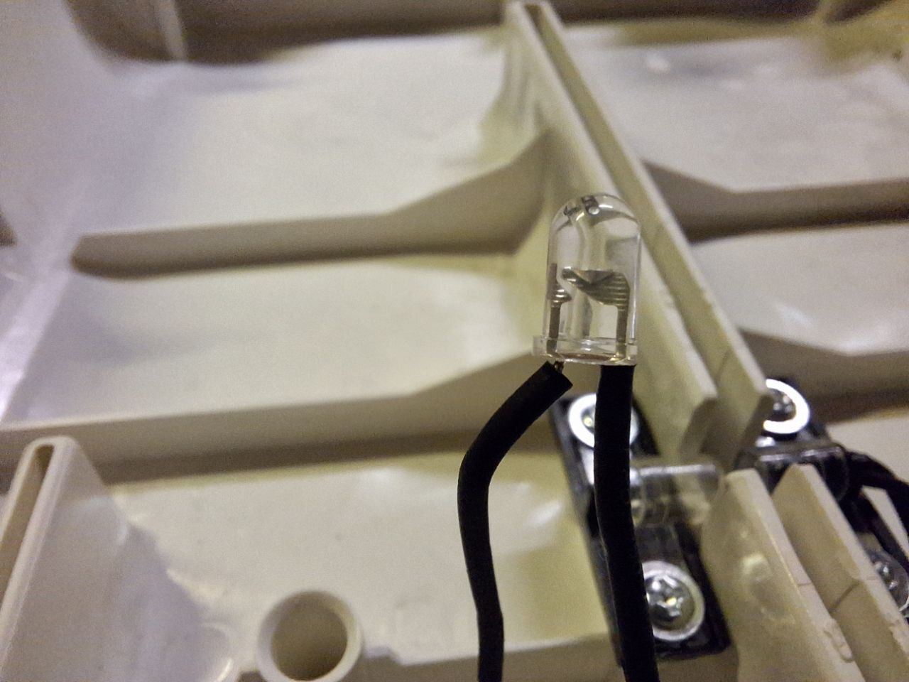

HSM shredstar S10 document shredder issue
  • shybear
    • Jan 2010
    • 114
    This machine has an optic sensor problem. When the machine power ON the motor start to work and stop when a sheet is inserted.
    This shredder documents come with two slits and each one has an infrared photo sensors couple (black + white LED).
    Making some cross test I've found that one of Led photosensor isnt't working.
    Is there a way to understand the right LED photosensor have to buy?
    For reference I attach a picture of the broken photoled. (5mm. type)
    • 31429
    just get whatever is cheapest - like the makers do.
    if in doubt - just get a new led too that runs at the same wavelength.
    • shybear
      • Jan 2010
      • 114
      ok, thanks, I've seen that its also possible to buy photoled couples (emitter + reciver) so to be sure that both run at same wavelenght.
        • 31429
        aliexpress has good deals,
        i got 10 matching pairs of 3mm emitters and diodes for about €2
        • shybear
          • Jan 2010
          • 114
          Yep I was looking here too😉
