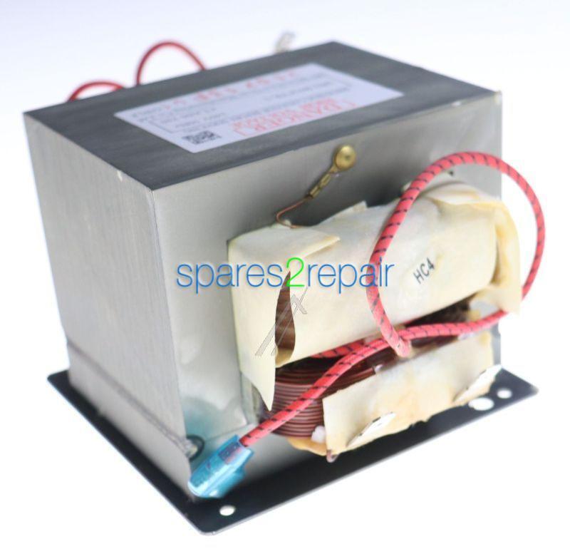

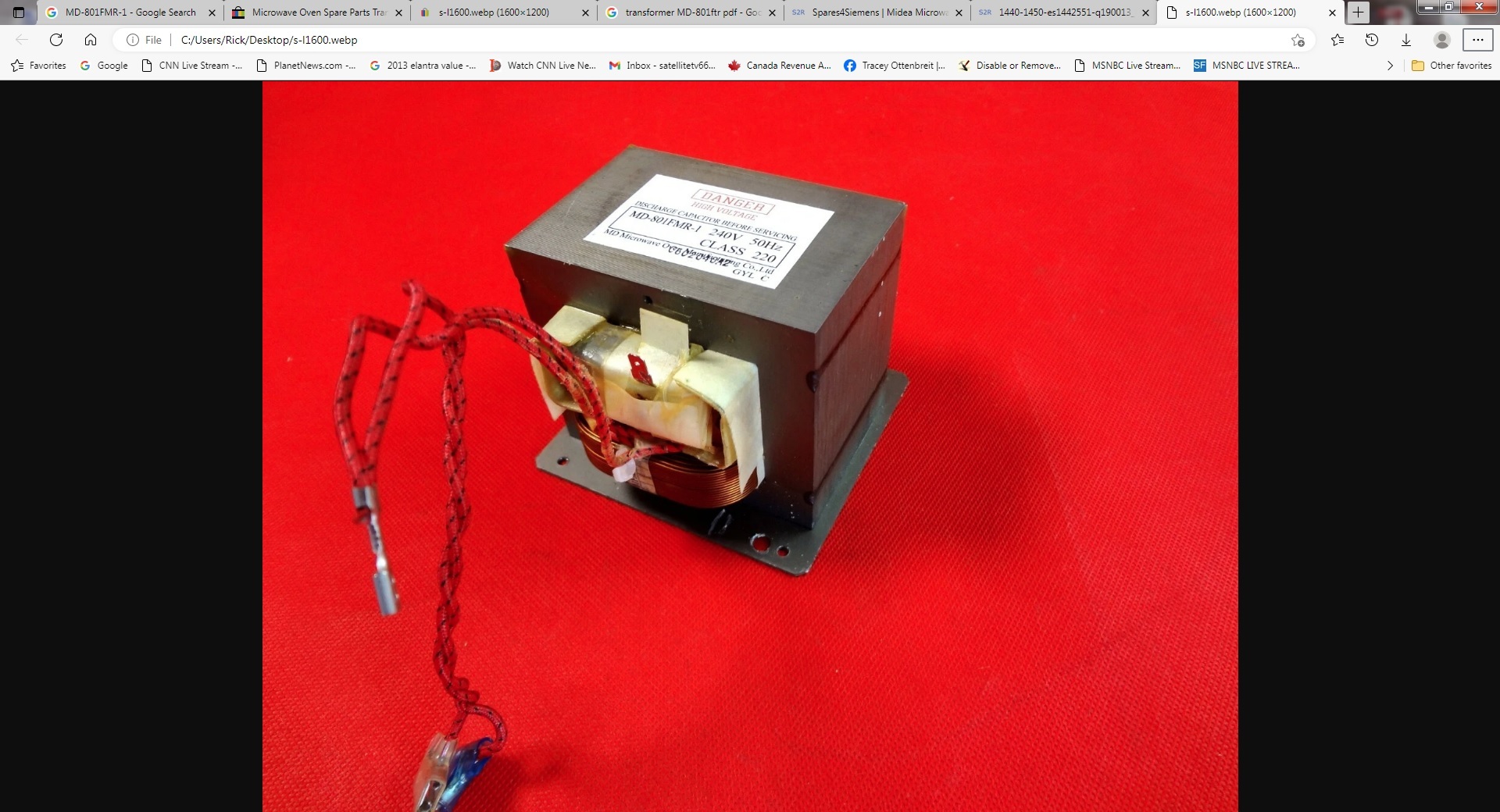

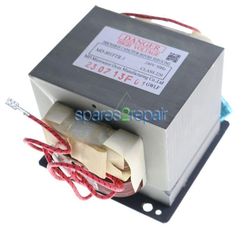

    Hi
    Can anyone tell me the difference between MD-801FMR-1 / MD-801FTR-1 and MD-801EMR-1 microwave HV transformers?
    All I can see is they are all 800W but wondered if they are inter changeable
  • CapLeaker
    Leaking Member
    • Dec 2014
    • 8340
    Probably region codes. AMR for America, EMR for Europe etc. As long as the primary winding has the same voltage than you have in your country, the mounts fit, wattage is the same and the connectors are the same, you should be all right.

      seems to be a slight difference in where one of the secondary leads comes out? they should be functionally the same
        That may explain the last picture, but not the first two.

            Looks like the differences mainly lie in the connector arrangement, for different design styles of oven, I would guess.
            Also one (MD-801EMR-1 by process of elimination) seems to have an electrical connection to the core, while the others don't appear to?

              The high voltage winding has one end connected to the core (ground) they all have that., the other end of the high voltage winding is either a wire lead with spade connector or just a spade connector on the transformer. The other leads are for the filament and are only a couple turns around the core to provide around 3 volts
              The FTR and EMR seem to be more similar, maybe lead length is different?
