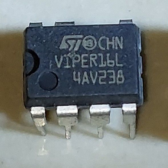

    Got a Kenmore Kenmore 790.74133311gas range with a control board 316630005 which has a blown PWM. Anybody has an idea what that chip is?

    Maybe a VIPER26L 7DIP?

      Looks like VIPER16L

        Originally posted by R_J
        Looks like VIPER16L
        Perfect R_J! That's just with what I came up to as well, since I can see part of the 1 on the 16L on my picture.

            Originally posted by sam_sam_sam
            Were you able to get it working again
            Crap, forgot about it to update! Yes! Board works A1!

              Did you put a heat sink on top of Viper chip to keep it cooler

                Nope. Old Viper out, new Viper in, cleanup, install and Bob is my uncle. I think it died due some lightning event.
