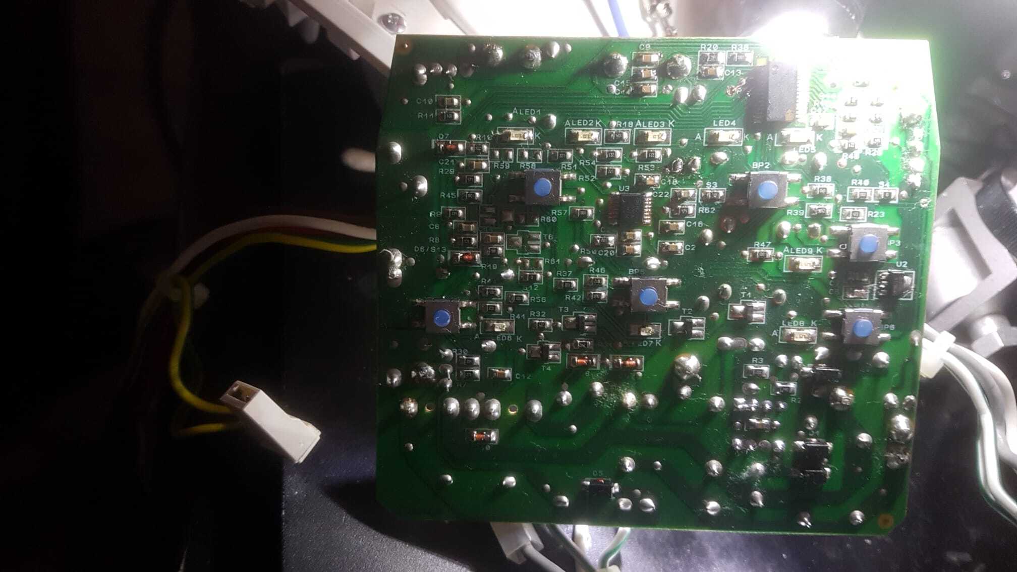

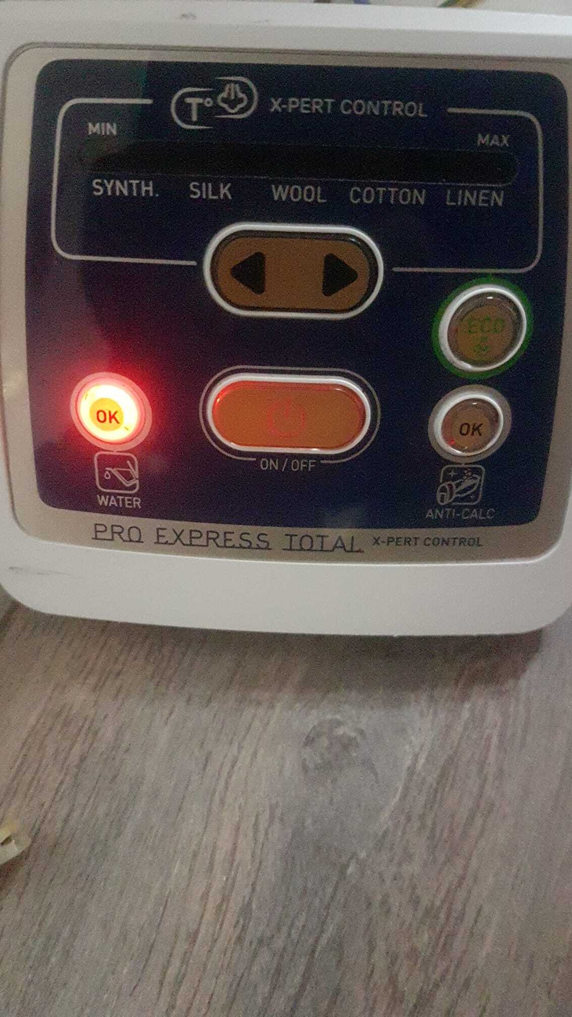

    we have been trying to get this iron to work, but the problem is that the relay clicks and then the no water sign flashes.
    the micro controller is pic16f1933.
    all other parts like water pump , boiler, solenoid ect are working.

      it seems that the 6th pin on the pic chip had 36 ohm resistance to ground, after replacing the chip, the iron started to function again. how did this happen?

          >be logical - how does it detect water?
          this steam generator doesn't have a water sensor.
          boiler gets hot
          water pump activates
          then it switches on a relay which causes the "no water" led to flash even when there is water . i am assuming it is a programming issue.

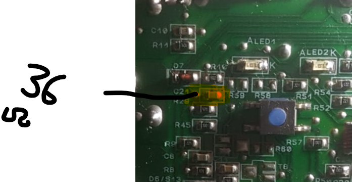

                        managed to trick the pic chip and confirmed that the board is working. the problem is either the ntc in the hand set or the boiler.this means i wasted 9 quid for no reason, there was no problem with the original pic chip.

                            everything works. 5 volt for one of the ntc's was missing.
