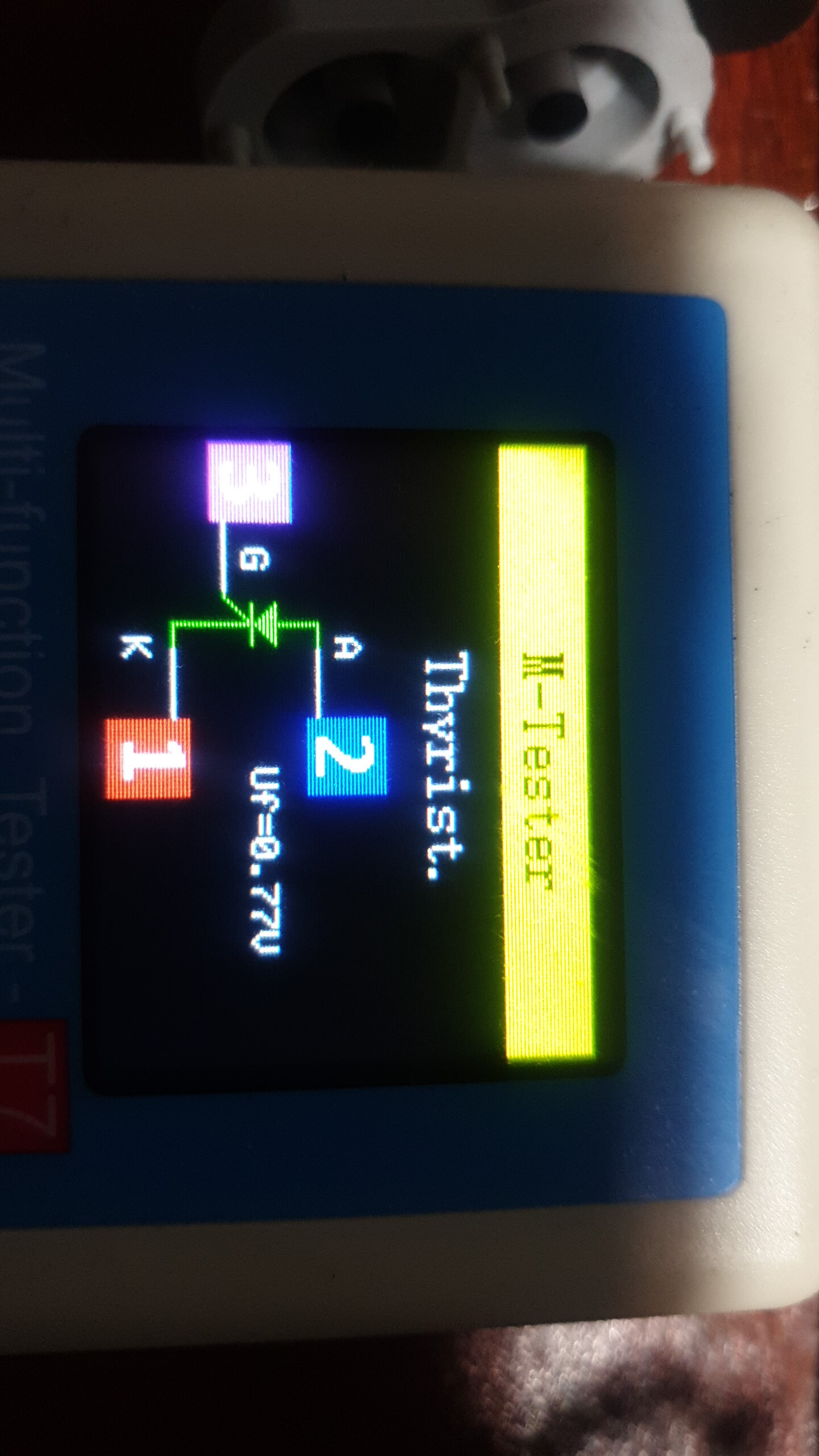

            Sorry, only saw that components this afternoon & had to Google it.

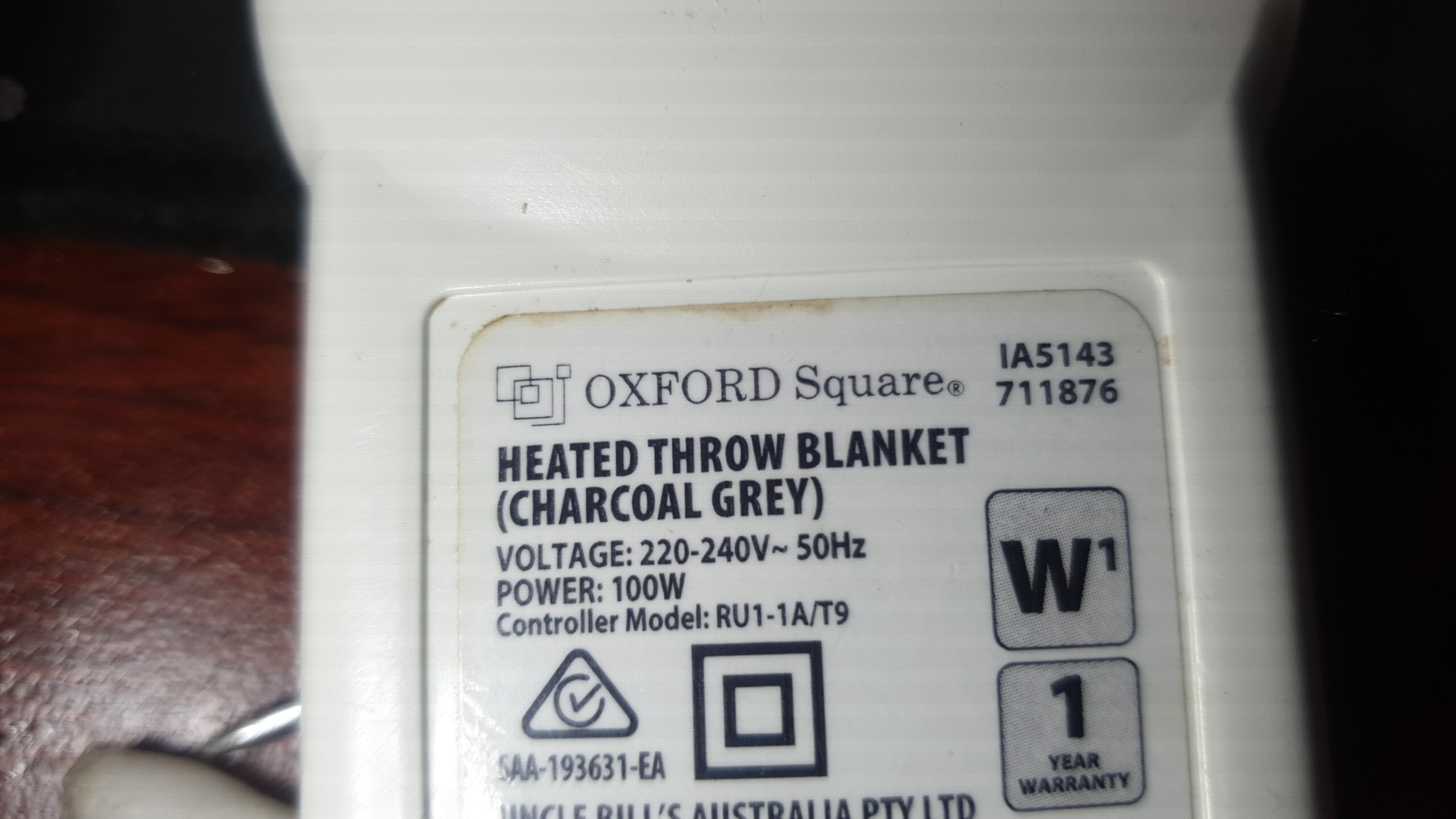

                how many watts is the blanket supposed to be ?
                  100w.
                  I put it into my new(ish) component tester. Didn't tell me much I don't think.

                    at 225 ohms i calculate about 250w .. but the resistance will change as it heats up so cant really calculate it easy
                    your tester knows what it is so its maybe good .
