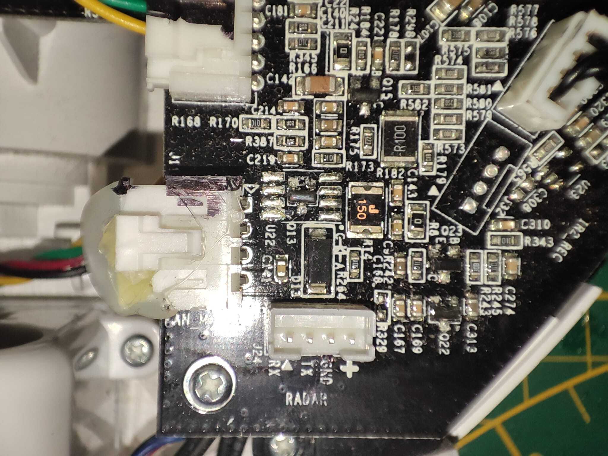

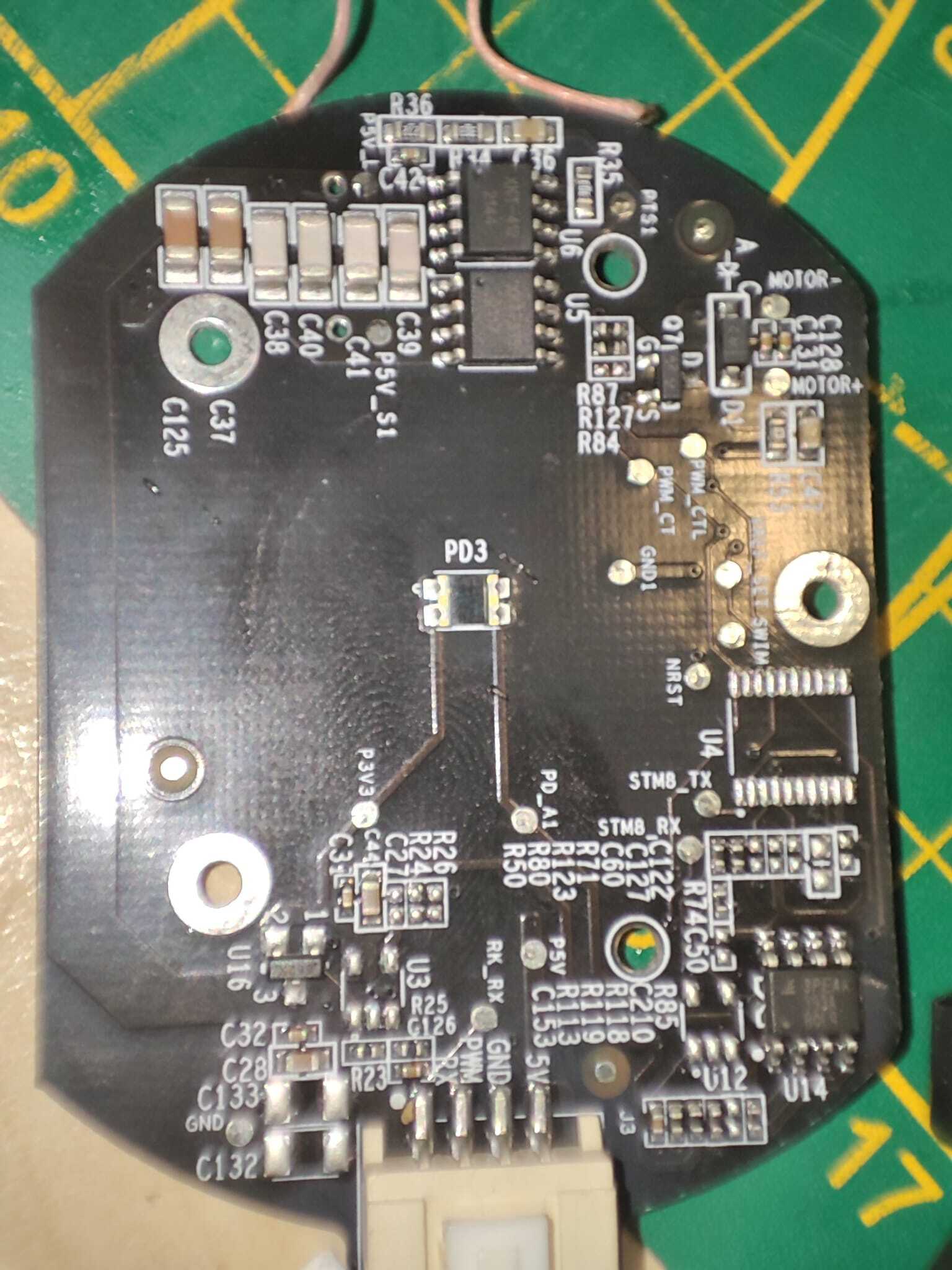

    the entire assembly consists of basically 3 pcb's
    1) main board that ofcourse controls the main functions
    2) board that controls the rotation of the radar module (and also has the light detection sensor on it !?)
    3) board that controls the radar function itself.
    I will add pictures of the 1) (part thereof) and 2)
    what have I done so far:
    1) Checked that the module spins freely, so there is no mechanical obstruction
    2) tested the electromotor.. by putting power directly on the two motor terminals bypassing the pcb, and the motor (and radar spun freely. so nothing seems to be wrong there.
    3) I put power (5V) on the PCB at the point where normally the PWM wires come in, so i connected 5V and ground to an external power source. obviously, the radar would not spin..
    but when tapping the 5V plus to the PWM pin, it did (ofcourse only when tapping)
    4) watched plenty of youtube videos' trying to find people with similar issues and see how they get things solved. Unfortunately, I found only 1 video, (a german one) that fit that description.
    https://www.youtube.com/watch?v=9zS4iptAZIQ&t=1485s,
    but, well let's say his way of working wouldn't be mine, also.. apparently the day after the repair, the thing failed him again, also his board that controls the rotation is different than mine.
    basically he replace / upgrade / parallel attached an mosfet, but i can't seem to find any mosfet on my board at all, so nothing to replace,
    my next step is to take the radar module as it is and connect it to an arduino and use that to rotate the module by code, this should be fairly easy. just will be a while before I can get around to that.
    The second next step is to test the PWM output of the mainboard and see if there is any PWM signal at all, I expect this to be more complicated as it sound as
    1) I never seen it function normally) and
    2) I don't know if it does when connecting when the thing when disassembled, or if some safety measure is in place to stop it from working anyway.
    if the issue is mainboard and not radar module related, I can easily order a new board. but this would be a waste if the issue is not in the mainboard and / or there is something wrong with the radar module that causes the mainboard to damage.
    also replacing a few components is cheaper and gives more satisfaction in the end.
    any part on the rotating boards, that could've been a mosfet
    u6: xkt 412
    u5 : xkt 335
    u14: 393a BQL
    u16: 662K
    there is no part, on the mainboard parts there that I believe to be a mosfet (functional / non functional), I specifically tested
    q13, q15, q22.
    any suggestions here would be highly appreciated.
    I have tried to be as concise as possible, if I missed something, please ask for it and I will answer asap.

    • Matthieu vK
      Matthieu
      • Apr 2024
      • 6
      • Nederland
      CapLeaker
      thank you so much for your reply!
      I completely agree with you that the issue of bad lubrication of the bearing can be essential.
      I had the feeling that the Lidar unit was replaced, so I checked it with the seller and it is indeed the new one.
      Therefor this unit still has proper lubriation (for now)
      According to the seller, it's an original part with the same partnr. but I believe many parts are available from different manufacturers,
      sed in different vacuum cleaner models that do the same job. All that is sent back is a UART signal anyway (with info on the measured distance of measured by the lidar and the rotation speed)
      o I believe this to be of no real importance for this repair at the moment.
      On the other hand, I finally did manage to find the mosfet (partnr O7, can't believe how I missed that)
      I had no stable reading between the drain and source, it kept fluctuating between a reading and no reading.
      So I believe that this part is faulty for this new Lidar unit, I took it off to test of board. but unfortunately, it broke into two pieces !?
      Mainly my fault I believe, But it could also be that the unit had indeed a real issue.
      so if the original unit had dried up, and the new unit had a faulty mosfet, this would both give similar effects.
      Additionally, the previous owner did home 'repairs ' and I believe that a short might have been created. Just not sure if this is a cause / or a effect (and a different cause)
      So I am still trying to get an answer on this question, could help me sorting things out.
      I also believe that the previous owner might have swapped RX and TX, this would've given the effect of no communication between the boards of course, and therefor also no rotation.
      so next steps...
      1) wait for the mosfets to arrive, test and replace them.
      2) test the Voltage out of the mainboard and verify Rx Tx connection and uart signals to verify the mainboard is still functional for the lidar control part.
      3) pre-lubricate the motor and bearings of the unit for longer lively
      Unfortunately there is a waiting time for the mosfets' so here hold my workings on this unit for the moment untit they arrive.
      I will post back afterward, to keep this thread up to date.
      Kind greats
      Matthieu
