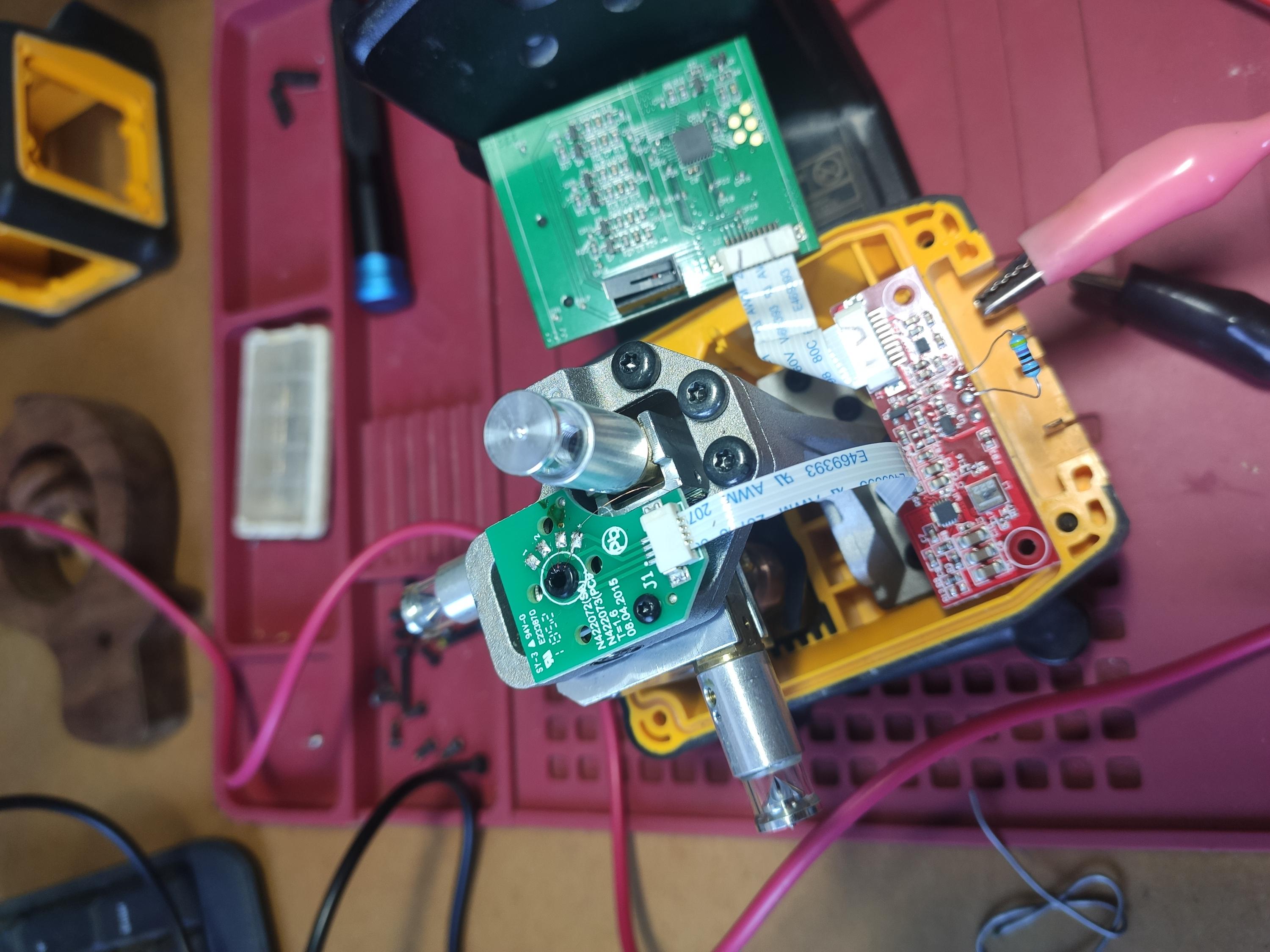

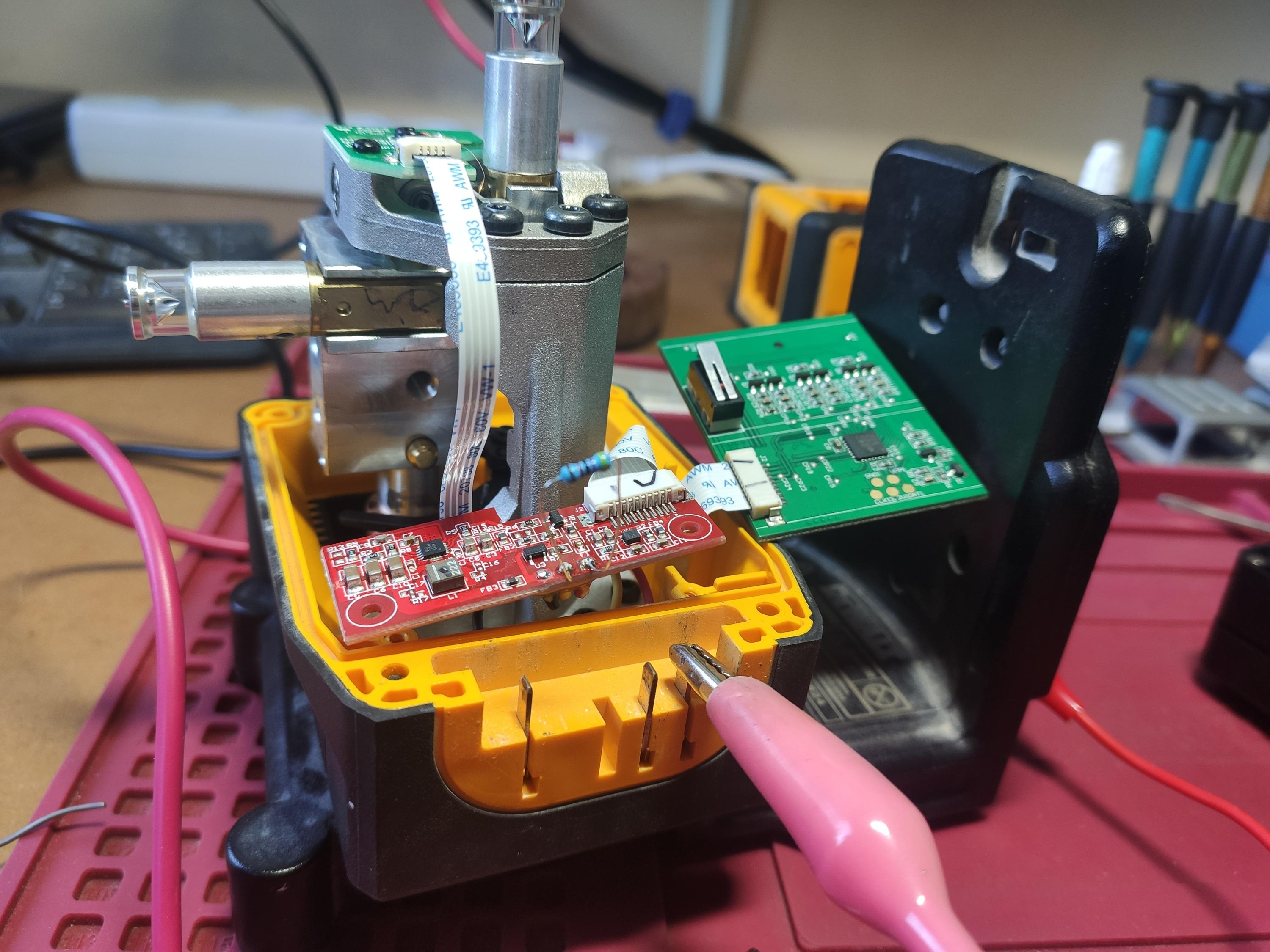

    i got a Dewalt laser measure which uses the 12V batteries to operate. The laser measure is faulty and I want to attempt a repair, never fixed such thing before. You might see a different topic if I fail with the repair
    However I do not have dewalt batteries nor want to buy one for 140EUR as the laser tool might have some chance that it is very hard to repair or unrepairable.
    I want to power it from my PSU.
    The tool has 3 input pins, on the battery it is marked with B-, B+ and ID/TH.
    i want to know what is the third pin exactly and what do I need to do in order to get it going.
    Obviously I have tried just hooking up 12V on + and - but nothing happened. I have read somewhere that the center pin is for thermocouple and a resistor is needed between the pins. On the below image I have added a 47k resistor between + and the center pin. The tool draws few milliamps every second like checking something but it does not turn on.
    I'm open for ideas.

                  Re: Power DeWalt 12V laser measure from power supply
                  https://forum.allaboutcircuits.com/t...id-pin.180775/
                  Look at post #4
                  Unfortunately I don't have any Dewalt 12V tools
                  tried this exact thing, if you see the photo in my first comment you will see the resistor soldered on the pin. Unfortunately did not work here. However I have seen the tool work with a battery so it might be something. Thanks for bringing this up

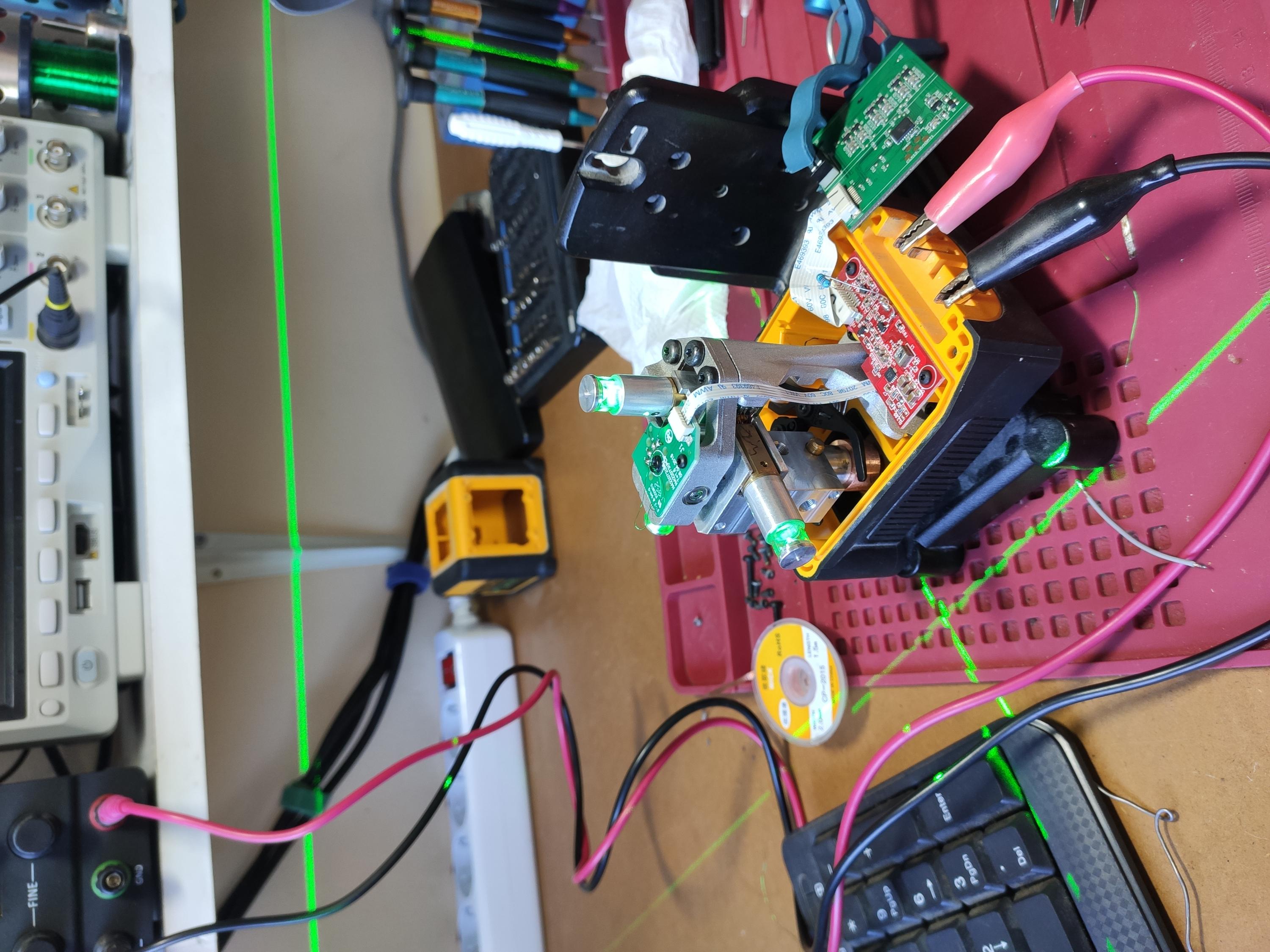

                      Maybe try other resistor values. Read this:
                      https://www.sevarg.net/2018/08/19/12...-ryobi-cb120l/
                      The 10k resistor between B- and the center pin did the trick.

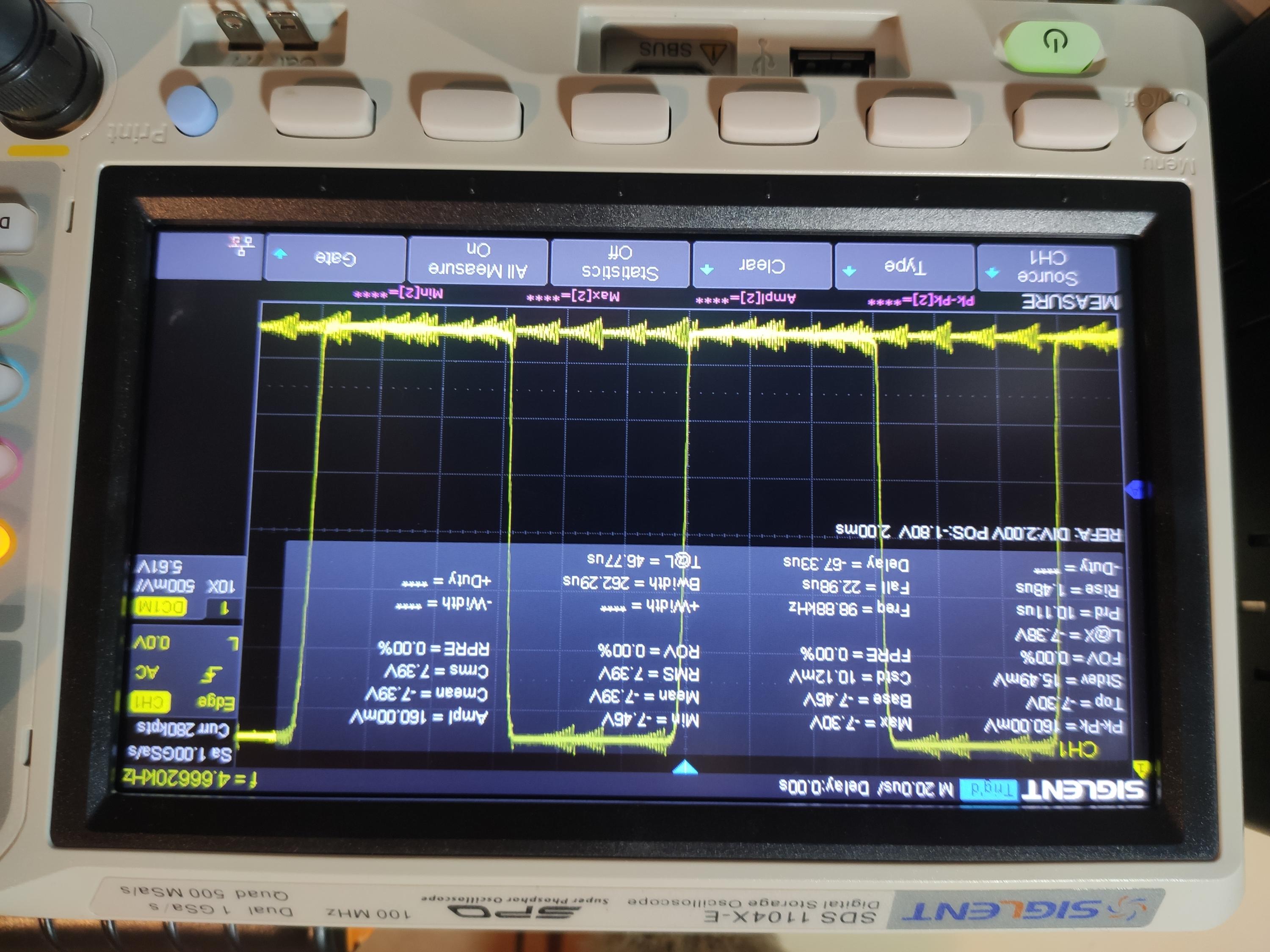

                      The laser is on now. I'm not really sure at the moment what is the issue, why one diode is not working. It is working with a 50% duty cycle 7.2V PWM signal.
                      I can measure the PWM on all 3 laser channels so the electronics and the power supply is fine.
                      When I test the 3 laser diodes with diode tester all 3 shows same voltage both ways (1.1V one way 0.7V the other)
                      Any idea how else to test if a diode laser is blown?

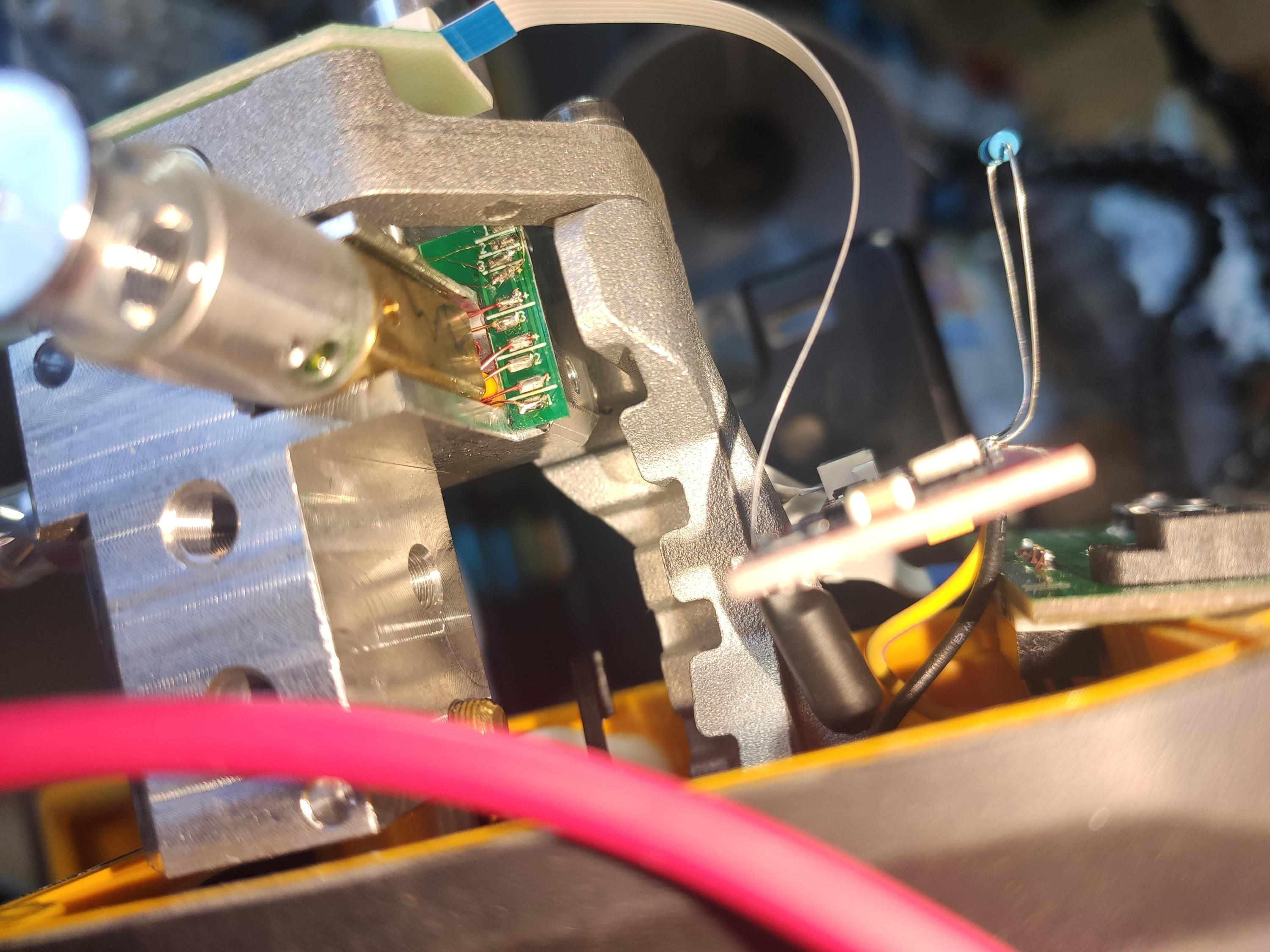

                            I got it working. Thanks guys for the help.
                            It is impossible to swap the lasers, they are glued in the factory.
                            It was a weak capacitor on the circuit. However that laser is still weaker than the rest and slightly blinking. I was able to see a tiny circuit on the butt of each laser diode that is full of ceramic capacitors. I suspect those are also toast but it is impossible to service it without damaging the entire construction.
                            So it will be a slightly faulty laser with one diode going on 80%. I can live with it, it will be overkill for my shelf installing kind of home projects anyway. It was a great bank for the buck as this is a pro tool and I got it for change.
                            So I will leave here a checklist for anyone ever coming across a similar faulty DeWalt DCE089G laser meausre
                            -Check the tiny wires going laser diodes. Continuity test does not work, there is some continuity on the circuit so even if the wire is broken it will show resistance. You have to visually examine if any of the tiny wires are broken.
                            -Check the 3 ceramic capacitors on the main power board.
                            -Check the power regulator IC on the main power board, check for warming on shorts
                            -If you have an oscilloscope you can check if each diode gets power. These lasers are working with some power generator kinda hybrid PWM signal to trick you they are brighter (somewhere between 4.2 and 7.2V), it is impossible to see with a multi-meter what is happening exactly.
                            And most importantly: While disassembled use a safety glass as the green laser can output a lot of infra light and can blind you.
