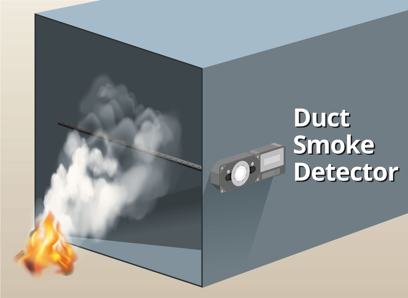

        I dont know the layout of the sauna in question but I cant imagine a situation where something like the duct smoke detector or something similar (with some sort of ionization detection probe) cant be installed retroactively. I am no expert tho.

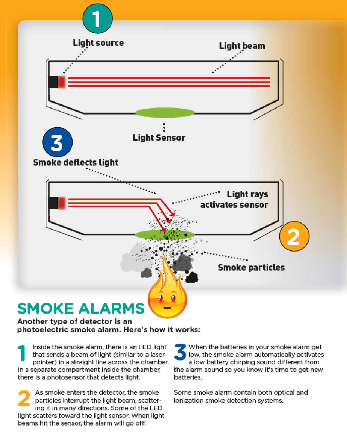

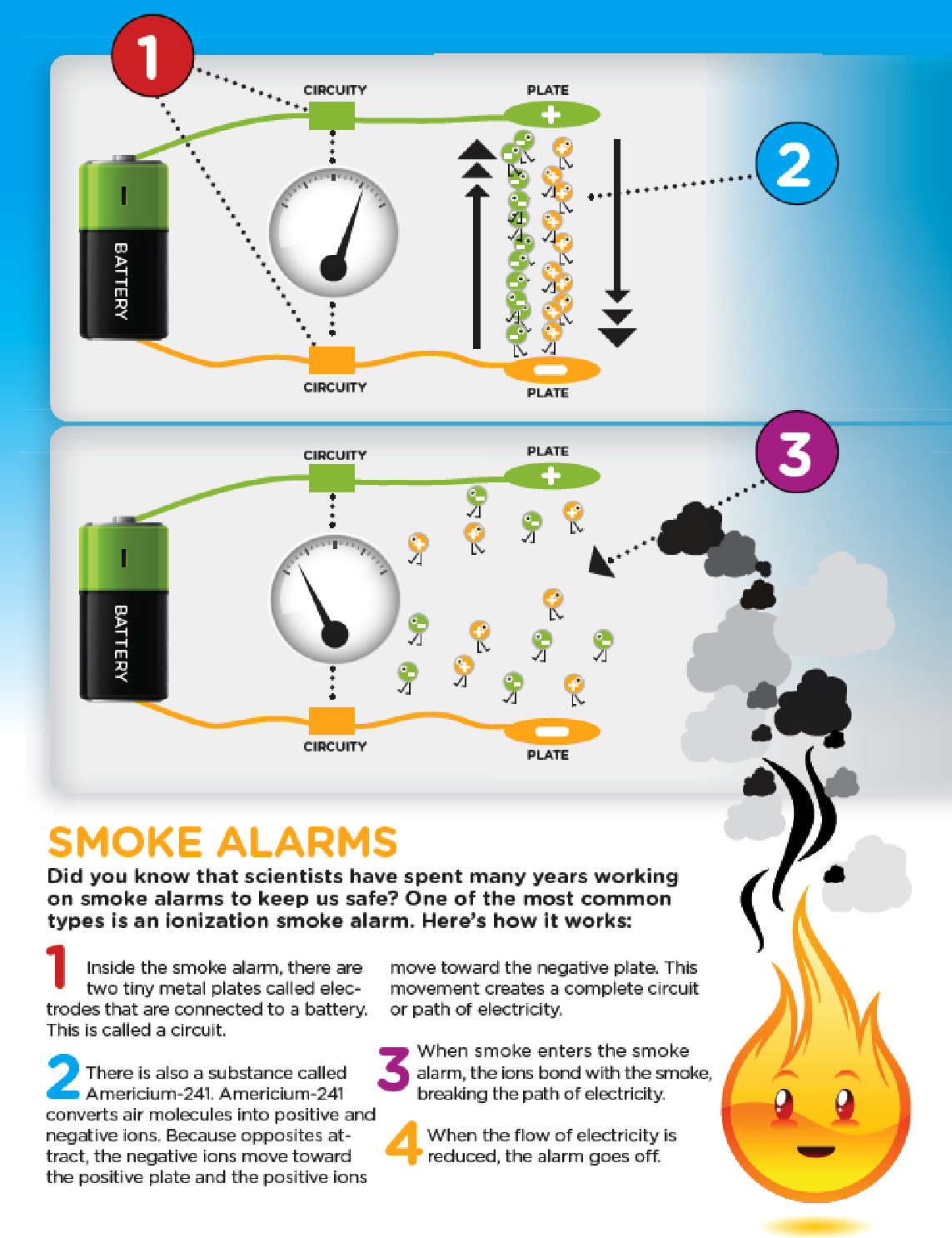

              Would this be able to differentiate between smoke and steam?
                • 31256
                Re: High-ambient-temp smoke sensor recommendation
                interesting question
                • KYBOSH
                  • Oct 2011
                  • 581
                  • Unknown
                  It would seem like we'd have to go with an ionization smoke detector as opposed to a photoelectric smoke detector for this application as ionization alarms are not affected by normal levels of cooking fumes or shower steam.
