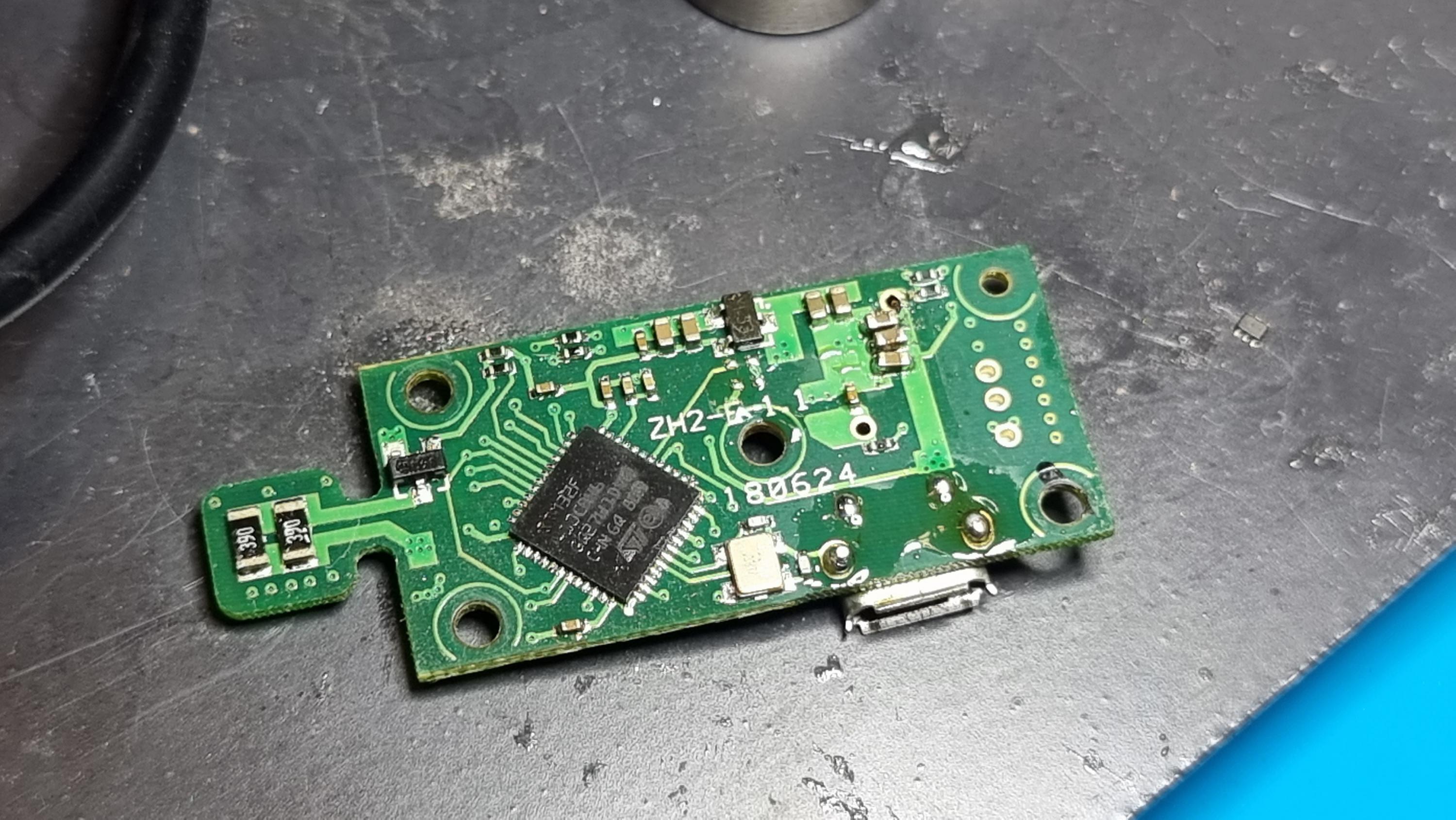

Help identify chip A7UH 827 Please
  • sikocan
    • Oct 2019
    • 344

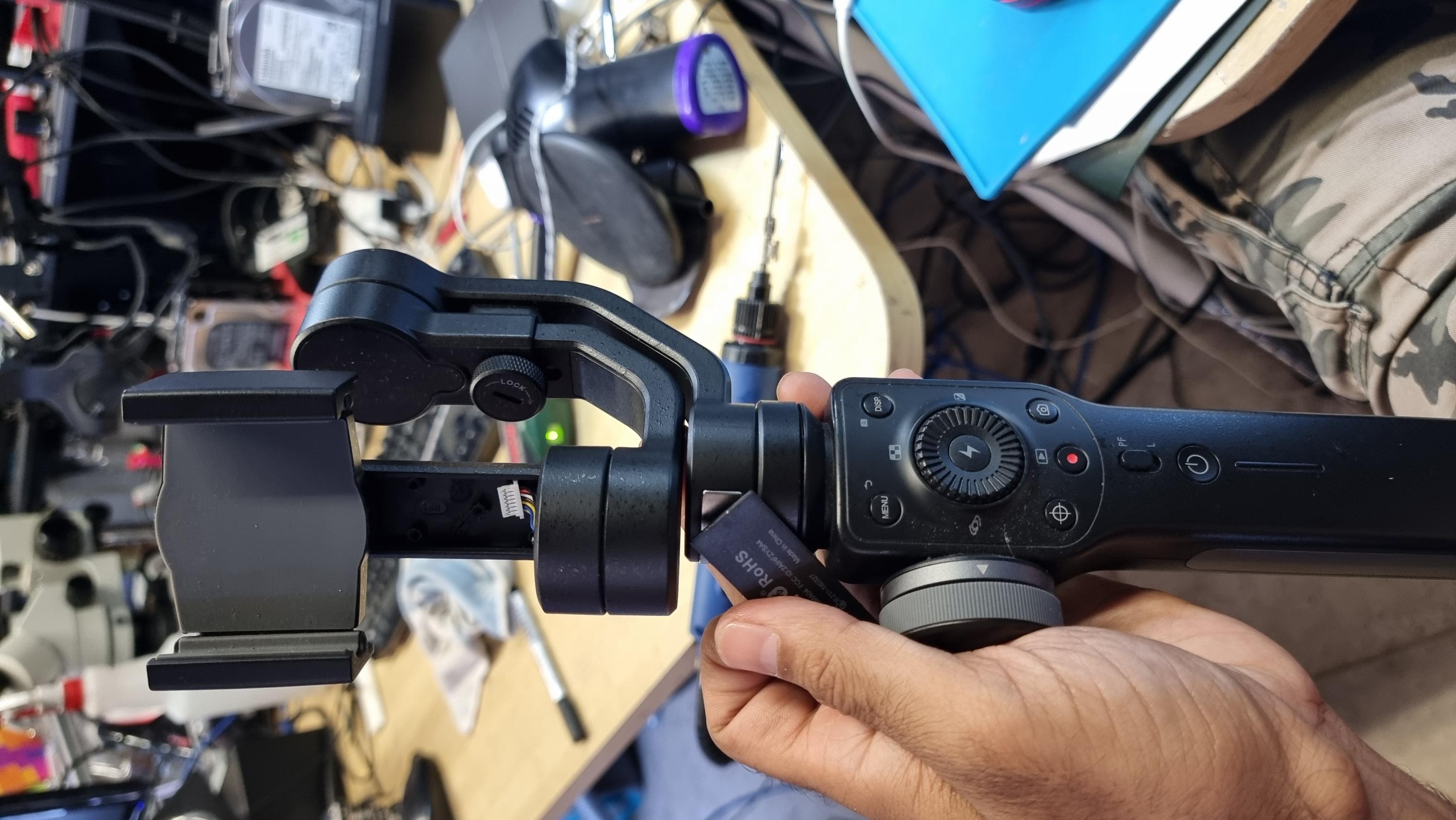

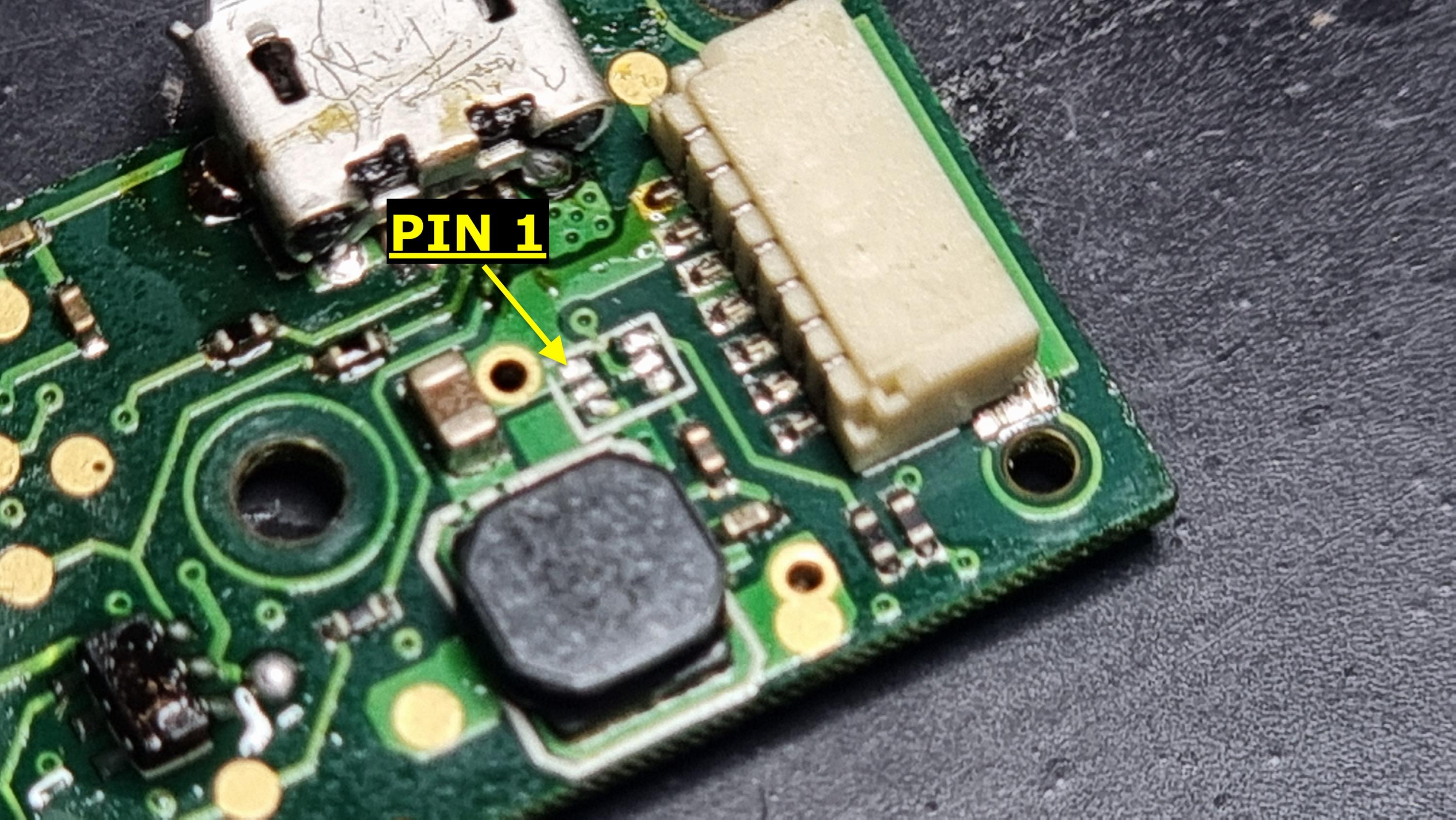

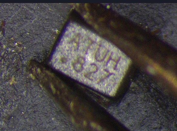

    Please help identify this part. It's from a Zhiyun Smooth 4 sma04 Gimbal Stabilizer. Images attached. Chip label: A7UH 827
    SOT-26 PACKAGE

    Silergy makes a chip similar to this in a DFN1.45x1-6
    This is NOT YOUR IC but might be similar and help you in your search: SY8078BDTC

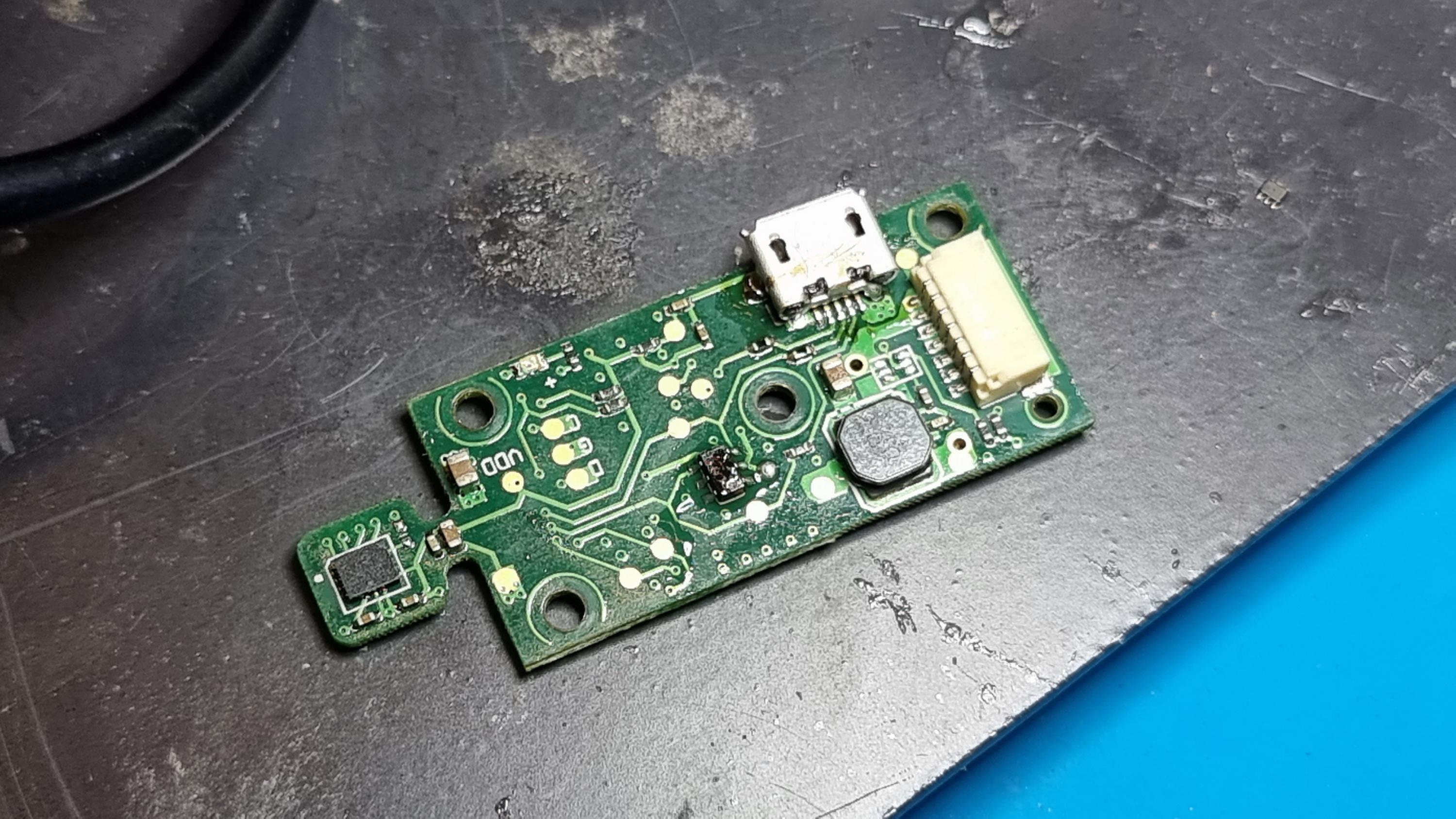

      Re: Help identify chip A7UH 827 Please
      Kinda makes sense, Vin microsusb 5v output charging a tiny battery LX pin, 1.2v ish
      Maybe I'll try same chip but different package
      Even a different manufacturer should be fine as long as same pin layout

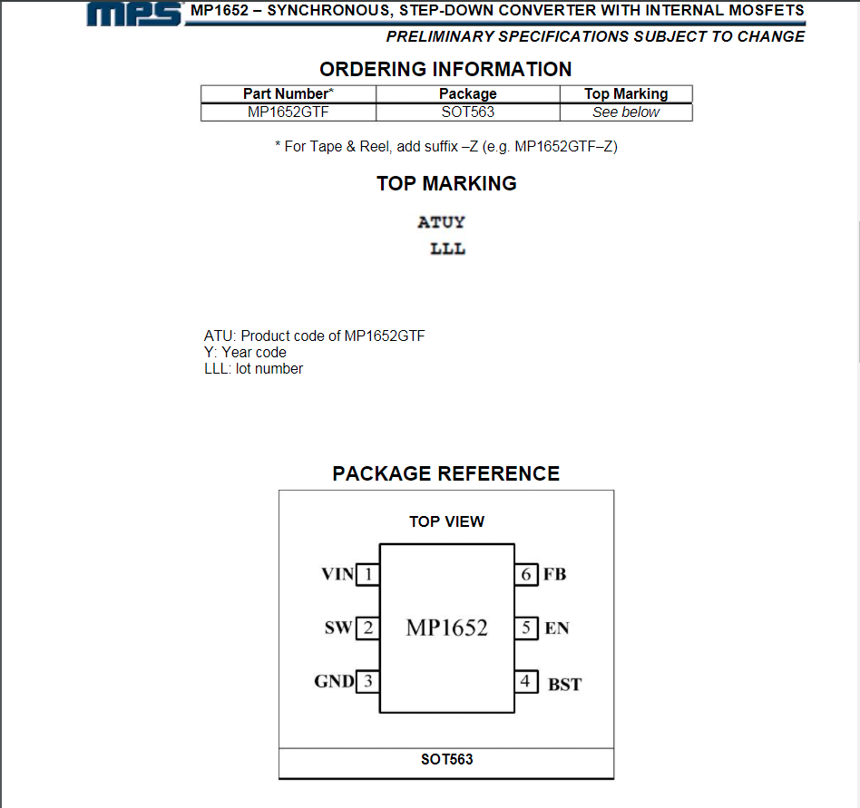

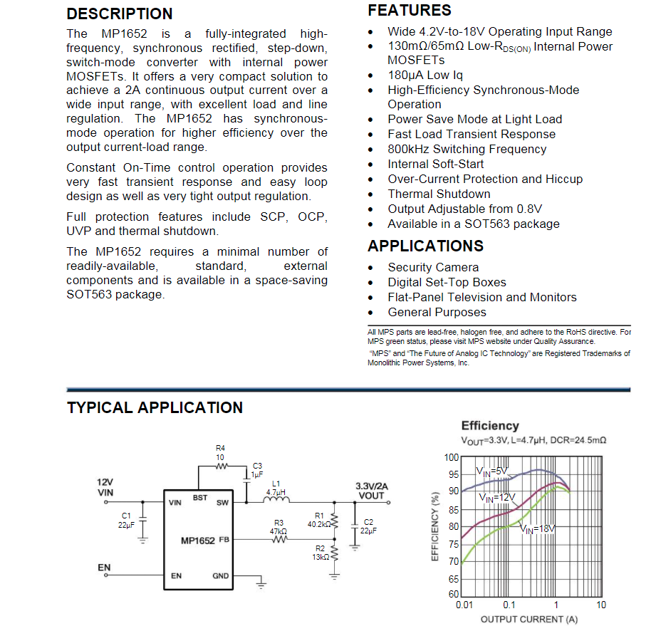

        MP1652GTF-Z
        https://aliexpress.com/item/1005003171086368.html
        • sikocan
          • Oct 2019
          • 344
          OMG. How did you know?
          • R_J
            • Jun 2012
            • 9607
            He used the correct number ATU not A7U, I could not make out the pin style because they were covered by your tweezers
            Another ic with the same marking (ATU) is MP1476GTF
            The MP1652GTF-Z seems to be more available

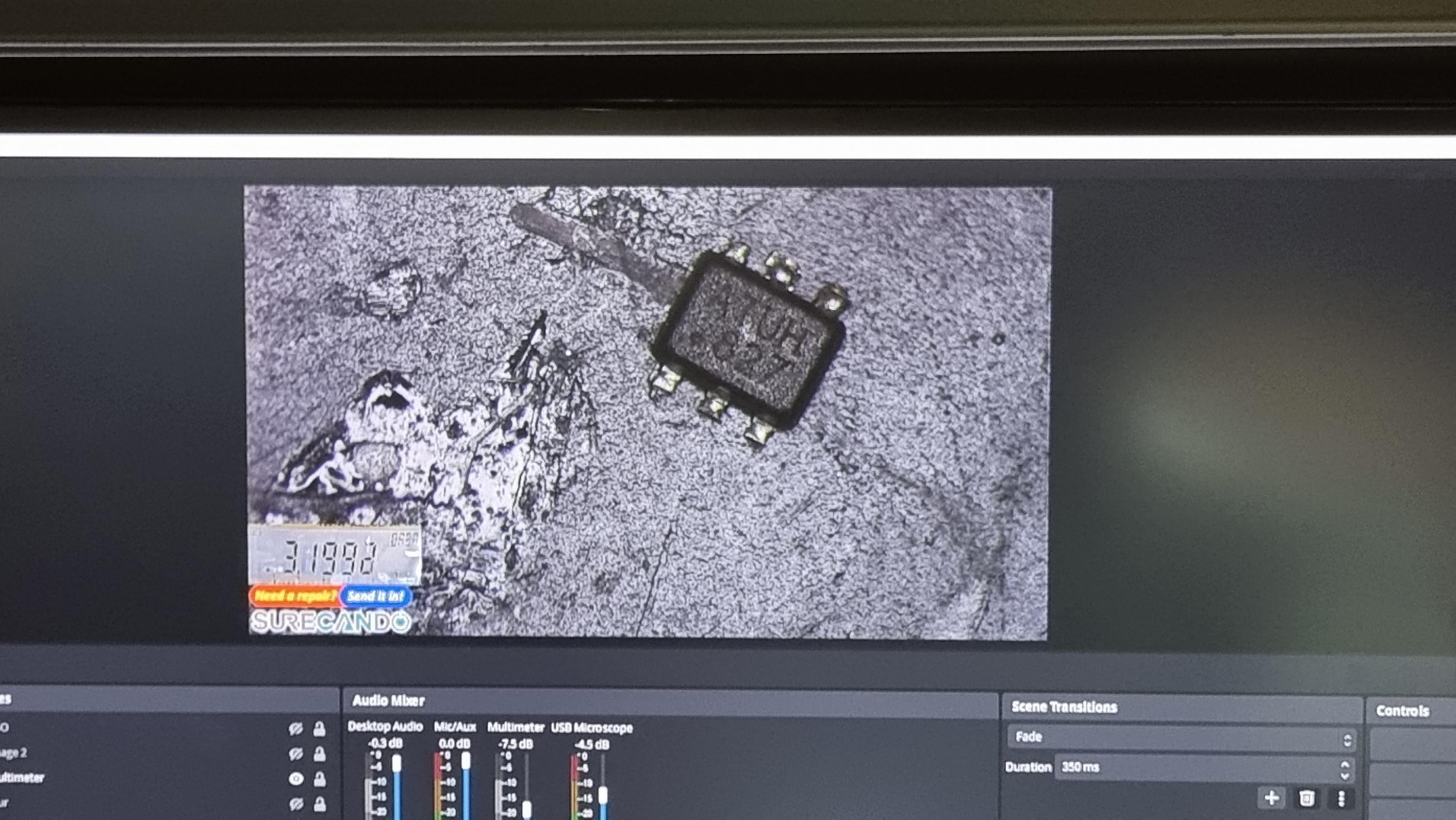

            • sikocan
              • Oct 2019
              • 344
              Hmm but it really was A7u as per picture. Interesting
              • R_J
                • Jun 2012
                • 9607
                It is an odd looking "7" compared to the date code "7"
                • sikocan
                  • Oct 2019
                  • 344
                  Now it makes sense. 7 on bottom is much better then 7 on top. I'll keep it in mind to search for letters as well.
                  • lotas
                    • Jan 2016
                    • 4786
                    • Russia
                    This could be due to heating, breakdown inside the crystal, because of this, the "T" in the center was deformed.
