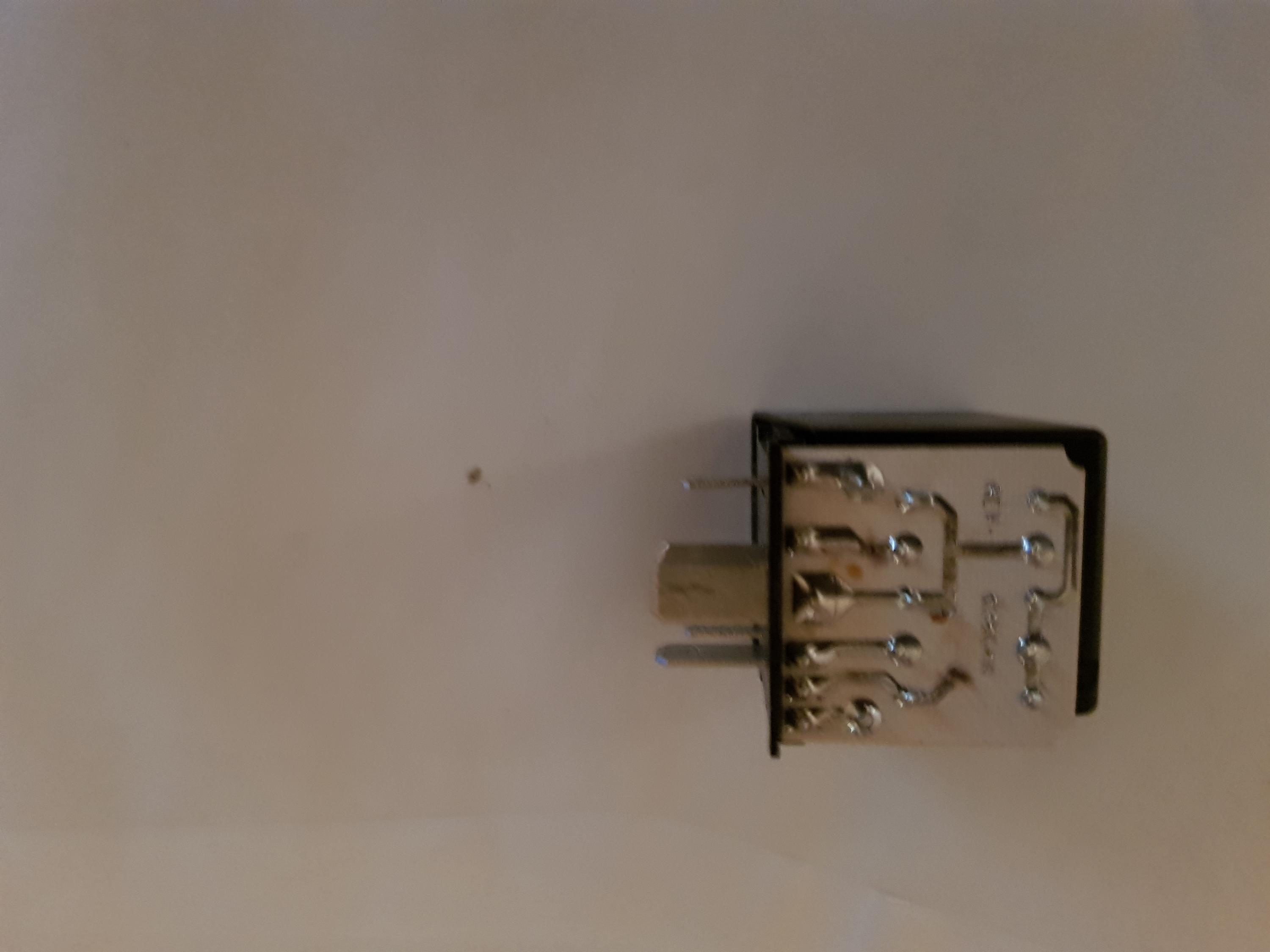

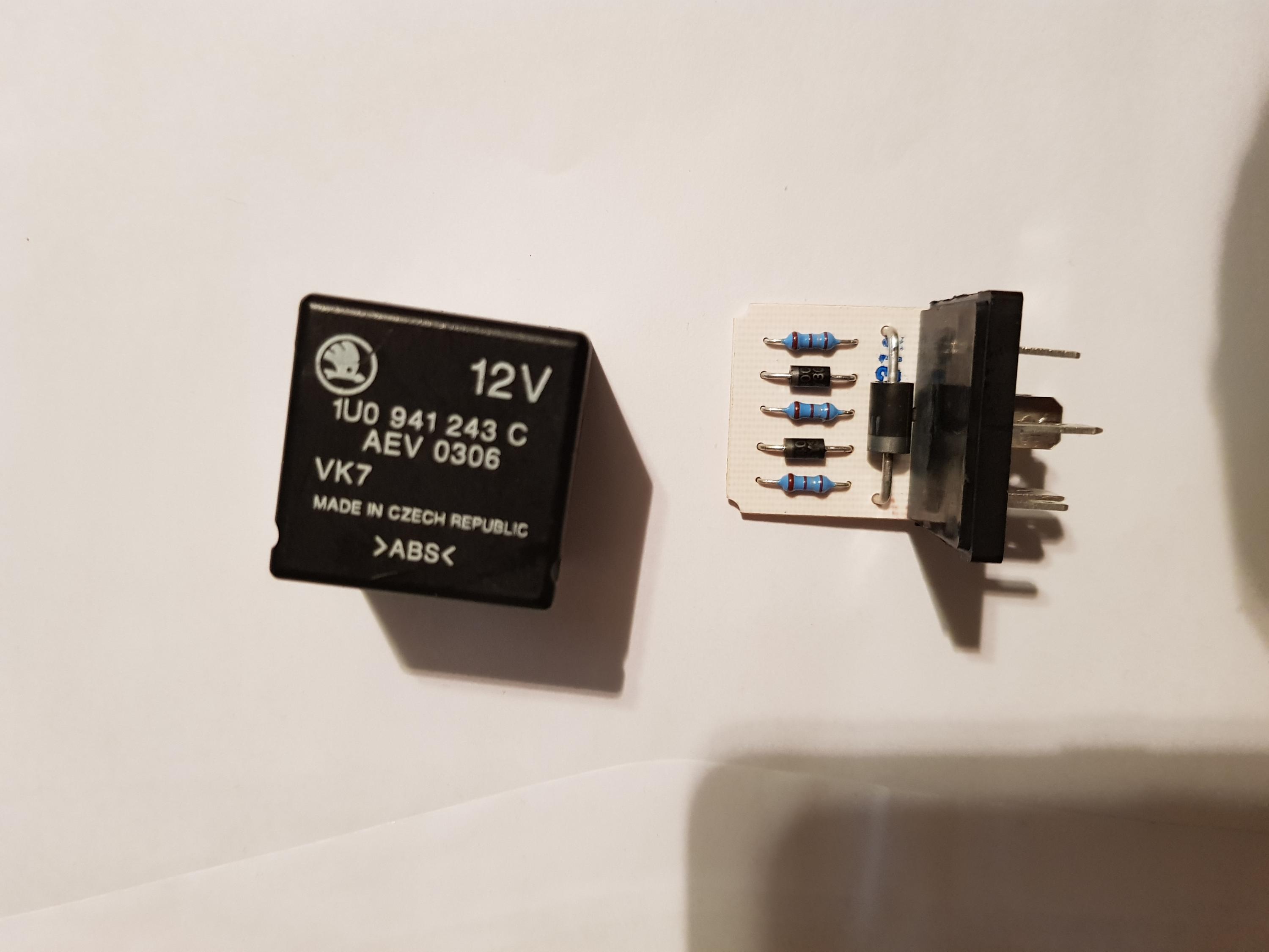

    Is it possible to repair this relay?
    the three resistors look like they have purple color on the bands is that correct? and one of the small diodes is broken. i ask because it is said that normal relays are not serviceable

    easy to fix or even fully rebuild if the mood takes you .

      what the heck...what's the switching element in this "relay" ... why aren't these diodes and resistors potted with the rest of the circuitry if there's more in the base?
      Without more data...that can't be a relay even if the encapsulation looks like one.
      Seems this PN crosses to other relays but no specs found yet. Probably has parts embedded in plastic (SSR) making it that much harder to replace the switching components if they're there.

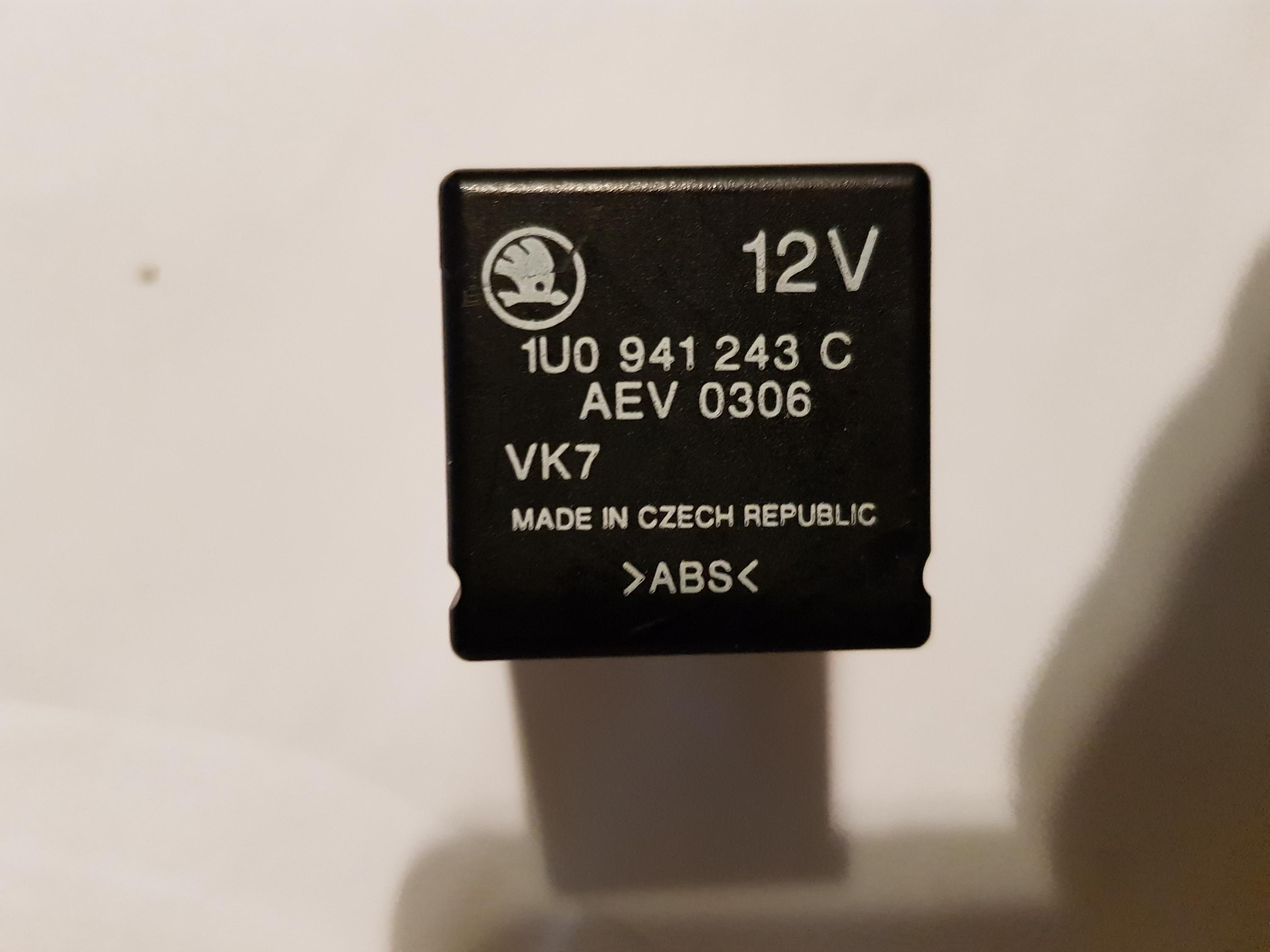

          yes it is a relay that belongs to a scoda octavia. "Probably have parts embedded in plastic (SSR) which makes it much more difficult to replace the clutch components if they are broken." exactly what i was thinking but there doesn't seem to be more than traces in the plastic protection

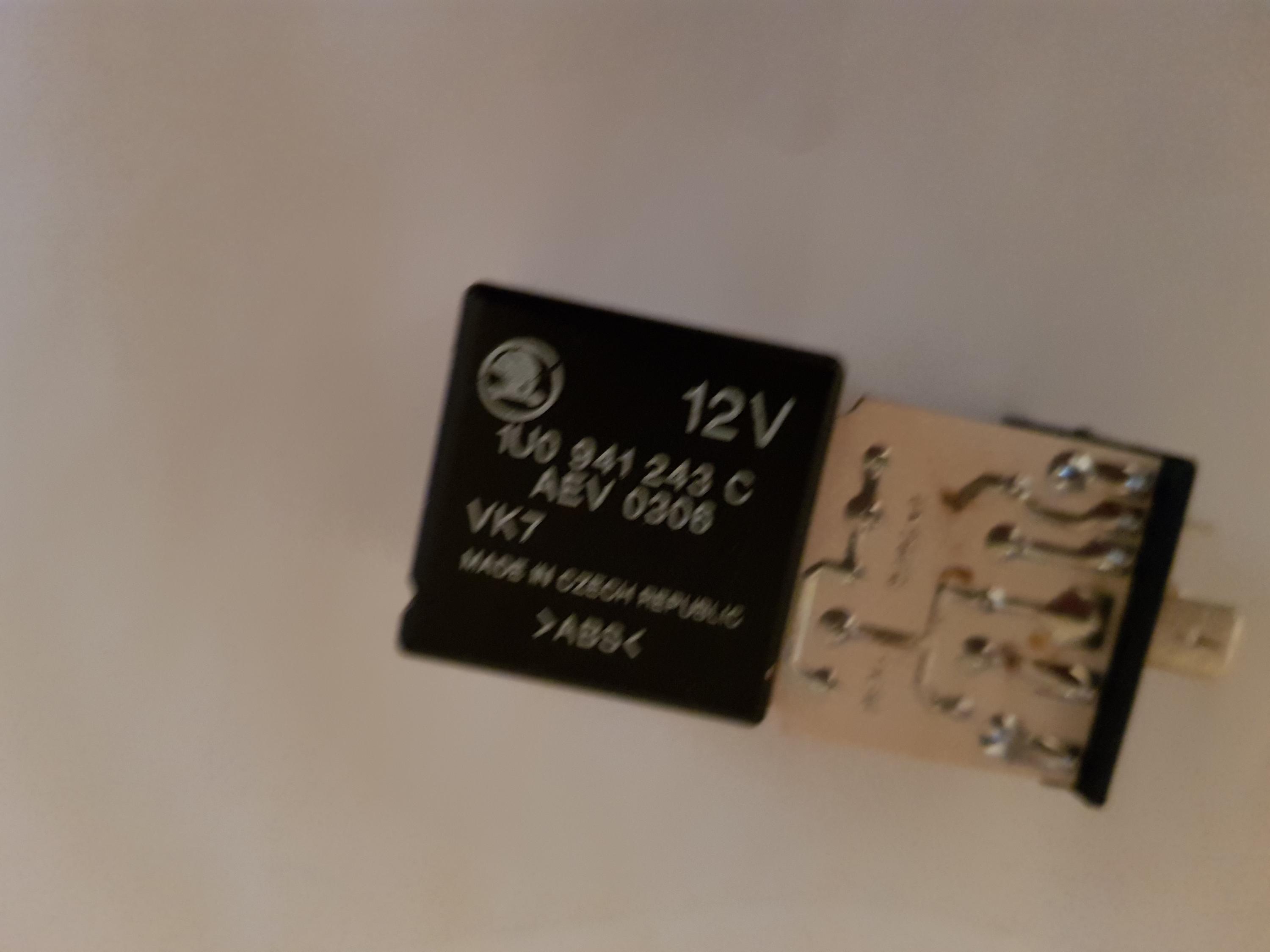

            Take a photo of it in sunlight...
            You know, maybe we need to start poking people to do this when they take pictures of resistors asking what color bands they are, so we don't have to trust the CRI of their light source as well as the "CRI" of the photosensor... enough trouble as it is that our monitors tend not to be color calibrated either.

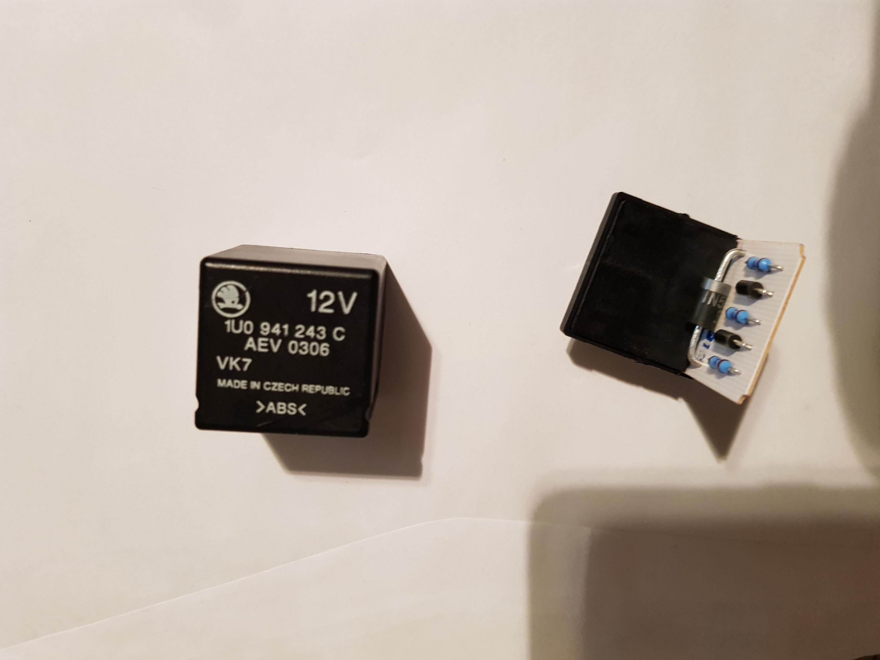

                You could remove one and measure it's resistance.

                    You're right, but right now I can't trust my eyes. it's 4 bands not 3 as I said before
                    Might be easier to see the colors in sunlight too, it's not only cameras that benefit from better CRI!

                      Oh, I see the PC board trace is melted and lifted up, it must have fused due to a short circuit in the car somewhere. It might have also blown a 1N4004 diode.
                      The resistors are not a problem, I see the middle as gray-brown so possibly 680Ω the first stripe I thought purple but no parts exist like that i.e. 780Ω.

                        ya there is a broken IN4005 but I measure 180 ohm po resistance with a lifted foot. In4005 Sy309 is the 2 small diode one is blown

                          You know I'm saying the copper track has melted
                          There is a problem with the car. It will just blow the relay once you repair it.
                          OK the resistor first stripe is brown then for 180Ω, and they are 1N4005 and a 1N5404.

                              Yes, inside the relay the track looks to have melted. I would say it was overloaded- which melts the PCB trace and pops the diode.
                              I would say a new relay or fixing this one and it will just melt again.
                              There must be a short circuit, such as a light bulb (socket) or cheezy LED lighting added to the car, or maybe some damaged wires. I can't tell what goes to the cracked diode.

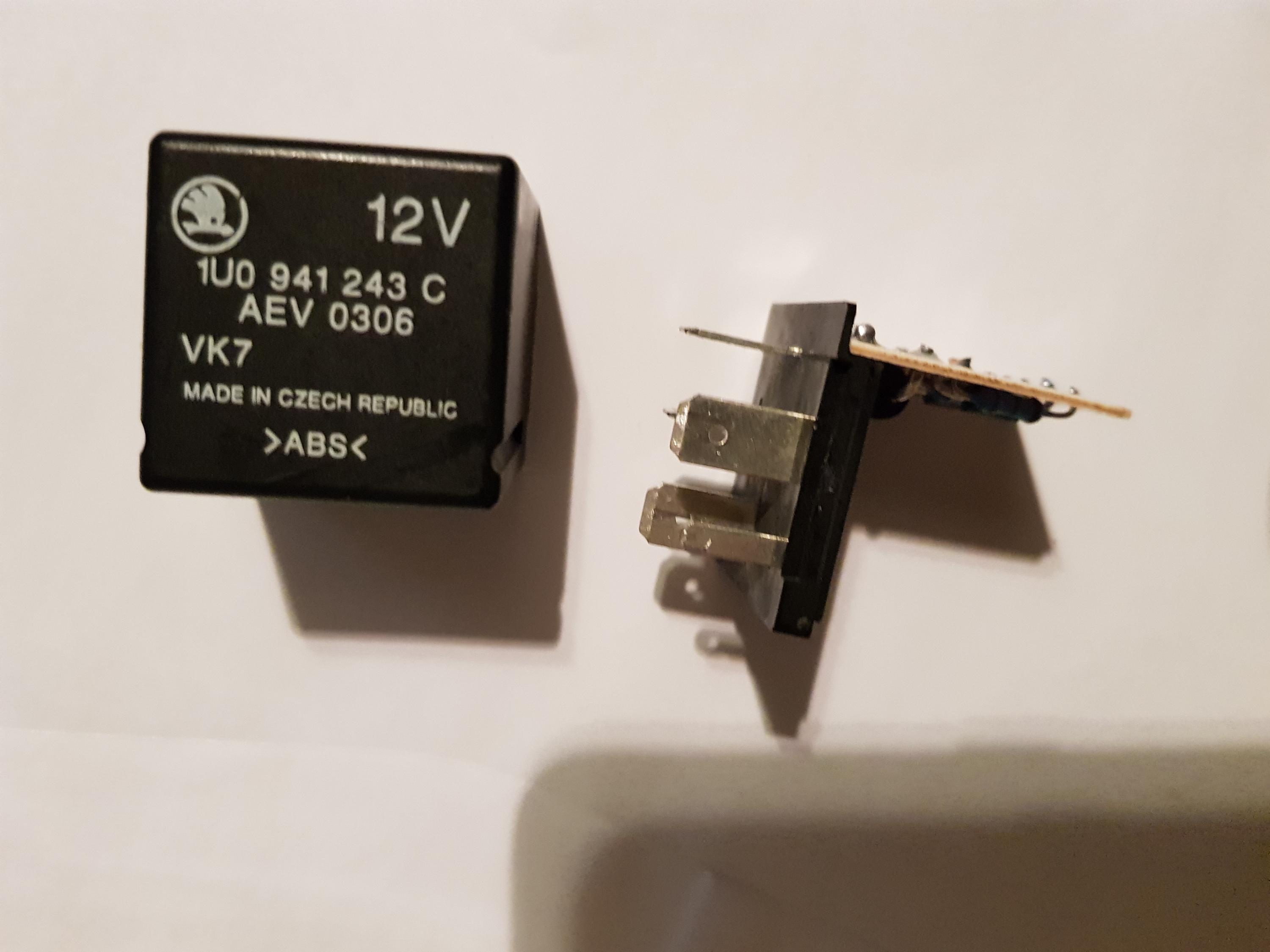

                              Can you post a clear picture of the circuit board trace side AND the relay pins (numbers). Do you have a wiring diagram for any of the car that involves the relay?
                              Škoda Octavia - 1U0941243C, AEV0306, VK7 relay, it seems to be for the power door locks (was the car in an accident?) and alarm system?
