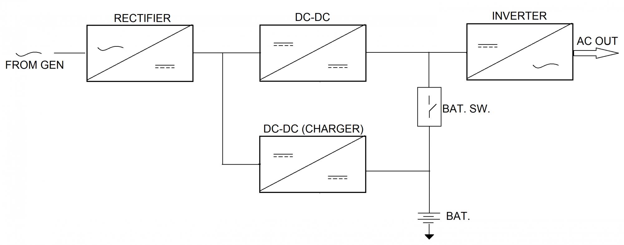

                  Here's how I'd imagine a small-ish DIY charge controller for home use. The components can be up-scaled as needed for bigger stuff, of course. That battery switch is a little tricky, as it has to open when the turbine turns (charge mode) and close when the wind stops (battery mode). I see an op-amp in there somewhere maybe...
                  Victron already has this stuff pre-made from what I gather.
