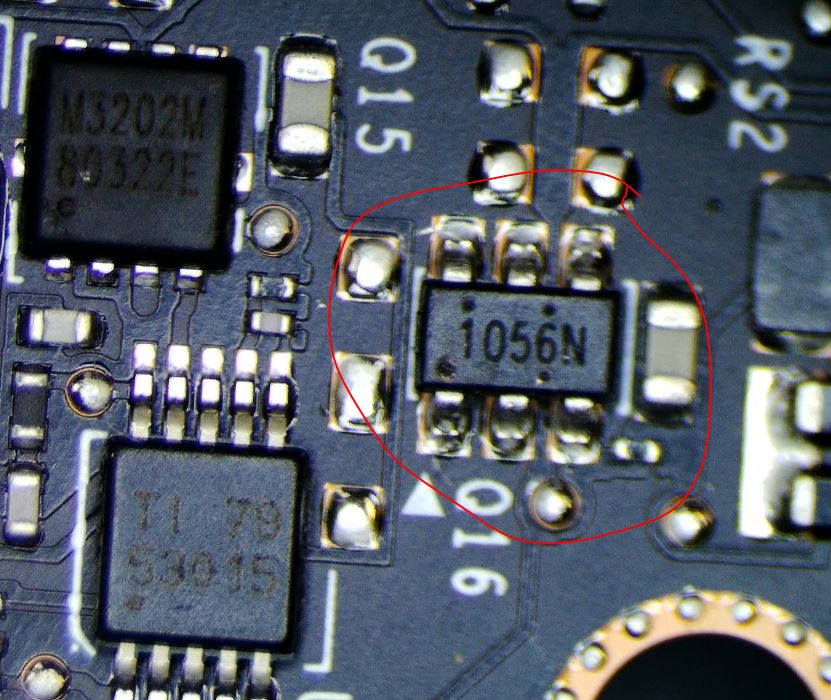

    Hello guys
    Got a broken Nvidia Shield, and I would need to replace Q16
    marking is 1056N
    Can someone help me understand how to identify the component and find a proper replacement?
    Thanks!

    It's a mosfet beyond that don't know but are you sure the board is still not showing shorted after it's removal ?

      Re: Nvidia Shield - Identify Q16 replacement
      Yeah I also know its a FET, and needs to be replaced.
      you can even see a burn mark near pin 1
      4 pins are shorted
        Which 4 pins ?
        Anyway I was asking if you've removed it yet to see if the short still remains between any of the pads and ground.
          4 pins are shorted
          That's not a burn mark, that is the small hole marking pin 1
          Here is a similar thread with the same mosfet in question https://www.badcaps.net/forum/showthread.php?t=89408
          In other threads Q16 is marked 1054P and 1052U, so 105 might be the product number

            It could be a Sinopower APM2605C. I found the info on a russian forum.
            https://datasheetspdf.com/pdf/110707...wer/APM2605C/1
