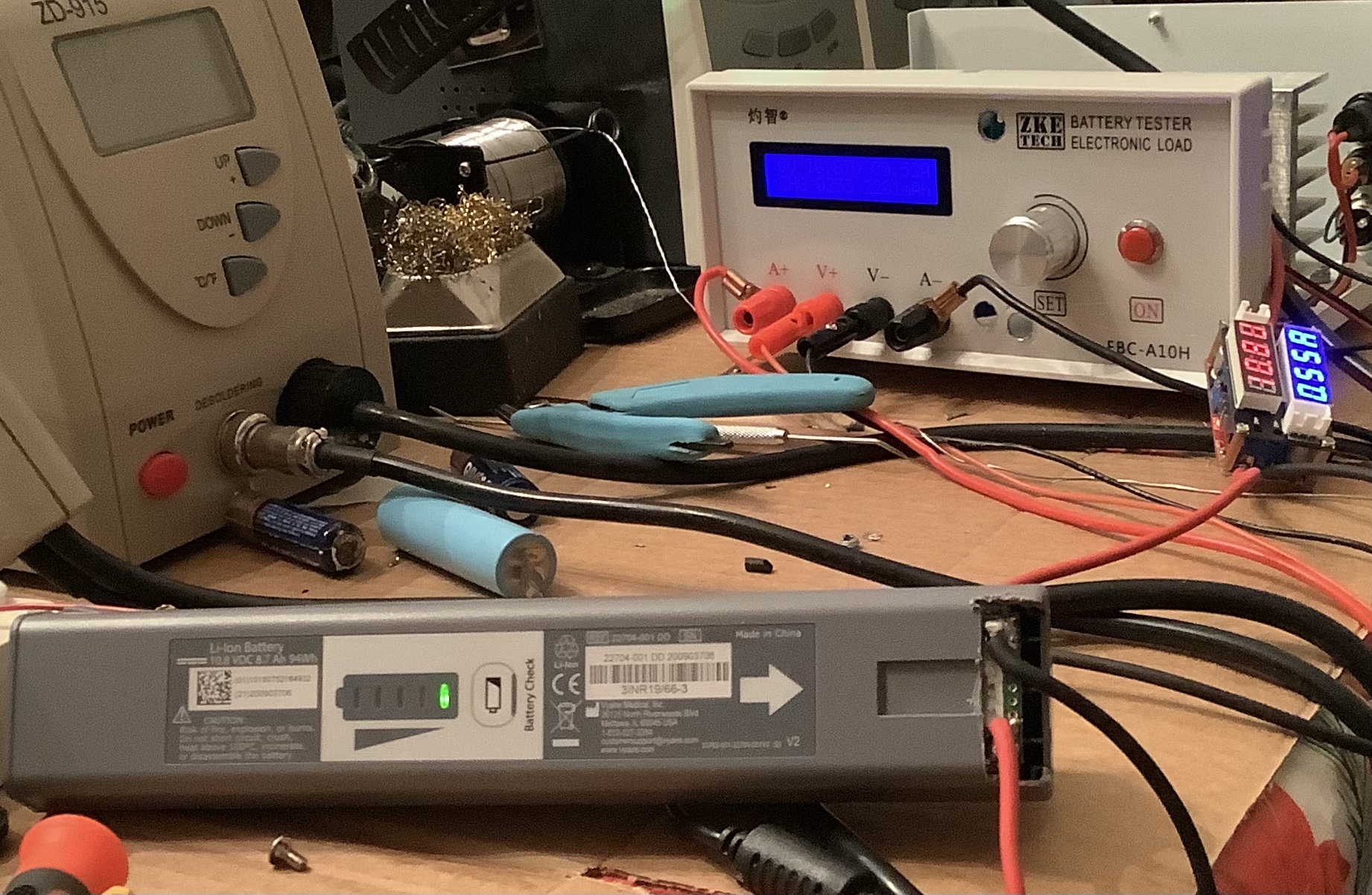

EBC-A10H BatteryTesting Machine Mosfet Failure when activate dose not turn off
    • Jul 2011
    • 6070
    Re: EBC-A10H BatteryTesting Machine Mosfet Failure when activate dose not turn off

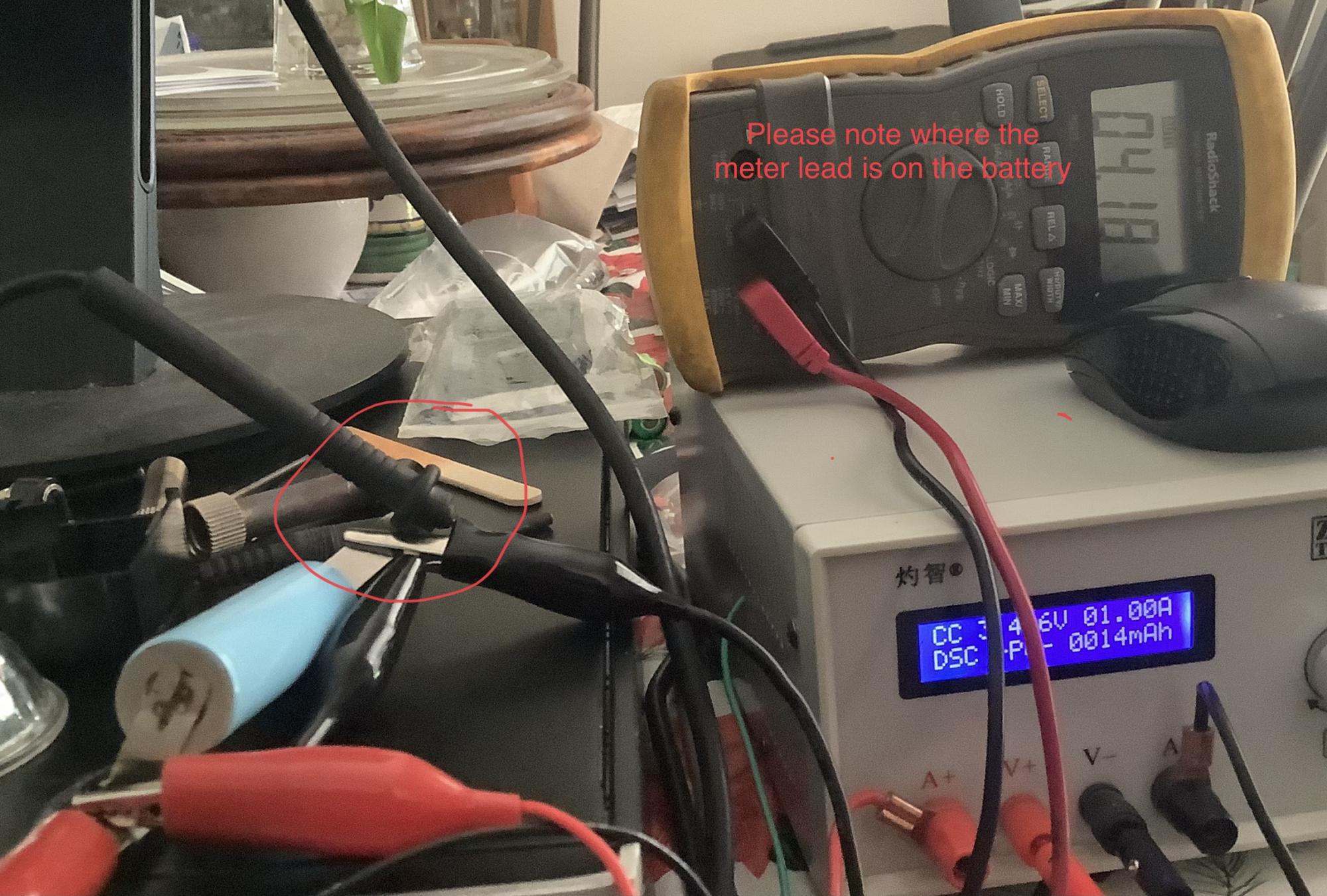

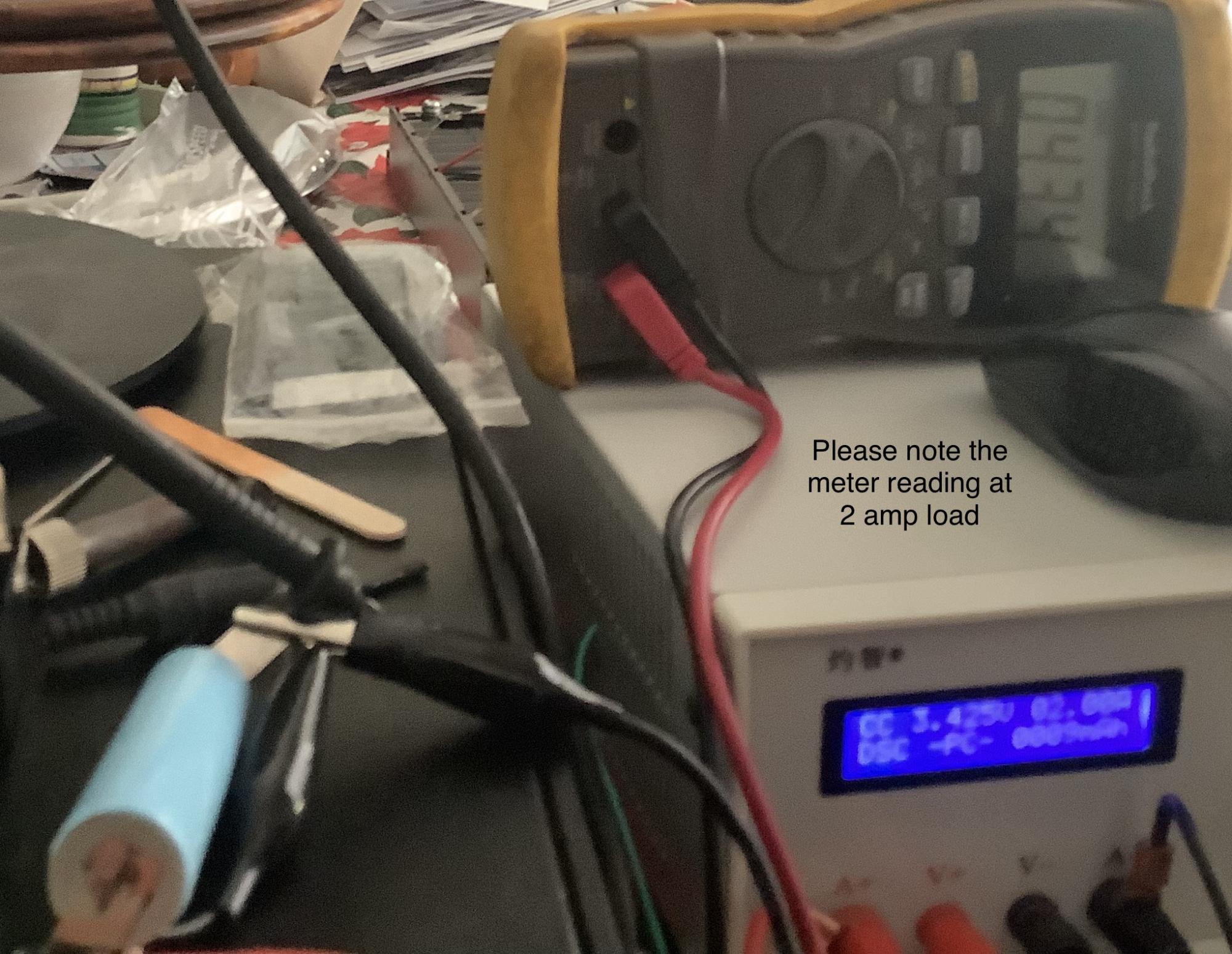

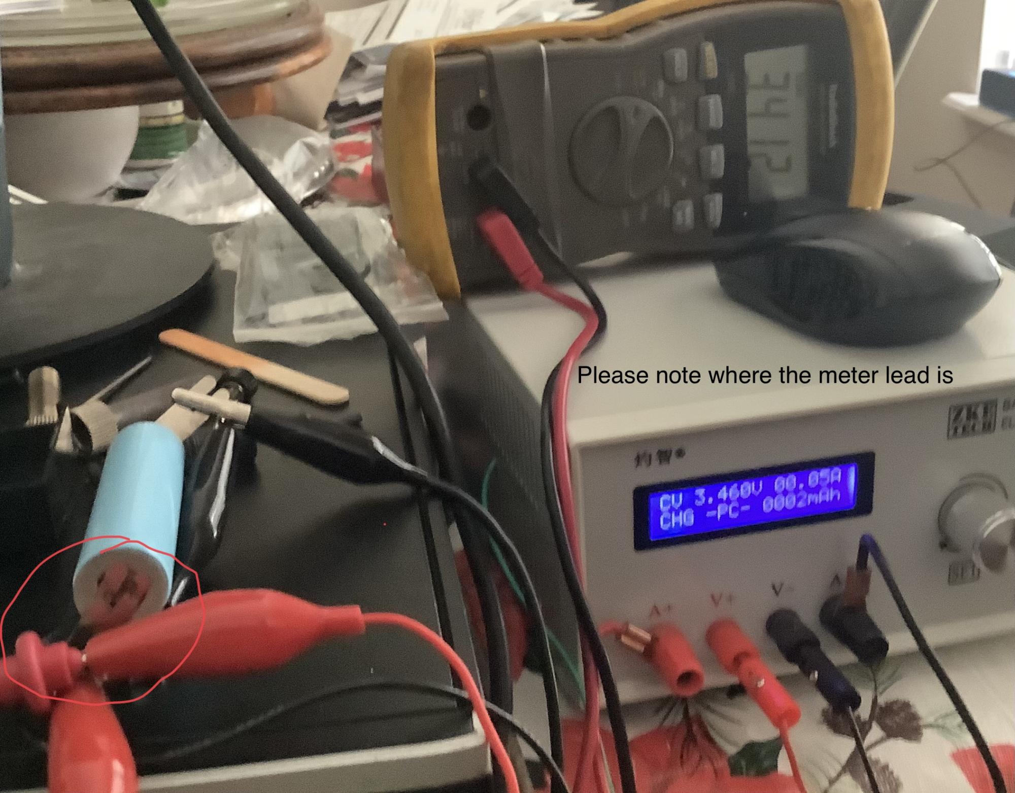

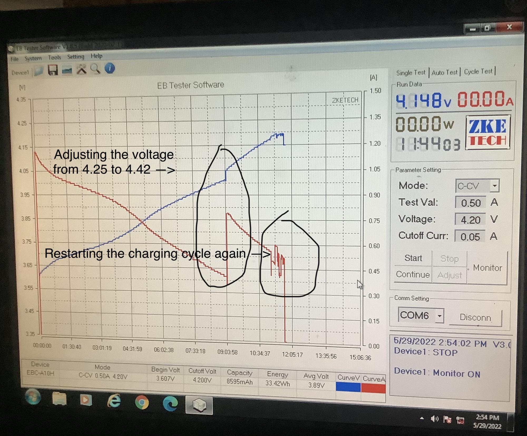

    Here are the testing results from the battery with a BMS protection board
      • Jul 2011
      • 6070

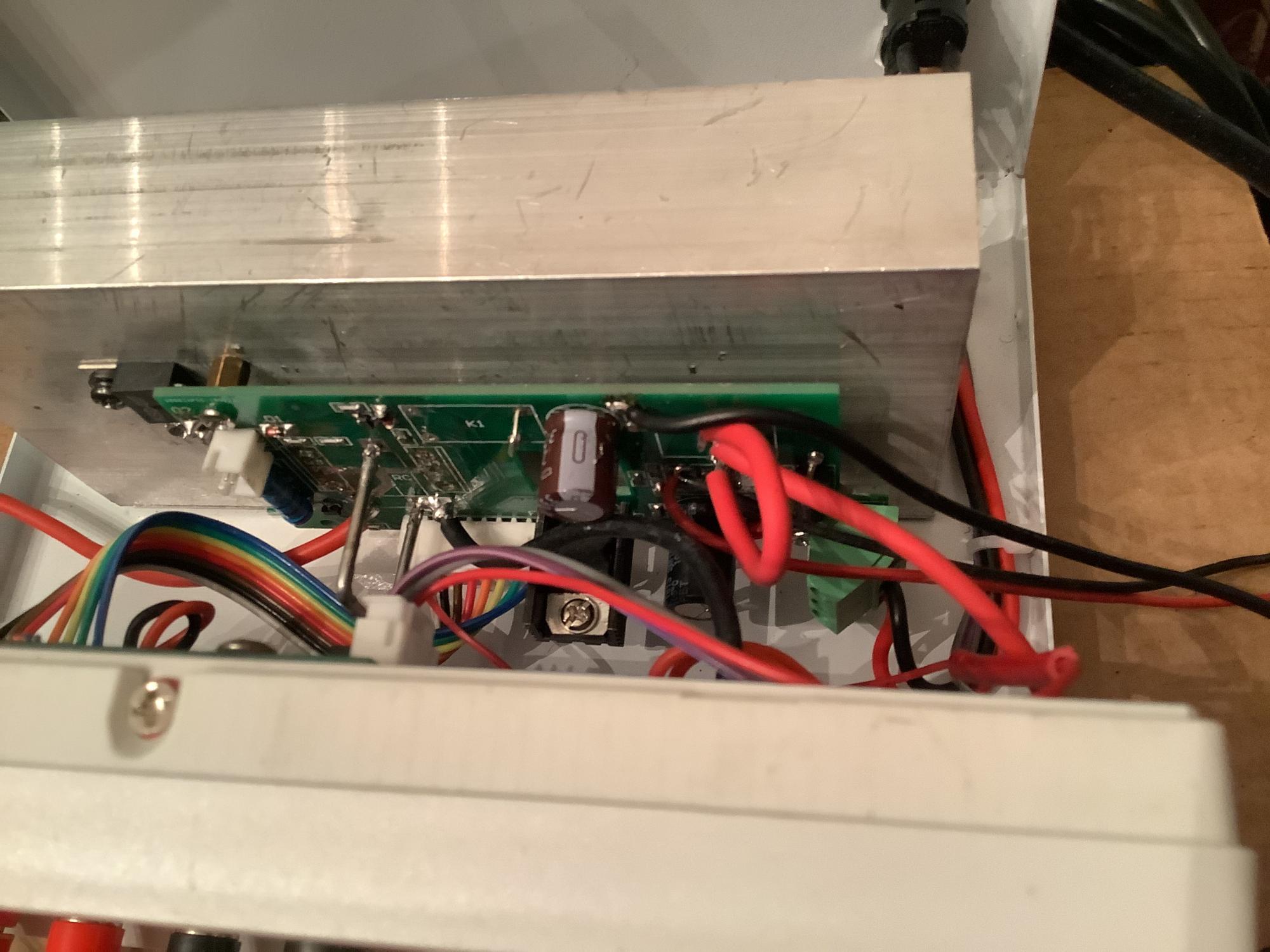

        O.k. Somehow the gate pins use three 10k ohm resistors… and where do they go from there?
          • Jul 2011
          • 6070
          One resistor go from the positive side of the power supply one gate pin to the next resistor then to the next gate pin then to the negative side of the power supply in between the two resistors is the resistor that goes to the controller board which appears to go to one of the lm358 ic chip but I not quite sure exactly where it goes for sure because it has a pin connector on it
          (P)———-resistor——— gate pin ———> | <———gate pin ——— resistor——-(N)
          ><= resistor connection to the controller
          I have to check this to make sure I have this information correct I might have this a little bit wrong

            While you’re at it, draw it out. You say the controller board is o.k.?
              • Jul 2011
              • 6070
              Yes one of them works with out the mosfets not installed the volt and current meters work
              The other one does not work correctly on the current it will show 5.5 amps or it does not show anything but does not charge any more the voltage meter still works with out the mosfets not installed

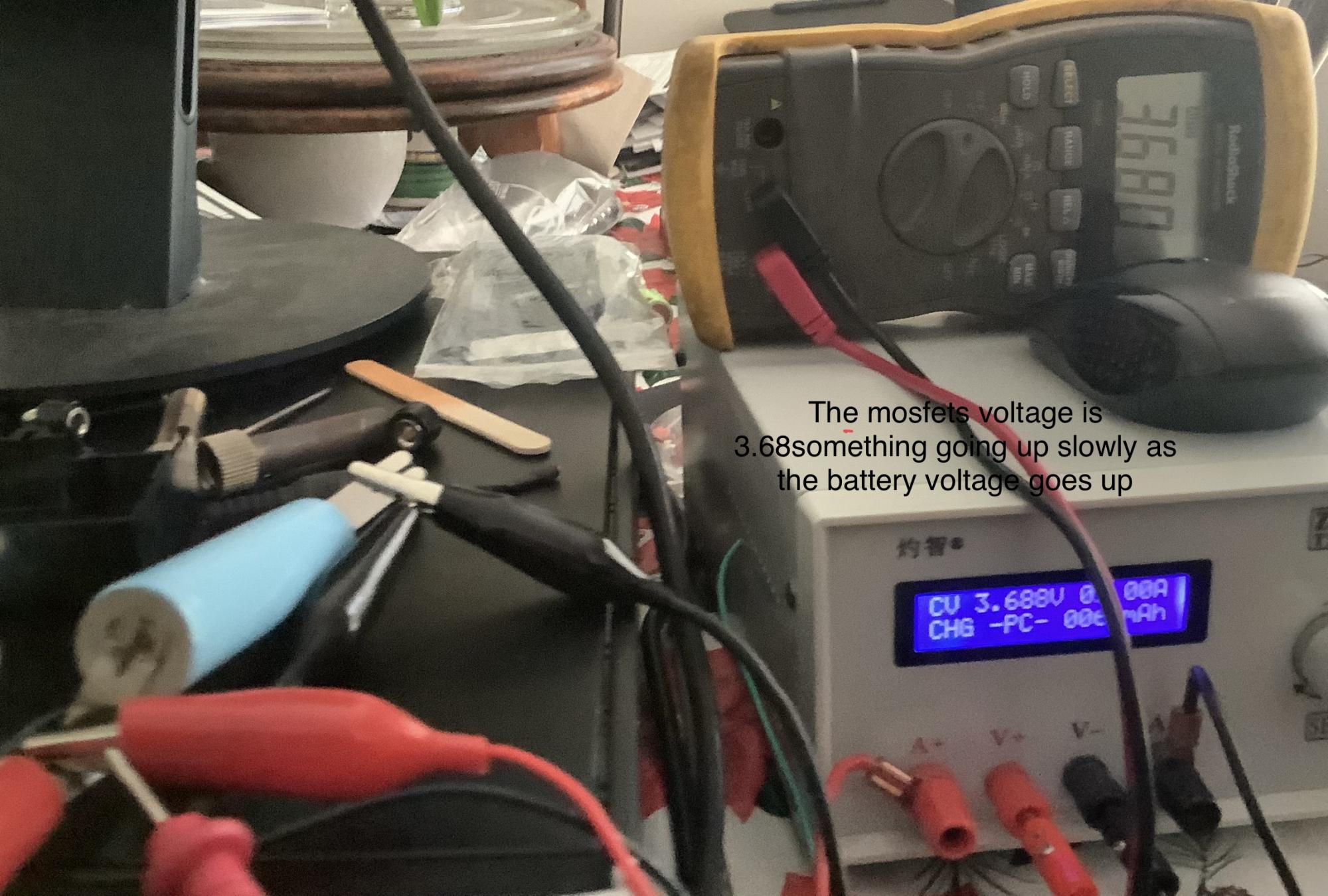

                I don't think the Mosfets turn on while charging. I think the Mosfets must have some weird configuration, where the large heat sink is on the bottom of the board and the Mosfets mounted to them, cooled by a fan. So I think this section is your "load". The Mosfets should be turned off during charging.
                I can't imagine it being any other way. If the Mosfets would be sticking out on top, the N channel Mosets would be facing each other and cooling of them is a headache. So this doesn't make any sense, as it couldn't handle any load at all.
                To me the Mosfets are mounted laying upside down to the board (the Mosfets back facing away from the bottom of the board), so a large heat sink can be mounted. So no... those suckers do Jack while charging. The resistors are placed to prevent an accidental turn on of the Mosfets each side. Plus don't forget protection for being hooked up backwards!
                  • Jul 2011
                  • 6070
                  I will have to try this on one that still works correctly that is not new and see if the mosfets are used while in the charging mode but what I can tell you is that the voltage regulator is not controlling the current this much I can tell you because the on/off sensing pin is not hooked up to the controller board but is at the connector but no wire is in this slot
                  The regulator seems to be configured for current limiting mode because the resistors and capacitors the configuration that is on this board does not match what is in the data sheet

                    Well I have some answers to these questions that you asked about and I was wondering about my self the pictures will tell the story the green wire that you see on left side of the battery testing machine is from the mosfet gate pin and that is where the other meter lead is you will notice where the meter lead is on the battery when on charging and where it is discharging
                    So it seems that the mosfets are used when charging and discharging this would explain why it would sometimes act up on charging mode and would work on discharging mode and sometimes it would be reversed and it would act the other way but now it does not work correctly in either mode on one controller
                    Maybe you might have an idea how this is done I am at a loss of how this works
                    The only thing that I can come up with when it is charging the current is one direction and when it is discharging the current is in other direction because I once had a car that had an analog current meter and in the center was “0” current and to the right of the gauge was charging and to the left side of the gauge was discharging so that might be case that in one it done one way in charging mode and in discharging mode it done a different way this just a guess to what might be going on in this circuit
                    I might do an forensic autopsy on the controller board but I have not been willing to this yet because I was hoping to get a replacement controller and mosfet board but I have not gotten a response from the company that made this battery testing machine
                    When I buy another new battery testing machine I will probably do the controller board and I will post some pictures of it when I decide to undertake this when I have some more time

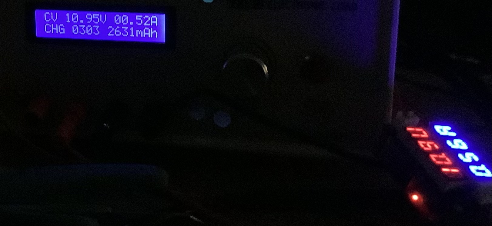

                        Are you using the same battery chemistry?
                        Some chargers stop for a fracture of a second, take a measure then continue changing. That’s with NICD, NIMH.
                        Lithium Ions are different and the charger constantly monitors CC and CV.
                          • Jul 2011
                          • 6070
                          #32
                          This is weird thing about this charger it does have have those options and I was charging a battery with out the BMS protection board hooked up and it did this that why I am a little confused about what was happening when I saw that it going 200 milliamperes to 1.0 amp which it did this quite a few times and went back to normal then a few minutes later it dose the same thing again I had it set to now if I set it for 500 milliamperes it so far has not done this so I do not know what going on with this

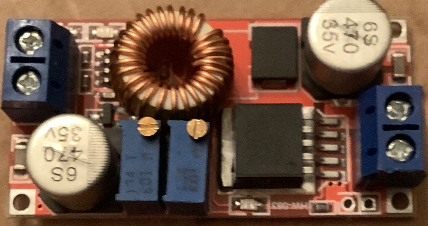

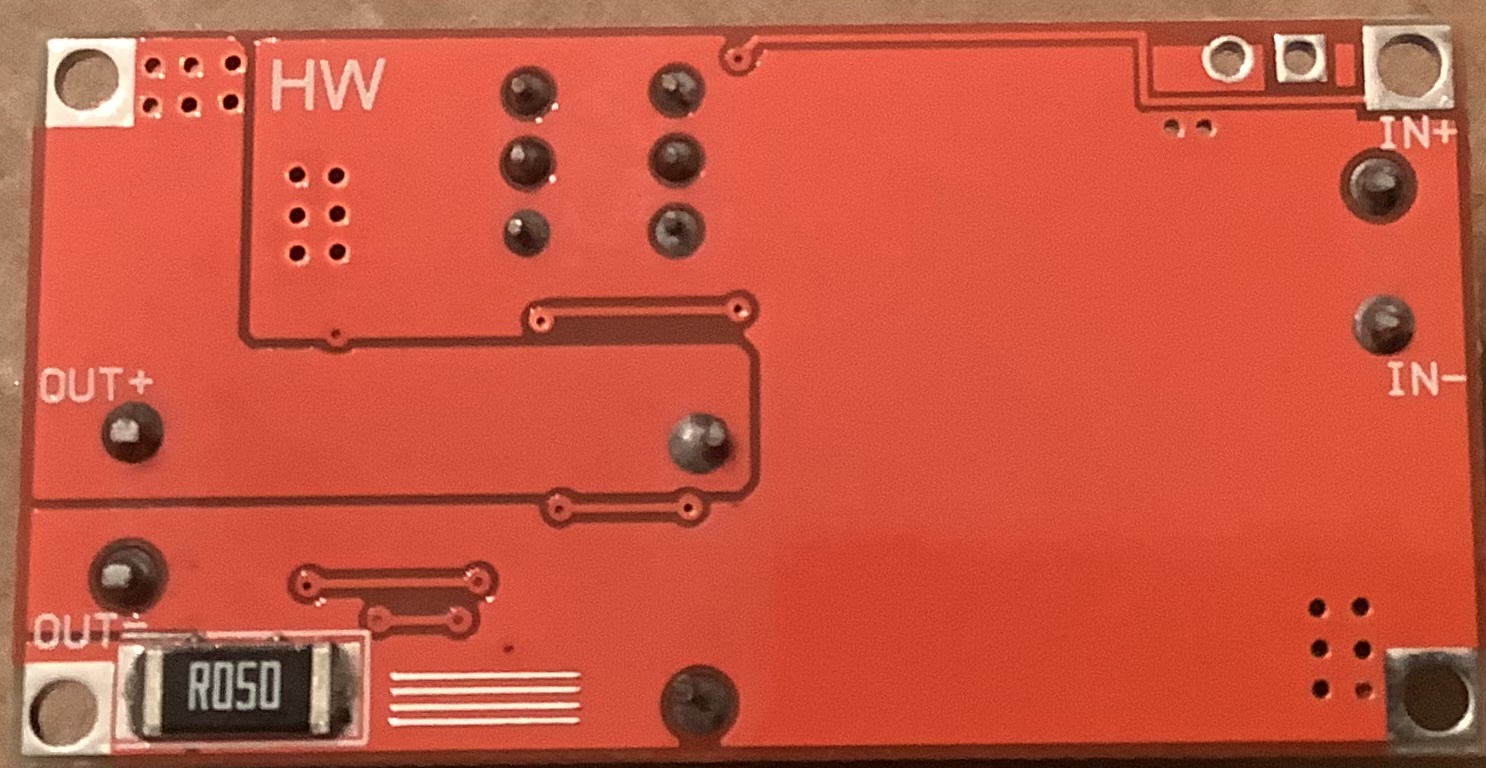

                              Well I had some time yesterday and finally found out how the charging circuit works they do not use the mosfets like it appears to at first instead they use the TTL mode on the buck converter ic chip but what I do not completely understand is how they are controlling the current not the voltage like you would normally how you would use this ic chip
                              I going to buy some new XL4015 and reinstall them with a wire on the feedback pin and switching output pin and see how this is done
                              Because I have been very curious about this is done because I have not been able to find any examples of how this is done
                                • Jul 2011
                                • 6070
                                #35

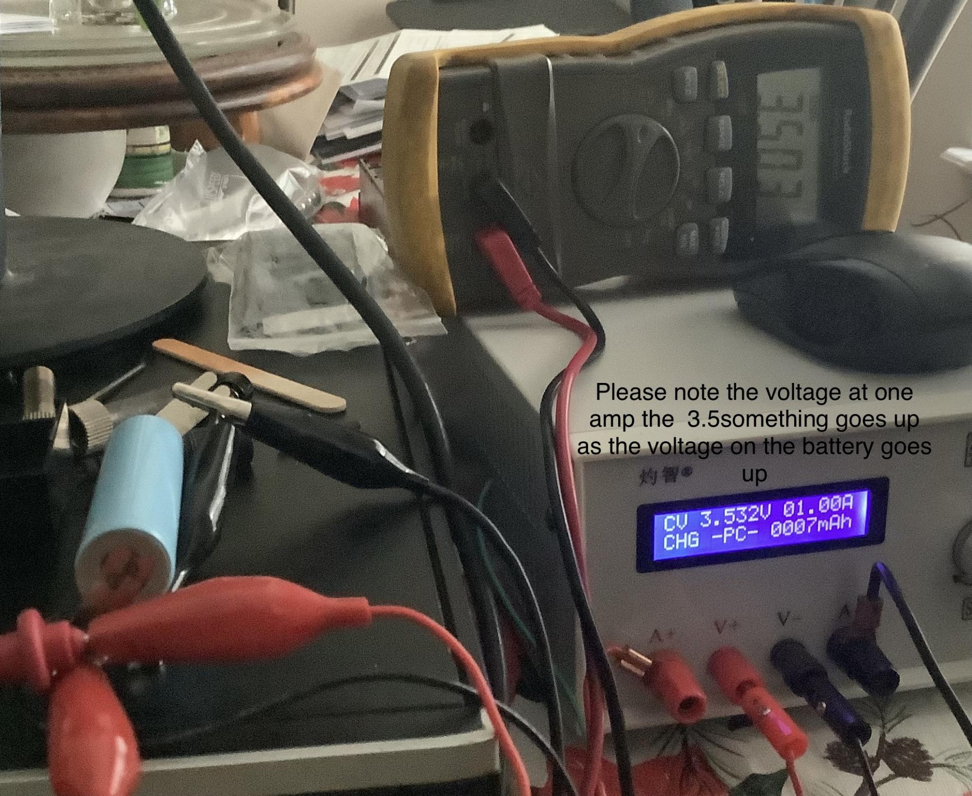

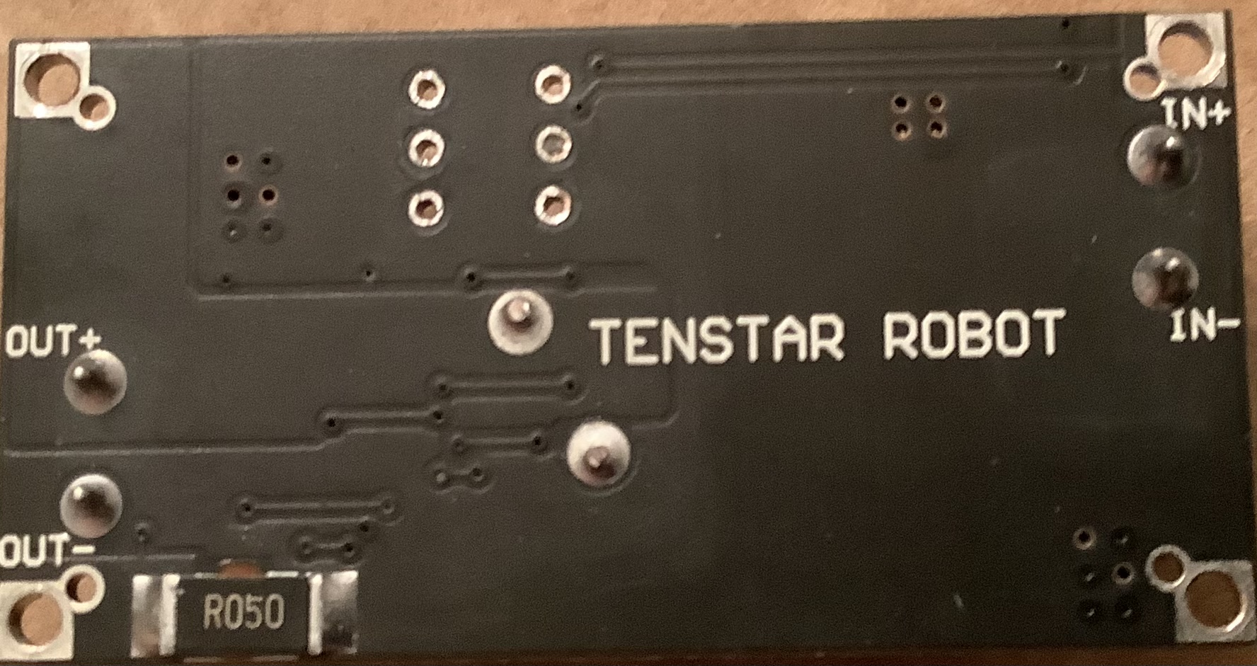

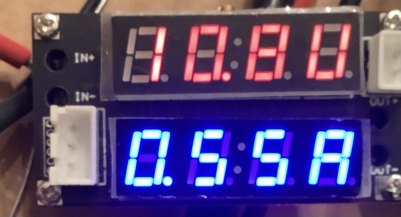

                                “ Because I have been very curious about how this is done because I have not been able to find any examples of how this is done ” from the above post

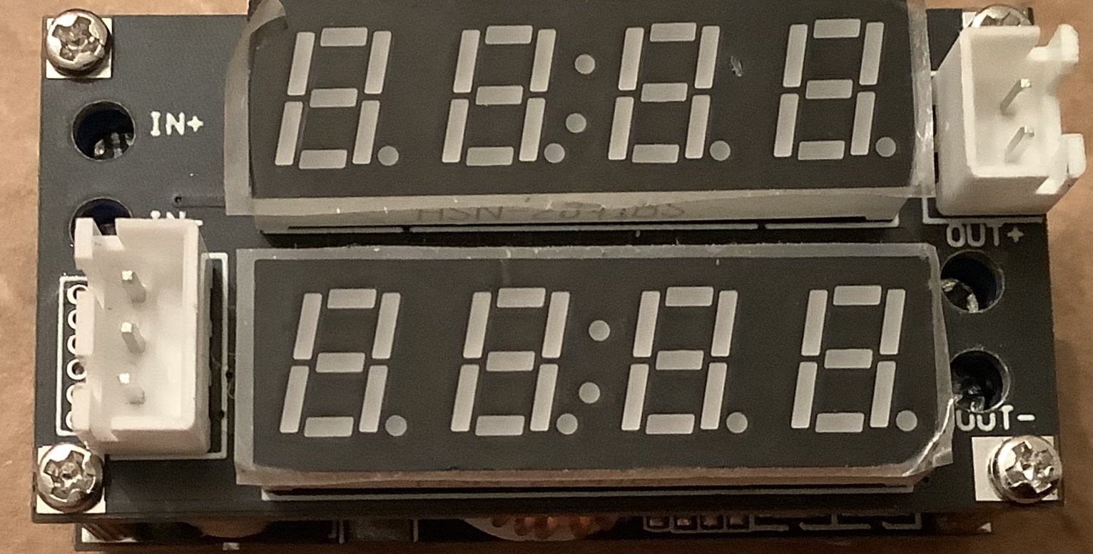

                                Major update on the XL4015 buck converter that has voltage/current control capability but more importantly the current control that has a voltage/current module meter on top of the buck converter
                                The TenStar Robot does not work correctly on the current control the current light comes on very dim but does not control the current
                                The meter seems to be very accurate for the type of meter that it is but the current control circuit is crap and does not work at all
                                  • Jul 2011
                                  • 6070

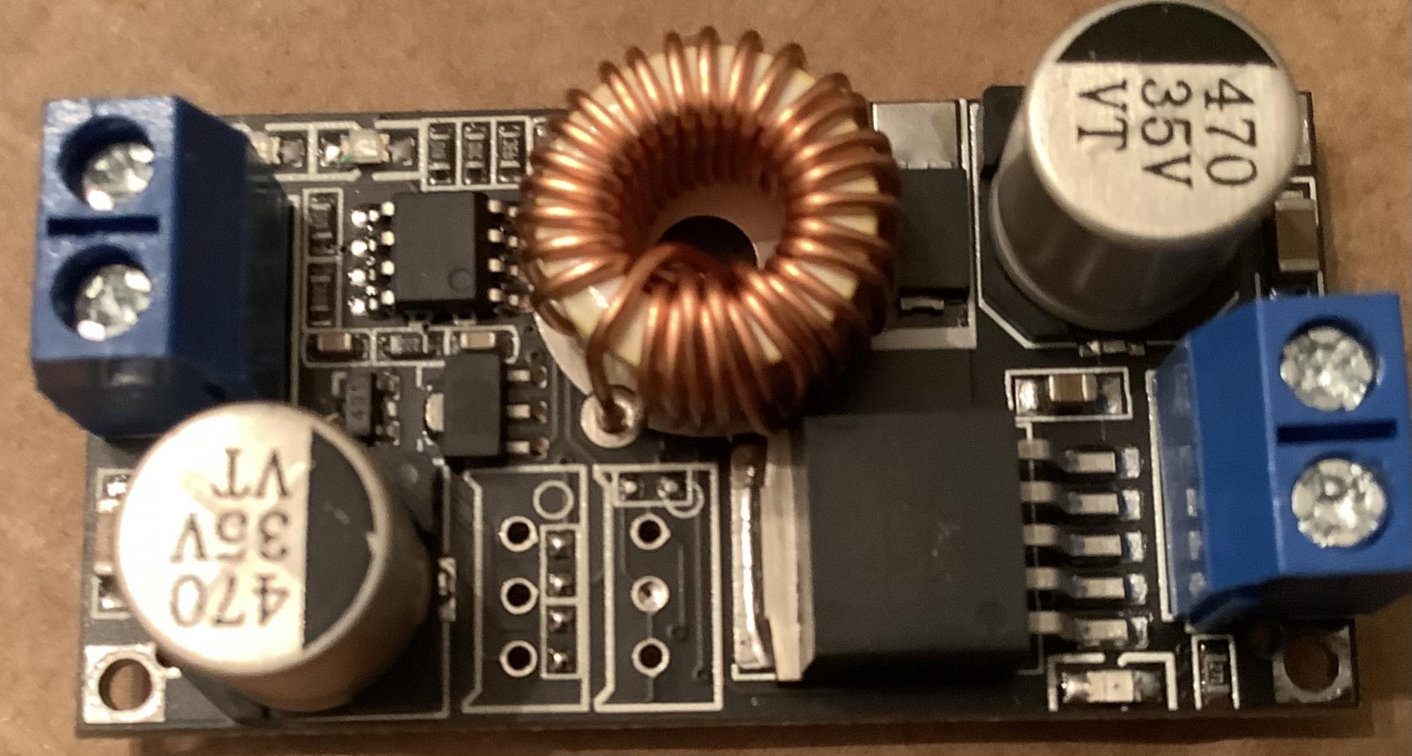

                                  #36
                                  Now this module works correctly on the current but does not come with the voltage/current meters it just so happens that the board are very similar but I had to use the pots from the one that the current control does not work correctly
                                  Now I have a voltage/current controller that actually works correctly the way it should
                                  One note about this setup it is very difficult to get this setup to work correctly because the voltage ( going UP turns in one direction but to lower the current limit you have to go in the same —>
                                  ( which you think that lowering voltage/current would be in the same direction )
                                  <— direction for turning down the current which was a little confusing at first
