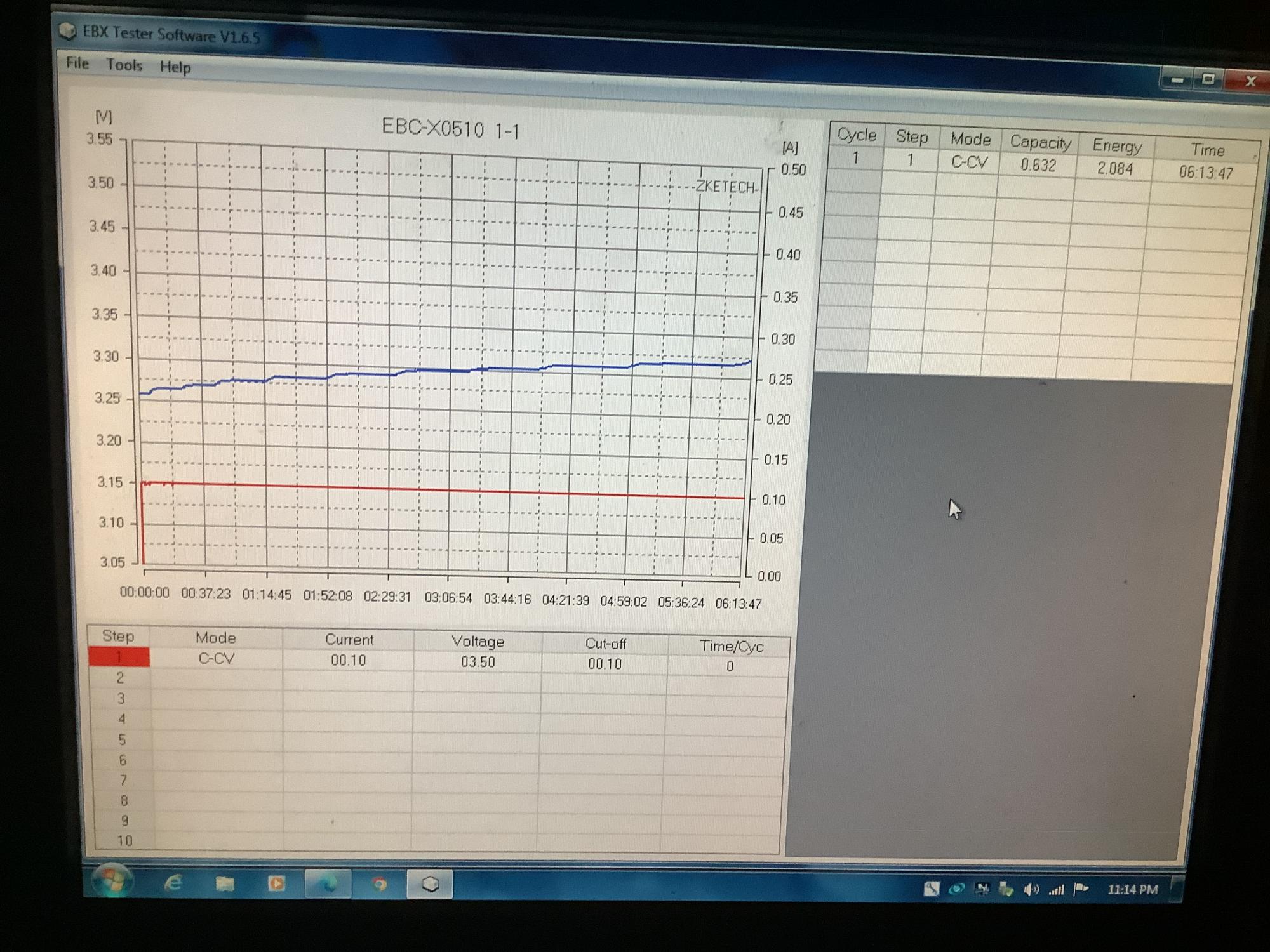

    Well I bought another battery testing machine but this one is the EBC-A20 but this one seems to act differently than the EBC-A10H in that when charging it seems to check the voltage every so often or it is not functioning correctly and I have not figured out which case it is but everything else seems to work ok
    But I have understand why this one does that every so often and it does not seem to have a certain pattern to it from what I can see so far
    In the discharge mode it works just like the other one so I guess I will have to see if it keeps working or not

    Are you using the same battery chemistry?
    Some chargers stop for a fracture of a second, take a measure then continue changing. That’s with NICD, NIMH.
    Lithium Ions are different and the charger constantly monitors CC and CV.
    This is weird thing about this charger it does have those options and I was charging a battery with out the BMS protection board hooked up and it did this that why I am a little confused about what was happening when I saw that it going 200 milliamperes to 1.0 amp which it did this quite a few times and went back to normal then a few minutes later it dose the same thing again I had it set to now if I set it for 500 milliamperes it so far has not done this so I do not know what going on with this

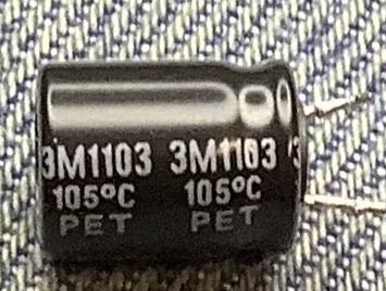

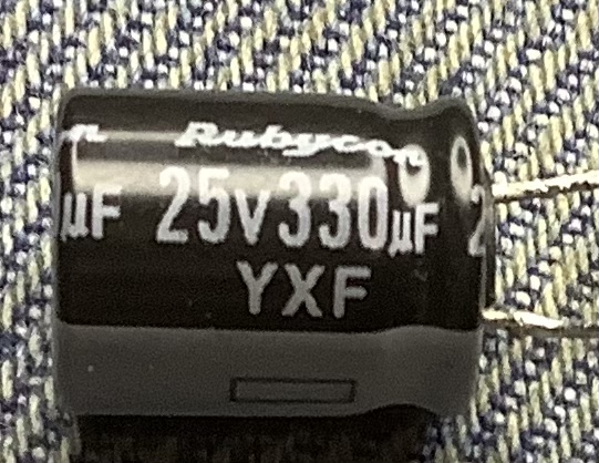

      Well turns out that the capacitor on the board where the buck converter is the capacitor and it was a brand name capacitor company but the ESR value was 0.07
      330uf@25 volts
      I put a 470uf@35 volt because I did not have one that was a 330uf@25 or 35 volts wrong height but I have this one which seems work correctly now I have ran it for several hours and it has stayed steady so far

            EBC-20A is rated <18V 0.1-5A charge, <30V 0.1-20A discharge is that right? It's powered by a brick 19-20VDC 3.5A
            I don't see you got a bad ESR reading. That 330uF 25V cap looks OK, maybe a fake Rubycon but YXF is rated ESR 0.16 ohms and you got 0.07 ohms.
            There might be a bad connection in the charger or the brick is crapping out. I am still suspicious lol.

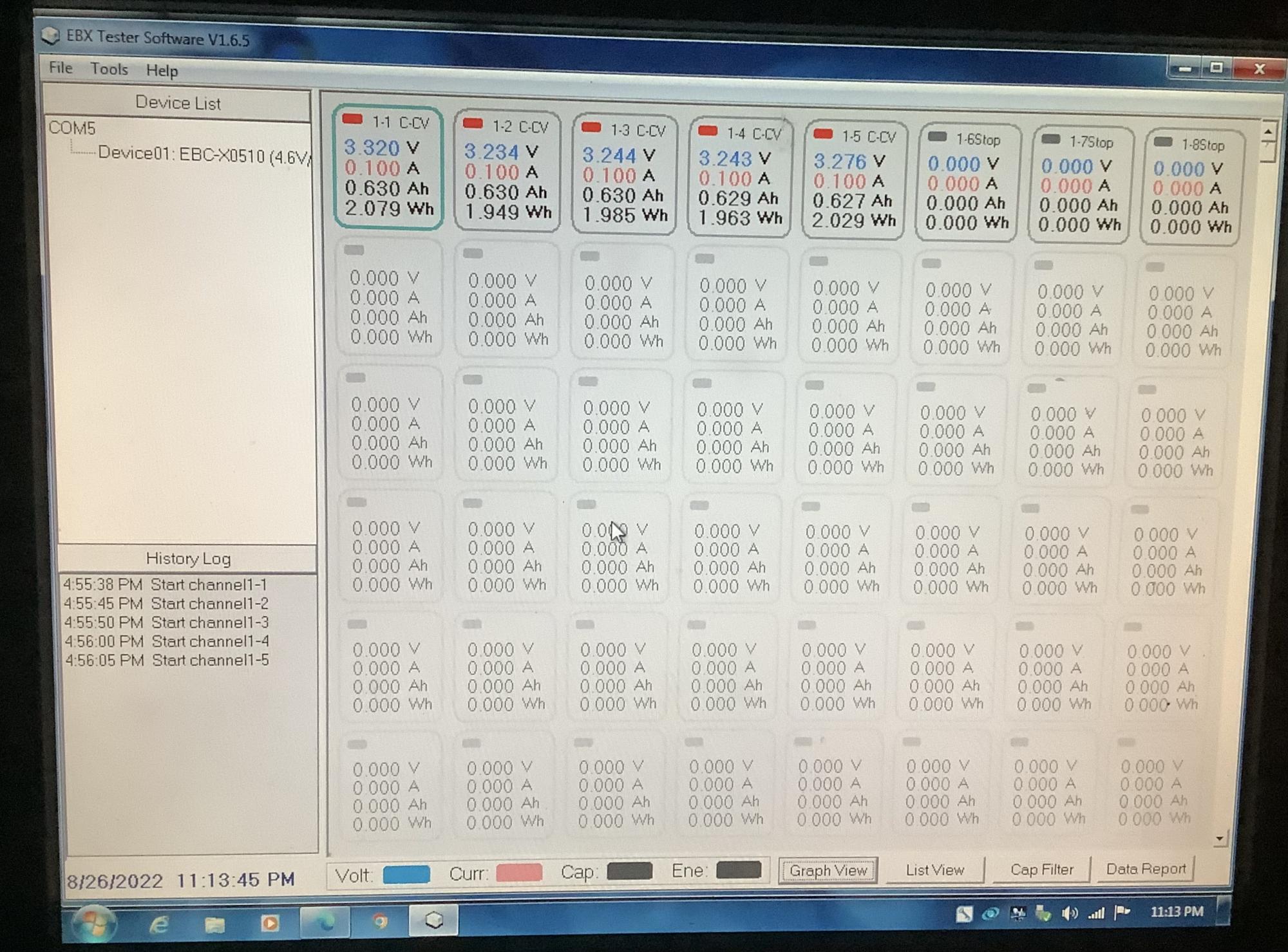

                On a different note but related for using battery testing machines
                The reason for having the current so low is that these batteries had very low voltage on these batteries and I do not know if they are damaged by this condition so I am charging them very slowly so I do not have continuously sit there and check there temperature which I would have to do if I used a higher current level
                I also bought the 8 channel version of this battery testing machine but I have to get use to setting up the parameters on this machine because it only has cycling menu not for single charging or discharging cycle but I have used it before but it not as quick as the single use setup
                This is the battery packs that I am testing

                The one thing that is also different is that when you want to see the test curves on the graph you have to click on the channel number that you are using for the battery in question the one thing that that they left out of the graph is the quick look on the voltage and current reading you have to go back to the main page to see this information
                One more thing is that you can only test one cell ( in a battery pack ) at a time which is okay but you can test eight batteries at a time which is a lot quicker
                The reason I bought this battery testing machine that has eight channels is this how I am going to charge signal battery cells instead of the other battery testing machine which can only do one battery cell or a battery pack with more battery cells in series up to 24 volts
                Now if I have a battery cell that the battery graph looks funny then I put it on the other battery testing machine to have a closer look at the battery graph curves which other battery testing machine does a better job of showing issues with the battery in question
