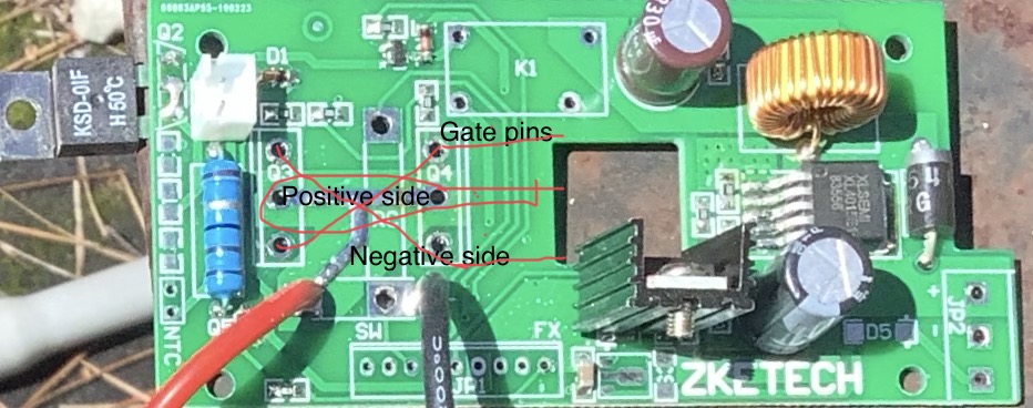

    I have an issue with this battery testing machine that if you activate it for 50 milliamperes charging mode it does not do this correctly it goes to 350 milliamperes and does not turn off until I power cycle it then it will be in the off state
    If I remember correctly it is a IFRP250N
    The Mouser part number is IRFP250PbF lead free version is the only type that is available now
    I can seem to find them at Mouser it seem Digikey shows them out of stock lead time 66 weeks lead time
    I going to order some but senses I have to repair this because of this failure I going to see if I can modify the charging controller to charge from my 5 volt 5 amp power supply so I can use my usb charger setup to test usb battery packs because the usb battery tester that uses the same exact software has an issue where after a certain amount of time it shuts down and stops counting the the amp hours correctly
    I will post some pictures of this repair when I receive the parts from Mouser because I have to order some other parts from them as well for another project
    When I order some of these mosfet I going to order enough of to have spares to repair the other two battery testers that I also have

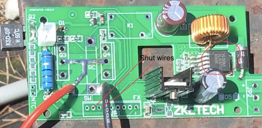

        Here is the data sheet for the buck converter ic chip
        https://cdn.badcaps-static.com/pdfs/...99e3c5b9eb.pdf
        This device is interesting it can be controlled by a TTL signal and it also shows you what components you need to make it work in figure number 9 at the bottom of the data sheet
        As you can see in the picture I have found the current sensor wires one of them is the common negative side of the battery side and the other side is the power supply side of the controller so this might be very easily done but I can not just power the board with a 5 volt power supply because this board also has a 12 voltage regulator that is the device that is on the heat sink but it is what I was hoping for and that the power supply side I was able to find the current shunt wire which I did now I have to find out what the resistance of the shunt device is so I can closely match it as possible and then I can do what I want with this battery testing machine

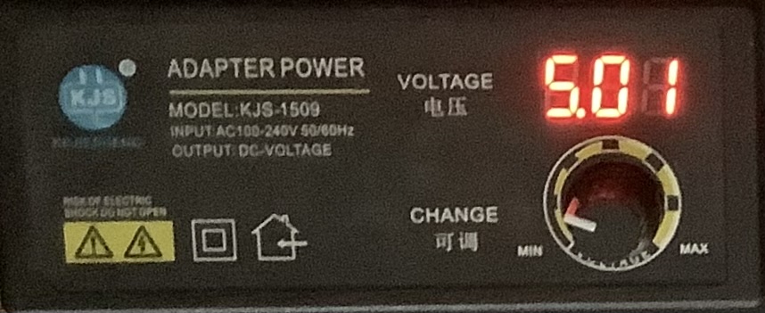

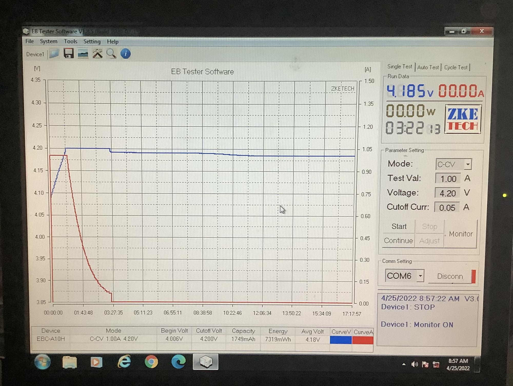

                  I tested a battery with a BMS protection board and the results are what I expected them to be one twin 18650 batteries with a
                  Settings for testing BMS 4.2 volt board
                  Battery tester 4.2 volts @ one amp
                  External power supply set at 5.0 volts unlimited amperage to 3 amps
                  The results of charging curve was what I expected it to be with a slop to zero amps and the voltage stayed at 4.2 volts when the battery tester finished it runtime the voltage only drop slightly which is what you want

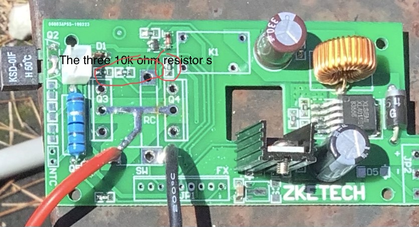

                          The controller works correctly when it wants to so I have removed both mosfets from the board and going to use an adjustable switching power supply to just charge the batteries with BMS boards like I originally plan to do until I tried to troubleshoot the issue that is wrong with it
                          The mosfets setup is a little strange to me because I have not seen this before
                          ******In between the two gate pins 10k ohm resistors there is also another 10k ohm then to the controller board
                          Positive——10k gate—— controller pin ***** 10k ohm *****——gate 10k ohm—— negative
                          Middle pins go to positive
                          Current shunt in between the positive and negative sides of mosfets
                          Outside pins to negative
                          One interesting thing about the voltage regulator setup it is limited to 5 amps with the resistor the turn on/off function pin is not wired to the controller ( with a motor as a load the output only had 2.5 amps on the input to the regulator was 24 volts @ 3.5 amps for the same motor ) I did not check the voltage that the motor has when going through the regulator
                          With out the mosfets installed the current is not controlled somehow the mosfets control the current but I have not figured out how they are doing it but my guess is the way the gate pins are configured is my guess but I just do not understand the theory behind this setup on this controller
                          I understand the discharge mode but not how the charging side of it works with the mosfets

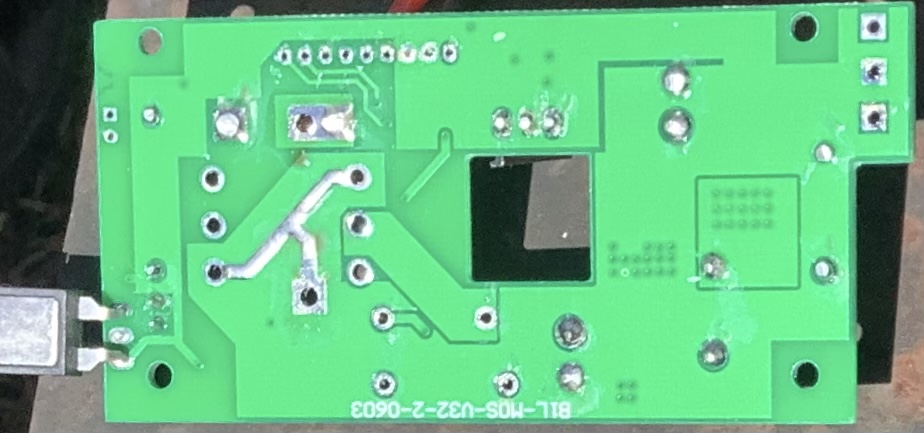

                          In post #4 I have both side of the board for the mosfets
                          If someone out there understand how this controller works in the charging mode I would greatly appreciate an explanation of how it is suppose to work ( in this configuration setup )

                                I've been following this thread for a while now. Not sure how to wrap my head around this. Anyway, I think you are stunned a bit having a 10k Ohm resistor on the gate of the Mosfet. It's common to put such a high value resistor from the gate to GND in order to make sure the Mosfet turns off. It could be that the gate capacitance keeps the Mosfet on (floating), even if it shouldn't (gate drive IC is off). So the resistor bleeds any voltage that resides on the capacitance on the Mosfet's gate pin, guaranteeing the Mosfet to turn off.
                                If I understand your problem correctly, the charger does charge, but for some reason has trouble with regulation?
                                    I understand why the resistors are on the gate pins what I have a hard time understanding why you would put a resistor on the positive and negative side of the power supply and have another resistor in series with the controller pin unless you are doing some type voltage divider circuit if so how does it work in the charging mode I understand how it works in the discharge mode
                                    I understand this part of this
                                    What I do not understand is how you use the mosfets to control the charging current is what I have a hard time with

                                      I think the mosfets are placed in such configuration that the body diodes facing each other, preventing current flow either way when off. To make Power go through, something needs to turn on the gate like a management IC or a transistor. I think the Mosfet is one n channel and the other one a p channel configuration? You need to draw a schematic of it, then the picture will be clearer.
                                        • Jul 2011
                                        • 6040
                                        Re: EBC-A10H BatteryTesting Machine Mosfet Failure when activate dose not turn off
                                        Well the strange thing is that they are the same part number for each one
