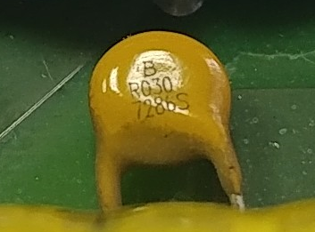

    Hello guys,
    can you please help me to identify the components shown in the attached photo,
    It is written the following:
    B
    R030
    7286S
    Is it possible that this component is 0.03 ohm resistor?
    Thank you very much.

    Re: Need help identifying a component
    Seems to be a Bourns PTC resettable fuse 300ma 60v MF-R030
      Thank you very much R_J.
