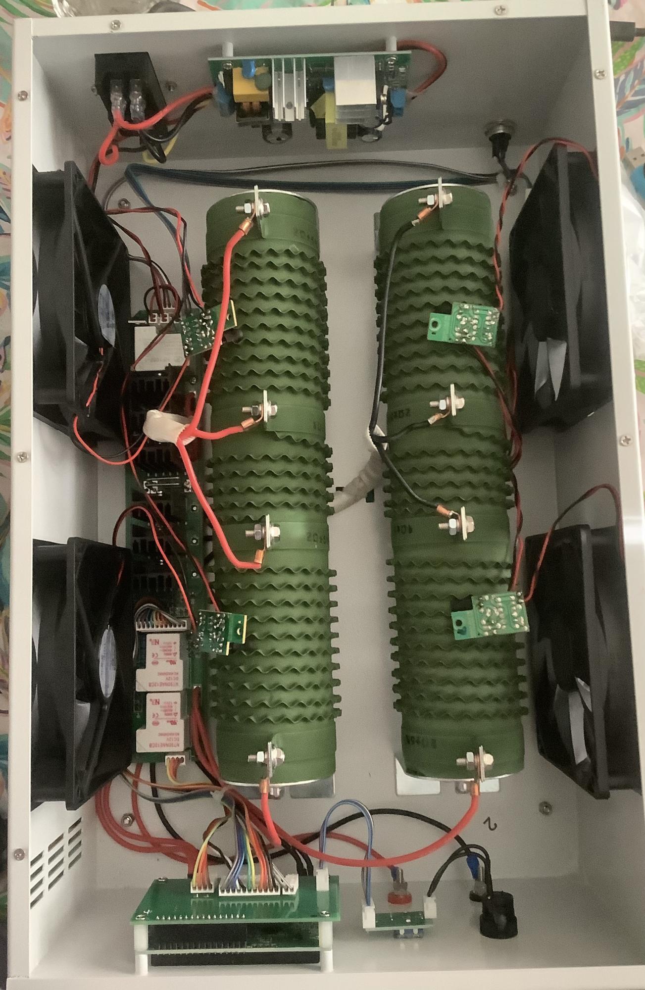

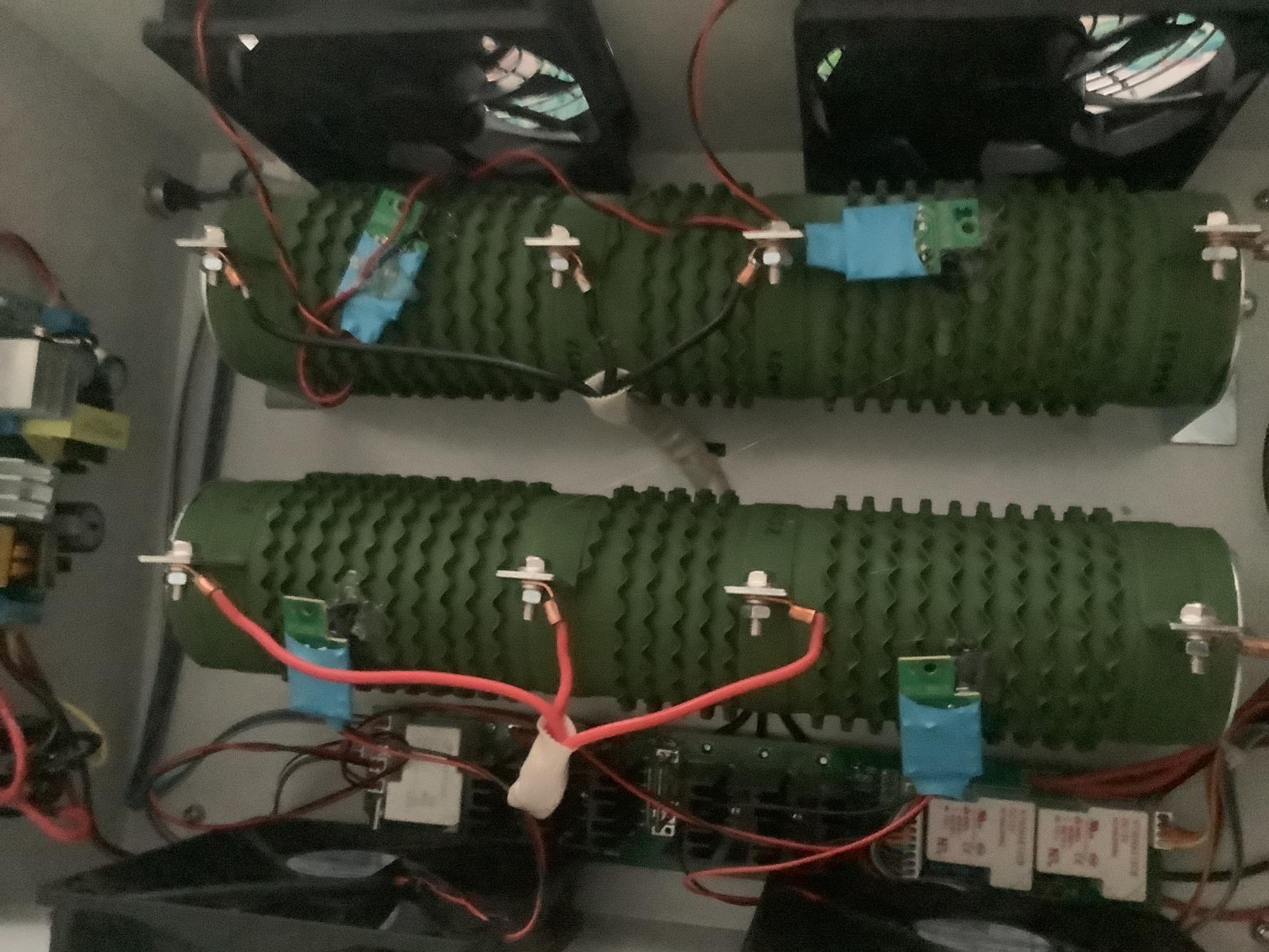

EBC-B20H 20A 12-72V Lithium Battery capacity tester just bought one
    • Jul 2011
    • 6037
    EBC-B20H 20A 12-72V Lithium Battery capacity tester just bought one
    I have just bought one of these battery tester because I have bought several battery packs that were over 24 volts and had no way to test them with out testing each battery bank of 1S3P which is a pain to do safely because it requires you to remove the battery board from the enclosure
    Plus it will allow me to test lead acid batteries at 10 amps versus 5 amps
    The only downside of this battery tester is that the voltage starts 12 to 72 volts instead of 1.2 volts to 30
    volts this is the main reason I have not bought one of these battery tester before now
    *** There is a note that if you are testing a 12 volt battery that it is limited 10 amps I am not sure exactly why this is the case ***
    https://www.ebay.com/itm/38436463604...53.m2749.l2649
    Last edited by sam_sam_sam; 12-08-2021, 05:25 PM.
  • eccerr0r
    Solder Sloth
    • Nov 2012
    • 8697
    Re: EBC-B20H 20A 12-72V Lithium Battery capacity tester just bought one
    Assumes protection or the acceptable lack of such?
    Indeed weird, seems 10A @ 72V would be a bigger problem than 10A @ 12V, perhaps it was a typo?
      • 30985
      Re: EBC-B20H 20A 12-72V Lithium Battery capacity tester just bought one
      how much current are those GX12 connectors rated per pin anyway?
        • Jul 2011
        • 6037
        Re: EBC-B20H 20A 12-72V Lithium Battery capacity tester just bought one
        Originally posted by eccerr0r
        Assumes protection or the acceptable lack of such?
        Indeed weird, seems 10A @ 72V would be a bigger problem than 10A @ 12V, perhaps it was a typo?
        I will find out once I get the battery tester and see if it does limit you at 12 volts @ 10 amps or not but you could be right that it might typo
        I know that the EBC-A10H is very well built because I have use the hell out of anywhere from 500 milliamperes to over 2.5 amps but not much higher than that because of the same reason about generating to much heat even though it does have a cooling fan that comes on when you go higher than one amp
        Last edited by sam_sam_sam; 12-09-2021, 09:10 AM.
          • Jul 2011
          • 6037
          Re: EBC-B20H 20A 12-72V Lithium Battery capacity tester just bought one
          Originally posted by stj
          how much current are those GX12 connectors rated per pin anyway?
          I do not know I would have to look it up but I doubt that I would go beyond 5 amps anyway just because how much heat you would build up in the battery tester compartment/enclosure
          • eccerr0r
            Solder Sloth
            • Nov 2012
            • 8697
            Re: EBC-B20H 20A 12-72V Lithium Battery capacity tester just bought one
            With its fans it probably can really dump 500W fine, but likely not 1KW. At 5A per contact it's probably using all three in parallel so those together will get you 10A just fine.
            Still trying to figure out what's in the box...
              • 30985
              Re: EBC-B20H 20A 12-72V Lithium Battery capacity tester just bought one
              probably just a shunt or an array of shunts switched by relays or fets,
              together with a simple mcu to do the metering of current over time
              • eccerr0r
                Solder Sloth
                • Nov 2012
                • 8697
                Re: EBC-B20H 20A 12-72V Lithium Battery capacity tester just bought one
                well... I guess I sort of meant "what's in the box" ... sarcastically, to explain the advertisement
                  • Jul 2011
                  • 6037
                  Re: EBC-B20H 20A 12-72V Lithium Battery capacity tester just bought one
                  Well the battery tester came today and I tried it and it works however in order to charge a battery you need an external power supply which I have to buy one that go up to at least 48 volts ( that is solely used for this battery tester ) I might get one that goes 100 volts but would have to limit the voltage 72 volts
                  This one is different from the other battery testing machine you set the cutoff current for charging and you set the power supply to the current that you want it to charge at
                  Come to think about why the current is limited to 10 amp might be because the cutoff voltage is 9.0 minimum setting for discharge and might cause it to misbehave and let out factory smoke is my guess to why it has this limitation
                  One note the manual does not explain why it has these limitations which I find odd
                  One other note when you activate the the discharge cycle the fans comes on automatically at full speed which is a little loud I might put a temperature controller on fans in the future depending on how much current I decide to test batteries at
                  The most that I tested current on the other battery testing machine was at 2 amp because the fan on this one does not seem to run very fast because it is not very loud but most of the time I would only use 1 amp and fan would barely come on
                  Last edited by sam_sam_sam; 12-11-2021, 06:43 PM.
                    • Jul 2011
                    • 6037
                    Re: EBC-B20H 20A 12-72V Lithium Battery capacity tester just bought one
                    Originally posted by eccerr0r
                    well... I guess I sort of meant "what's in the box" ... sarcastically, to explain the advertisement
                    The package weight was 22 pounds this is heavier ( and twice the size ) than the other battery tester that I have from the same company
                    I might open it up after I have it for awhile to see what electronics are in it and see how it is setup
                    Last edited by sam_sam_sam; 12-11-2021, 06:35 PM.
                      • Jul 2011
                      • 6037
                      Re: EBC-B20H 20A 12-72V Lithium Battery capacity tester just bought one
                      Well I used it to test a 32 volt battery pack and the results are pretty good however when I do more than 1 amp I need to use the step cycle feature that this battery tester has to step down to 500 milliamperes when I am finished with higher discharge current above 1 amp for more accurate milliamperes hours results when doing li-ion batteries
                      With this feature I can test a battery pack for what current the device requires to work correctly and see what my results are if the device has a stand-by feature and a working feature which I did not have this capability before with out worrying about the tester taking a shit beyond the 2 amp limitation I have used for the other battery tester
                      Last edited by sam_sam_sam; 12-12-2021, 06:11 AM.
                        • Jul 2011
                        • 6037
                        Re: EBC-B20H 20A 12-72V Lithium Battery capacity tester just bought one
                        I am going to have to put some temperature controlled cooling fans on this new battery tester because these fans are noisy as hell which is going to drive me nuts if I do not replace them very soon
                        • eccerr0r
                          Solder Sloth
                          • Nov 2012
                          • 8697
                          Re: EBC-B20H 20A 12-72V Lithium Battery capacity tester just bought one
                          what does it use for the load?
                            • Jul 2011
                            • 6037
                            Re: EBC-B20H 20A 12-72V Lithium Battery capacity tester just bought one
                            Originally posted by eccerr0r
                            what does it use for the load?
                            I will post some pictures of it when I take it apart but last week and this week are very hectic at work I did not even have a day off so far sense last Sunday night and this week does not look any better until Thursday night unless something changes sometime this week
                            Are working week starts Sunday night to Thursday night
                            On a brighter note the week of Christmas and the week of New Years we are scheduled to only work Sunday night to Tuesday night unless they change their minds which happens sometime
                              • Jul 2011
                              • 6037
                              Re: EBC-B20H 20A 12-72V Lithium Battery capacity tester just bought one
                              Here are the fan that I am going to use in the new battery tester machine
                              https://www.mpja.com/12VDC-47-120mm-...info/35272+FN/
                              I will remove the temperature sensors and relocate it to the heat sink or heat sinks for better cooling temperature control
                              Last edited by sam_sam_sam; 12-13-2021, 08:07 PM.
                              • eccerr0r
                                Solder Sloth
                                • Nov 2012
                                • 8697
                                Re: EBC-B20H 20A 12-72V Lithium Battery capacity tester just bought one
                                Not sure if it's easy to relocate the sensors in those fans...may be easier to have custom controller for those fans?
                                  • Jul 2011
                                  • 6037
                                  Re: EBC-B20H 20A 12-72V Lithium Battery capacity tester just bought one
                                  It not hard to relocate temperatures sensor you just have to have some patience and take your time and use a desoldering gun and after you remove it then you put the temperature sensor on a small circuit board and use some very small diameter wire between the two circuit boards and use some hot glue on the temperature sensor and you are ready to rock and roll
                                  However it took several tries before I could do it with out damaging the sensor or the circuit board
                                  The switching power supply that I wrote about modifying a few months ago I had modified a small size fan from the same company
                                  Last edited by sam_sam_sam; 12-14-2021, 01:25 AM.
                                    • Jul 2011
                                    • 6037
                                    Re: EBC-B20H 20A 12-72V Lithium Battery capacity tester just bought one
                                    Well what I had in mind to use for the temperature controlled fans is not going to work because the thickness of the those fans are two times more than the ones in there now
                                    So plan number two which is use temperature controller from some switching power supply that I bought surplus a couple of years ago which I have not done much with so far I have found two of them I need to find two more of them
                                    But I installed the two that I found and it is a lot quieter than it was I can at least be in the same room now with it
                                      • Jul 2011
                                      • 6037
                                      Re: EBC-B20H 20A 12-72V Lithium Battery capacity tester just bought one
                                      Here is some pictures of the inside of this battery testing machine before and after I mounted the temperature sensors on the loading resistors
                                      So much quieter than it was before I added the fan speed controllers on this battery testing machine at least now I can be in the same room with while running the testing
                                      Last edited by sam_sam_sam; 12-19-2021, 01:04 PM.
                                        • Jul 2011
                                        • 6037
                                        Re: EBC-B20H 20A 12-72V Lithium Battery capacity tester just bought one
                                        Originally posted by eccerr0r
                                        what does it use for the load?
                                        I posted some pictures of the inside of this tester
                                        I also ordered a temperature sensor controller that I going to put on the charging controller circuit so I do not have to babysit the battery tester on battery packs that I am not sure of
                                        • mkdj
                                          ASUS X571 no power : battery issue?
                                          by mkdj
                                          Mark and model: ASUS X571
                                          Symptoms: not turning on. There is only the LED battery indicator working. The owner of the laptop told me this problem arrived one week after having changed the battery. He then managed to power on the laptop only once, and then it never powered on again.
                                          Tests already made:
                                          - Battery is charging when laptop is plugged in. The LED battery indicator turns white after a couple of hours of charge, indicating that battery is fully charged. However, laptop won't turn on anyway, with or without AC plug.
                                          - I have removed...
                                          07-14-2025, 09:16 AM
                                          ISL88739AHRZ ISL88739 Laptop Battery Charger Datasheet
                                          The ISL88739 & ISL88739AHRZ are a highly versatile combo battery charger
                                          configurable for operating as either a Hybrid Power Boost (HPB)
                                          charger or a Narrow VDC (NVDC) charger, supporting 2-, 3-, or
                                          4-cell batteries. Both configurations allow the battery to work with
                                          the adapter together to supply the system load when it exceeds
                                          the adapter capability, referred to as system Turbo mode. HPB
                                          charger configuration reverse-boosts battery energy to the system
                                          bus to help the adapter provide the system power in Turbo mode.
                                          NVDC charger configuration...
                                          11-05-2024, 03:28 PM
                                        • ferah831208
                                          Strange battery present behaviour in Lenovo Legion 5-15ARH05 mb model nm-d041
                                          by ferah831208
                                          Hello guys, i need help with this problem, I have a NM-D041 mobo, it came with low impedance in 3v linear regulator rail, the cause was a damaged EC controller ITE8227e-192. I ordered a new one and replaced it. This laptop have a different chip for keyboard management and it8227e pins for programming ITE chips are not accesible through keyboard interface, I flashed it using i2c interface pins with vertyanov programmer because laptop was dead and SPI flash didn't have power (only 3v EC) so it couldn't access firmware stored in SPI memory. I read SPI and extracted it8227 firmware from original BIOS...
                                          03-18-2025, 01:18 AM
                                          EBC-X 8-Channels 18650 Battery Capacity Tester Charge & Discharge 10A Aging Test Modificatio
                                          by sam_sam_sam
                                          This is another battery testing machine that needs to be modified for the cooling fans because these are noisy but not as bad as one of the other battery testing machines that I had modified recently because of it being too noisy
                                          The battery testing machine is going to get two temperatures controlled cooling fans like one I put in the other battery testing machine I just have to remove the temperature sensor and relocate the temperature sensor to one of the heat sinks and put one on the other heat sink so the fan speed can be controlled by temperature
                                          https://www.eb...
                                          05-05-2024, 06:07 PM
                                        • trepachka
                                          iPad Air A1475 Boot loops after replacing battery
                                          by trepachka
                                          This iPad was working fine except the battery was not holding charge for more than 40 minutes. I replaced it with a new battery. I haven't glued the battery yet, just inserted it into the slot and held it with battery screw.
                                          The iPad was powered on with the new battery and I am getting white screen with Apple logo for about 10 seconds, then the screen turns dark. It then cycles like this forever.
                                          I know the battery is working because the iPad continues to boot loop without the charger until it depletes to 0% and the message displays I need to plug in the charger.
                                          11-08-2024, 03:17 PM
