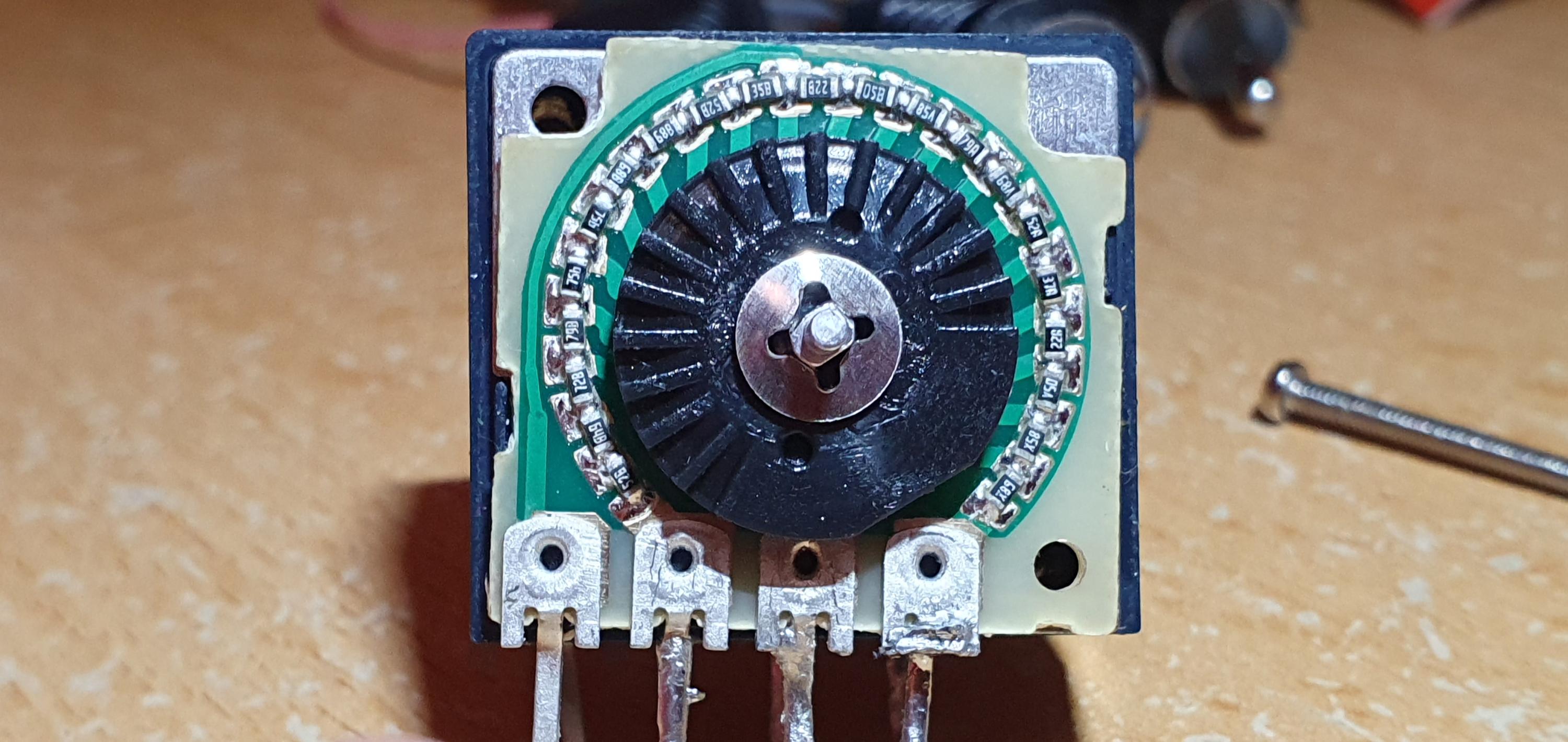

                        Out of curiosity, I went to my parts bin and dug out that big Alps pot I mentioned as being perfect in terms of balance and it turns out it's not really Alps and it's not really a "pot" either
                        First off, there's no info on this part whatsoever - RH2702 only gets me links to random sellers and references to the "real" thing which apparently is the RK271 series. RH is not even an official Alps series of its own, which leads me to believe it's a knock-off. Should come as no surprise given that I got it off Ali and it's common practice for sellers to spoof official names and models by altering a letter, such as Sqny instead of Sony and so on. In this case, it's RH instead of RK.
                        Backing this up is a discussion I found here where they talk about the same exact doubts about the authenticity of said pots. Someone said the real ones do not have a stepped feel and knurled shaft and also a serif font for the ALPS logo on the back....mine has both of the former and plain text as well, so it's deffo fake.
                        Looking past that, what IS this thing then ? I mentioned how it's got a stepped feel to it and how it's not really a pot. It's a "stepped attentuator" if you ask me. I found a picture of it dismantled here and the way it works is by moving the wiper across a series of fixed value SMD resistors, hence the stepped feel when you turn it. Out of curiosity, I took mine apart as well and sure enough, there's your 22 SMD resistors in series. It works fine, no complaints there and I guess one redeeming aspect is that it offers "true zero" when the wiper is at either end (why can't more pots do this ?), but the stepping is kind of rough and results in large jumps in volume. I also don't like the force required to turn it....
                        This got me thinking of getting a real RK one, since it seems to be praised by audio guys....

                            This one is 22, counting the zero position. I had no idea what the fourth pin was for. Measuring it against the others just gave some random BS reading that made no sense. After reading about it, I learned it's called a loudness tap and it's connected somewhere in the middle of the resistors, so at one point the resistance between the wiper and this pin becomes zero indeed.
                            No idea what I could use that for though...

                              I'm surprised, thought those pots with tons of little detents were mechanical detents on a continuously variable background; I'm surprised that it's cheaper to make a side switch on a PCB with tons of different little SMD resistors -- though getting a good long lasting log pot isn't easy.
                                I thought the same from the moment it landed in my parts bin years ago, until yesterday when I tried looking up a datasheet for it and got nothing other than that page which shows one open.
                                I tried it out as the master volume for the headphone part of my build, just out of curiosity and just as I predicted, after just one CW click (so 50 ohms "away" from GND), it gets louder than how I'd like it to be, at least for these particular earphones and laptop, as I'm sure it'd be adequate if I maybe had higher impedance drivers, a device with a weaker output and the content itself encoded at a lower volume. The channel balance on the other hand is, as I said and as you'd expect from fixed value resistors, BANG on, to the nearest digit ! I'd like to see something else like this but with more steps, hence more resistor values packed in there because the concept is great overall, albeit it's an overall fake part nonetheless !
