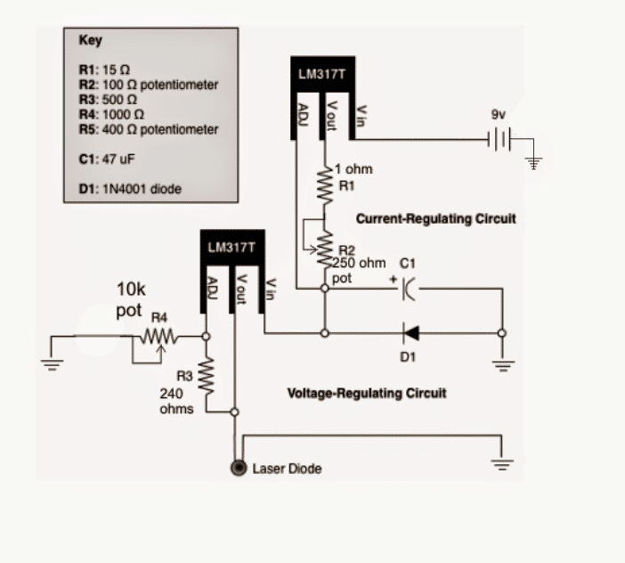

    Given this circuit:
    How can I calculate IR2?

    Re: How to calculate current in R2 with an LM317
    IR2=Approximately 1.25/R2
        Actually I screwed up, should be (1.25/R1 + a bit, usually around 60µA or so), math isn't cooperating with me nowadays. Sigh. I knew something was wrong with the previous answer when I tried dividing by zero, something was definitely wrong... But yes it should not matter what the load is, as long as the LM317 is operating within its design point - both the IC and the entire circuit.
              I R1 is constant as the LM317 always maintains 1.25V between the OUT and ADJ terminals.
              1.25V/datasheet 240R for R1 is 5.2083mA, which must flow through R2 plus the ADJ pin current ~50uA which is so small it is usually ignored to simplify math. Exactly I R2 would be 5.2583mA
              This is from using Kirchoff's current law.
              Note the LM317 needs a minimum load which is why R1 is set to a low value.

                      Circuit Operation
                      Referring to the shown circuit diagram, the configuration looks pretty straightforward, two LM317 IC s can be seen, one configured in its standard voltage regulator mode and the other in a current control mode.
                      To be precise the upper LM317 forms the current regulator stage while the lower acts like a voltage controller stage.
                      The input supply source is connected across the Vin and ground of the upper current regulator circuit, the output from this stage goes to the input of the lower LM317 variable voltage regulator stage. Basically both the stages are connected in series for implementing a complete foolproof voltage and current regulation for the connected load which is a laser diode in the present case.
                        Now this is the challenge: design a LM317 circuit that allows digital control (128 steps or better) that implements adjustable current limiting to a circuit up to 1A...
