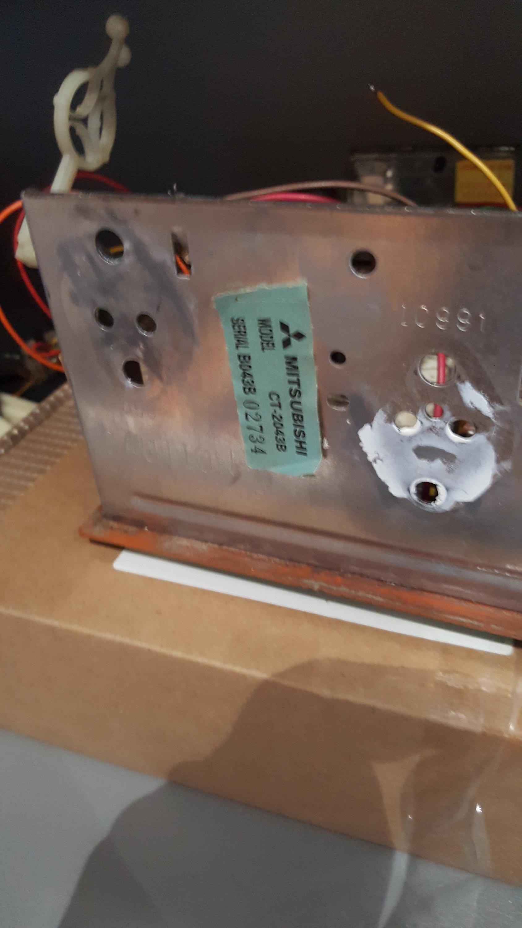

    repairs on an old CRT tv from the 80s that blew a flyback have led me to this diode which is reading near 0 in both directions. The diode is marked as an R2KY avalanche diode but is no longer manufactured.
    I am fairly new to the world of electronics, could anyone help me source a suitable modern-day equivalent diode?

          Originally posted by stj
          do you have a schematic to show where it was used?
          unfortunately not. The tv is a Mitsubishi ct 2043B although it seems to be really obscure.
          The diode is connected to a voltage regulator. I will have a look at making a schematic in the next few days : )

              Re: Help substituting avalanche diode
              what is the board number ? will be something like vestel------- or maybe Haier -----

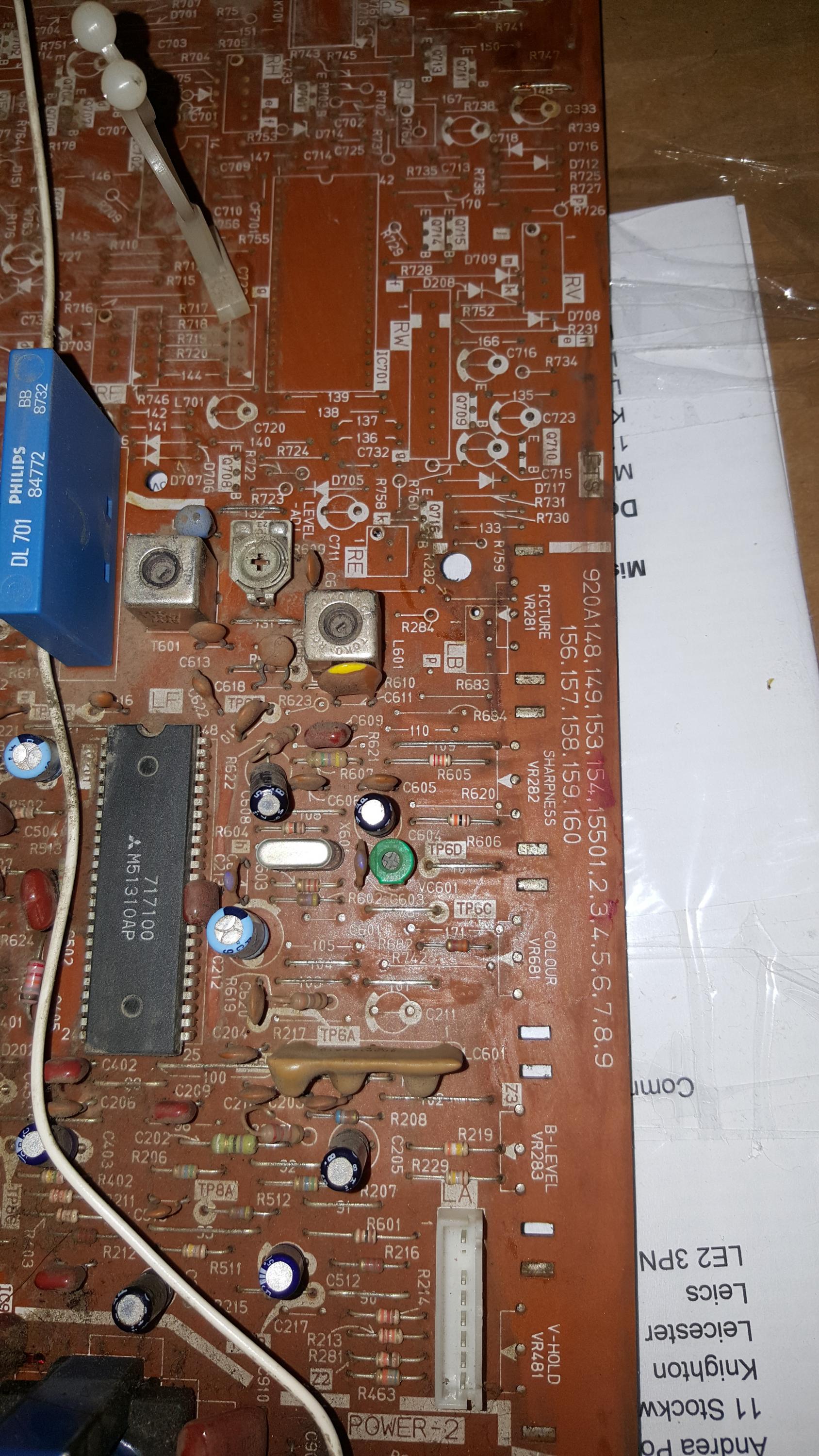

                • Bibdid
                  • Jun 2019
                  • 10
                  there is a schematic but asks to sign up . http://freebodydiagram.archivioprimo...our-television
                  That looks promising but the site seems to be very shady. Relinks me to scam sites.
                  I have attached some board model/serial numbers although it seems very obscure.
                      . cant make sense out of the board numbers yet .. maybe there are more numbers or a sticker
