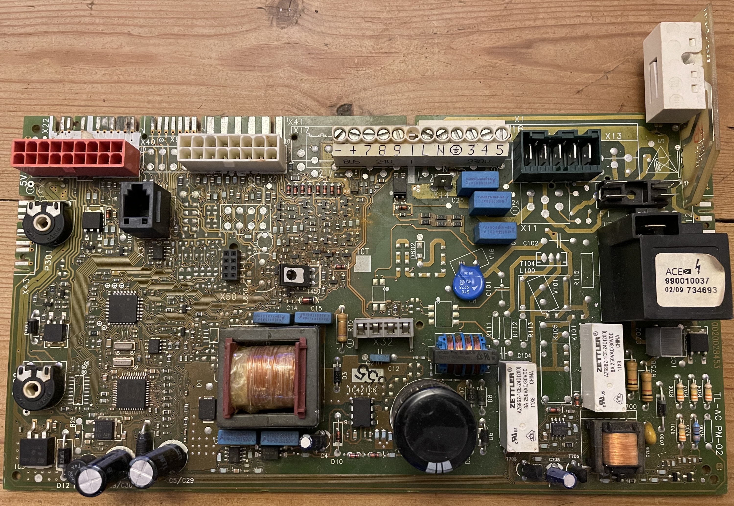

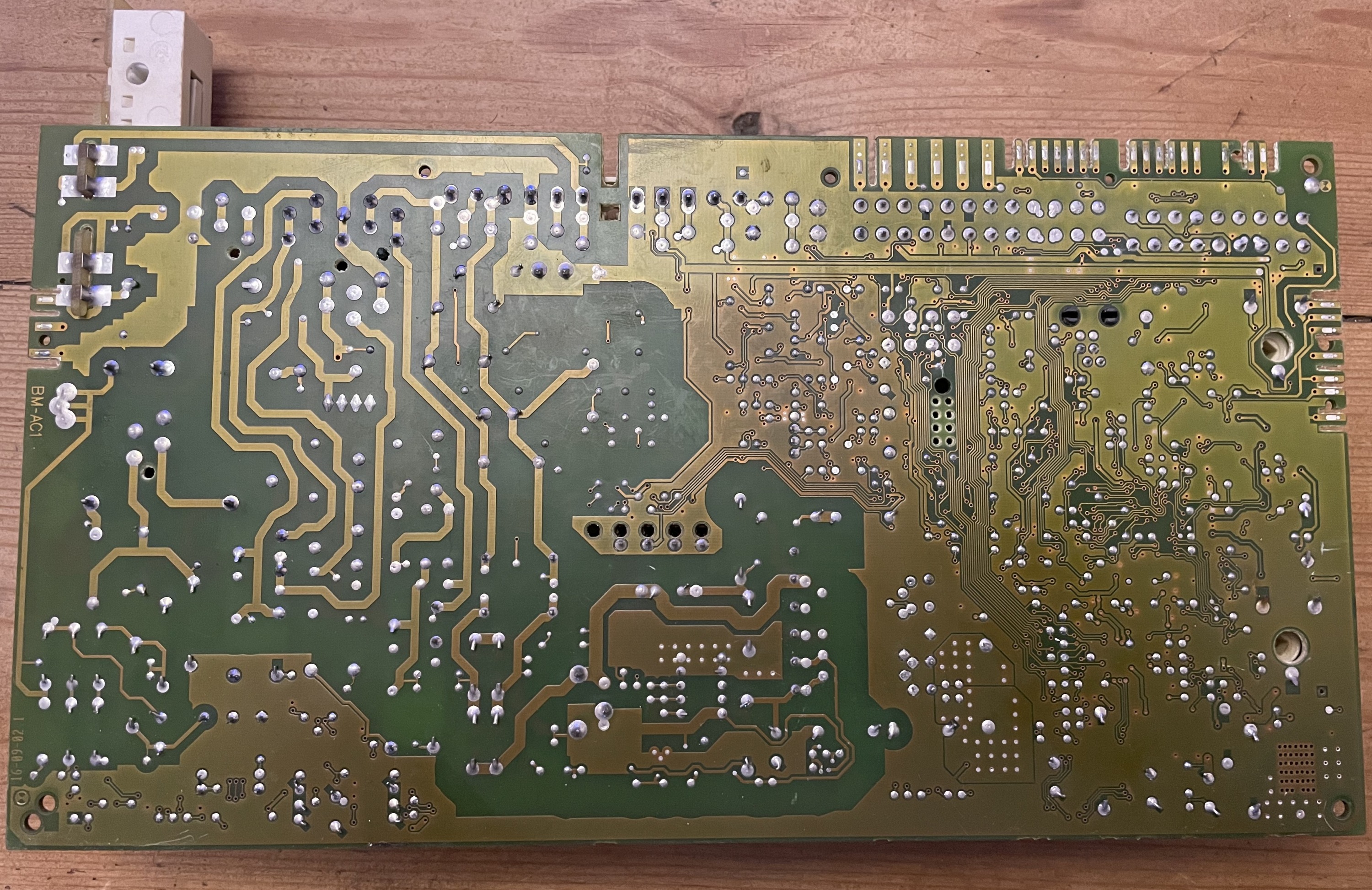

    Hi Guy's, ive got a valiant boiler & these are prone for the control boards failing, causing the boiler to go into a error state.
    When you run the hot tap, it goes into the error state but then when you reset, these work fine until next time.
    Im convinced that the problem with the boards are something simple like a relay which would cost considerable less than replacing the complete board at several hundred pounds.
    I was wondering if anyone had ever done any work or knows of anything to do with boiler boards?
    Many thanks in advance

    i ave fixed boiler boards.
    it's usually capacitors.
    fitting them in a box under a boiler probably doesnt help!

        your looking for any signs of yellow liquid or tops not perfectly flat.
        also check the soldering on the connectors - the cables put a lot of stress on the joints

              Re: Valliant boiler board
              Please see below, although upon inspecting, the big black one seems to be slightly bulging, although no leakage, ive peeled the black wrap from the top and it seems to be a sealed (no the pressure cross, if you know what I mean, like on the others).. but I welcome and ideas or suggestions.
              Many thanks again
              ASH

                  • redwire
                    • Dec 2010
                    • 3910
                    The board shows water damage, rust on the pcb. Something leaked on it.
                    I would clean it up with isopropyl alcohol and an old toothbrush, gently.
                      • 31040
                      sooo - you didnt notice the connector at x22 has burned all the pads off????
                      the oposing part on the wiring loom needs to be replaced or it will do that to any replacement boards.

                                  You could be onto something, after inspecting a little more of the old board I found this (I believe it to be a relay) which looks like its been warm in places.
                                  Whats everyones thoughts?
                                  https://ibb.co/gw45wJk
                                  https://ibb.co/dQ5WbH2

                                      On the second board I see capacitor C708 bent over, hopefully not mashed. It's by the big filter cap/relay at the edge.
                                      Did you clean the flame rod? Common problem here is boiler controller goes into lockout after either seeing an unexpected flame out or it's unable to light up. If the rod is dirty, the controller will see weak or no flame even though it's there.
                                      Another problem I have seen is the board's grounding, the igniter can cause the MCU to crash if the ground to the appliance or mains is not good. In the pic the two ground wires are cable-tied to the ignition cable- which is a bad idea. Keep everything away from it.
                                      I'm also seeing the high-limit switch trip, either due to low flow or the switch just getting old. I have not worked with Valliant but there should be an LED or something to read fault codes when the unit goes into lockout.
