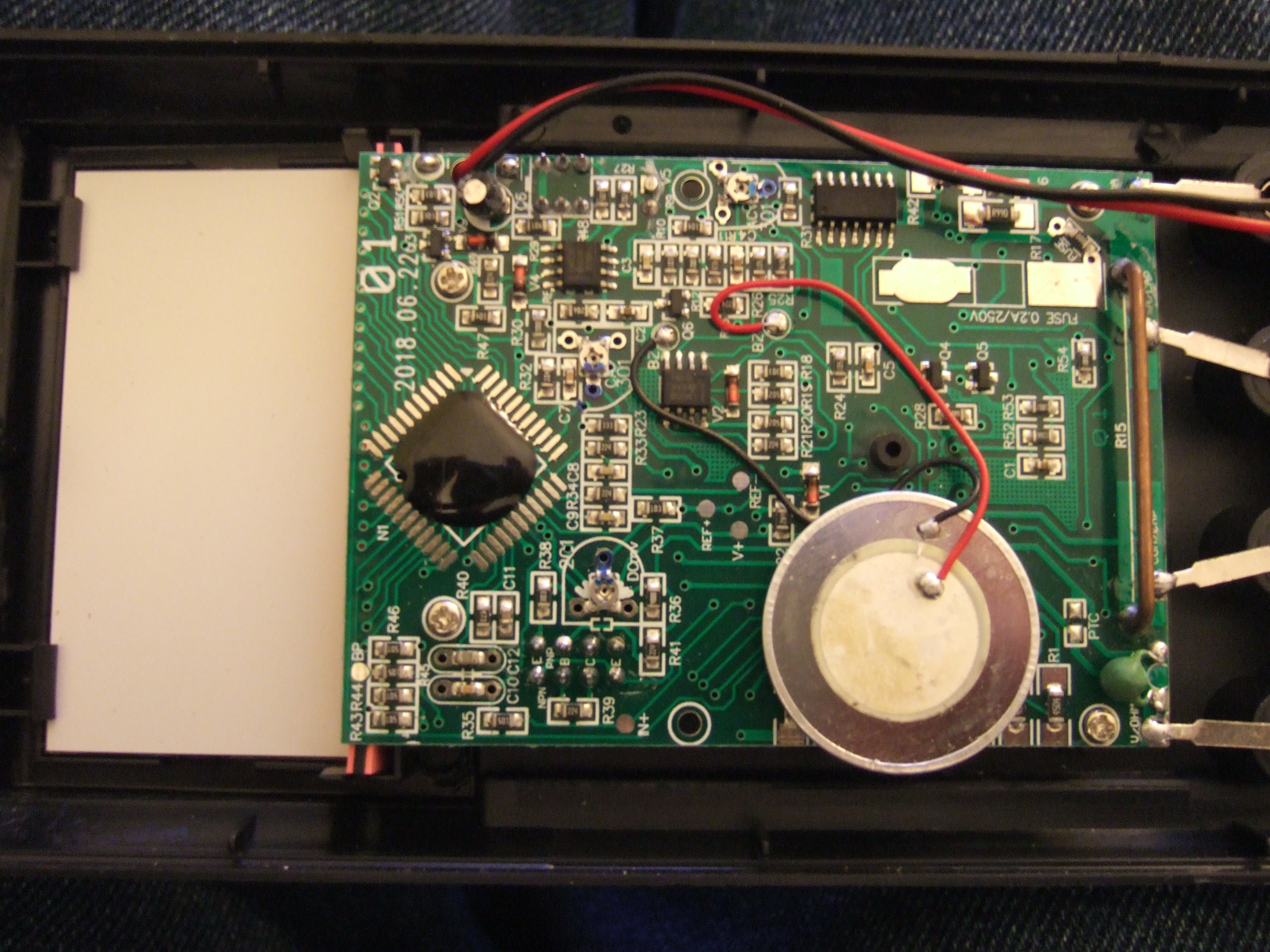

    Has anybody got the circuit for this meter ?
    Barry

    what chip does it use?
    dtm0660?
    dm1106?

      Hi cant tell what the chip is attached a picture .
      I know this was quite cheap ,bought it from Amazon because I had blown workshop one on some Ferrus power supplies, in fact its not bad just a bit low on all readings,when I compare it with my best meter which is accurate.
      Just would like to increase the counts which will make it bit better.

          i dont think you can increase the count if it doesnt use one of the chips i listed,
          are either of the 8pin chips a 24c02 eeprom?

            Hi I did find some info on line ,which I did not think was correct . It showed a circuit with 7106 IC.

              it's not the old icl chip - the tracks dont fit the schematic.

                It might be the new chip which has 44 pins
                R34 is connected to pin 39 (100K) reducing by padding this with 10M has brought up the reading .Its slightly high now .
                One of those tiny pots would be nice ,but have never found them anywhere.
                I have got some SM 10M resistors left over from a scope repair ,so I will fit one of them.

                  i have those pots - they come from ali express.
                  https://www.aliexpress.com/item/32843902104.html
                  if your in a pinch, you can find them on cd/dvd laser assembly's
